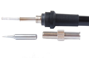

Mikorist Napisano Decembar 16, 2022 Share #24 Napisano Decembar 16, 2022 I na baku je grejac na vrhu. Ide kroz onaj cilindar sve do samog vrha. Samo pazljivo mora da se odvija - i da se ne zapece Link to comment Podeli na ovim sajtovima More sharing options...

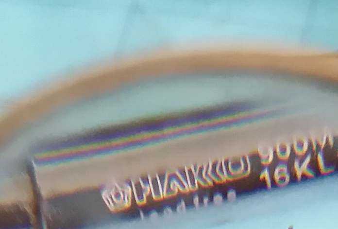

Mikorist Napisano Decembar 16, 2022 Share #40 Napisano Decembar 16, 2022 Meni sve to isto izgleda. Klonovi. Ali imam ovaj vrh - isto pasuje... HAKKO made in Japan, Osaka Ko da ja lemim nekad SMD - ali nakupovao da se nadje... HAKKO 900M iron tip 2C type 900MT2C From Japan WWW.EBAY.COM Is a big scale car eye-catching be left to decorate. Full function of forward and backward, right and left turns. Of course also the lighting of the headlights! Link to comment Podeli na ovim sajtovima More sharing options...

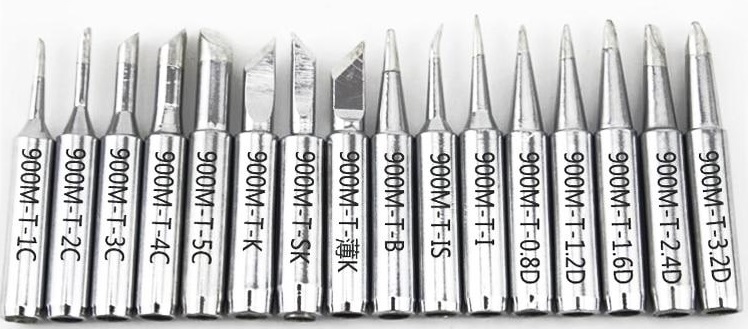

Mikorist Napisano Decembar 16, 2022 Share #44 Napisano Decembar 16, 2022 Evo oznaka svih 900M Hakko Link to comment Podeli na ovim sajtovima More sharing options...
