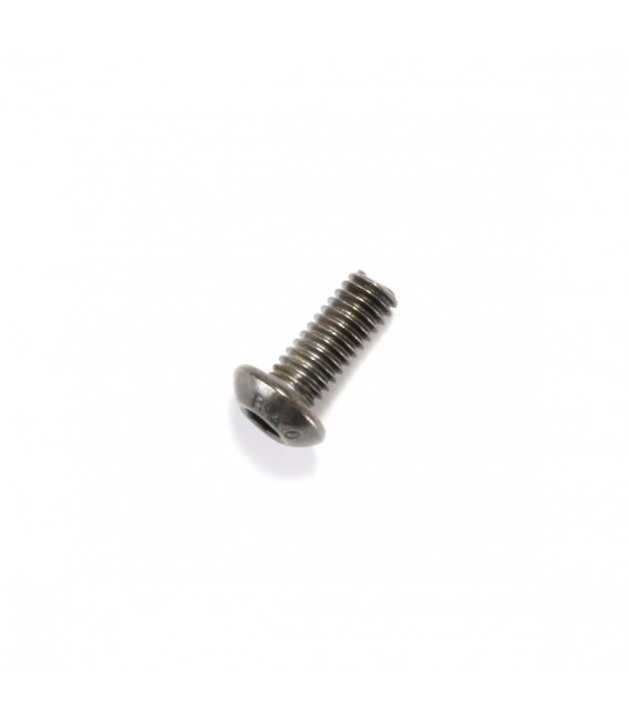

savan Napisano Decembar 9, 2021 #55 Napisano Decembar 9, 2021 10 komada nikl crni za 1.3eur Audiophonics - Hexagon Socket Round Head Screw M4x10mm 10.9 Nickel Steel Black (x10) WWW.AUDIOPHONICS.FR These hexagon socket round head screws are in M4x10mm format. Made of 10.9 steel, they guarantee a high durability. Beli_Ninja je reagovao/la na ovo 1
