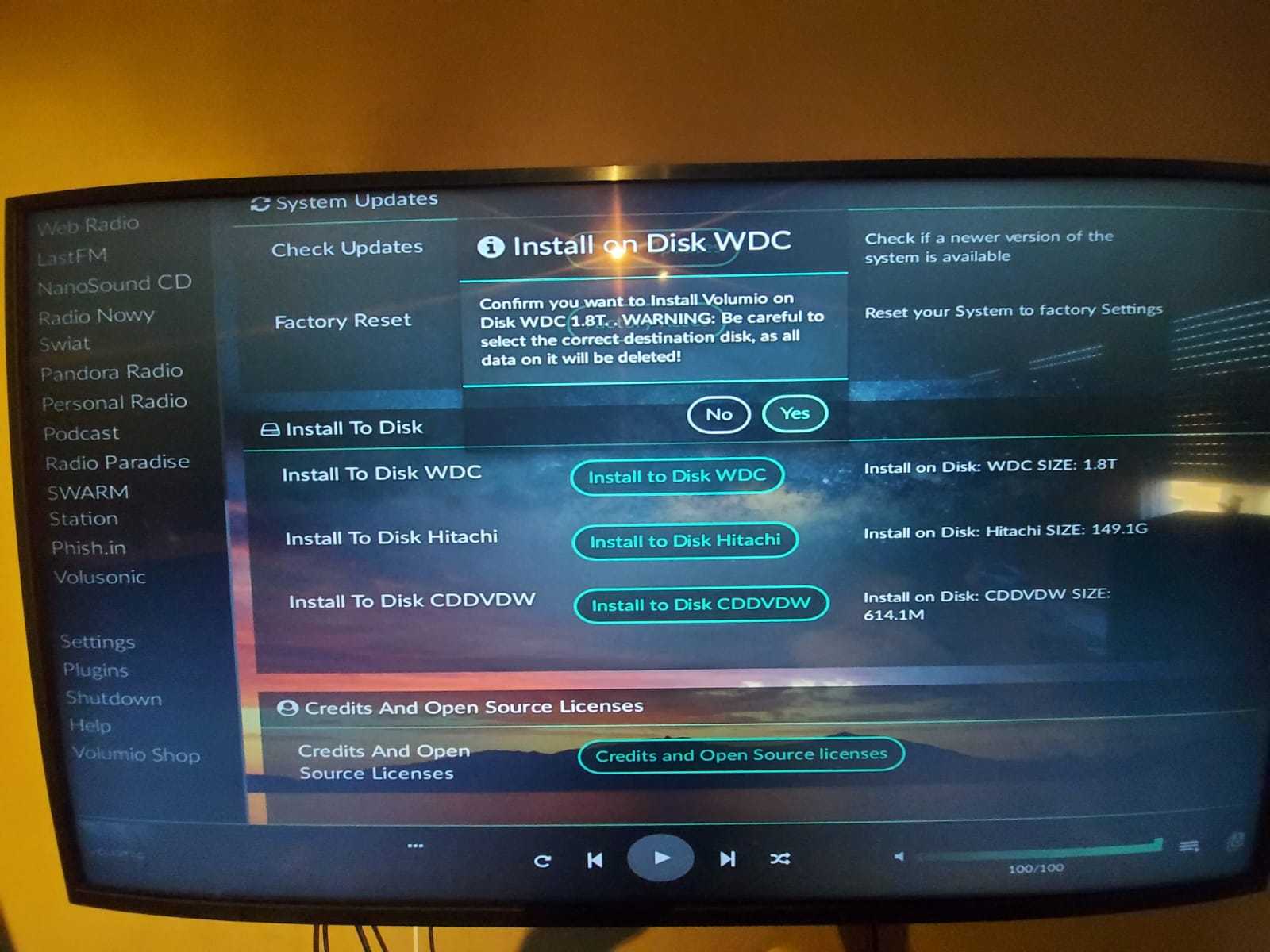

Naravno, Volumio možeš da spustiš i na HDD, ali gubiš sve podatke:
Quote
NOTE: you will loose ALL the data on your HDD.
- Flash Volumio 2 to a usb stick
- Format another usb stick wit FAT32, and copy the unzipped downloaded x86 image to it.
- Then boot from your usb volumio 2 stick.
- Will until the UI is showing, the press ctrl-alt-F1 to open a terminal session
- Log in with volumio/volumio
- Type
Code: Select all
    sudo blkid
and check the output.
- You should see /dev/sda, /dev/sdb and /dev/sdc (presuming you only have one disk in your x86 pc)
The device with the labels "volumioboot", "volumioimg" and "volumiodata" is the one you booted from.
The device with the single vfat partition is the stick with the volumio image, assume it is /dev/sdX (X being a, b, c...)
The other device is your netbook's hdd, assume it is /dev/sdY (Y being a, b, c...)
- When sure about the devices, type
Code: Select all
      mkdir usb
      sudo mount /dev/sdX1 usb
      cd usb
      ls -l
      sudo dd if=fullnameofthevolumioimage   of=/dev/sdY   bs=4M
      sync
      cd ..
      sudo umount usb
      sudo rm -r usb
      poweroff
- remove the usb sticks, reboot et voila

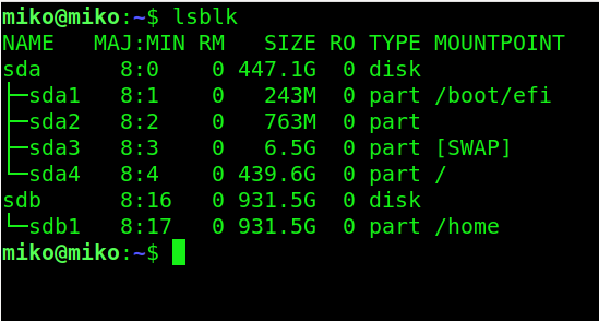

Da se izlistaju svi diskovi koristi se komanda lsblk
Onda mora da napraviš putanju za HDD
tipa
sudo mkdir  /mnt/Muzika
disk od 931GB je Muzika i Filmovi nemož da promašiš veličinu
onda ideš
sudo mount /dev/sdb1 /mnt/Muzika
kod mene je sdb1 kod tebe možee biti i nešto drugo
gledaš gde je 1T
onda ideš
ln -s /mnt/Muzika /var/lib/mpd/music/Muzika
pa
mpc update
prosto ko pasulj :sarcastic_hand:

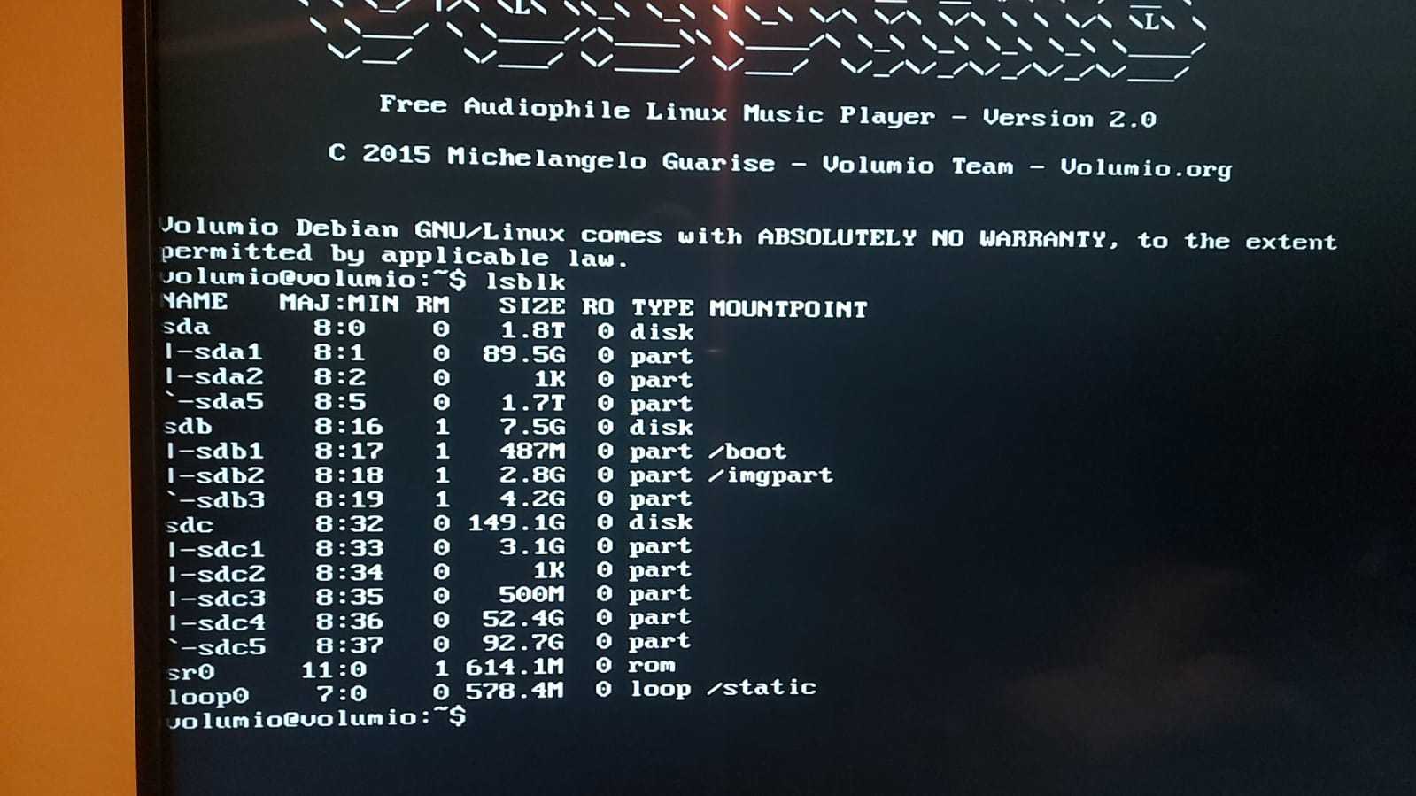

Slika 1:
Pobjegao sam glavom bez obzira od toga.
Slika 2:
Poslusao sam savjet i ukucao ctrl+alt+F1 i dobio ovo na slici.
Zapravo sam prvo ukucao "lsblk" i stisnuo "Enter"
Nakon toga me trazio to sto se vidi. Na zalost, ne da mi pisati, tj. kad pisem nema slova da se vide.

na tom crnom prozoru kucaš  volumio/volumio
kad dobiješ volumio@volumio :~$
onda tek kucaš pone komande

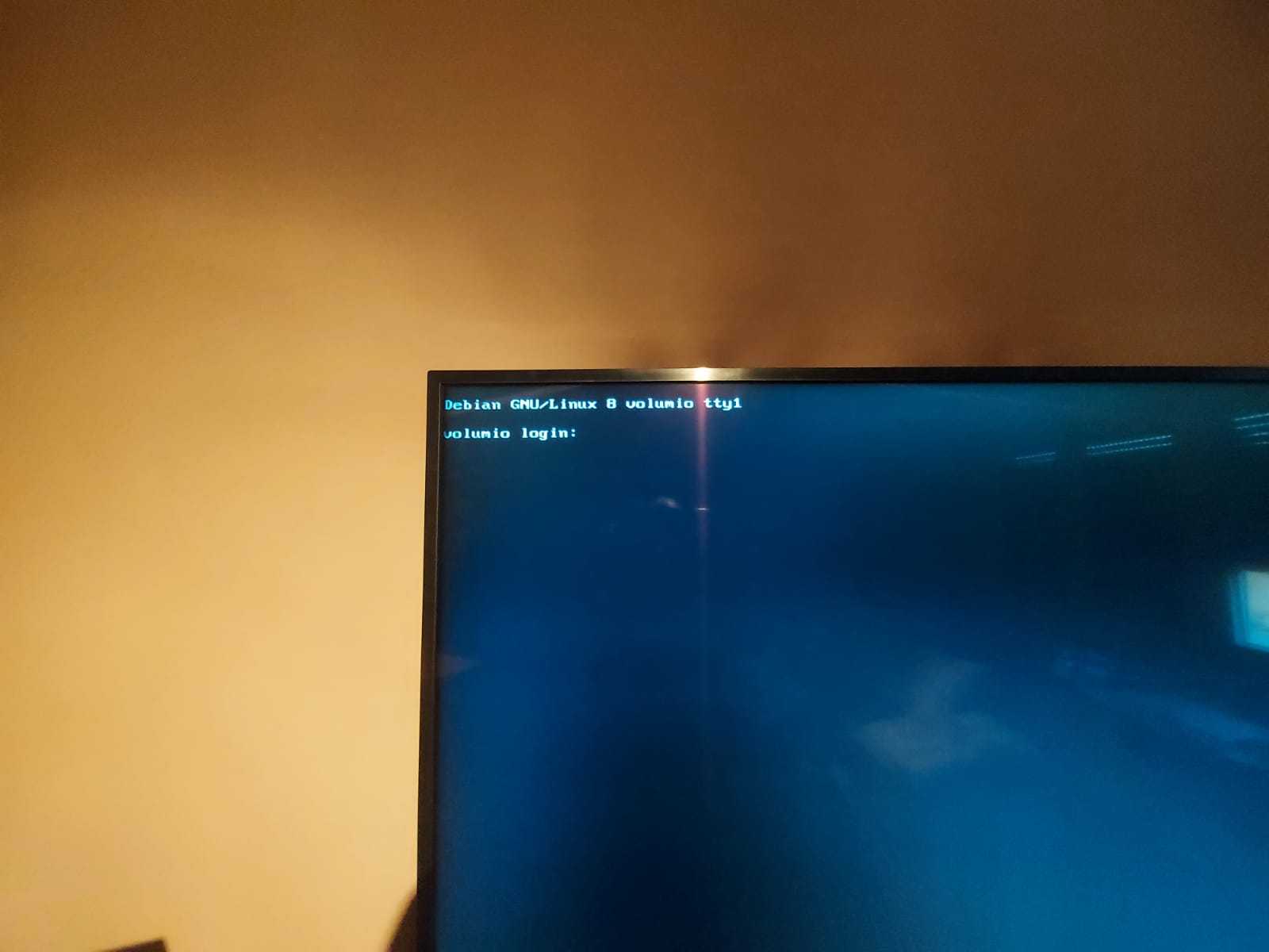

username = volumio
password = volumio
Vjeruj mi da sam prasnuo u smijeh.
Nema sto nisam istipkao jer sam vidio "volumio/volumio". :D
Okay.
Dobio sam logotip na crnom ekranu.
Znaci sad ide "lsblk"?
Kad sam dosao dovdje ide Linux!

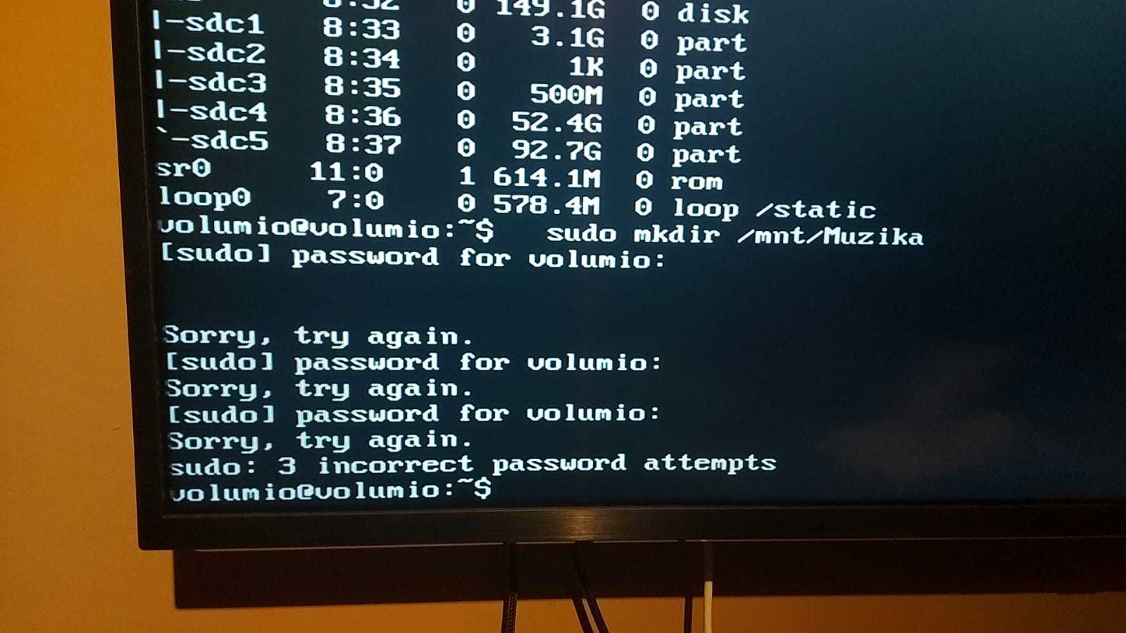

onda ideš
gledaš gde je 1T
onda ideš
pa
mpc update
Znaci sad ide ovo?
Tim redom i sa tim razmacima?
Osim sto je kod mene SDA5 taj sa najvise prostora, pa je u njemu i sva muzika?
