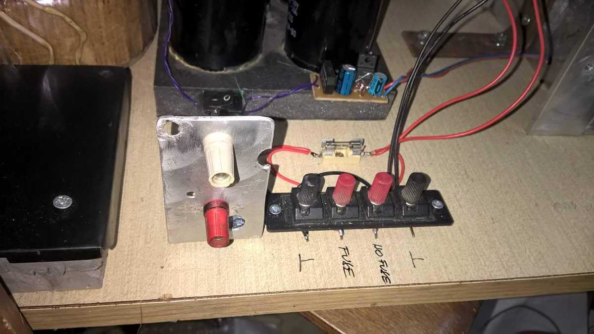

Zen Mod Napisano Jul 20, 2018 Autor #135 Napisano Jul 20, 2018 well , I did one slight imrpovement of T-Bed added another set of (1/)5 way output terminals

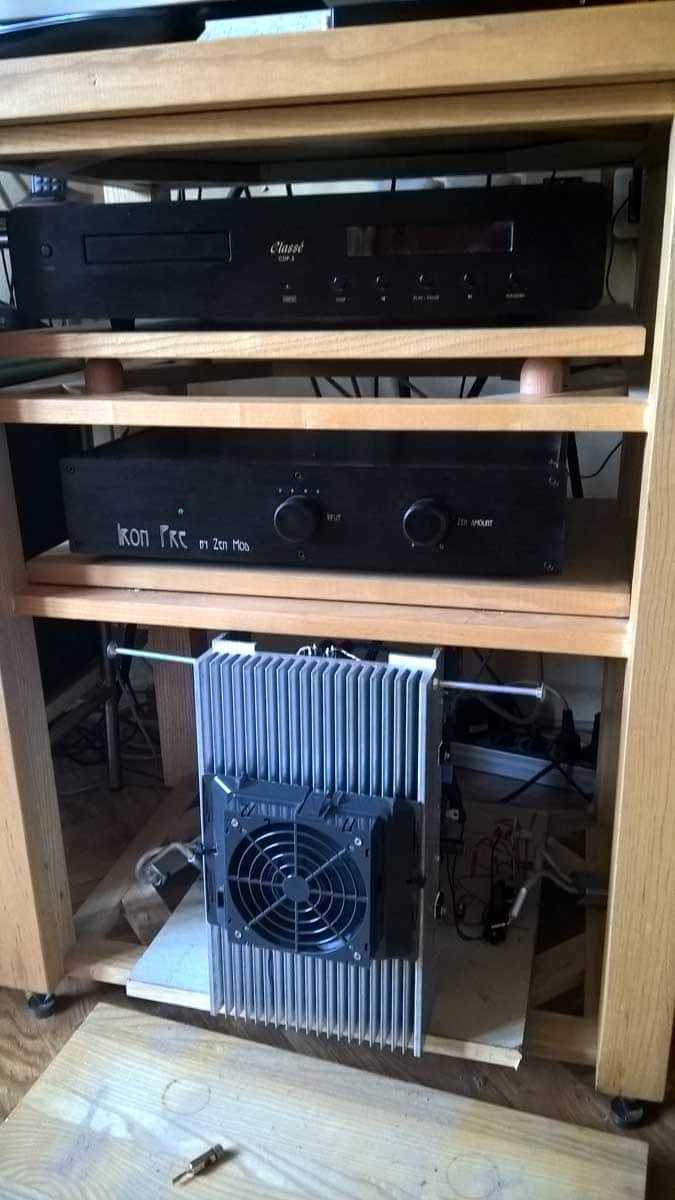

Zen Mod Napisano Jul 20, 2018 Autor #136 Napisano Jul 20, 2018 and today is first day of evaluation on Dynaudio Contour 1.8 Mk2 4R impedance ..... after just 30min (after initial warm up) it is clear that Babelfish M25 is damn well improvement over regular (Papa's Koan) M2 ......... and that still even without trying/engaging (supposedly superior ) White Cathode Borbely JFet buffer ...... and that one is promising to have objectively lower distortions , driving that nice Edcor Iron and , we are speaking here about properly made M2 - dual mono (each channel having 250VA Donut and 4 x 33mF caps) with proper wiring inside ...... while T-Bed is having common supply for both channels , with old and tired caps and sooooo crappy wiring ........ and with flimsy 1A6 fuses inline with speakers Woland, vladd, Aleks and 1 član je reagovao/la na ovo 3 1
prophet Napisano Jul 20, 2018 #137 Napisano Jul 20, 2018 well , I did one slight imrpovement of T-Bed added another set of (1/)5 way output terminals Da ne znas odakle su ti terminali, mislim na par levo crveni i beli? Proizvodjaca i namenu?
Zen Mod Napisano Jul 20, 2018 Autor #138 Napisano Jul 20, 2018 bice da je nekadasnja Iskra prophet je reagovao/la na ovo 1
