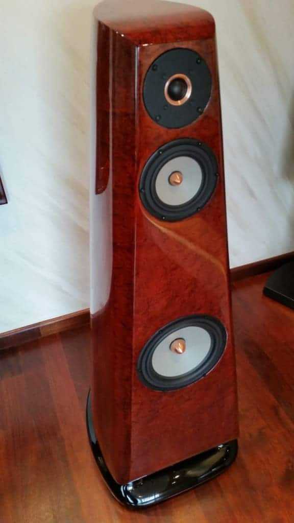

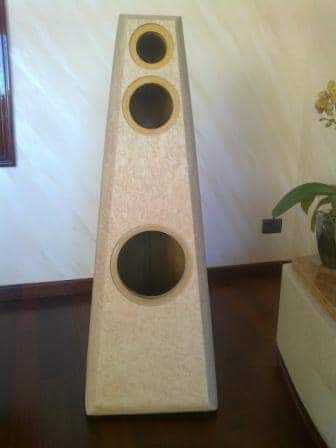

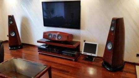

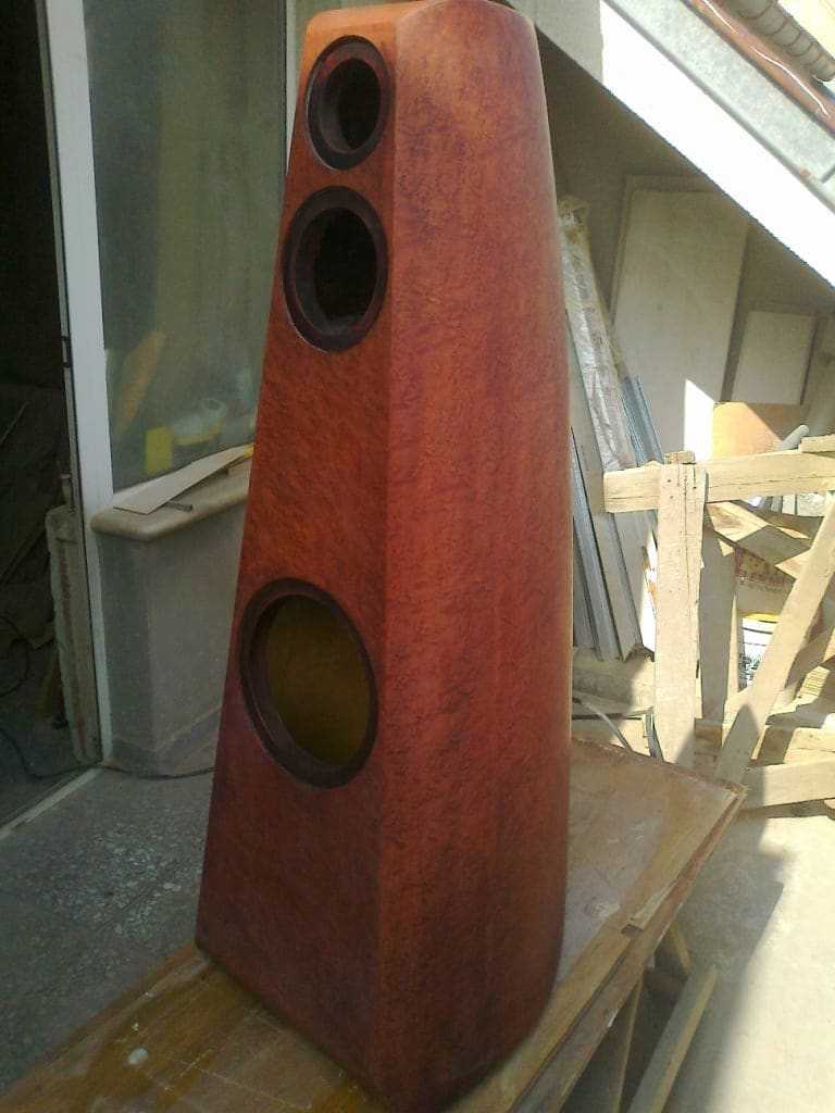

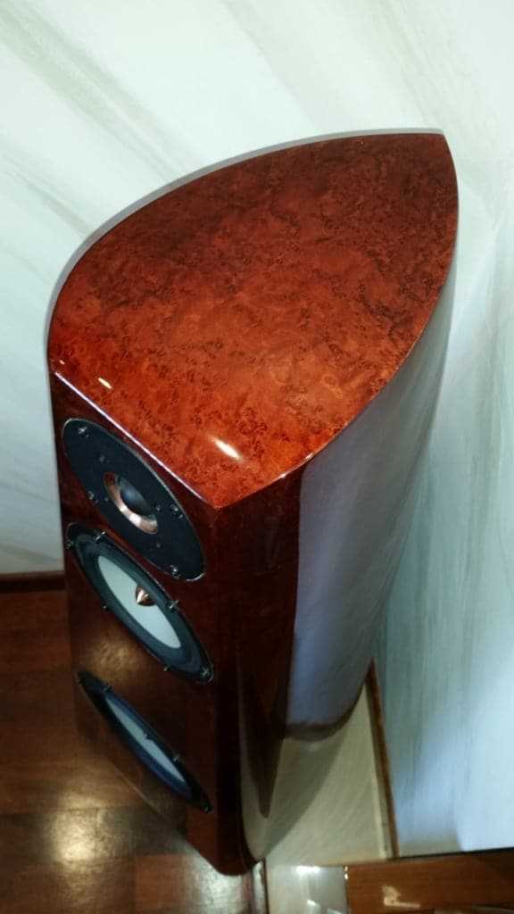

jororaitchev Napisano Januar 30, 2017 #1 Napisano Januar 30, 2017 Hello,the first project of my DIY loudspeakers i have served Ti6k- JBL. My first contact withthem, was in distant 2005.I started working with them in 2009 and finished in 2012.The loudspeakers are "SEAS"- Excel / Tw-1”, Mw-5”for center 2х 5.5”,Bass-8,5”/ and cross-over parts- "Intertechnik".Have are some pictures, if there is interest, i will continue.Regards! Dacho, grozni, kan042 and 6 ostalih je reagovao/la na ovo 9

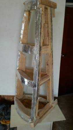

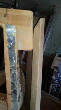

Dacho Napisano Januar 30, 2017 #3 Napisano Januar 30, 2017 14 minutes ago, jororaitchev said: Hello,the first project of my DIY loudspeakers i have served Ti6k- JBL. My first contact withthem, was in distant 2005.I started working with them in 2009 and finished in 2012.The loudspeakers are "SEAS"- Excel / Tw-1”, Mw-5”for center 2х 5.5”,Bass-8,5”/ and cross-over parts- "Intertechnik".Have are some pictures, if there is interest, i will continue.Regards! Very nice... Why are you put aluminium foil on the interior construction?
jororaitchev Napisano Januar 30, 2017 Autor #4 Napisano Januar 30, 2017 9 minutes ago, Dacho said: Very nice... Why are you put aluminium foil on the interior construction? Thank you for the good evaluation of my work! I have no idea what al. foil talk about!!
Zen Mod Napisano Januar 30, 2017 #5 Napisano Januar 30, 2017 he meant on that shiny thing on box skeleton it looks as aluminium foil
jororaitchev Napisano Januar 30, 2017 Autor #7 Napisano Januar 30, 2017 5 minutes ago, Zen Mod said: he meant on that shiny thing on box skeleton it looks as aluminium foil Well, a more foil... hifish je reagovao/la na ovo 1

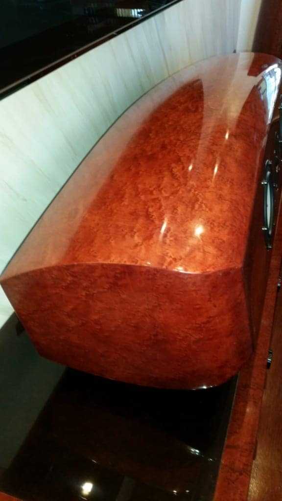

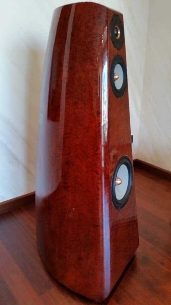

sir Oliver Napisano Januar 30, 2017 #14 Napisano Januar 30, 2017 Mного хубаво. Kойто фурнир употреба? Kак като готови гланц?
Deyan Napisano Januar 30, 2017 #16 Napisano Januar 30, 2017 Molim administraciju da izbrisu link iz mog predhodnog posta. Hvala
jororaitchev Napisano Januar 31, 2017 Autor #17 Napisano Januar 31, 2017 6 minutes ago, sir Oliver said: Mного хубаво. Kойто фурнир употреба? Kак като готови гланц? Благодаря за оценката! Вече не знам, на какъв език да пиша? Фурнирът е "Птичи явор" / Bird maple/ .Обработката /The finish/ е, майка ми жална, 6,7 слоя /coats/ полиуретанов грунд и над 20 слоя висококачествен акрилен авто лак, с полиране след всеки слой. Ако не сте разбрали нещо , ще Ви пиша на английски. Поздрави, Жоро

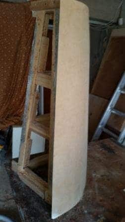

Dacho Napisano Januar 31, 2017 #20 Napisano Januar 31, 2017 7 hours ago, jororaitchev said: Thank you for the good evaluation of my work! I have no idea what al. foil talk about!! On the first picture...
jororaitchev Napisano Januar 31, 2017 Autor #21 Napisano Januar 31, 2017 15 hours ago, Dacho said: On the first picture... The first image is a "matrix" of her bending 8 layers x 4 mm MDF/ she did not participate in the construction/. This aluminum foil is to not to to be glued the layers in bending. Sorry, I do not understand!
