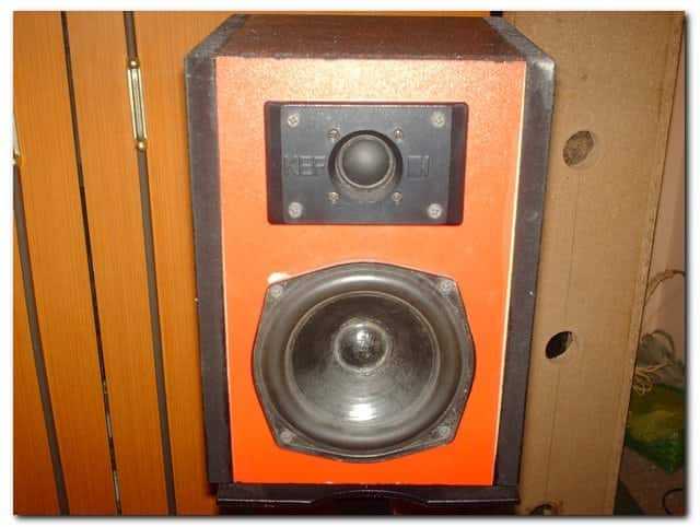

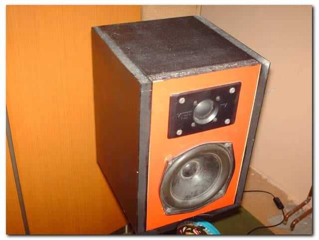

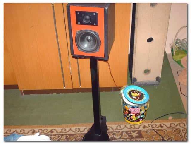

2a3 Napisano April 28, 2013 Share #129 Napisano April 28, 2013 Evo i moj skromni doprinos kef b110 bas reflex odpozadii dimenzije 28x19x2o cm. Link to comment Podeli na ovim sajtovima More sharing options...
