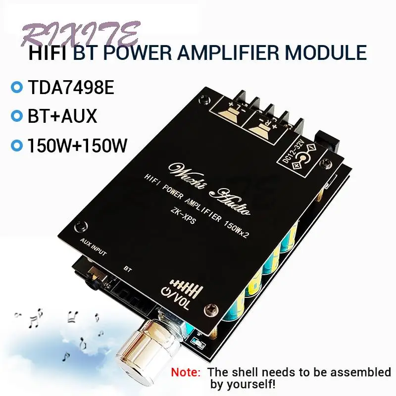

NIXIE Napisano April 29, 2022 Share #6 Napisano April 29, 2022 Evo imaš ovako nešto jeftino. 2*150W Bluetooth 5,0 dual channel hifi audio power verstärker modul stereo TDA7498E verstärker bord audio heimkino AUX XPS|Amplifier| - AliExpress WWW.ALIEXPRESS.COM Smarter Shopping, Better Living! Aliexpress.com Link to comment Podeli na ovim sajtovima More sharing options...
