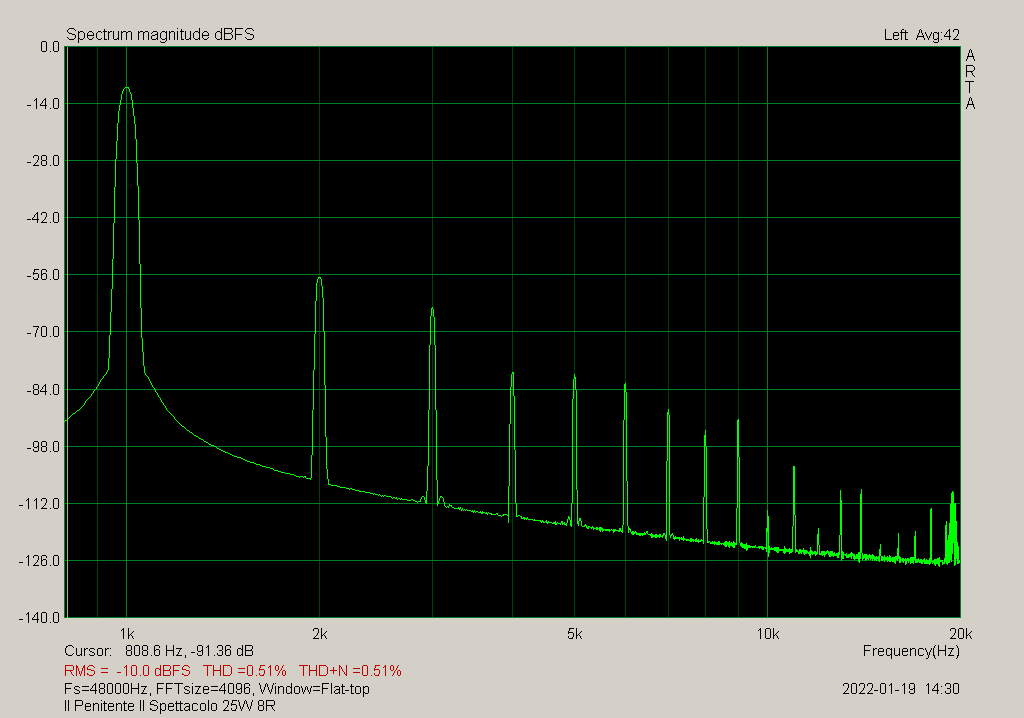

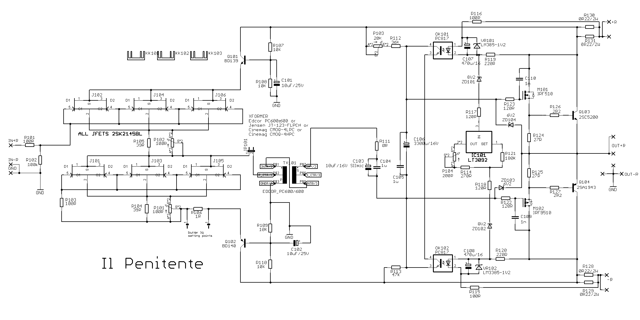

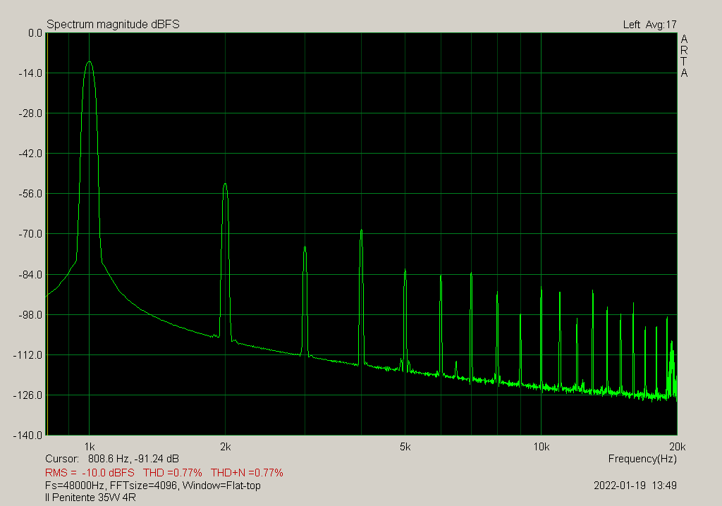

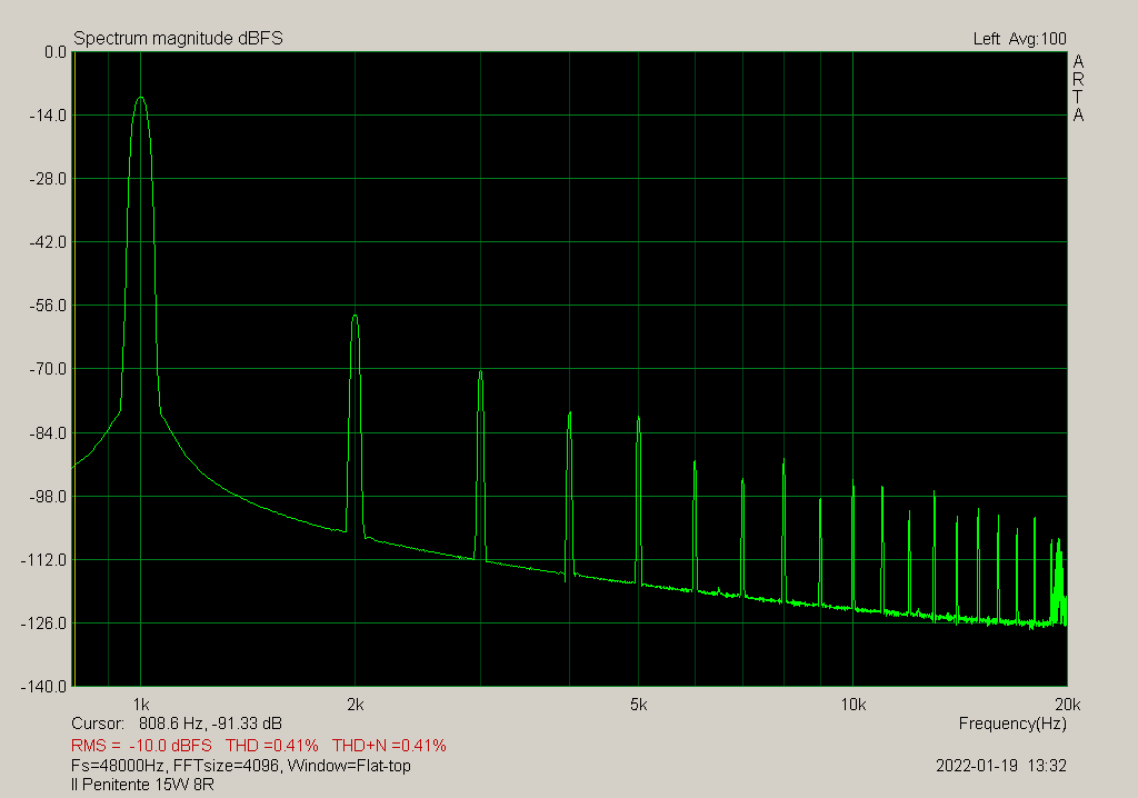

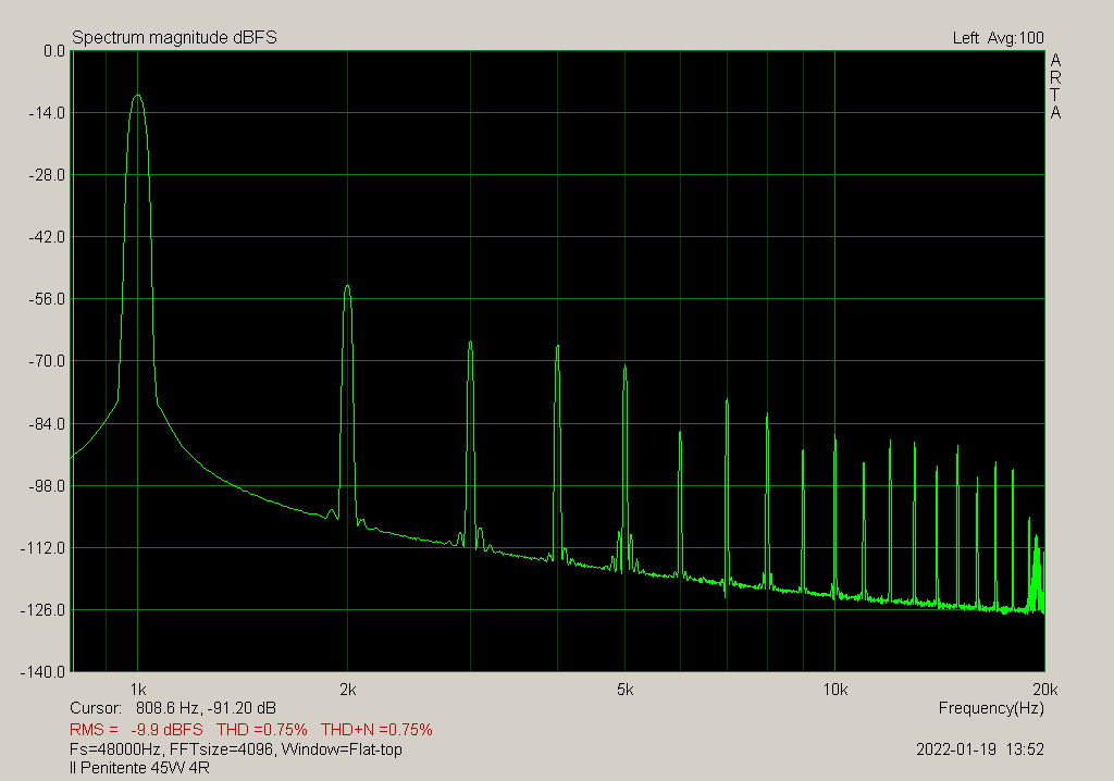

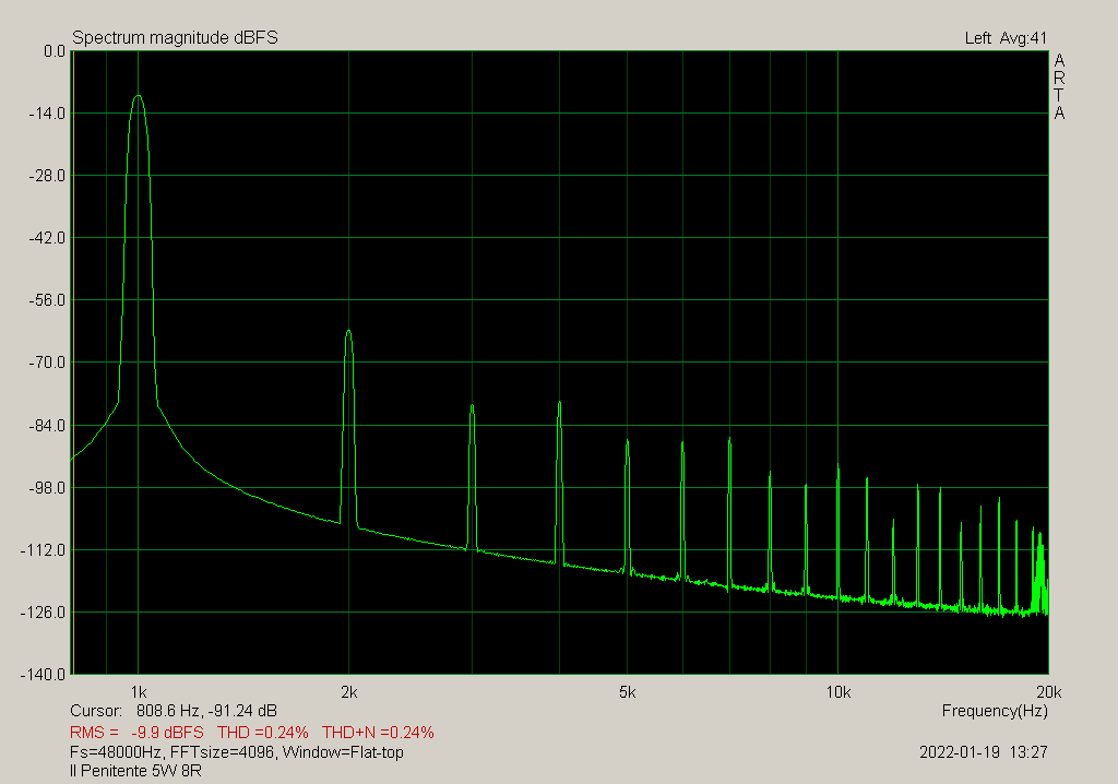

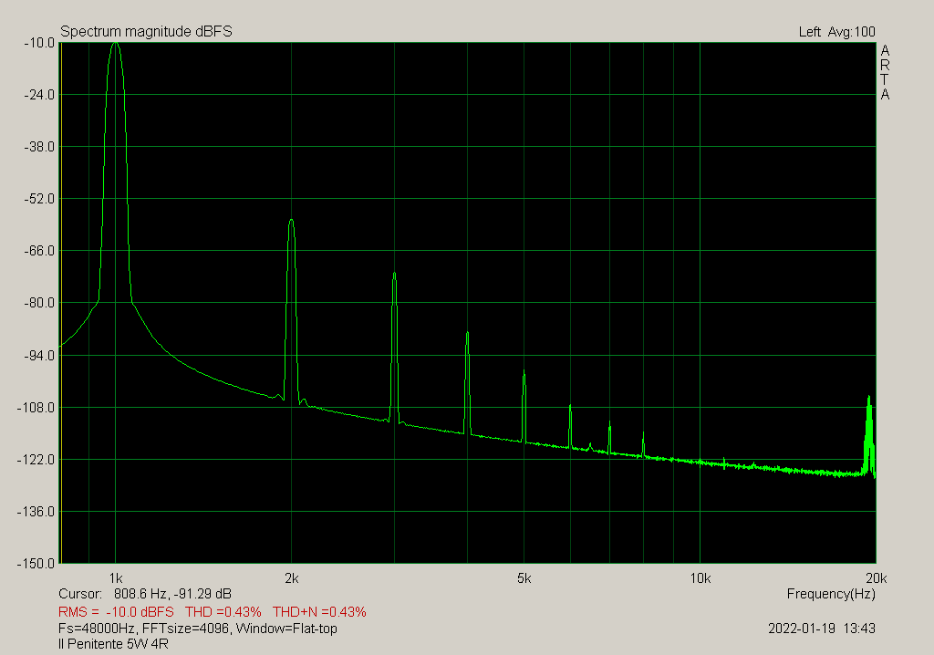

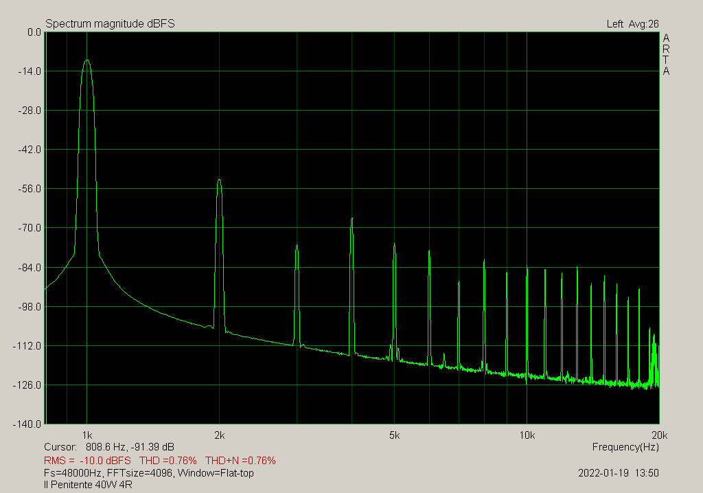

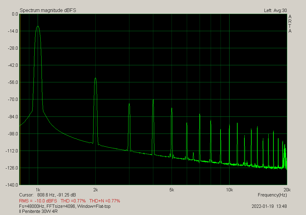

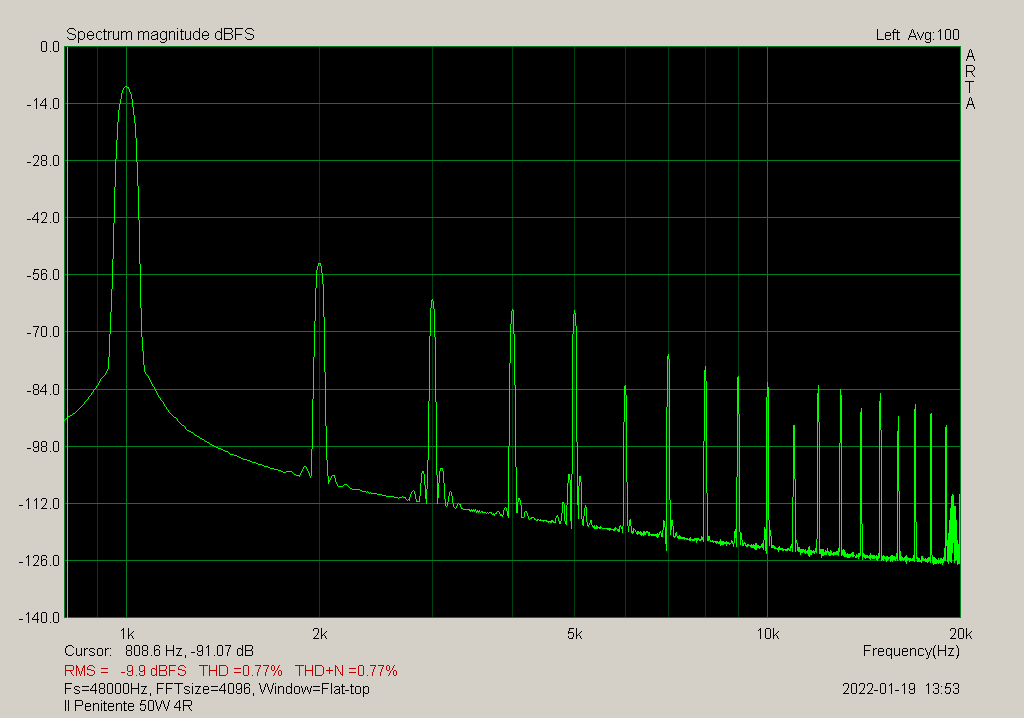

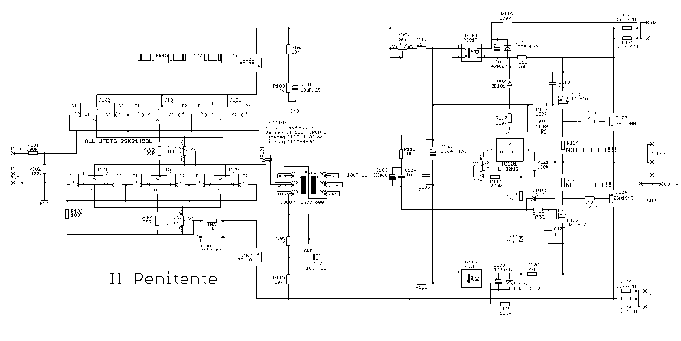

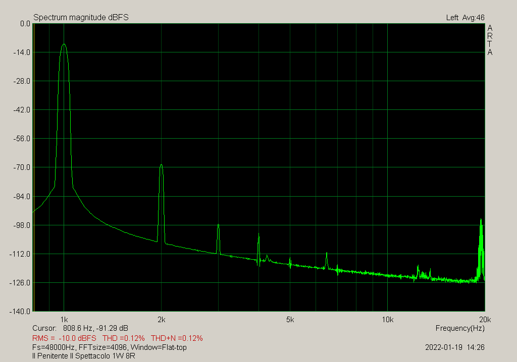

Zen Mod Napisano Januar 19, 2022 #1 Napisano Januar 19, 2022 kao i uvek, lenj da kucam ponovo, pa copy-paste sa Big DiyA: yup, as I said , bad influence of Cyclotron emanation , all the way from Bubba Bob's Davis ...... 'Talian names popping as mushrooms after the rain anyway, what's better to put on pizza than mushrooms ....... So, last one in series of autoformer gain amps (you can call them all - M2 on Mushrooms ) , this one differing on outputs being classic BJT complementary pair, so sorta blasphemy in Papaland ......... he sinned heavily eons ago ....... while my Sin is recent........ Anyway, here's funny diagram, showing nothing else than bunch of multilegged fuses and some nice iron hm, yes, my prototype equipped with first genuine ones I snatched from drawer - 2SA1491/2SC3855 ....... but pretty much any "for Audio amp" complementary pair should work well ........ 2SA1943/2SC5200 , TTA/TTC (newest Toshiba incarnation of 2SA/2SC) rails +/-23V, Iq 1A5 2nd is clearly neg phase, not seen from my gigglywiggly, but I stumbled on nice routine in LTSpice showing just that behavior and didn't yet found reason to doubt it shonne and Vix je reagovao/la na ovo 1 1
Zen Mod Napisano Januar 19, 2022 Autor #2 Napisano Januar 19, 2022 some funny pics from my workbench Mikorist, John Coltrane, dejanco32 and 3 ostalih je reagovao/la na ovo 2 3 1

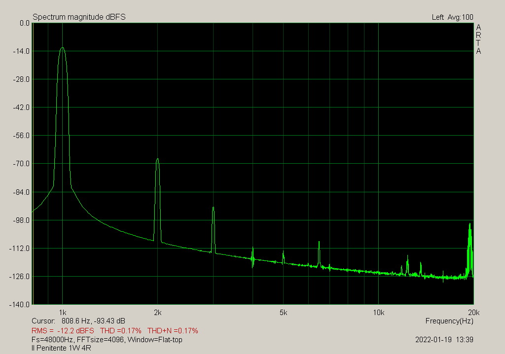

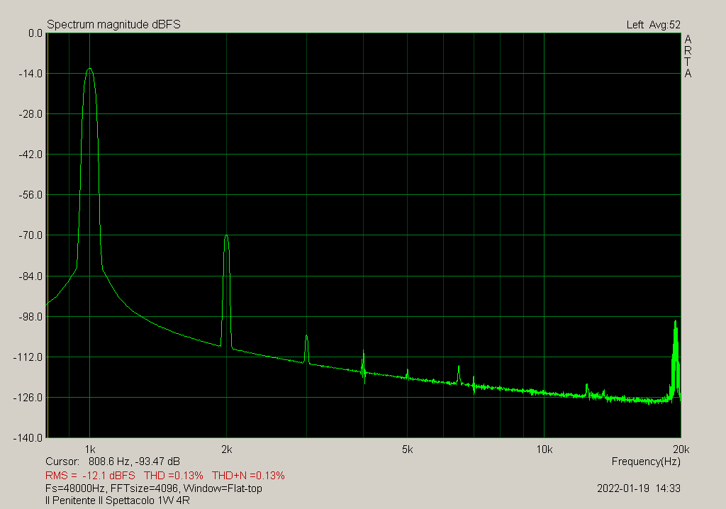

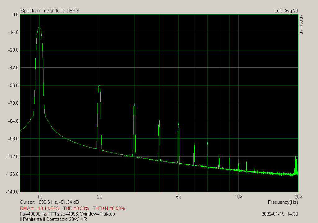

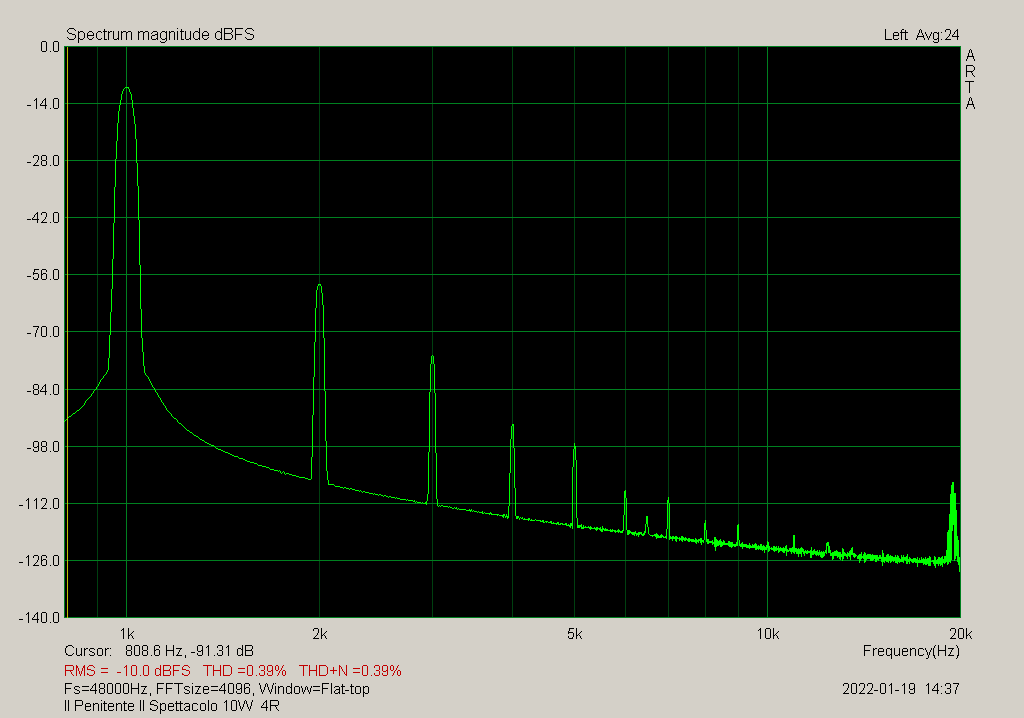

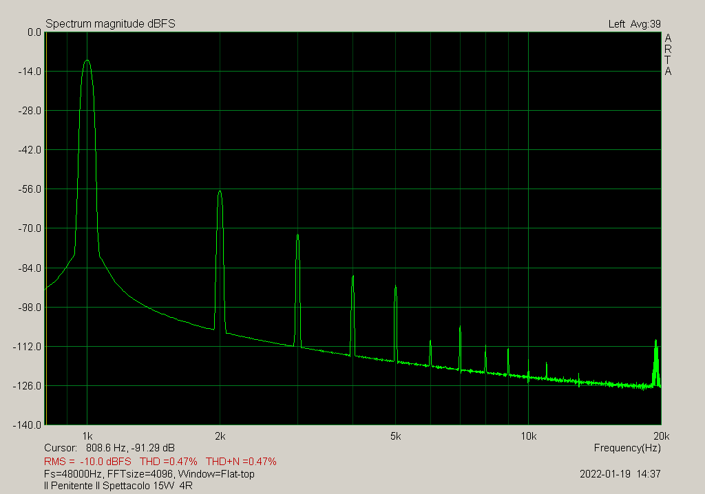

Zen Mod Napisano Januar 19, 2022 Autor #5 Napisano Januar 19, 2022 Ok , that's it ....... Pretty straightforward..... nice SETish THD spectra ....... but wait !! There is also Il Penitente - Il Spettacolo!!! zerowaf je reagovao/la na ovo 1

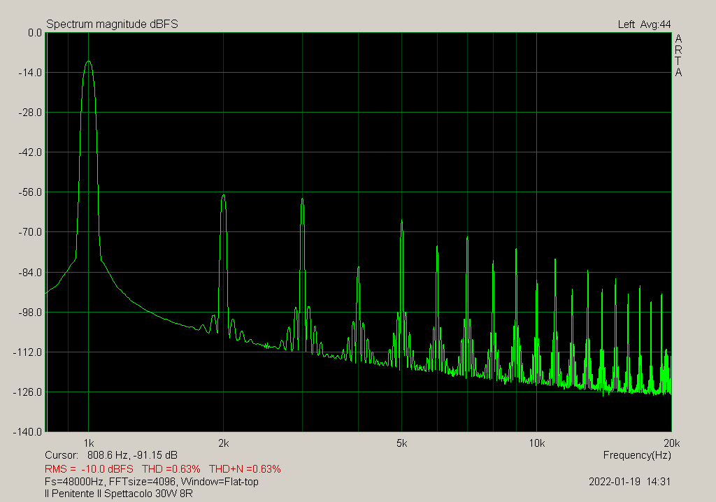

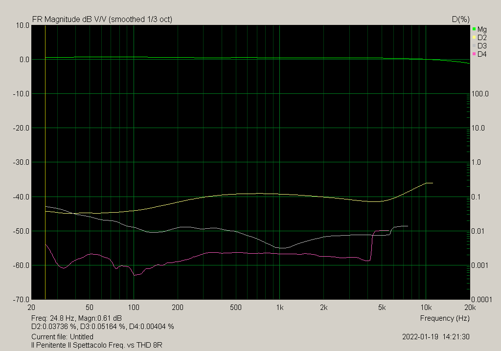

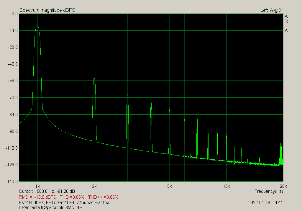

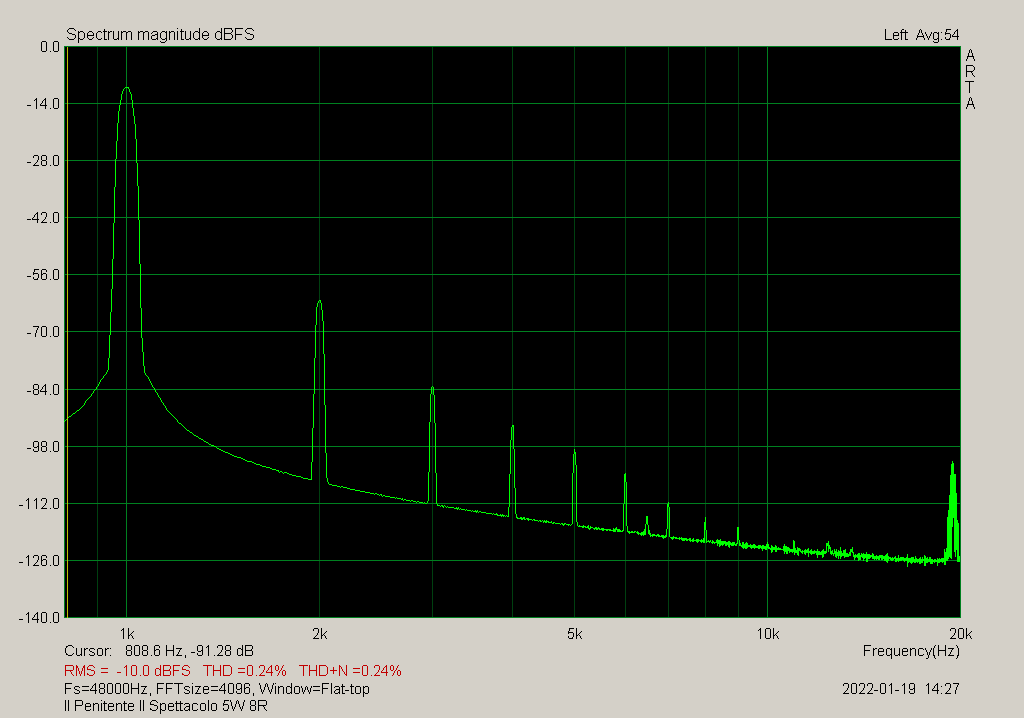

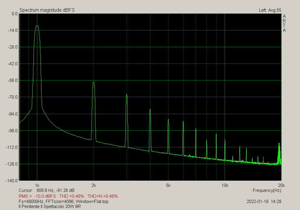

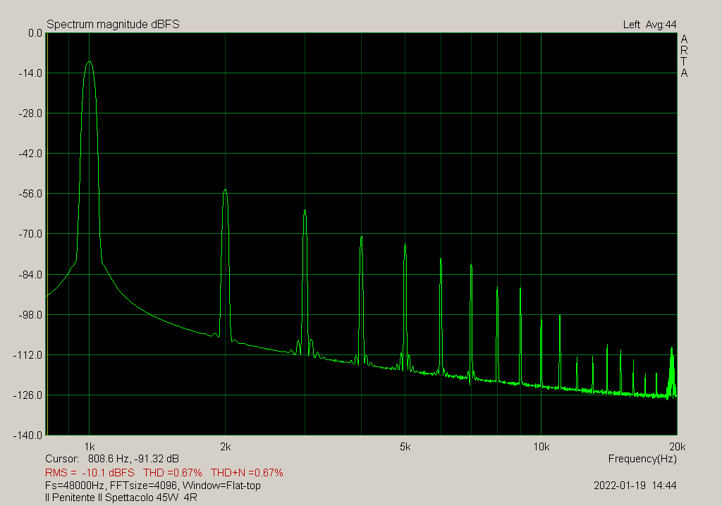

Zen Mod Napisano Januar 19, 2022 Autor #6 Napisano Januar 19, 2022 Now - Il Penitente Il Spettacolo is wakoo iteration with special parts in output stage we can call then Insulated Gate Bastard Transistors ........ made simply by tossing out source resistors of TO220 mosfets, so mosfets are covering just base current of output BJTS here's schm shonne and Vix je reagovao/la na ovo 1 1

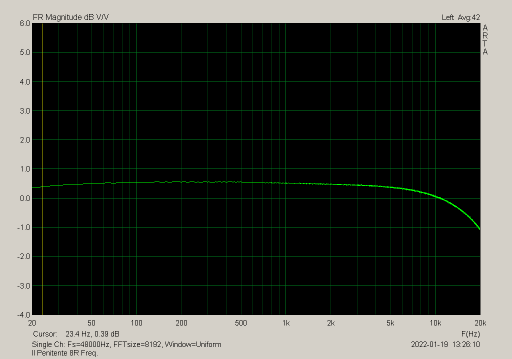

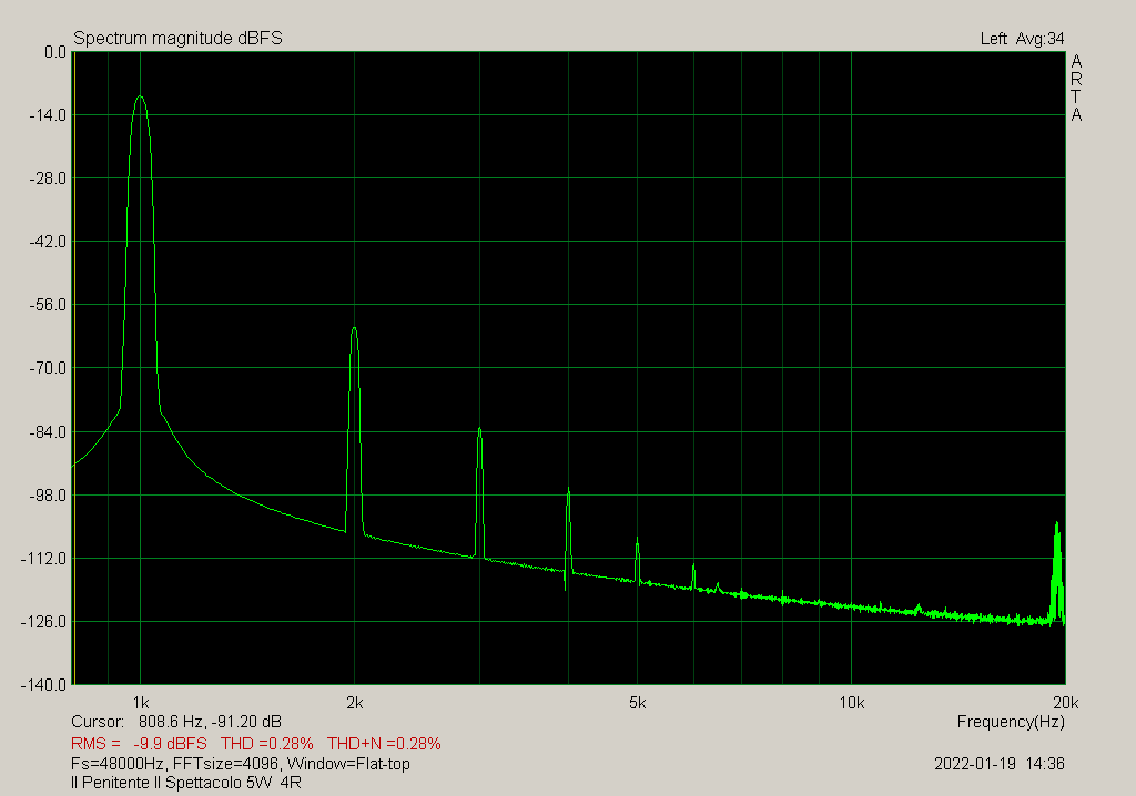

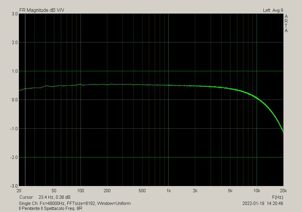

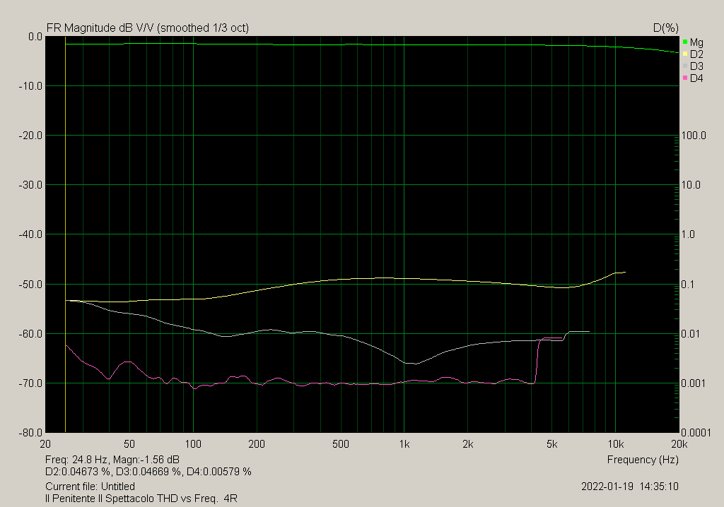

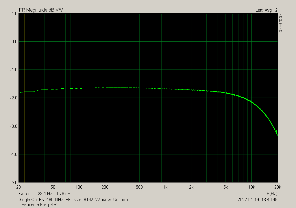

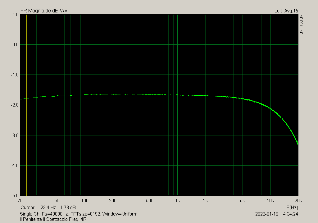

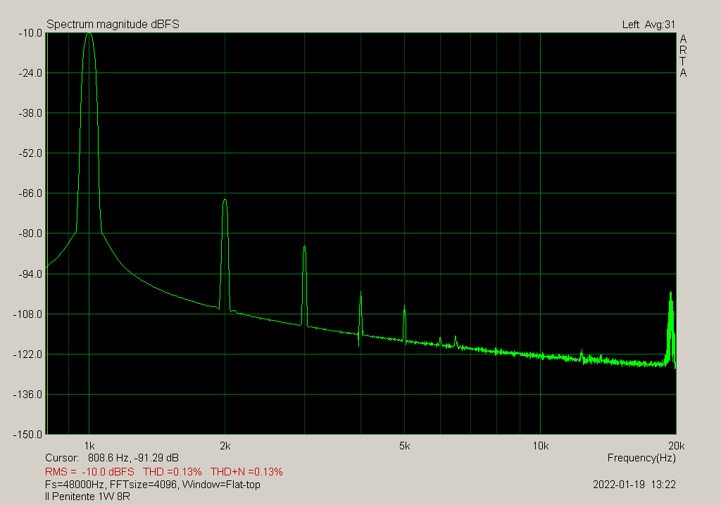

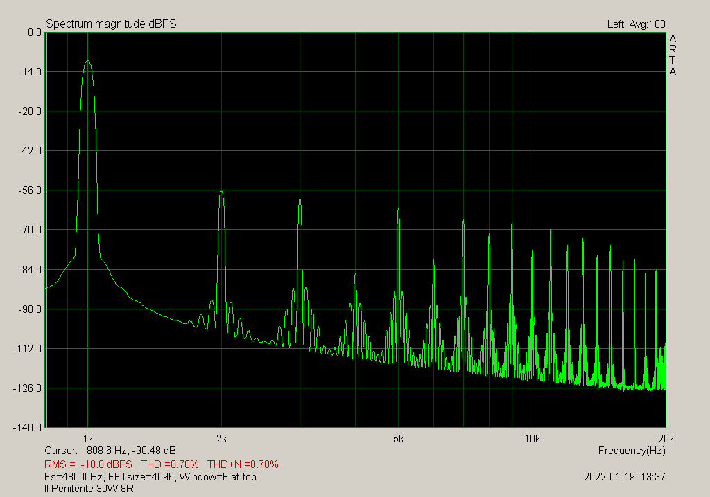

Zen Mod Napisano Januar 19, 2022 Autor #7 Napisano Januar 19, 2022 graphs, 8R load difference to boring regular Il Penitente is - more uniform THD Spectra on all power levels

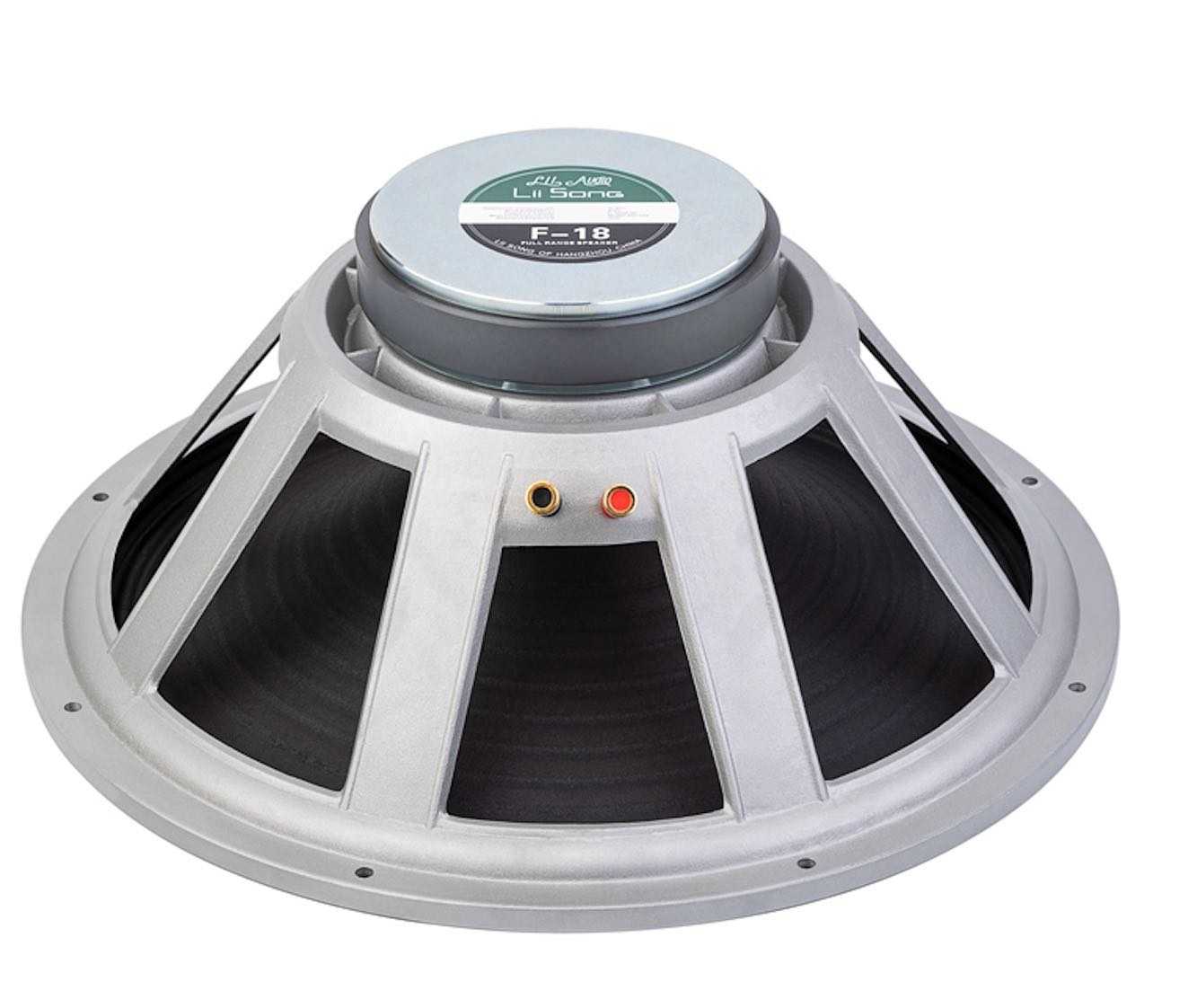

Mikorist Napisano Januar 19, 2022 #21 Napisano Januar 19, 2022 Ja sam poludeo sad da nabavim ove FR od 18 inča zerowaf je reagovao/la na ovo 1
Mikorist Napisano Januar 19, 2022 #22 Napisano Januar 19, 2022 Znam pitaćeš me da slikam korpu sa strane.... Aha liveni gus
