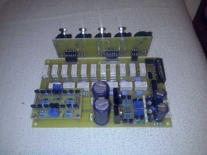

  10. shonne
    JC-80, UGS
    kako izgleda kad se stavi modul.

    Sad jasno... za neupucene. Where aswitch contains both normallyopen (NO) and normallyclosed (NC) contacts, theorder inwhich they make and break can be significant. Inmost cases, therule is break-before-make or B-B-M ; thatis, theNO and NC contacts are never simultaneously closed during thetransition between states. Thisisnot always the case, Form C contacts follow this rule, while theotherwise equivalent Form D contacts follow theopposite rule, make before break. The less common configuration, when theNO and NC contacts are simultaneously closed during thetransition, ismake-before- breakor M-B-B Mi kad smo pustili u rad uc controler, on koliko videli MBB ima podesavanja u us...nismo testirali vec videli samo da ima ta opcija. Ono sto sledi jeste pustanje u pogon svih delova i onda igranje sa tim.

    à Mbb turn Off delay (Play on the switching time of the volume relays, and minimize clocks at the volume setting). à Mbb turn On time (The volume relays are activated one after the other, with an adjustable time interval. It allows to refine the previous setting if necessary.) je li to ovo?

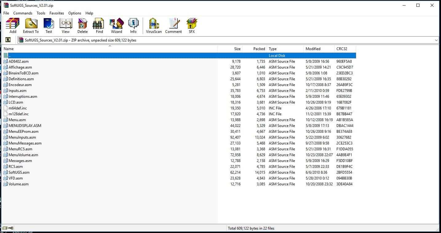

    da ne ulazim u nesto sto me ne interesuje, samo nfo i prestajem. ovde ima ceo source, pa kome nije gadljivo da modifikuje za svoje potrebe, moze da dobije jednu lepu celinu.

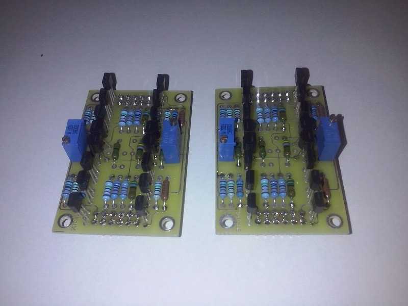

    i ono zasto je sve ovo pocelo, UGS moduli.
