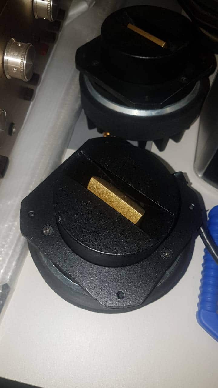

I can only tell you one more time,
the tweeters are working.
I got some JBL Monitors L-65, 4333, 4343 and 4315 with the same tweeters and they sound semilar to them.
I bought the pair as backup, but they do not look like as descripted. They was descripted as all alnico inside.
a par poruka prije kaže da nije tehničar i da nezna otvoriti kučište
No, i do not open anything.
I'm no technican. Sorry
