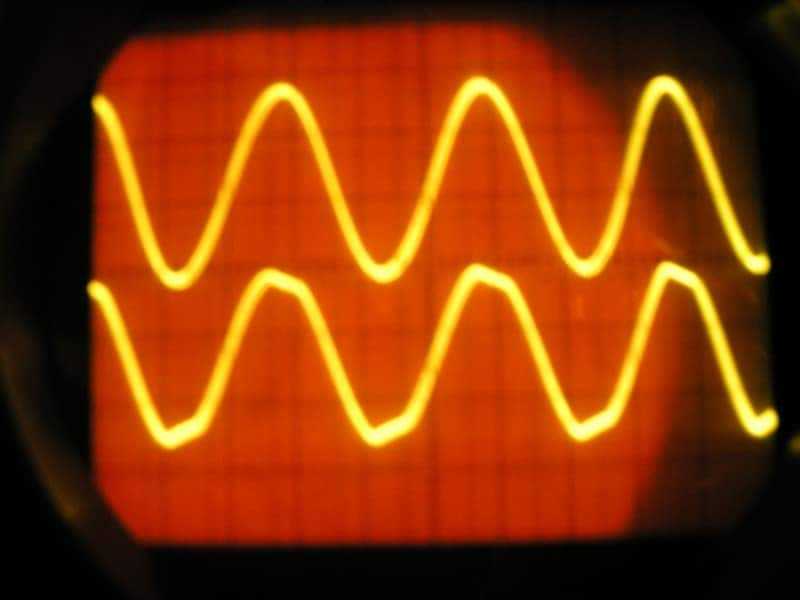

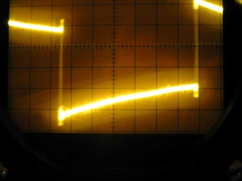

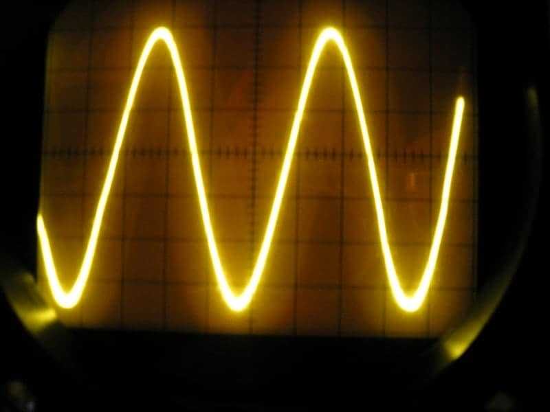

Magura Napisano Januar 25, 2010 Autor Share #423 Napisano Januar 25, 2010 I figured that today was a real good day to get the scope running. Every time I power it up, I wonder why it still works, but then again, it's been working for a few decades, so why shouldn't it work for another decade? First 20Hz square into 8R. This is actually better than I expected it to be. I aimed for things going south below 30Hz, and even at 20Hz it's actually fair enough.Second is a 20hz sine into 8R, nothing to complain too loud about.The rest from 30Hz to 20KHz was relatively boring, as it's simply as it should be Magura Link to comment Podeli na ovim sajtovima More sharing options...
Zen Mod Napisano Januar 25, 2010 Share #424 Napisano Januar 25, 2010 man - that's fookin' great - I mean that 20HzSQ pic besides that - how's square looking right from 20 Hz ?with just little more tweaking ( you know what Kwayzeedanske ), we can tell that we create monster :blush:Upp values ? Link to comment Podeli na ovim sajtovima More sharing options...
Ја sam sam Napisano Januar 25, 2010 Share #425 Napisano Januar 25, 2010 2nd pic looks fine but, intensity is too high of scop!стоН_Колд Link to comment Podeli na ovim sajtovima More sharing options...
Zen Mod Napisano Januar 25, 2010 Share #426 Napisano Januar 25, 2010 ..... intensity is too high of scop!стоН_Колдyou can't say that just from pic , especially when Magura is using it (camera) Link to comment Podeli na ovim sajtovima More sharing options...
Magura Napisano Januar 25, 2010 Autor Share #427 Napisano Januar 25, 2010 man - that's fookin' great - I mean that 20HzSQ pic besides that - how's square looking right from 20 Hz ?with just little more tweaking ( you know what Kwayzeedanske ), we can tell that we create monster :buehehe:Upp values ?I have no idea why it accepts 20Hz It should maximum accept some 25Hz, best case scenario, so don't ask me Yeah, thermistors are on their way. Magura Link to comment Podeli na ovim sajtovima More sharing options...
Magura Napisano Januar 25, 2010 Autor Share #428 Napisano Januar 25, 2010 2nd pic looks fine but, intensity is too high of scop!стоН_КолдYou're perfectly right Ston. I turned up the intensity, to try to get some better pics. Obviously not a good idea, but as Choky already said, I'm a clown with a camera. Magura Link to comment Podeli na ovim sajtovima More sharing options...
Ја sam sam Napisano Januar 25, 2010 Share #429 Napisano Januar 25, 2010 You're perfectly right Ston. I turned up the intensity, to try to get some better pics. Obviously not a good idea, but as Choky already said, I'm a clown with a camera. Magura :buehehe: стоН_Колд Link to comment Podeli na ovim sajtovima More sharing options...

AR2 Napisano Januar 25, 2010 Share #431 Napisano Januar 25, 2010 You're perfectly right Ston. I turned up the intensity, to try to get some better pics. Obviously not a good idea, but as Choky already said, I'm a clown with a camera. Magura You could achieve a same effect you have darker screen and longer exposure. That way you will have a less blooming, sharper picture and exposure time will be your control of brightness. Obviously for that you should have a small tripod to put your camera on if the exposure time is longer than lets say 1/30sec. Link to comment Podeli na ovim sajtovima More sharing options...

Magura Napisano Januar 26, 2010 Autor Share #438 Napisano Januar 26, 2010 First 20Hz square into 8R. This is actually better than I expected it to be. I aimed for things going south below 30Hz, and even at 20Hz it's actually fair enough.Magura Hmm, seems like me culpa. The square is not 20Hz, but 25Hz, which makes a lot more sense. According to the calcs I've made, it sure does not do 20Hz in a reasonable way.20Hz sine is no problem though.Magura Link to comment Podeli na ovim sajtovima More sharing options...
