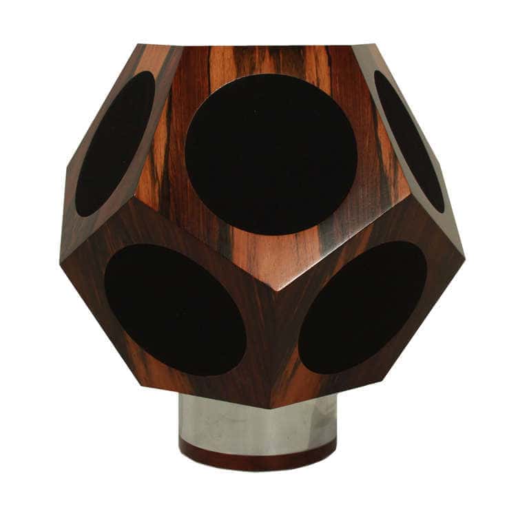

Postavljena slika
Ispuna se radi sa nekom mineralnom vunom koja nema da se kupi kod nas..neki novi Knauf ...izgleda jako neobično i dobro... Stavlja se samo po zidovima kutije...

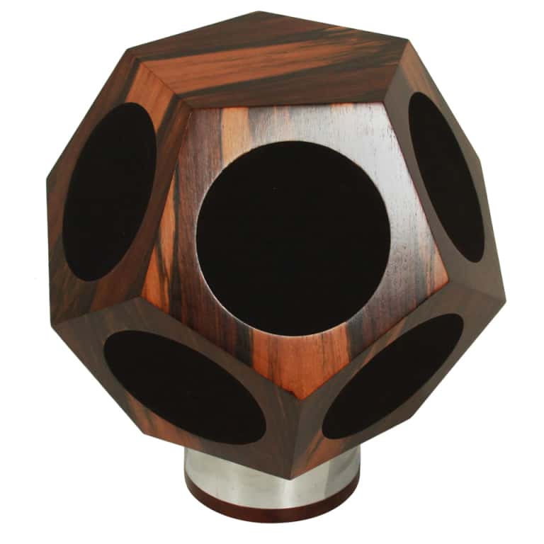

Postavljena slika
Све ми се чини да ћеш скроз загушити кутије, али је сасвим могуће да грешим. Без обзира на све, заиста изгледају изузетно добро.
Neću, stavlja se samo na zidove-vuna će doprineti da zvučnik 'vidi' veću zapreminu. Naravno, vuna se može zbog rupa staviti samo u prve dve komore...
Koje su dimenzije,da li postoji nacrt na netu kako se ovo pravi?I kako se uopste zove ovaj kabinet da bi potrazili?
Neznam , ja sam samo dobio čast da ih finiširam :)  Raspitaću se :)
Da nema pregrada i da ispunis celu kutiju ravnomerno onda bi vido vecu zapreminu, ovako ako stavis samo na zidove ne znam uopste kakvog uticaja ce imati
Naravno da će imati uticaja a kakvog to ćemo čuti :)

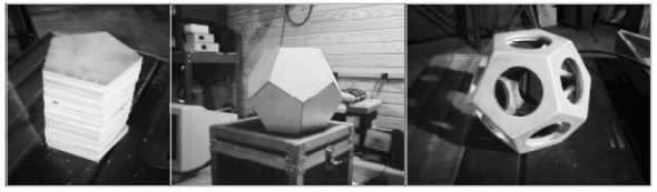

Postavljena slika
Building a Dodec
[*]1. Start by cutting a 7.5 inch length off of a 4’ x 8’ sheet of birch plywood. A table saw or panel saw works well for this purpose.
[*]2. Use a table saw to slice the board into 7.5 inch squares. Twelve will be required.
[*]3. This step is critical. A compound miter saw is suggested. If you don’t own one, they can be rented at the local rental house, since carpenters require them for installing crown molding. Set the saw for an 18 degree angle (900 – 720) and proceed to cut the squares into pentagons. I simply marked the saw guide at 4.5 inches with a pencil and rotated the square after cutting each face.
[*]4. To cut the correct bevel on the pentagon sides, set the vertical angle of the saw at 33 degrees ((1800 – 1140)/2), keeping the horizontal angle at the original 18 degrees. Recut each side using this setting. While it would be possible to make both cuts at once on the squares, I found it easier to control the saw by breaking it down into two steps.
[*]5. The pentagons are now ready to assemble. Clamp one down to a firm work surface and see if the others fit together correctly. They should if you have done everything correctly up till this point. I used a 1.25 inch brad nailer (air powered) to assemble the sides. Apply wood glue liberally to both surfaces prior to nailing. Internal braces should not be necessary, since the very nature of the shape makes it nearly impossible to com- press the dodec or pull it apart.
[*]6. Use a 4-inch hole saw to cut the loudspeaker holes. I went a step further and recessed the loudspeakers using a router. If you are going to do this, I recommend finding some round loudspeakers. The stamped-frame units that I used were more rectangular in shape, which required me to make a router template.
[*]7. The loudspeakers must be wired in a series-parallel configuration to get a total impedance close to 8 ohms. See the wiring diagram (Fig. 1). The actual impedance was about 6 ohms, which should work with virtually any power amplifier.
Postavljena slika
