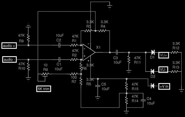

  9. Beli_Ninja
    Sony CDP-M18
    Evo sheme
