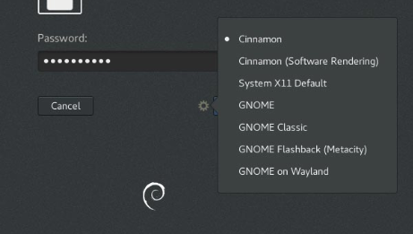

Mikorist Napisano Jun 14, 2019 Share #118 Napisano Jun 14, 2019 Nije velika mudrost sudo apt-get install cinnamon I onda pre nego se uloguješ izabereš Link to comment Podeli na ovim sajtovima More sharing options...

Mikorist Napisano Jun 14, 2019 Share #120 Napisano Jun 14, 2019 Iskopah i ovaj sa full firmware https://cdimage.debian.org/cdimage/unofficial/non-free/cd-including-firmware/9.9.0-live+nonfree/amd64/iso-hybrid/debian-live-9.9.0-amd64-cinnamon+nonfree.iso Jedina vizuelna razlika je što ne piše Mint. Ali je ispod haube full debian Link to comment Podeli na ovim sajtovima More sharing options...
