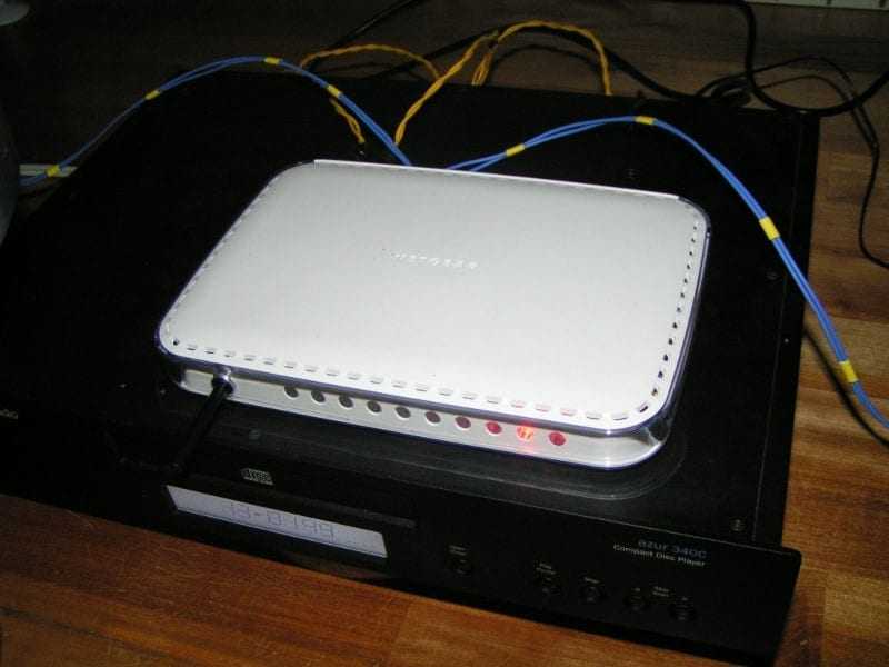

I guess it's time you get a laugh on me :blackeye: I had a friend visit me, whom had been given a B4 by Nelson Pass. I put it in my system, just using the buffer (B1), and switched off the rest of the circuit.I kinda liked the sound of it, so built a B1 an afternoon, a couple of days ago. Care for a B1 in a gutted ADSL router :angel0: Magura :confused1:
Soooo, did the "Netgear" die on you? I have one in the workshop and just might "aid" a bit to make it reusable for something... :blackeye: I suppose that's all we will hear about B4 here as well... Nothing more specific on Big DIYA still... :confused1:
The Netgear was struck by lightning. It sure didn't like that treatment :blackeye: The PSU survived though, and 15V is fine for a B1, so I simply just replaced the innards of the box, and added a few holes.What do you wanna know about the B4? I took the liberty to pop the hood of it, and will get the manual in a couple of days.Magura :confused1:

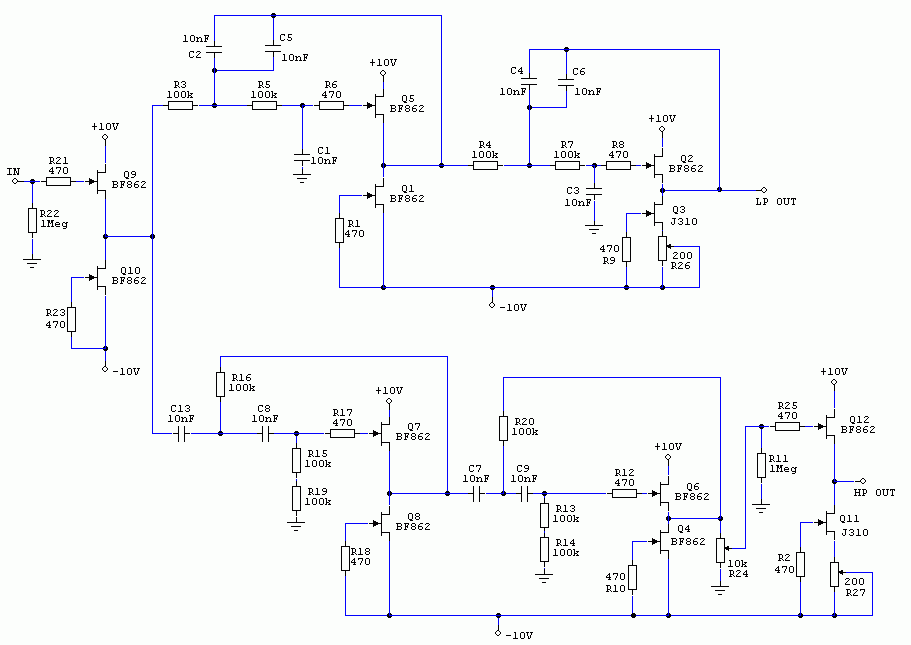

Oh, then, no thanks, keep the lightning :angel0:I would like to compare it with what I am about to put together... Probably two pigs from different farms, but...post-13-126401157162_thumb.gif
