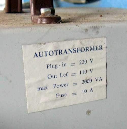

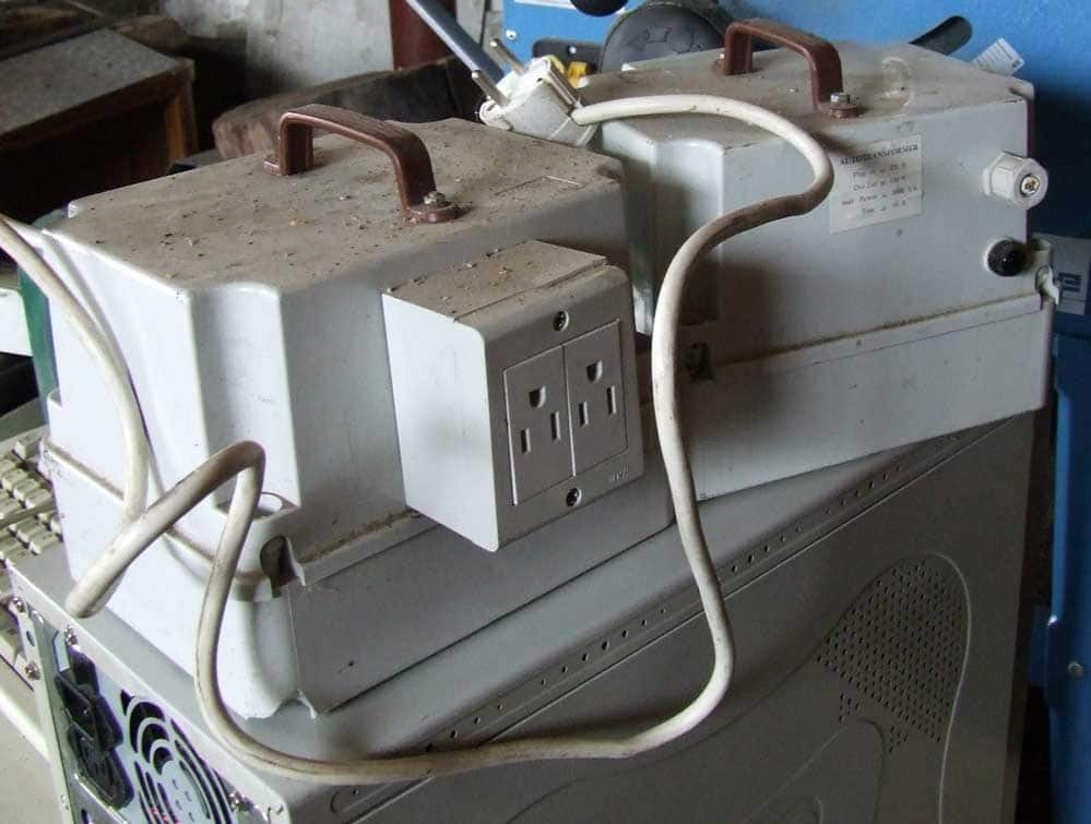

Zen Mod Napisano Decembar 25, 2009 #309 Napisano Decembar 25, 2009 just as a reminder ....... when schematic was born :character13:even if case was started years ago ........ :)http://www.diyaudio.com/forums/pass-labs/133433-choky-susy-f3-lu1014s.htmlthere is a pic of two of my big boyz ....... not some wussy round thingies of 25 killos big boyz - courtesy of Zflazar
Aleksandar Car Napisano Decembar 25, 2009 #310 Napisano Decembar 25, 2009 Is right one bayed on the "fast market"??? Nice work with knife!
Magura Napisano Decembar 25, 2009 Autor #311 Napisano Decembar 25, 2009 there is a pic of two of my big boyz ....... not some wussy round thingies of 25 killos big boyz - courtesy of ZflazarHey that's pretty cool ....and they're connected in the amp the same way as mine Now refresh my memory, they were like 2kVA?Magura
Zen Mod Napisano Decembar 25, 2009 #312 Napisano Decembar 25, 2009 Hey that's pretty cool ....and they're connected in the amp the same way as mine Now refresh my memory, they were like 2kVA?Magura lazy Metaldanske ....... :(here it is : http://www.diyaudio.com/forums/pass-labs/133433-choky-susy-f3-lu1014s-7.html#post1744811(yup = same way connected as yours)

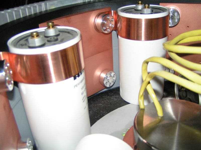

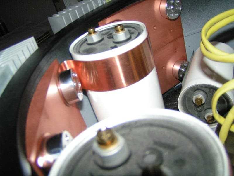

Magura Napisano Decembar 25, 2009 Autor #316 Napisano Decembar 25, 2009 I got the capacitors mounted yesterday. It may look simple, but making 2 holes and 3 radius line up with 2 angles....by hand Magura
Daudio Napisano Decembar 25, 2009 #317 Napisano Decembar 25, 2009 I got the capacitors mounted yesterday. It may look simple, but making 2 holes and 3 radius line up with 2 angles....by hand Magura I have no comment for perversion
Sipi Napisano Decembar 25, 2009 #318 Napisano Decembar 25, 2009 I got the capacitors mounted yesterday. ...Magura why do you want to cook RIFAs? They can take it - that's for sure, but they'll last longer if you give them a (thermal) break
Sipi Napisano Decembar 25, 2009 #320 Napisano Decembar 25, 2009 Define "cook" ?Magura Maybe it's just the picture that creates such an impression, but it looks like the RIFAs are attached directly to heatsink - and knowing you, that heatsink is going to be hot :character13:I'd put some thermal isolation between the RIFAs and the heatsink - that will prolong ELKO's life significantly.
Zen Mod Napisano Decembar 25, 2009 #321 Napisano Decembar 25, 2009 that case will cook with 0,5KWit will be bored with wimpy 100W++ dissipation of Donut
Magura Napisano Decembar 25, 2009 Autor #322 Napisano Decembar 25, 2009 Maybe it's just the picture that creates such an impression, but it looks like the RIFAs are attached directly to heatsink - and knowing you, that heatsink is going to be hot :DI'd put some thermal isolation between the RIFAs and the heatsink - that will prolong ELKO's life significantly.Thanks for the hint. Usually you'd be right -but not in this case. Less than 10C above ambient according to my calcs. So the copper strips would actually be cooling the Rifa's.This is not my usual approach, as you have noticed, but in this case, it's an amp that's gonna stay in the living room, and the Mrs. should preferably stay as well Magura
Magura Napisano Decembar 25, 2009 Autor #323 Napisano Decembar 25, 2009 that case will cook with 0,5KWit will be bored with wimpy 100W++ dissipation of DonutI think you're not too far off. 0.5KW is about the limit for that case. That would be like 40C above ambient.Magura

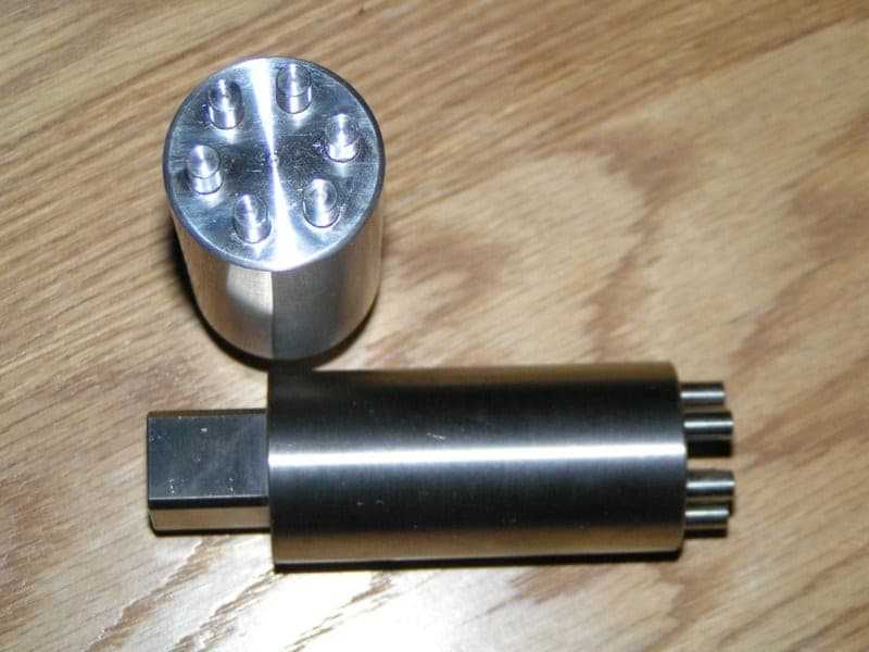

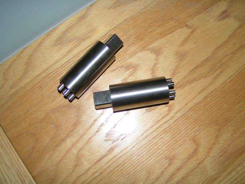

Sipi Napisano Decembar 25, 2009 #325 Napisano Decembar 25, 2009 .... and the Mrs. should preferably stay as well If that's the way the things are - you don't seem to have much choice :character13:But I wonder... women usually don't object the heat, it's the bulk that usually bothers them - big things use to scare them, and you got the opposite situation :rofl:BTW, I can't help admiring those crazy bolts you made, do you mind showing the screwdriver you use to handle them?
Magura Napisano Decembar 25, 2009 Autor #326 Napisano Decembar 25, 2009 If that's the way the things are - you don't seem to have much choice :character13:But I wonder... women usually don't object the heat, it's the bulk that usually bothers them - big things use to scare them, and you got the opposite situation Oh, the Mrs. is actively participating in designing and so forth, so no problem there......but she has little (ok, none) tolerance towards open wires that are powered, or if she risks getting burned or shocked in general.BTW, I can't help admiring those crazy bolts you made, do you mind showing the screwdriver you use to handle them?Thanks There you go. It's not really a screwdriver, but a set of sockets for a socket wrench. The bolts serve their purpose well. They take up less space, than any other standard bolt type I know of, and can be tightened to their max anyway. The only drawback they have, is that they're fiddly to get the socket into, but not an issue for those few bolts. They wouldn't fly in an industrial situation, unless there were no other options.Magura
Sipi Napisano Decembar 25, 2009 #327 Napisano Decembar 25, 2009 ...There you go. It's not really a screwdriver, but a set of sockets for a socket wrench....Lovely
bregar Napisano Decembar 25, 2009 #328 Napisano Decembar 25, 2009 Isti kao alat za Kia sigurnosni brezon za alu felne.
Ја sam sam Napisano Decembar 25, 2009 #329 Napisano Decembar 25, 2009 Isti kao alat za Kia sigurnosni brezon za alu felne.Можда му неко ради у "КИА Моторс"!?стоН_Колд
Sipi Napisano Decembar 25, 2009 #330 Napisano Decembar 25, 2009 Можда му неко ради у "КИА Моторс"!?стоН_КолдMa jok, na brezonu je sigurnosna matica a Magura je ovo napravio kao sraf - ima glavu a brezon nema, njemu je jedan kraj sa narezanim navojem a drugi se sastaje sa tockom.
