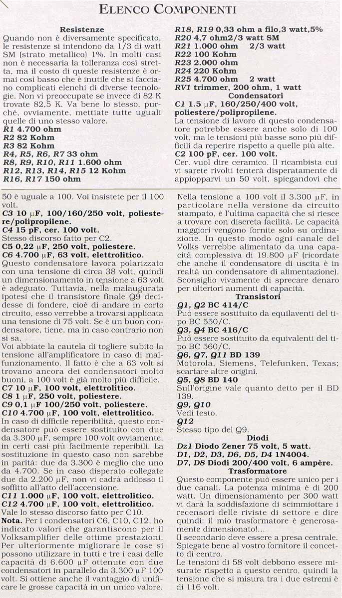

Mikorist Napisano Maj 28, 2012 Share #10 Napisano Maj 28, 2012 VolkAmplifier by Bartolomeo Aloia from 50 watt: ovo je sve bajato - tj. od 1999 : http://www.audiodesignguide.com/ba/ Link to comment Podeli na ovim sajtovima More sharing options...
