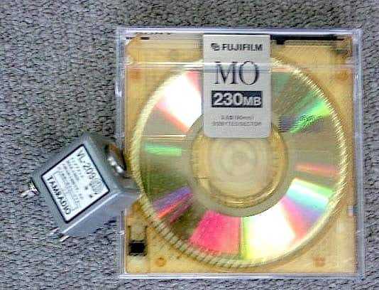

ZZZ Napisano Novembar 8, 2011 Share #26 Napisano Novembar 8, 2011 Iskopao sam, u PDF-u podataka sa ove adrese http://www10.big.or.jp/~dh/faq/vl/ . VL inductors Tamura.pdf Link to comment Podeli na ovim sajtovima More sharing options...
ZZZ Napisano Novembar 8, 2011 Share #27 Napisano Novembar 8, 2011 fotka Link to comment Podeli na ovim sajtovima More sharing options...

ZZZ Napisano Novembar 8, 2011 Share #32 Napisano Novembar 8, 2011 http://www10.big.or.jp/~dh/work/0101.html Tamura VL series are important devices for Sakuma, but Tamura stops production of VL series. Sakuma asked Tamura to design a new item instead of VL. Tamura's answer is an inductor SS-VL. 208, 209 and 210 split means it can be use as 1.1H, 3.0H and 7.0H. 1.1H is the minimum inductance of VL-208 3.0H is VL-209 and 7.0H is VL-210. SS-VL is not on the market and Tamura has no idea about it. ima i ovde nekih informacija http://www.audioasylum.com/forums/bottlehead/messages/2/23618.html http://www.audioasylum.com/forums/bottlehead/messages/2/23626.html http://www.audioasylum.com/forums/bottlehead/messages/2/23627.html . Link to comment Podeli na ovim sajtovima More sharing options...
