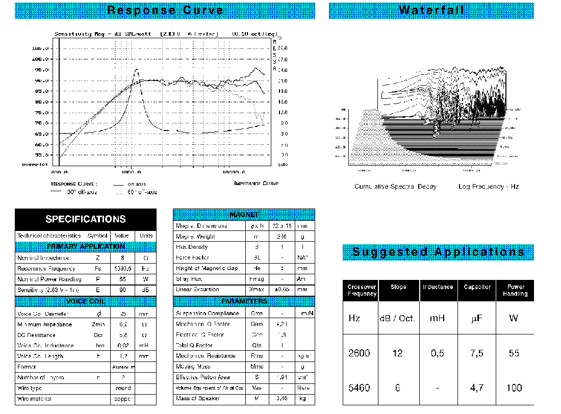

revox Napisano Novembar 19, 2012 Autor Share #84 Napisano Novembar 19, 2012 nalećeh na netu da je zamjena za originalni visokotonac za Tannoy M20 mk1 Audax-ov visokotonoac TW025A0 ja slučajno stavih TW025M3 koji je sličan AO kako kažu · Top-Quality 25 mm/ 1" Textile-Dome SILVER coated. · Newly developed “Catenary“-Profile, similar to the top of an egg with appropriate rigidity. · Additional magnet for slight shielding - differing from drawing! · Almost identical to TW025A0. · Response 3.000-20.000 Hz +- 2 dB. · SPECIAL from OEM-Industry-Production! · Nominal Impedance : 8 Ohm · Frequency Range : ab 2.500 Hz · SPL 2,83 V/1m : 92 dB · Fs : 1.500 Hz · Weight : 0,7 Kg Link to comment Podeli na ovim sajtovima More sharing options...
