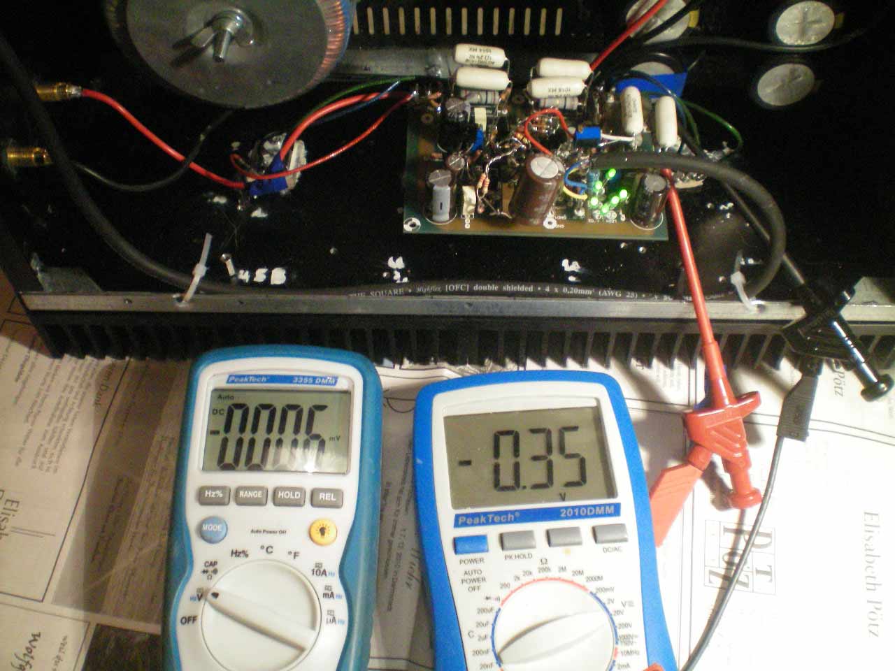

turn back R25 to zero , increase value of R26 for max 220R ( from 390 to ,say, 610-620 (whatever you have in drawer) ) ;
turn R25 up , to have 0 offset
set both Iq and offset - fiddling iteratively with R12 and R25
Tea - these are simple things
if you can't do it easily on Sunday afternoon - leave it for tomorrow
These are simple things :blink:
So I am at 680R for R26, and best offset so far is achieved with R25 at max, R12 at min.
Are you suggesting I try 220R for R26? :dubbio:
Sorry if I am coming across as dumbass. (true nature)

good news...after half an hour the optocoupling device tracks the current precisely and offset is stable around 1mV plus minus 5mVeven at 1,4 A and 6 times o,25 Ohm!@tea-bag: good luck and I hope the sound will change in the direction you want!
completely logical and in line what I'm writing all the time
nope - that will increase negative offset
what I said is " increase R26 for 220R"
not dumbass , but you're obviously working today without enough concentration
This still doesn't make sense to me. You mean R25 to 220R (max for it)??
My thinking tells me to use 1K instead of 680R, should get more wiggle room with R25 pot. 680R improved over 470R, which was improved over 390R original. OR I should try to swap R25 to 1K pot. This makes sense to me.... :frusty:
More resistance here has been dropping the offset, but not enough room to get near 0v. :P
Let me translate: Increase R26 for 220R = Increase R26 by 220R, as in "add 220R to R26"
