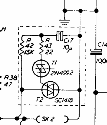

Tea-Bag Napisano Novembar 16, 2010 Share #658 Napisano Novembar 16, 2010 Guys, I get a little cone exursion during power on/off (full power) with BJ2. Is this going to be a problem if using lowthers? If so, I can put a ground lift switch to the speakers. It does not 'thump' Link to comment Podeli na ovim sajtovima More sharing options...
Zen Mod Napisano Novembar 16, 2010 Autor Share #659 Napisano Novembar 16, 2010 nope - it will not hurt your spksanyway - if you have precious spks - think about crowbar protection on spk cab terminals - no matter what amp are you using ( as long it is Solid State drek )you can always repair an amp , but spks are what's worthsee Quad 405 for crowbar schmtc Link to comment Podeli na ovim sajtovima More sharing options...
Zen Mod Napisano Novembar 16, 2010 Autor Share #660 Napisano Novembar 16, 2010 here it is in Q405 - small pcb ditto on output terminalsimilar parts :2N4992 BS 08ASC141B BS7-02A, MAC 216-4, Link to comment Podeli na ovim sajtovima More sharing options...
