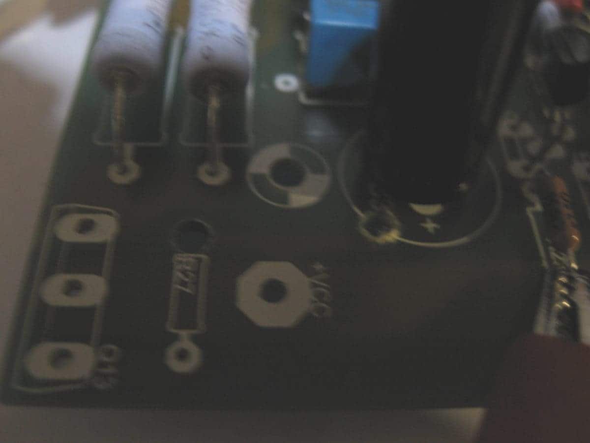

So this shows the mod I made to stop the short from happening. Other channel was fine. Sorry for the bad modified pic.The track looks plenty far away, so not sure what happened.Anyways, Q8 gets full voltage over it now, and things are looking good. :Viannen_loungelizard: The 2SJ's are still getting only 10.5v, should I add another LED on to add some voltage? Will it make a huge difference sonically? Maybe I should find out myself.Current over 4.7r's is 23.5mv and R9 is 9.4v.Next step is to add the R100's back in and see if I can get the offset reasonable. :crazyrocker: :crazyrocker: I can't decide what to start on for gate resistors. I have 33R. 47R and 180R's, no 100R's like Generg used.

So this shows the mod I made to stop the short from happening. Other channel was fine. Sorry for the bad modified pic.The track looks plenty far away, so not sure what happened......
:confused1: I can't see how's that possible ; probably some gremlin in pcb factory
current is good , same as voltage ( current) at jfetsregading jfet/cascode voltage - either add another led or find regular ones ; maybe it's best - when you have working amps to listen , then change and hear what's difference in few volts difference :rolleyes:
.....Next step is to add the R100's back in and see if I can get the offset reasonable. :crazyrocker: :crazyrocker: I can't decide what to start on for gate resistors. I have 33R. 47R and 180R's, no 100R's like Generg used.
don't forget to disconnect speaker output from gnd :sarcastic_hand:gate resistors - try with 47 for start , then try 68 and 100 ; let your ears decide
