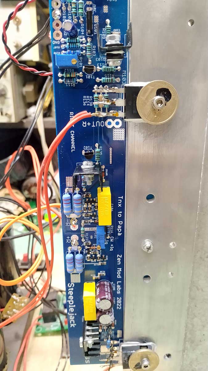

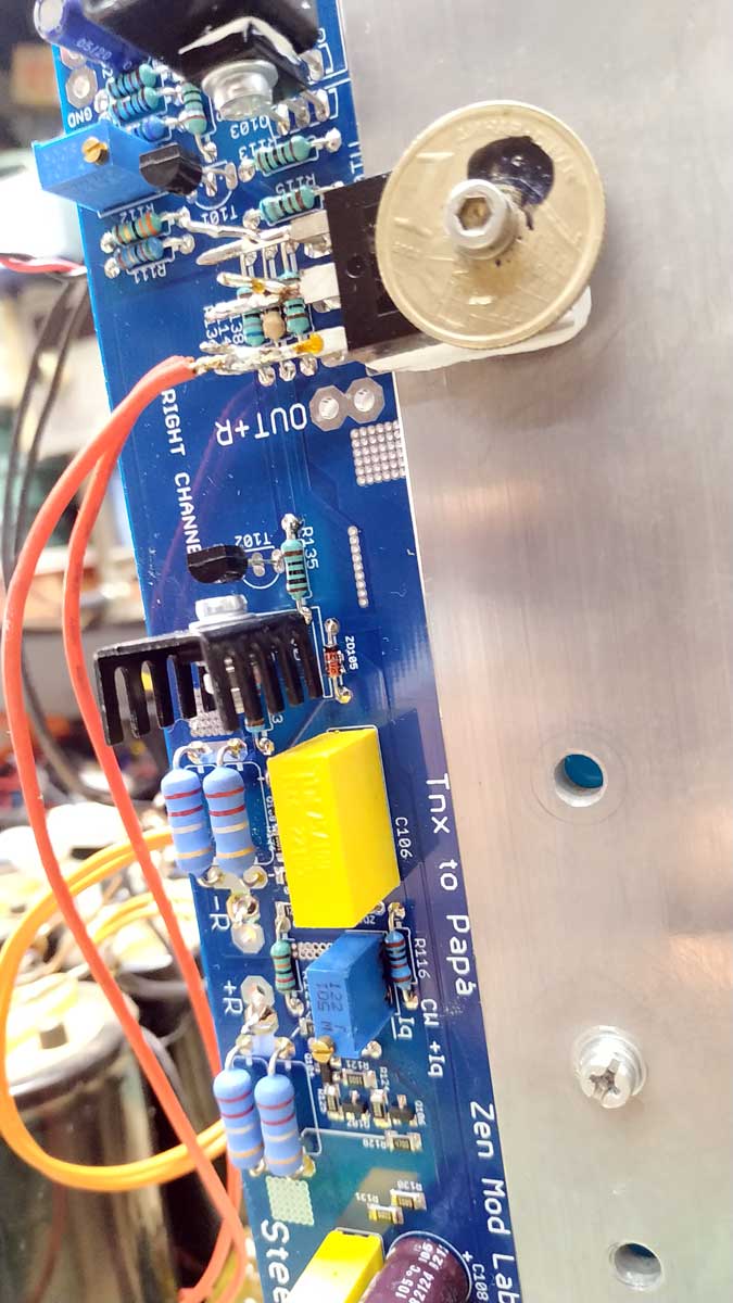

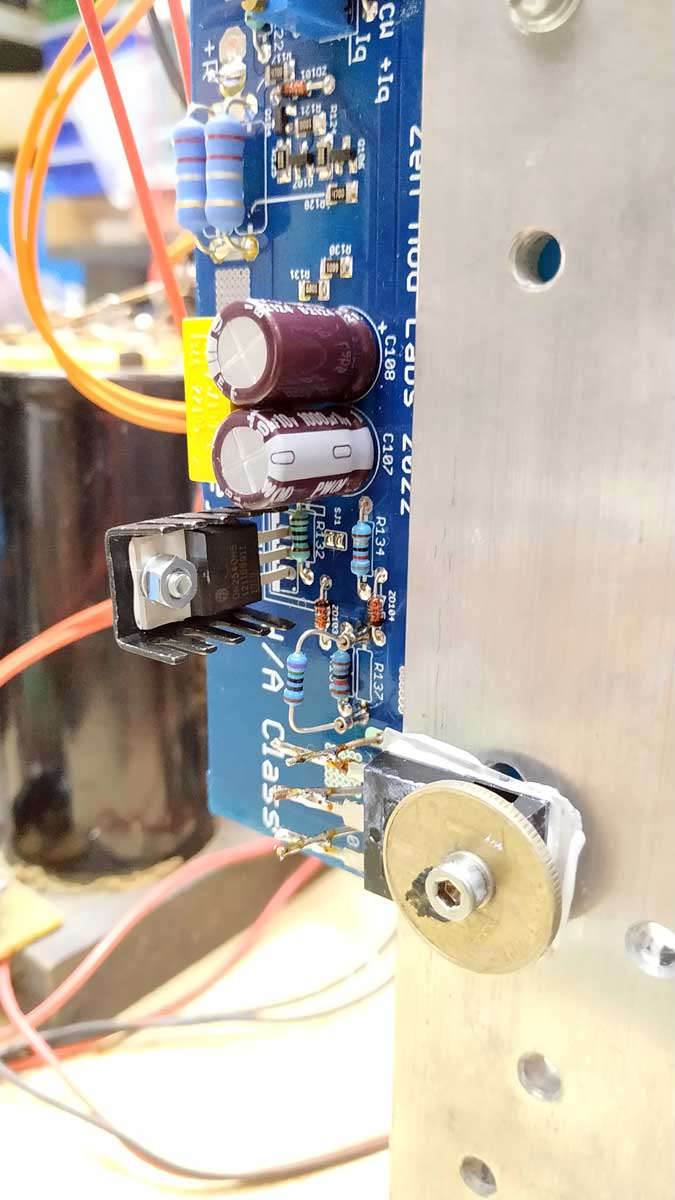

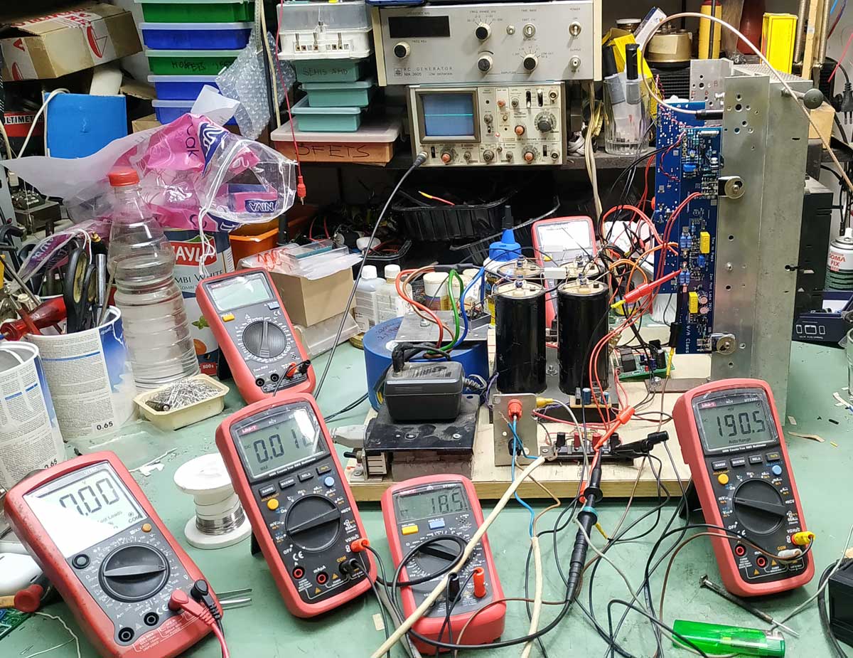

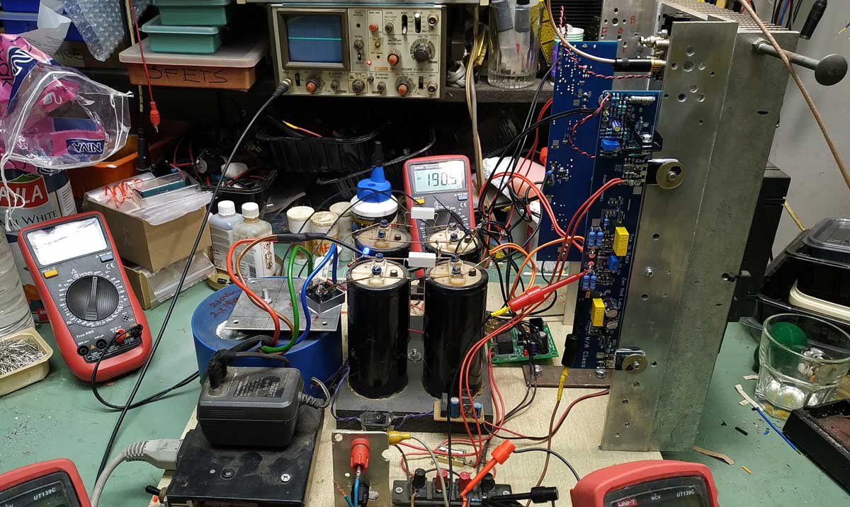

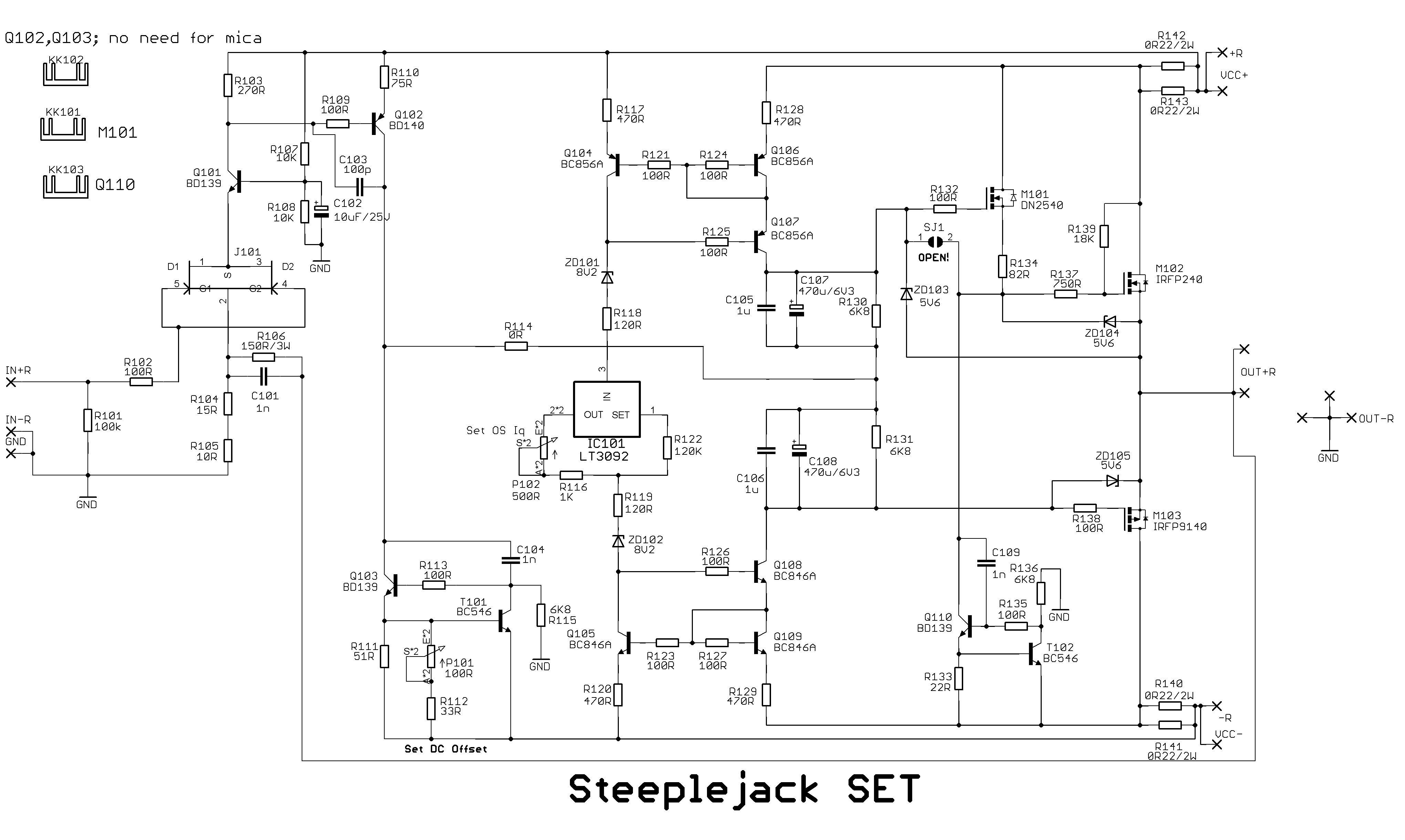

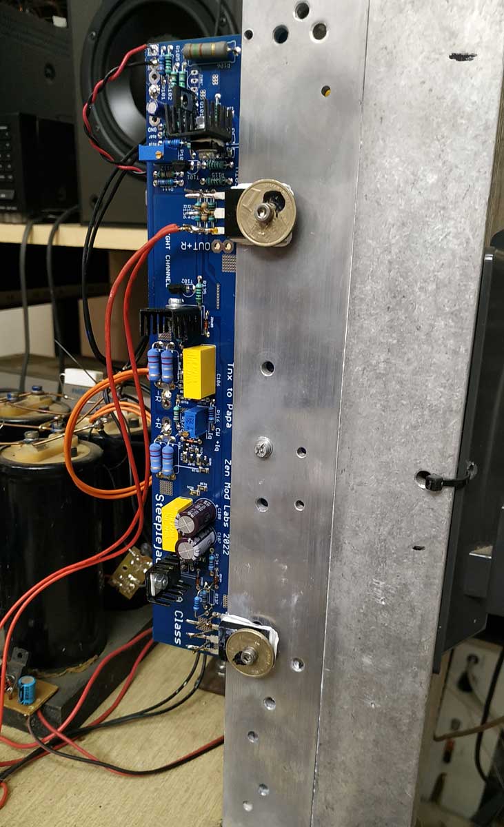

Zen Mod Napisano Septembar 7, 2022 Autor #10 Napisano Septembar 7, 2022 ha! just finished conversion to Steeplejack SET (Schaded Enhanced Thingie), meaning that upper mosfet is connected in Schade arrangement all measurements done, it's already singing, and as I could expect, everything is slightly more in the face, while I can still hear Miles thinking how it could be better that I didn't wiped clean damn spectacles prior to gig, probably lesser trouble with stage reflectors ZM is Happy Camper, Steeplejack SET is Poor Men's Scryer ...... even for this one 300B Fetishists can eat my liver
