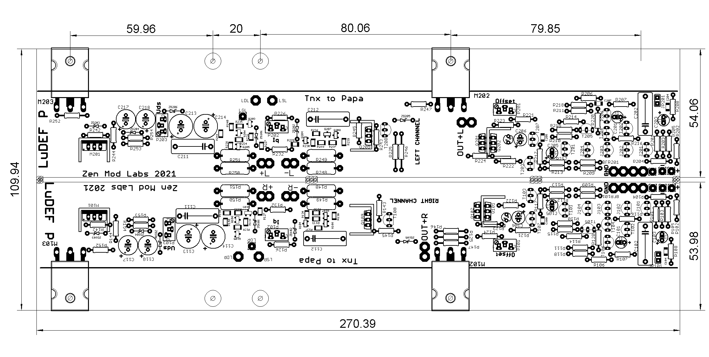

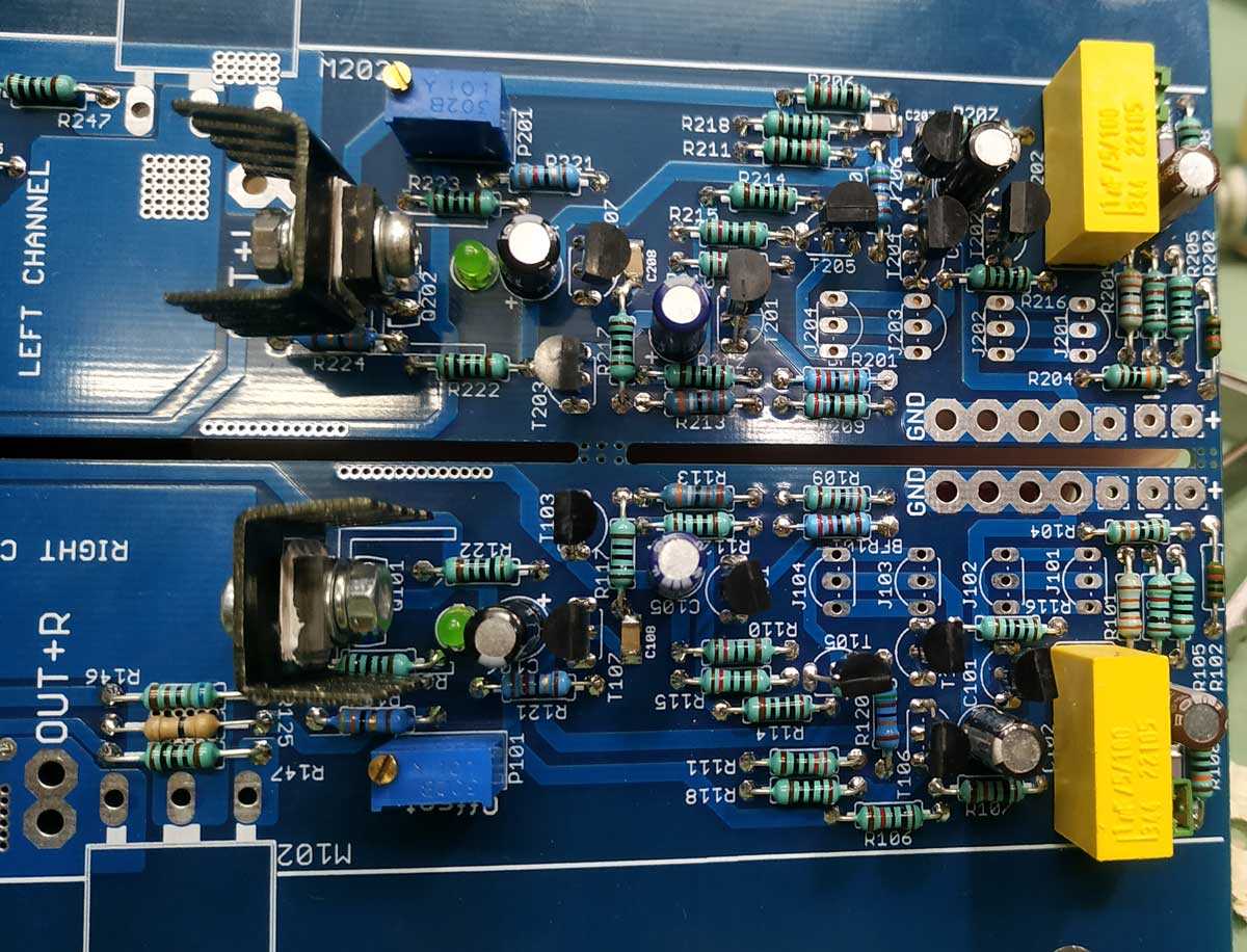

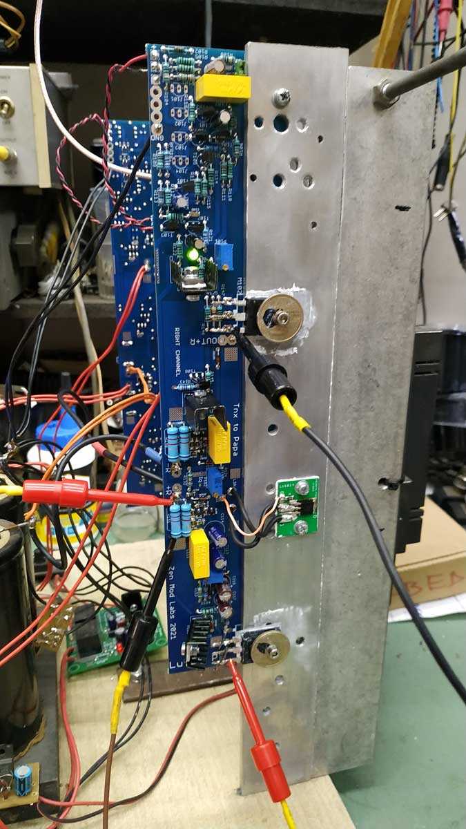

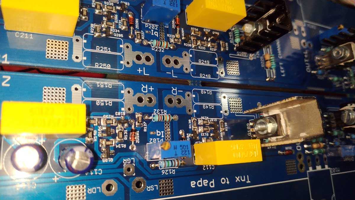

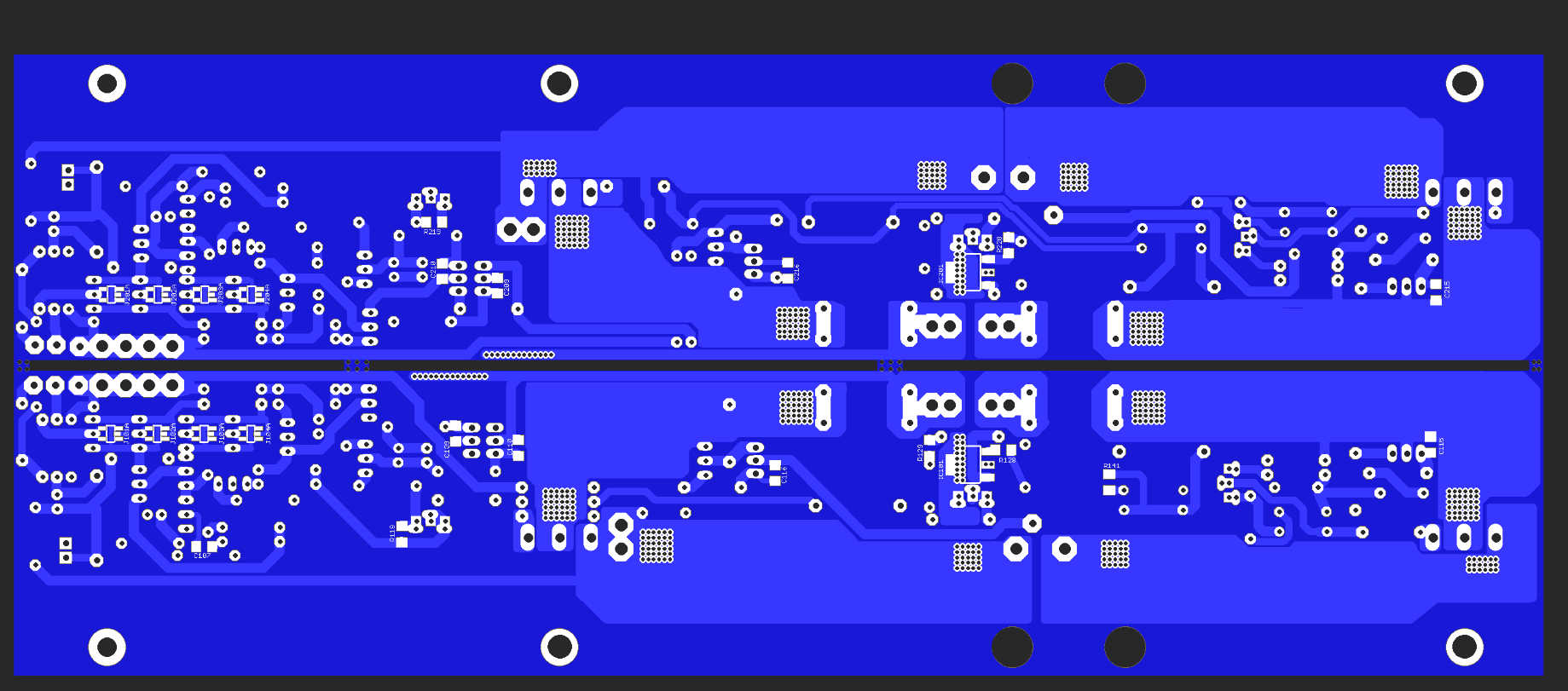

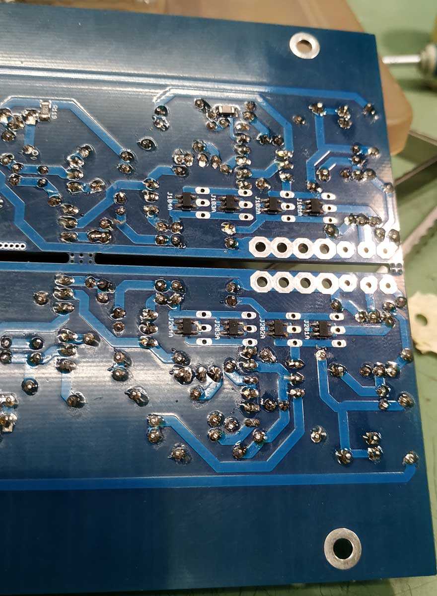

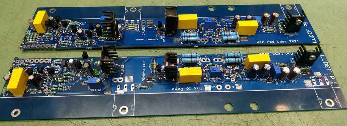

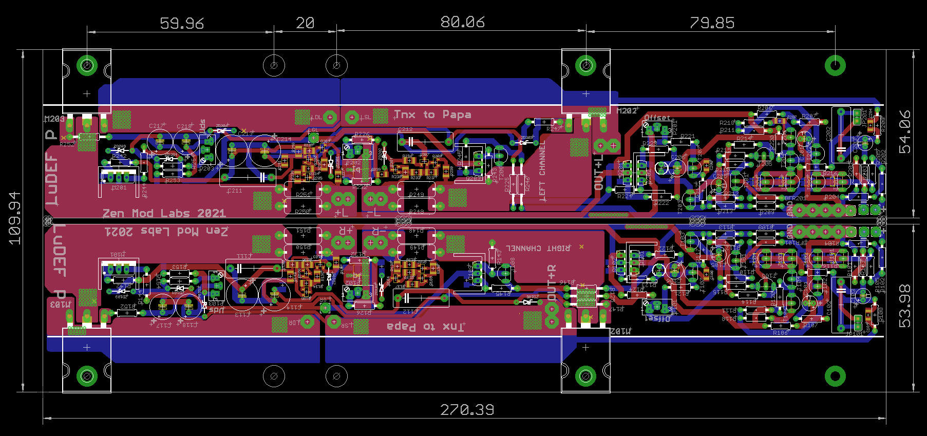

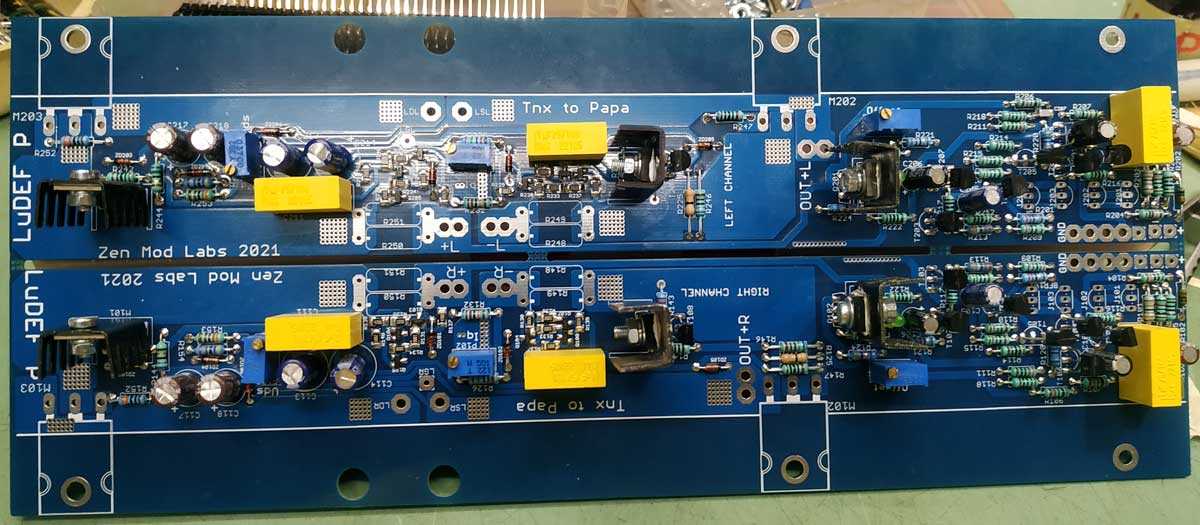

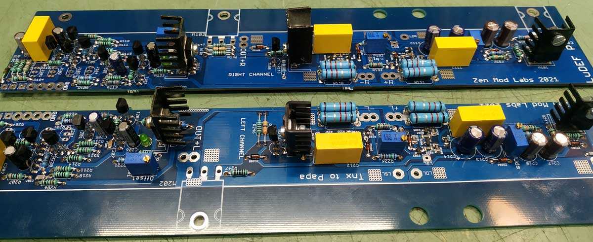

Zen Mod Napisano Maj 16, 2022 #1 Napisano Maj 16, 2022 Postovano na Big DiyA Copy-paste ovde, mrzi me da kucam ponovo Second installment of Plethora of Pinjatas series of amps Started with this shonne, zerowaf, LightMatic and 1 član je reagovao/la na ovo 1 1 2

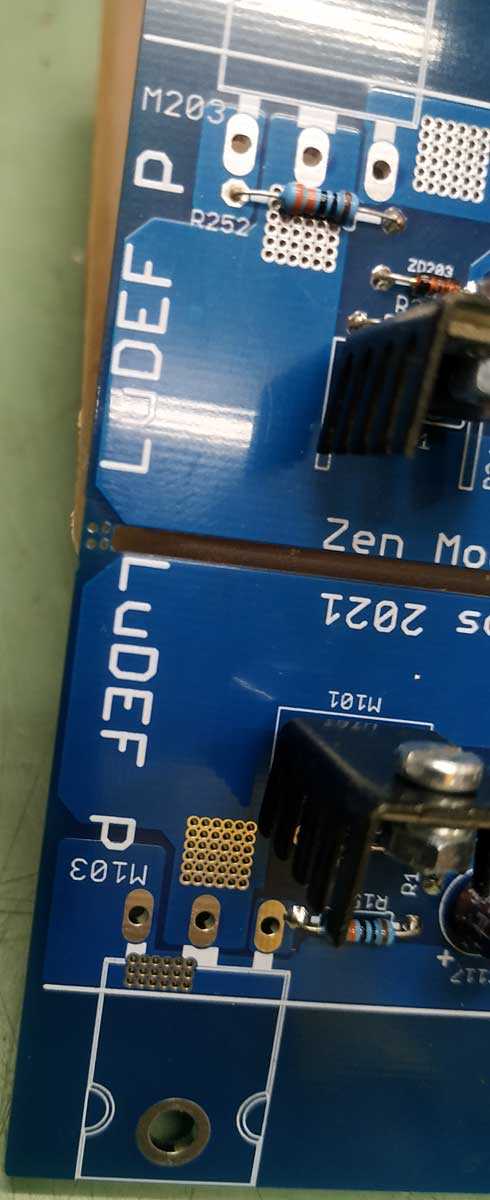

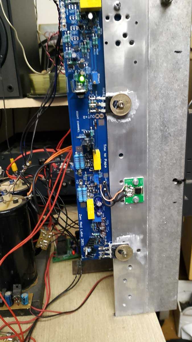

Zen Mod Napisano Maj 16, 2022 Autor #2 Napisano Maj 16, 2022 which is LightMatic, Vix and shonne je reagovao/la na ovo 1 2

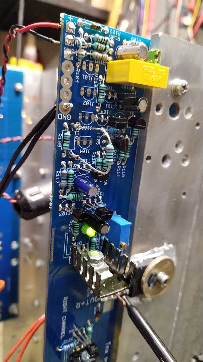

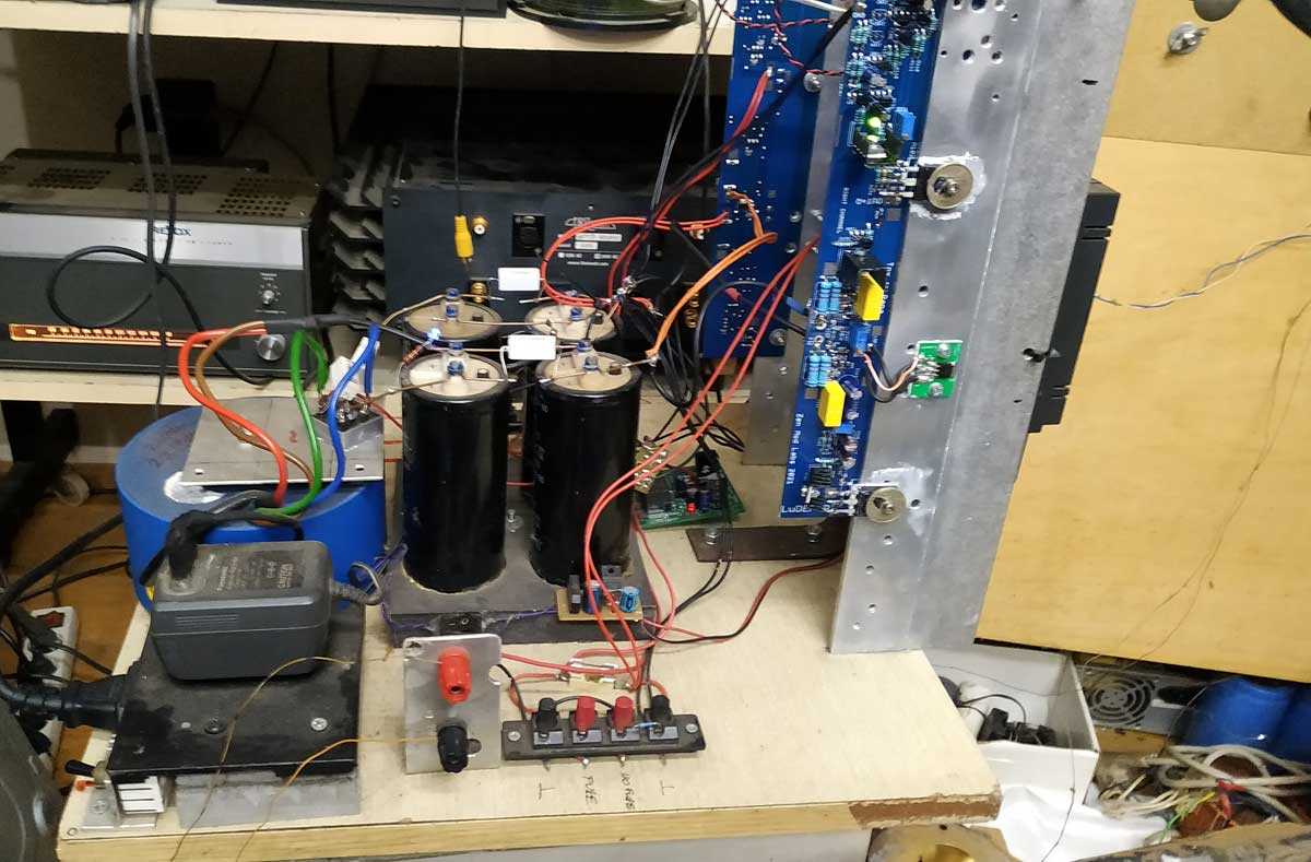

Zen Mod Napisano Maj 16, 2022 Autor #3 Napisano Maj 16, 2022 that gone to T-Bed Vix and shonne je reagovao/la na ovo 2

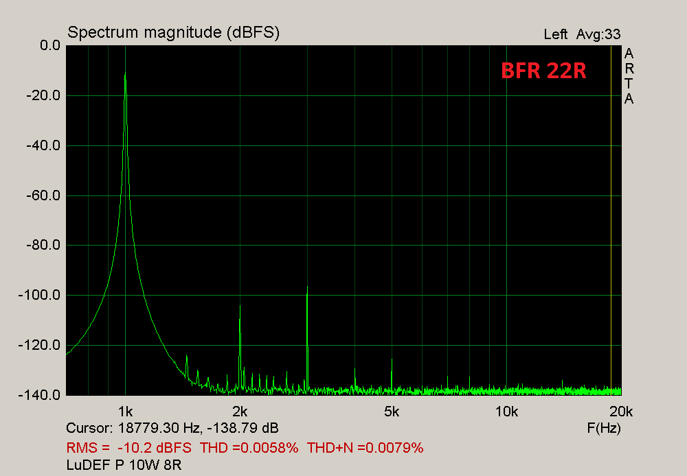

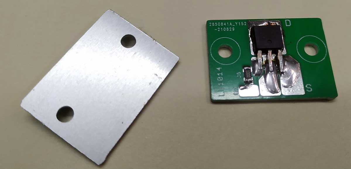

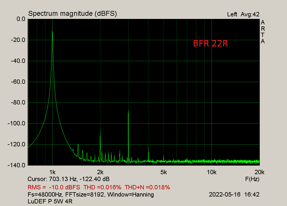

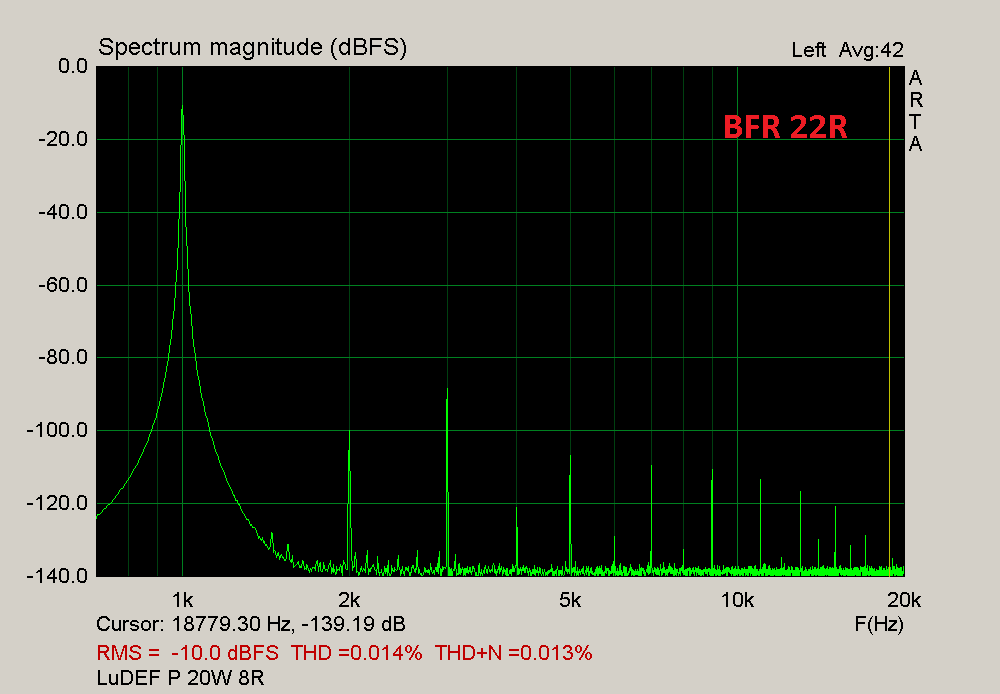

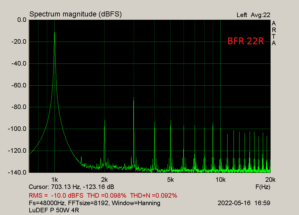

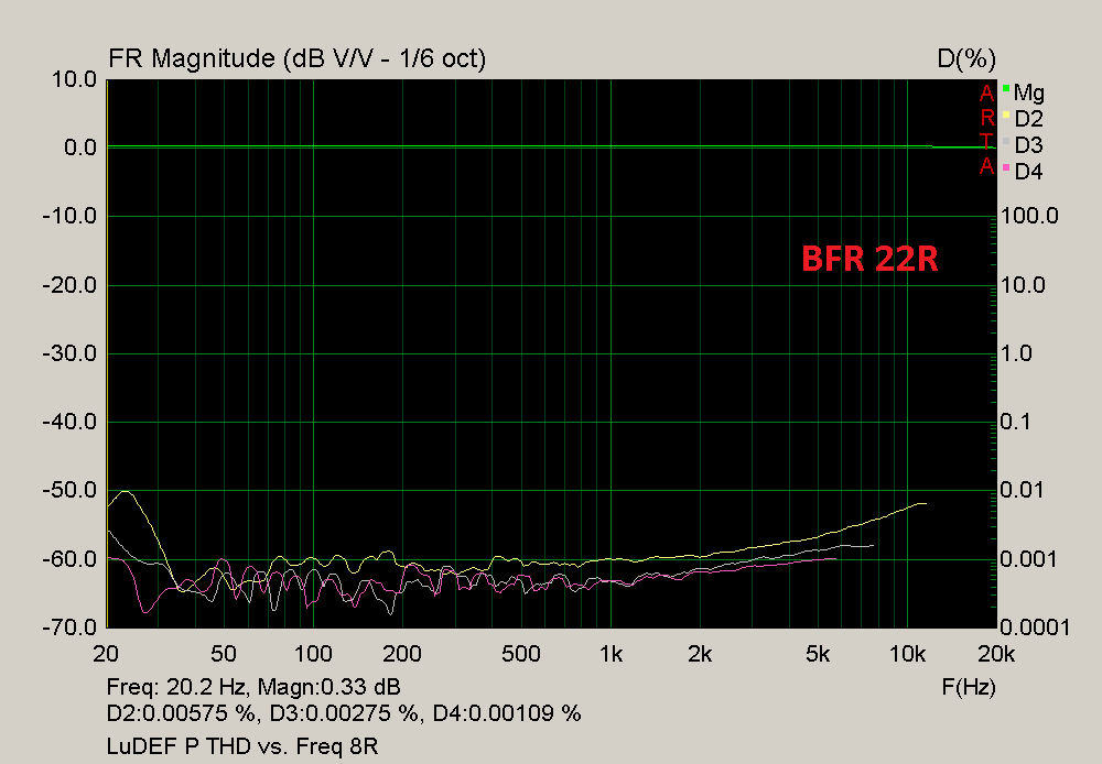

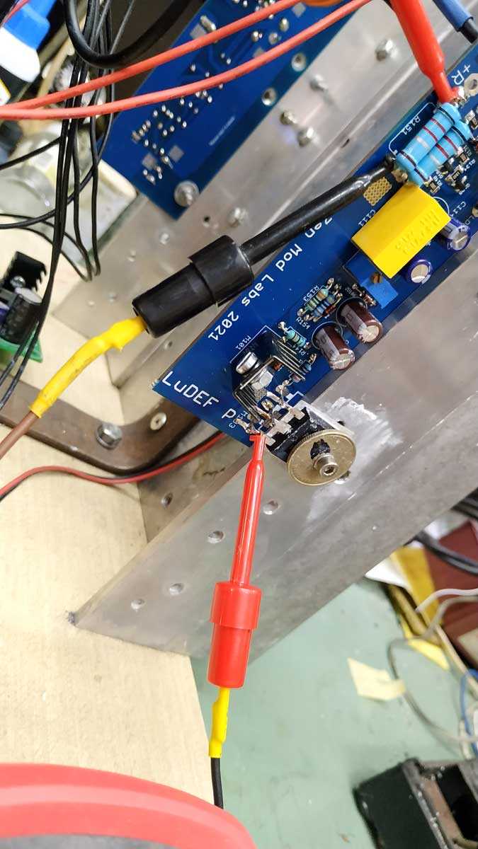

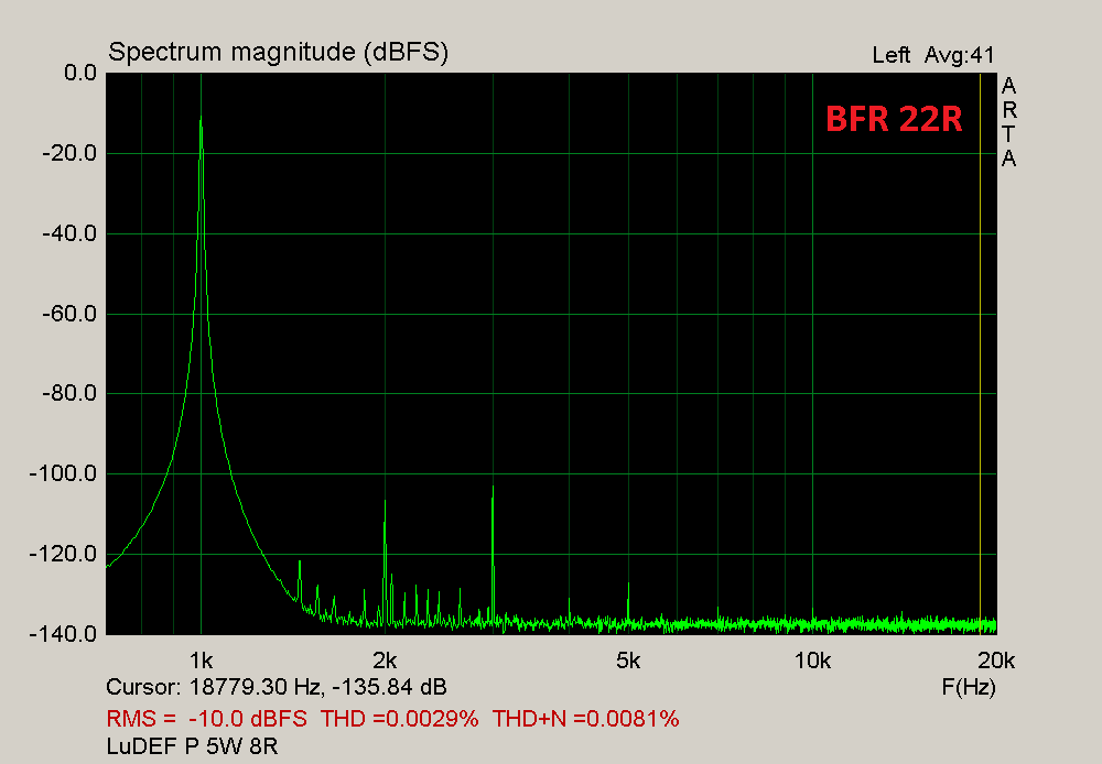

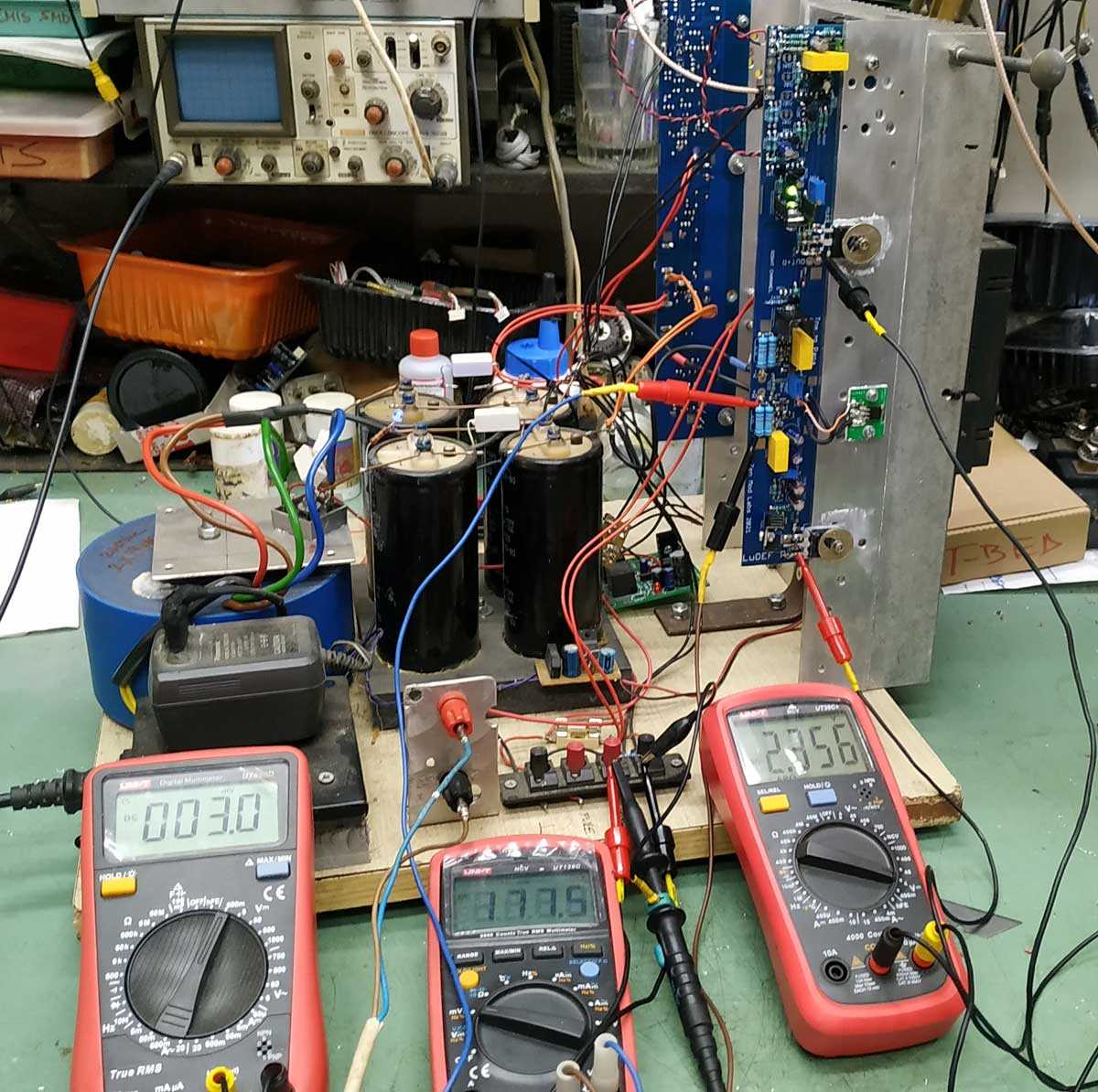

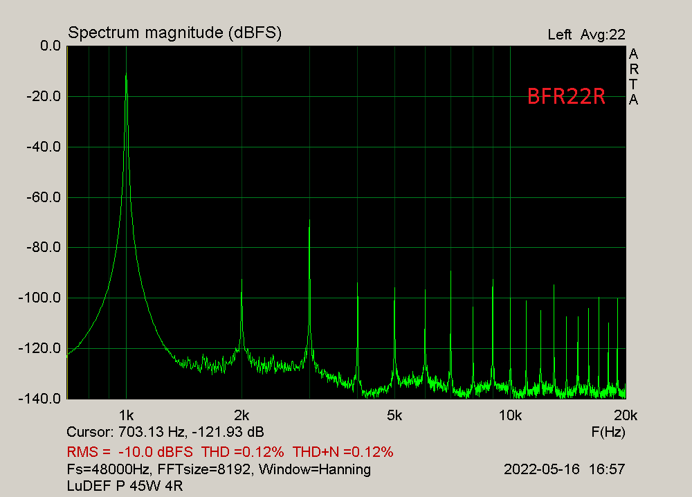

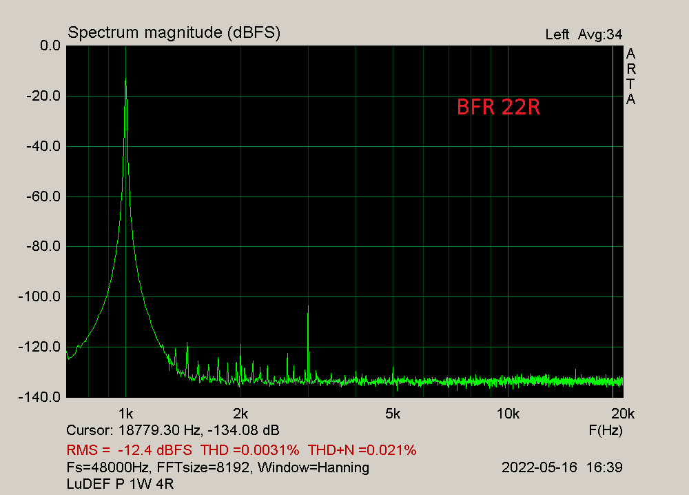

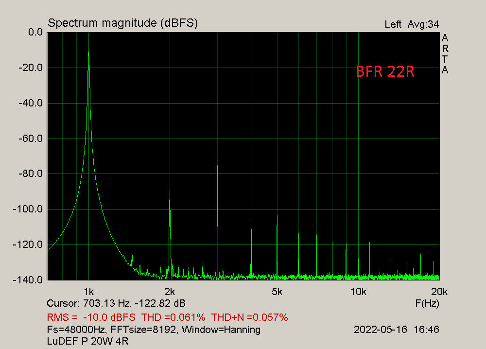

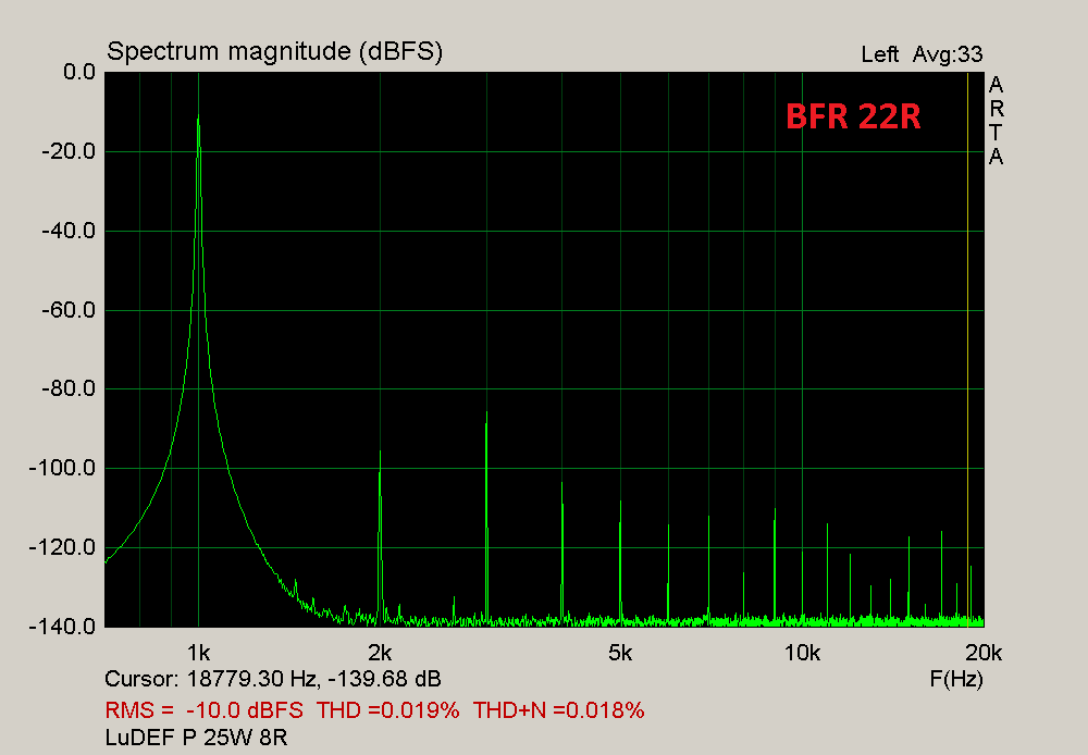

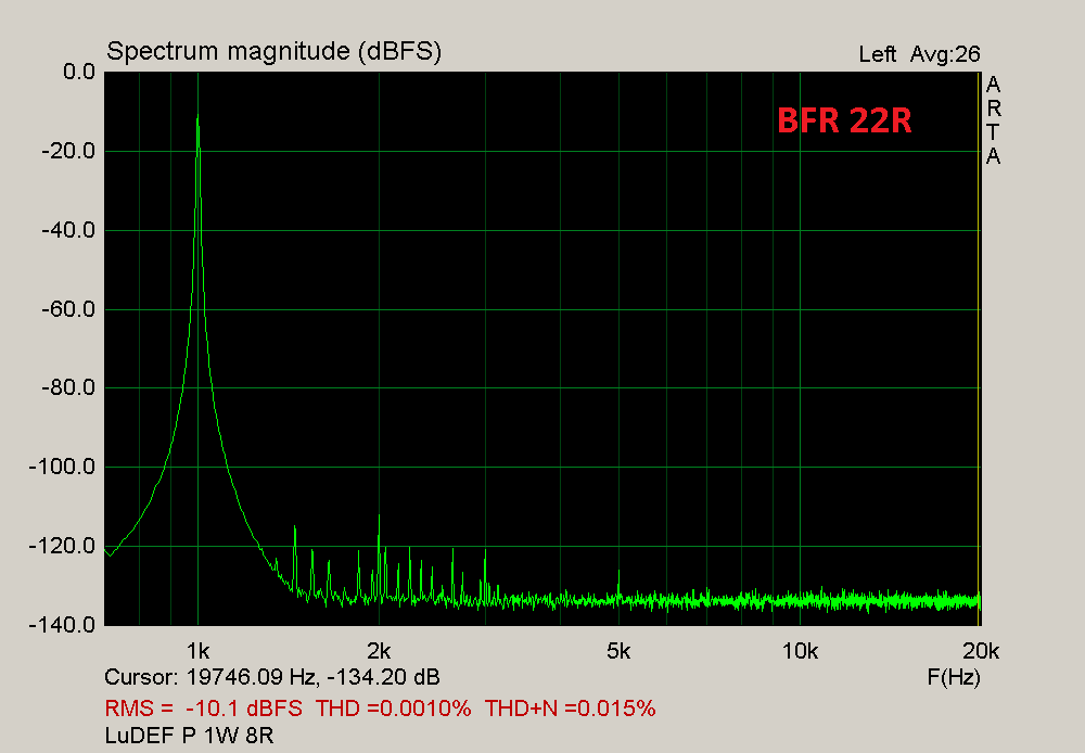

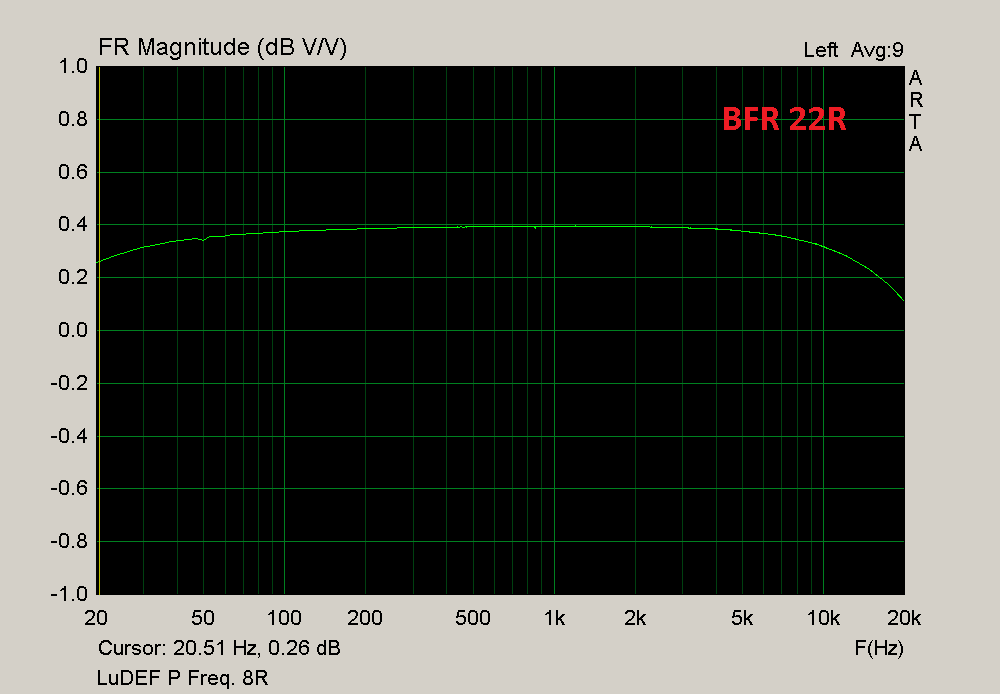

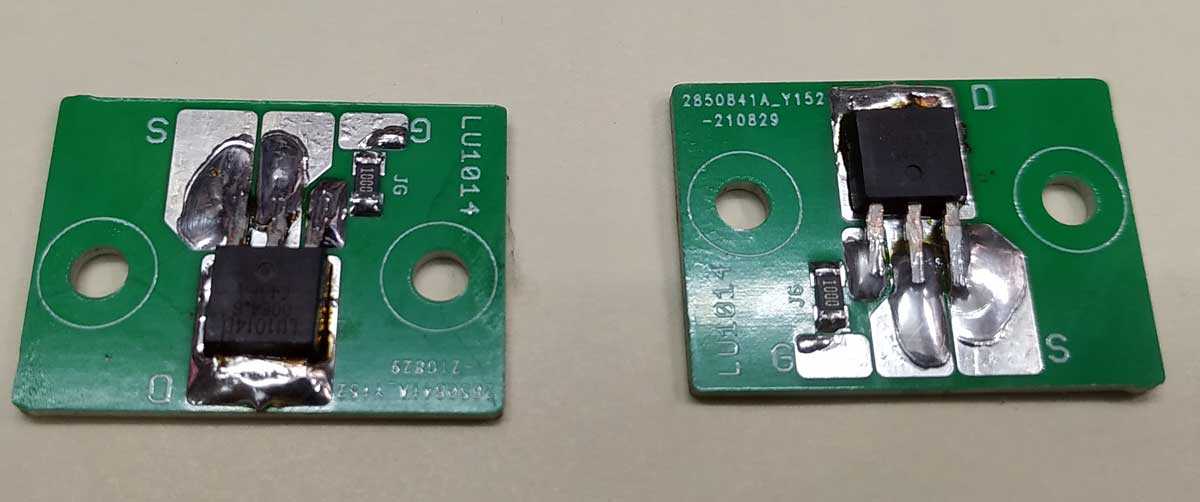

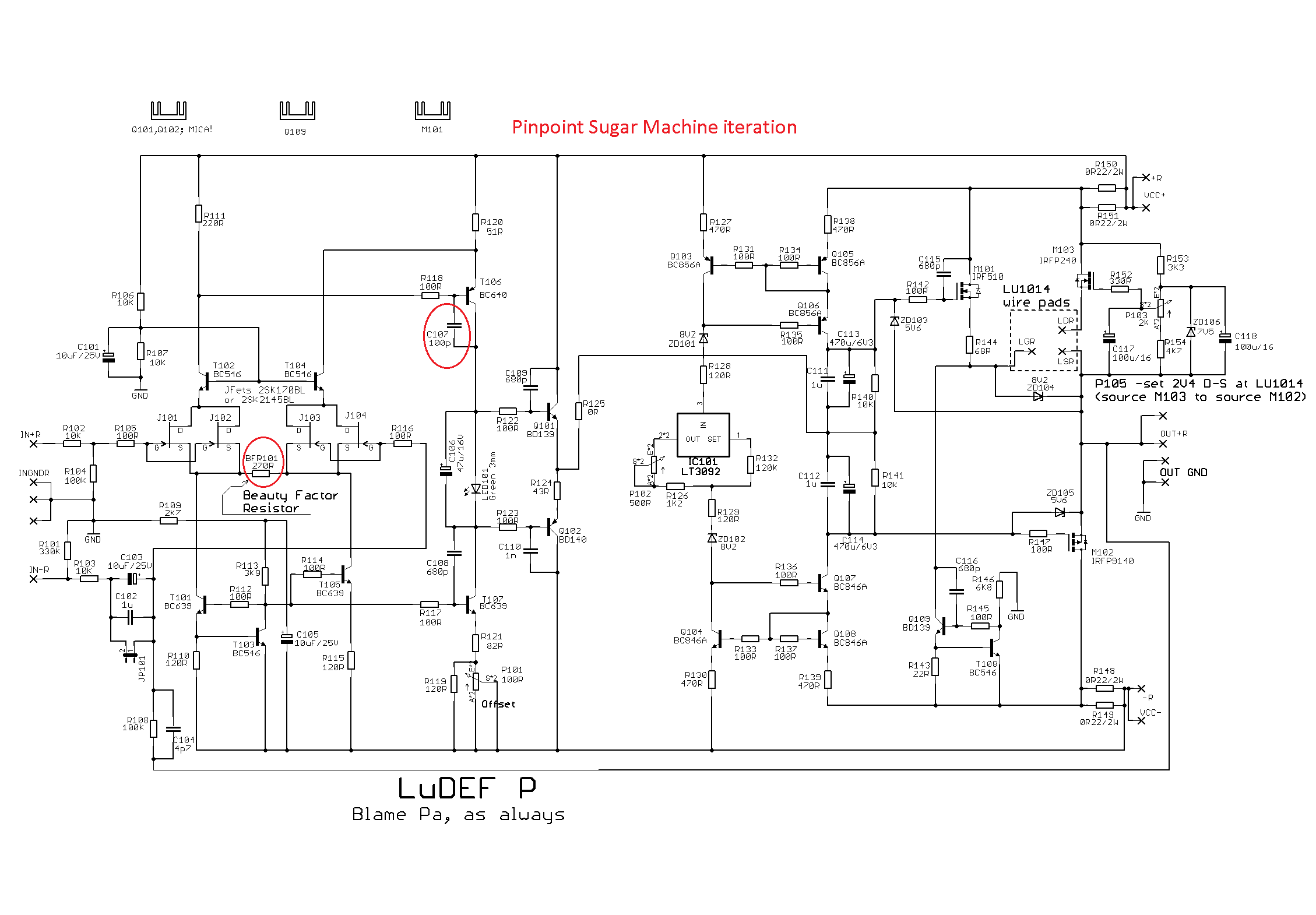

Zen Mod Napisano Maj 16, 2022 Autor #4 Napisano Maj 16, 2022 rails +/-23-ish Iq 1A7-ish output DC Offset negligible LU1014 Uds set to 2V4 BFR (Beauty Factor Resistor) 22R, so OLG max. thinking to make MC pre of this one result, Pinpoint Machine - dominant 3rd set of graphs for 8R Load: shonne je reagovao/la na ovo 1

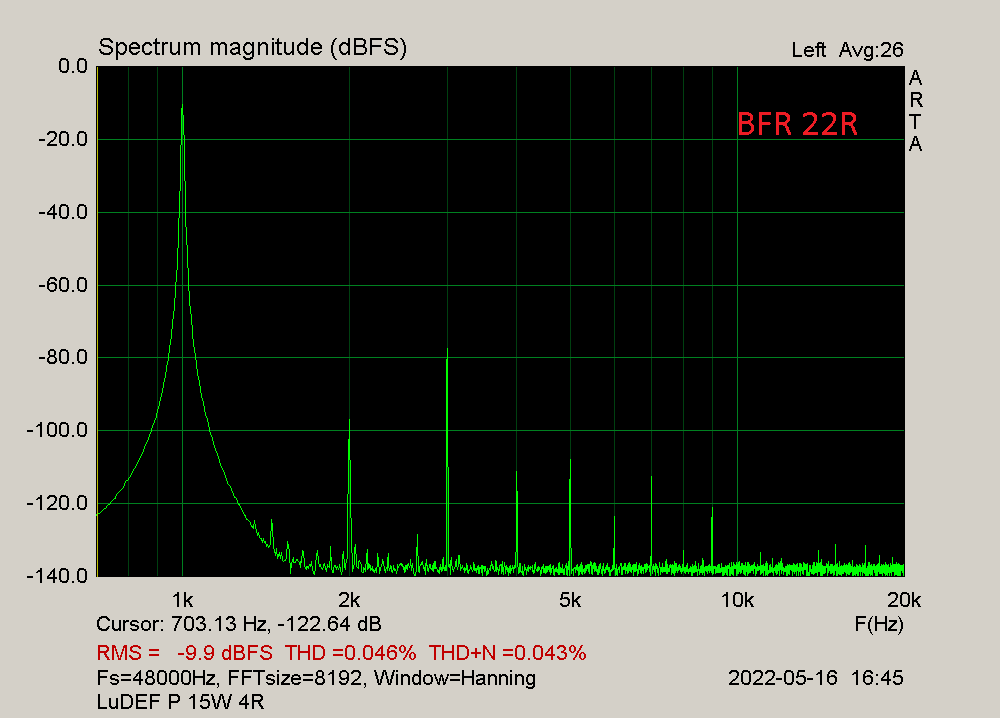

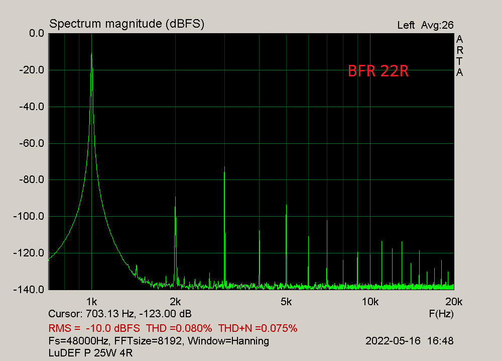

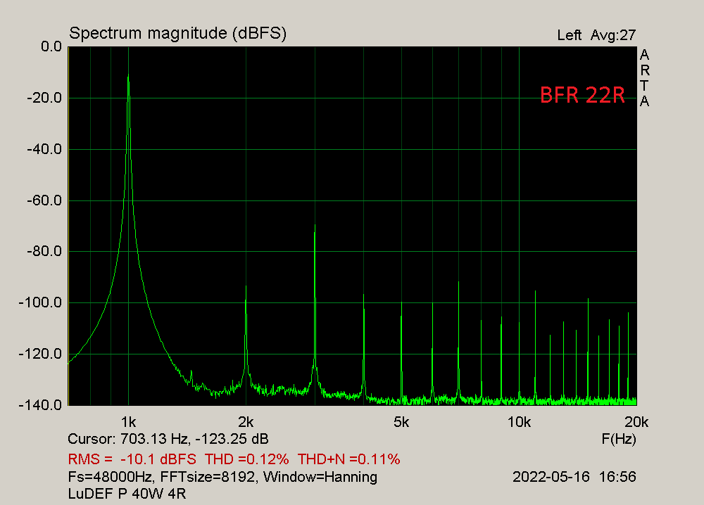

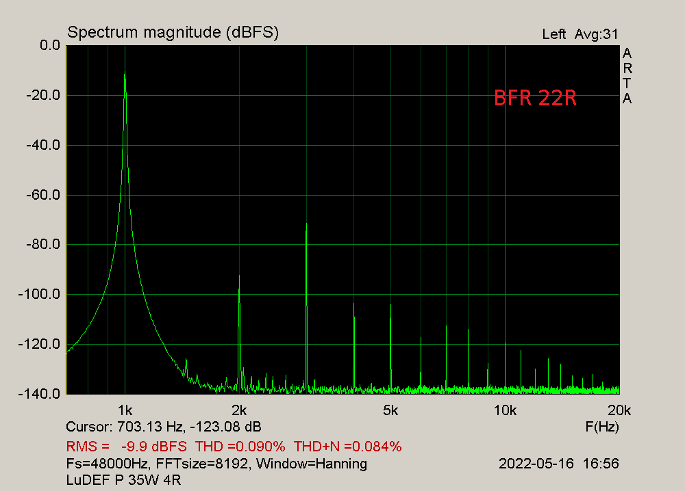

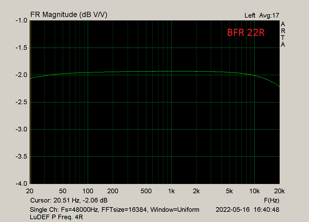

Zen Mod Napisano Maj 16, 2022 Autor #5 Napisano Maj 16, 2022 everything the same; set of graphs for 4R Load

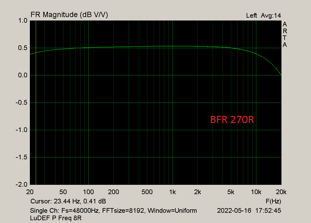

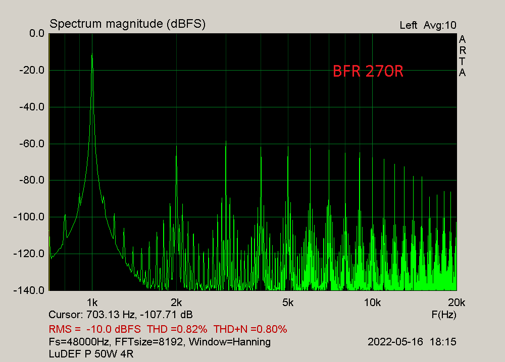

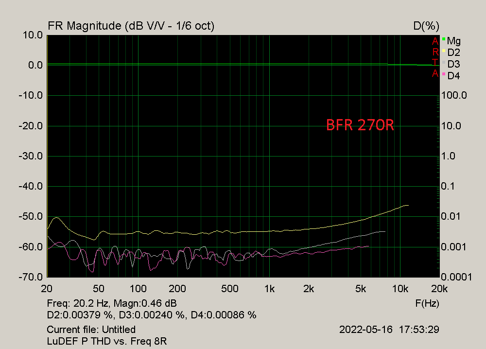

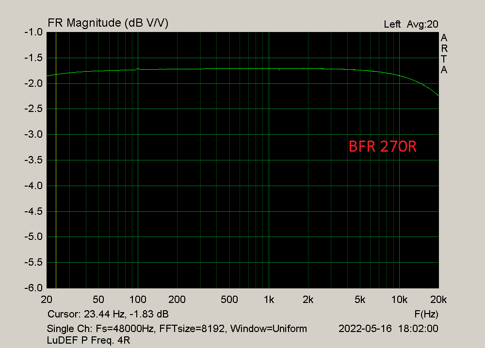

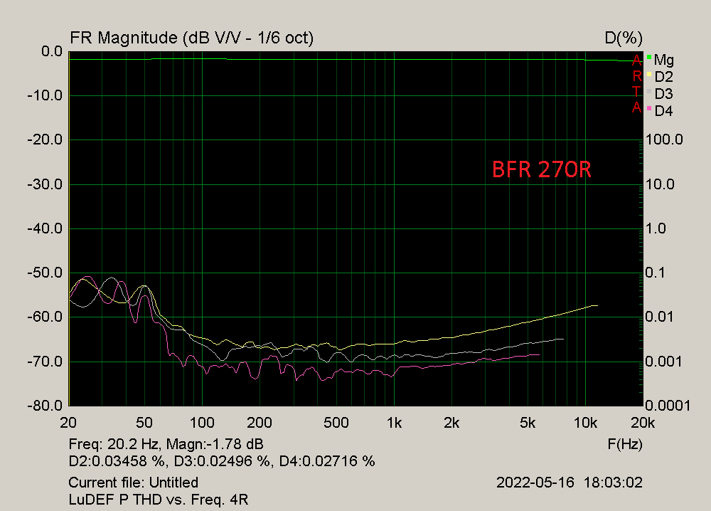

Zen Mod Napisano Maj 16, 2022 Autor #6 Napisano Maj 16, 2022 OK, THD levels are ridicolous But, as intention wasn't dominant 3rd, finally to use BFR position for Sugar Level Tweaking BFR changed to 270R (OLG goes down, amount of NFB goes down, degree of symmetry between phases (LTP) goes down) Vix je reagovao/la na ovo 1

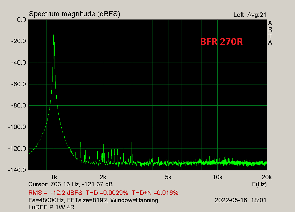

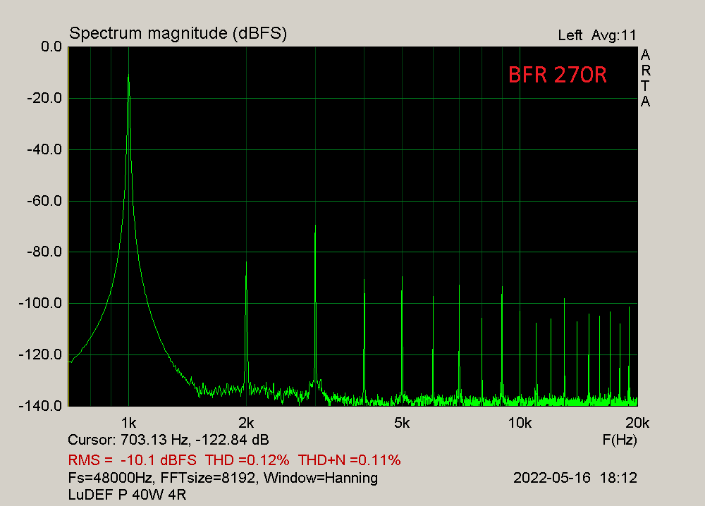

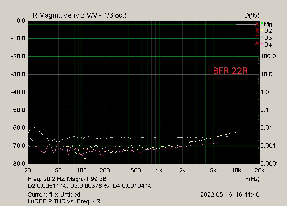

Zen Mod Napisano Maj 16, 2022 Autor #7 Napisano Maj 16, 2022 so, to repeat: rails +/-23-ish Iq 1A7-ish output DC Offset negligible LU1014 Uds set to 2V4 BFR (Beauty Factor Resistor) 270R result - Pinpoint Sugar Machine, dominant 2nd, THD Levels still ridiculously low set of graphs for 8R Load: zerowaf je reagovao/la na ovo 1
Zen Mod Napisano Maj 16, 2022 Autor #8 Napisano Maj 16, 2022 everything the same; set of graphs for 4R Load

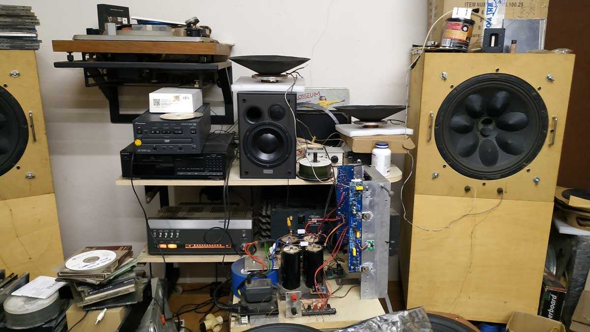

Zen Mod Napisano Maj 16, 2022 Autor #9 Napisano Maj 16, 2022 Show Time shonne, LightMatic and Vix je reagovao/la na ovo 2 1

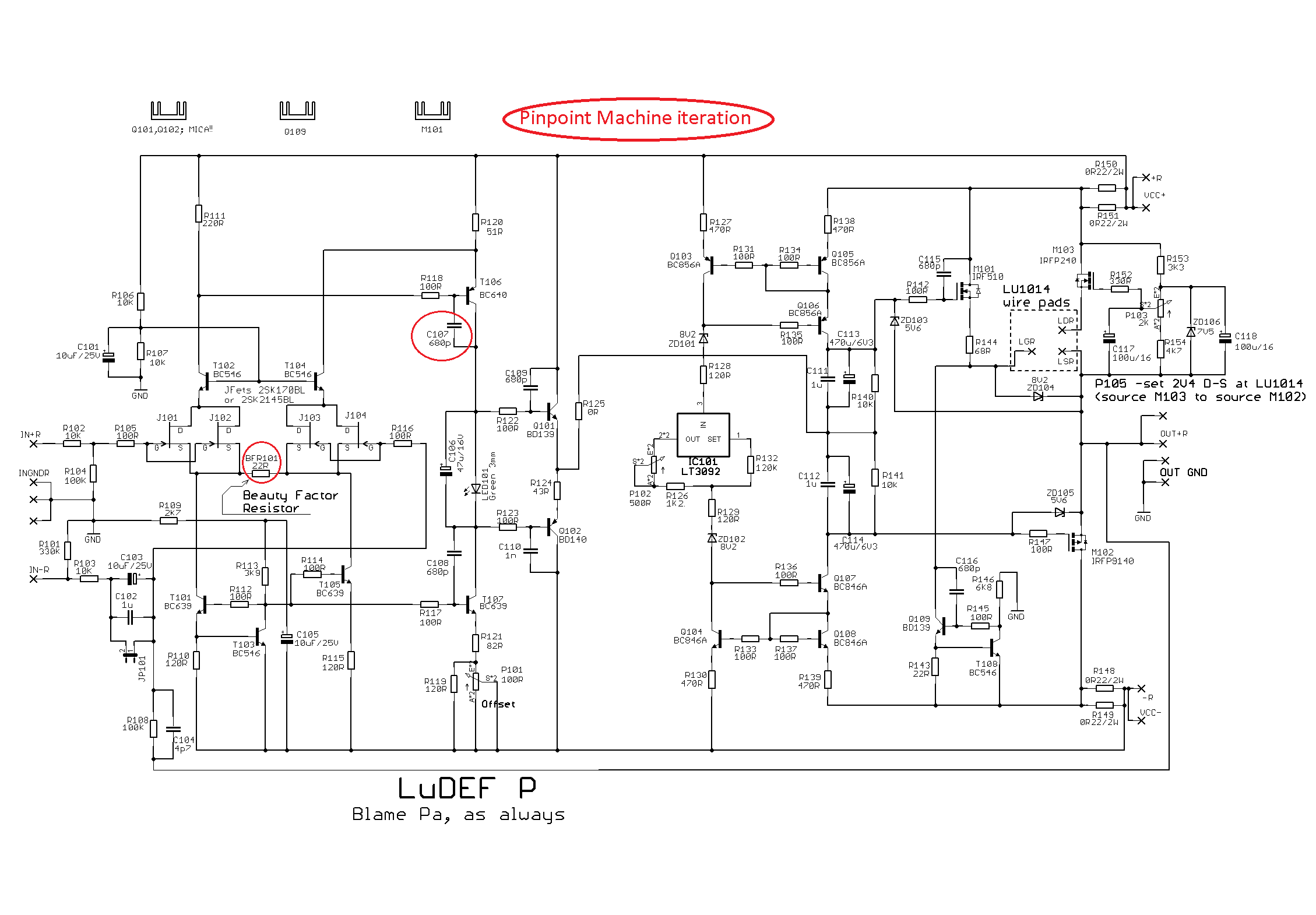

Zen Mod Napisano Maj 16, 2022 Autor #10 Napisano Maj 16, 2022 Signal Path and Block schm more or less same as in SissySIT P active links How it sounds? Spooky LightMatic je reagovao/la na ovo 1
