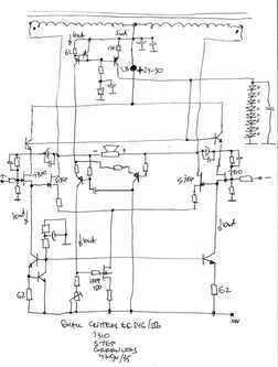

    verovatno ti je predebela struja kroz ulazni LTP nikad nikad nikad nemoj stavljati trimer u paralelu sa fiksnim otporom - na takvom mestu evo ti prepravljena sema - cilj je da imas 20-25mA kroz ulazni LTP povecaj R7 na 390 , moze i na 420 oma moras imati namontirane izlazne ( bar jedan par ) ako mislis da imas punu funkcionalnost , ukljucujuci offset na izlazu ne treba ti nikakav dummy load na izlazu , ali ulazi moraju biti zakljuceni na gnd

  3. why wasting 2SK170 , when with two-bjt-CCS you have very nice CCS , with superior Tempco . with R9 set 20mA through input LTP ( exactly 9V4 across R3 )both R12 and R25 are influencing Iq and offset ; start with R25 at zero , trim R12 to desired Iq , then fiddle offset with R25 20mA type is good ; they're operating here at 5mA ; nice value , considering both internal resistance , tempco and noiseQ8 ? base of Q8 via R24 and base of Q5 via R2 are connected to neg PSU, via R21 put some little heatsink to Q8 ; Q7 is maybe just warm ; difference between BD140-10 and BD140-16 , same as between 556B and 556C are just in Hfe ; do not even bother ..... tell me more .....

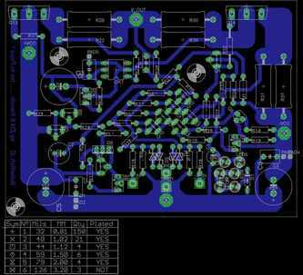

  10. opet ne citas temu ajd' pogledaj pcb kako je rutirana nekoristeni ulazi se mutiraju na gnd mute gnd i audio gnd nisu spojene nego imaju svaka svoj vod na star gnd
