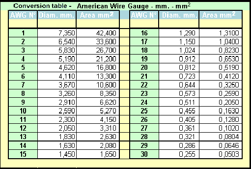

Mikorist Napisano Jul 7, 2009 Autor Share #15 Napisano Jul 7, 2009 AWG - American Wire Gauge - Conversion table : Link to comment Podeli na ovim sajtovima More sharing options...
