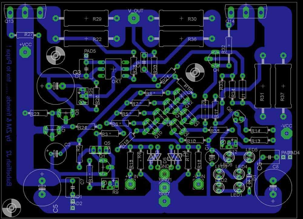

Tea-Bag Napisano Oktobar 24, 2010 #507 Napisano Oktobar 24, 2010 No worries. Q13 - 1.31 UgS @ 2A, Q14 1.42 UgS @ 2A
Zen Mod Napisano Oktobar 24, 2010 Autor #508 Napisano Oktobar 24, 2010 OKtry to preset - in cold ( prior to powering up ) sum of R12+R35 to ~250Rthen try standard procedure with variac
Tea-Bag Napisano Oktobar 24, 2010 #509 Napisano Oktobar 24, 2010 OKtry to preset - in cold ( prior to powering up ) sum of R12+R35 to ~250Rthen try standard procedure with variac250R, 310R, did not work. I remember after replacing Q14, but not fixing short around R27, that it biased up to .750, but after fixing it, I got this. I had de-soldered most of the upper right part of the schematic trying to figure that out, maybe something toasted there, but uncertain. Drilling that area, really just takes the R27 to C3 track out of the picture.Everything around 'front end Jfet's' look good.
Zen Mod Napisano Oktobar 24, 2010 Autor #510 Napisano Oktobar 24, 2010 have you continuity between R32 (not jfet side but left side on schematic) and C of Q2also - check continuity between R32 and Q14
generg Napisano Oktobar 24, 2010 #511 Napisano Oktobar 24, 2010 hi Zen Mod, only for pleasure I simulated with multisim the two buffers...... at 5 v and 10kH your buffer had only a tenth of the distortion of the B1 Buffer (0,001/0,01) next week I will build up.......hope you had a nice weekend
generg Napisano Oktobar 24, 2010 #512 Napisano Oktobar 24, 2010 Oh I forgot,matching the two j-fets?at about 8mA Idss?
Tea-Bag Napisano Oktobar 24, 2010 #513 Napisano Oktobar 24, 2010 have you continuity between R32 (not jfet side but left side on schematic) and C of Q2also - check continuity between R32 and Q14Yes, those are fine on both channels.
Zen Mod Napisano Oktobar 24, 2010 Autor #514 Napisano Oktobar 24, 2010 :dubbio:point is that upper jfet is open but lower one isn't , so you are having same offset as in case that you have high value resistor instead lower jfet , while upper one is trying topump current through it .I can't figure how on earth - what's stealing current from R35&R12 combo ; is Q4 OK ?with positive offset on output - it will be logical that Q11&Q12 are sort of choked and that Q9&Q10 are conducting more current , so you should have greater amount of voltage across R35&R12 ........ but not - here is contrarycheck Q4 please
Tea-Bag Napisano Oktobar 24, 2010 #515 Napisano Oktobar 24, 2010 :dubbio:point is that upper jfet is open but lower one isn't , so you are having same offset as in case that you have high value resistor instead lower jfet , while upper one is trying topump current through it .I can't figure how on earth - what's stealing current from R35&R12 combo ; is Q4 OK ?with positive offset on output - it will be logical that Q11&Q12 are sort of choked and that Q9&Q10 are conducting more current , so you should have greater amount of voltage across R35&R12 ........ but not - here is contrarycheck Q4 pleaseReplaced Q4 - still same appoxiamate voltage .765Measured again Q6 - - ~ -12v like last time.Good channel Q4 - ~2V, Q6 around - 6V (I think). Not as high. No BF245's around to swap out.Thanks for looking.
Zen Mod Napisano Oktobar 24, 2010 Autor #516 Napisano Oktobar 24, 2010 Replaced Q4 - still same appoxiamate voltage .765Measured again Q6 - - ~ -12v like last time.Good channel Q4 - ~2V, Q6 around - 6V (I think). Not as high. No BF245's around to swap out......what's important regarding Q6 is just voltage at bases of cascodes - Q2 & Q3 ;they must be in range of minus 11-12V - exact what is voltage drop across leds+1N string
Tea-Bag Napisano Oktobar 24, 2010 #517 Napisano Oktobar 24, 2010 - exact what is voltage drop across leds+1N stringIs this a question? I think your just telling me role of Q6. Not related to issue...
Zen Mod Napisano Oktobar 24, 2010 Autor #518 Napisano Oktobar 24, 2010 that was just pointing that I don't care and it's not imprtant what you are measuring at Q6 - if you have -11V to -12V at bases of Q2 & Q3 ; in that case LED string and Q6 CCS are serving their functionif channel is working - then they are functional , so you don't need to check them there - voltage check points at schmtc are good enough for purpose
Tea-Bag Napisano Oktobar 26, 2010 #519 Napisano Oktobar 26, 2010 swapped out Q13 and Q14 for a better matching pair, and still no bias. Hmm.I think my next step is another analysis of continuity and cold resistance figures on both channels. If that provides nothing. I will overhaul the motorcycle.
