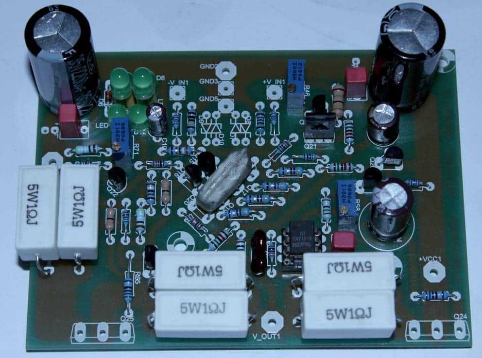

  2. Second PCB Tested....boring :aloofandbored12:It's working the same as the first one

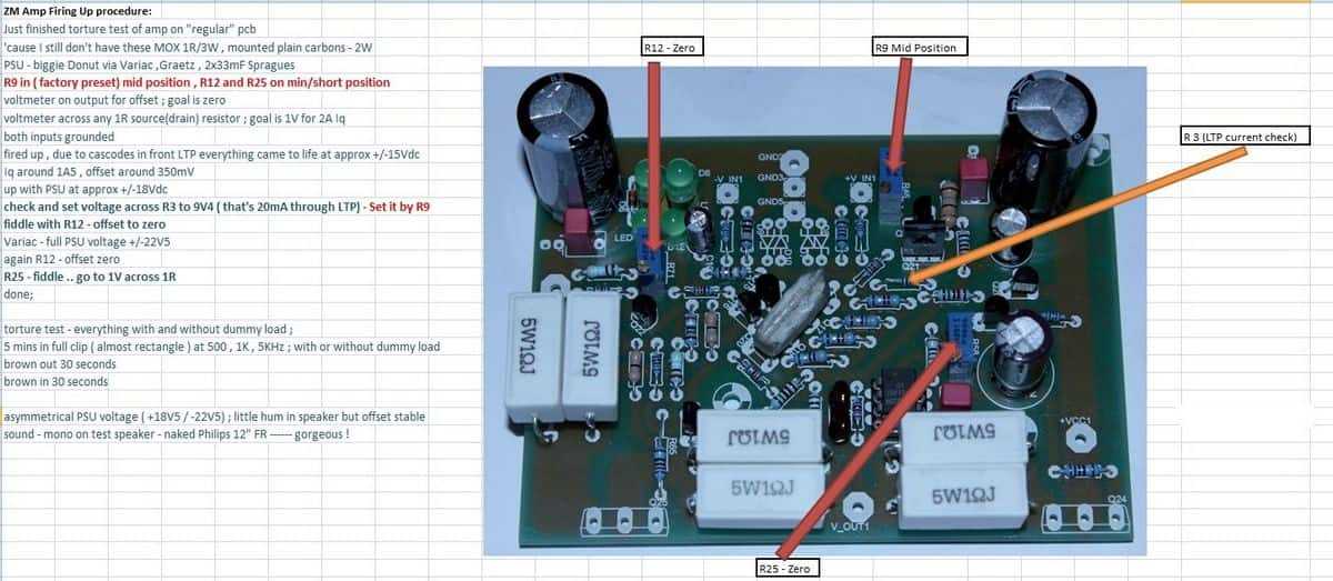

  8. Sipi was right.I changed R39. R57 and R70 to 10K - No change....0,49V over R69I changed Q26...0,49V over R69I put R70 1K and 0,6V over R69 then...I'm OK with this...
  9. Hvala sipi...Ja sam svuda umesto 12K stavio 15K...verovatno je tu zez....Mozda promenim sva3 komada na 10K.
  10. If You have Vgs measured as 1,32V at 2A, then expect Vgs+Rds to be around 2,4V, not 2,7V....

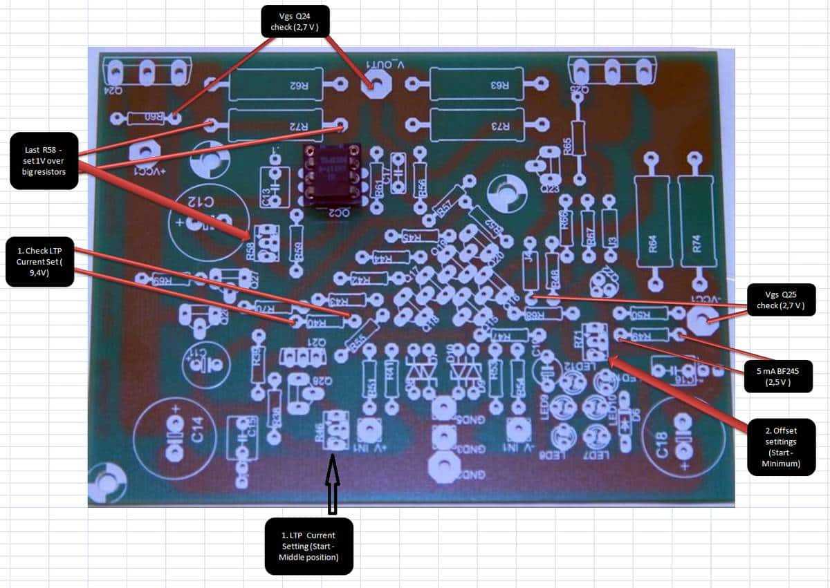

  12. Anyhow, Do you agree with a measurement points shown previously (where and how) ?
  13. And according to previous picture, here comes where to measure
  14. Here comes Schematic Nomenclature according to my PCB edit : schm deleted by ZM

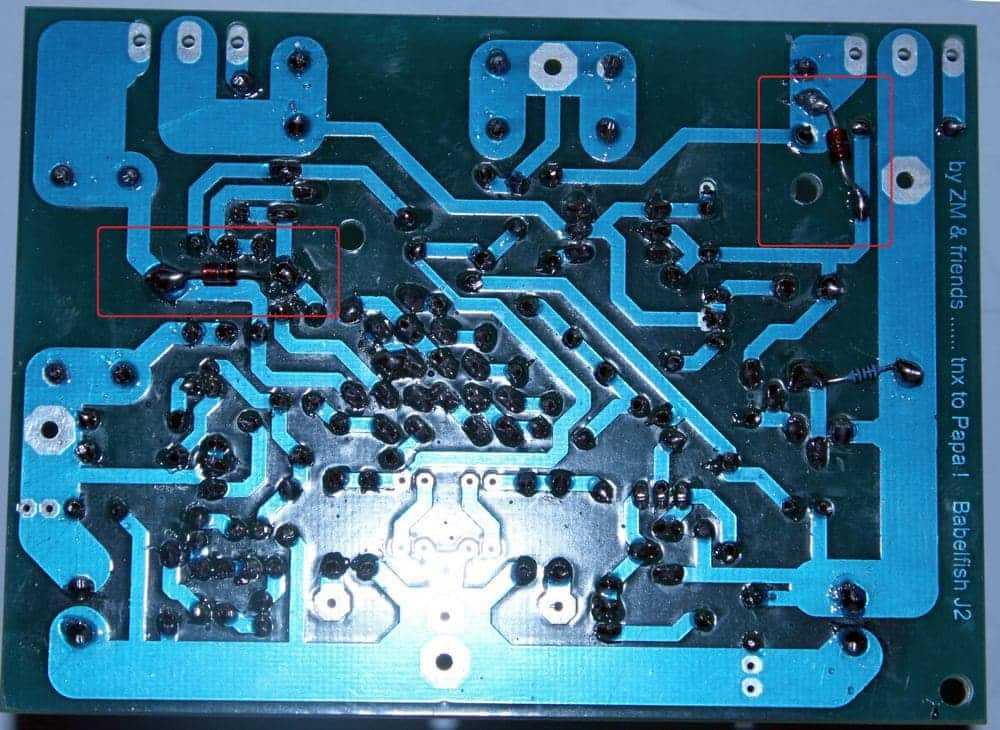

  21. And prove that I'm listening good advices :hi:Safety Zeners....
  22. One more picture
