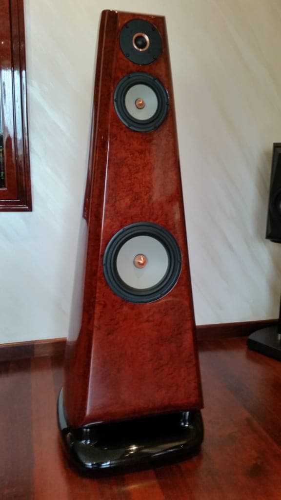

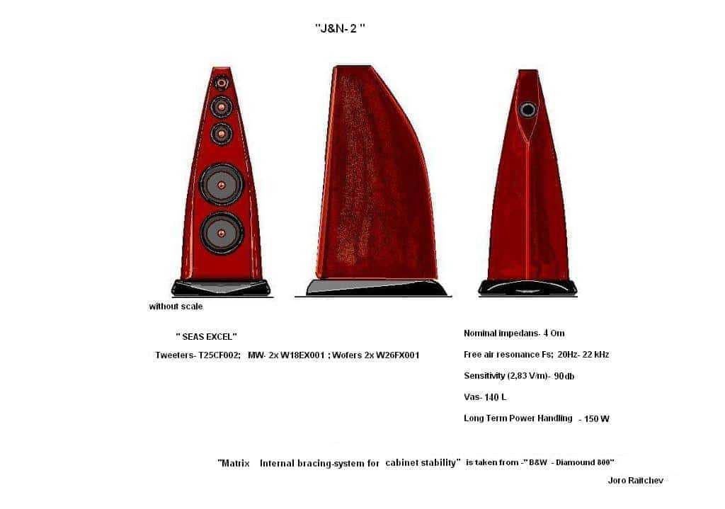

  1. Thanks! Maybe you missed the stage of my posts, please see page 8! Speakers is a 2 1/2- way, crossover is combination of a series for upper bass and treble added a parallel filter for lower bass. P.S. W18E001. W18EX001 QTS- 0,42. QTS- 0,26 / Thor/ / J&N/
  2. Thank you for good evaluation of my work! Ihave long been thinking about chainging the Tw with " crescendo" -SEAS. I have always wondered why SEAS do not offer this one Tw in a similar color of "Excel"- obviously a not well thought- out commercial concept.Agree with me, that these columns will look more lnapproprite with the color of the "crescendo"

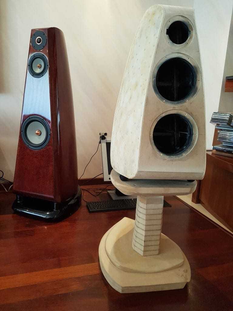

  3. Clarification, this is a polyurethane primer, I will be make veneer on the on cabinet's with "Birds of Maple".The first home tests are good.My current surround speakers of " Technics" CA-10 with a good sound from 1997, they are sadly retreated himself ... After the measurements, this is are Technical data:Frequence Range; 33-25000 HzLong term Max Power; 200 WCrossover Frequency; 2800 HzImpedance; 4 OhmsSensitivity; 90 db SPLCabinet Volume; 31 LGross weight / without stand /; 27kg.Joro RaitchevSofia- Bulgaria

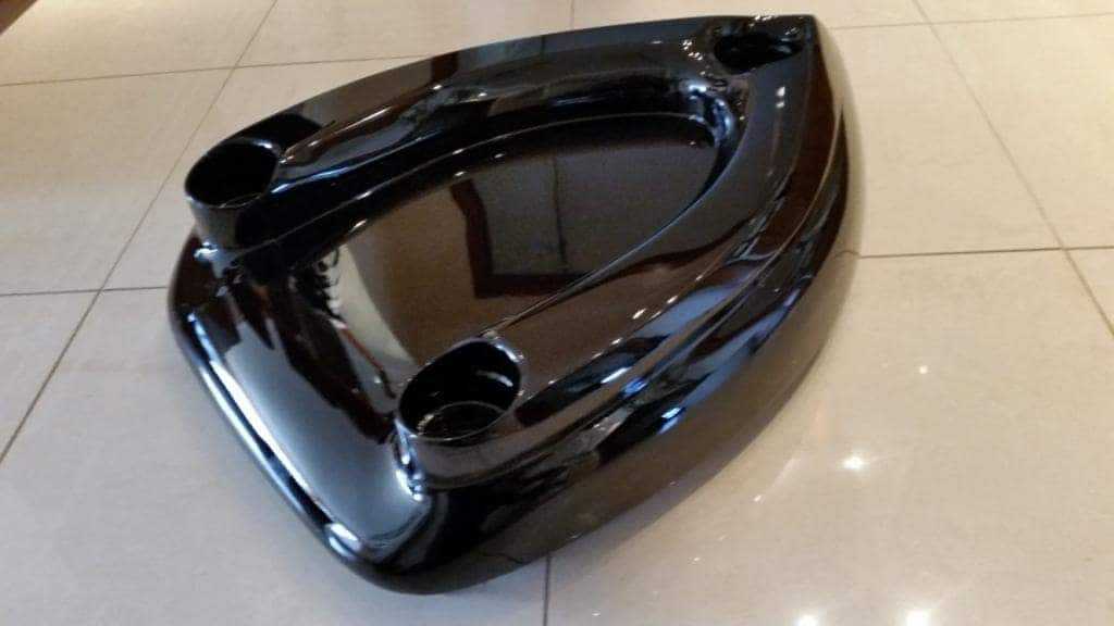

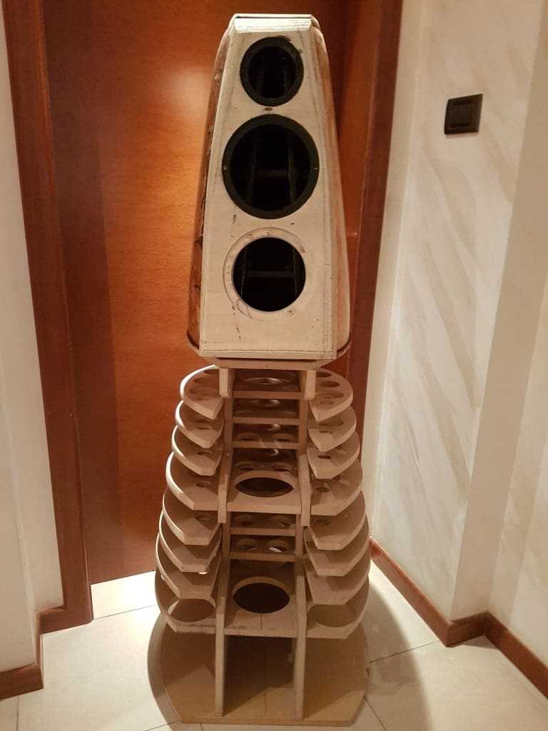

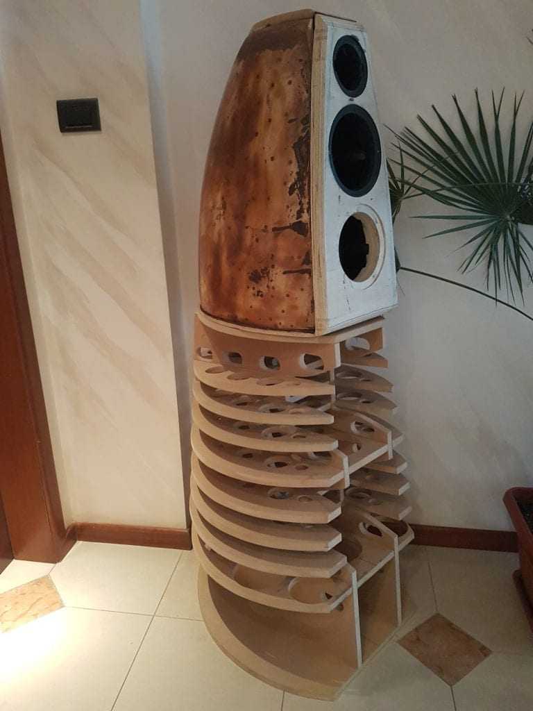

  8. Relax , there is a lot of work still on the stand! Similar was the situation with the bases of the central pillars;
  9. And a risky picture (everything is supported by gravity), how look for compared to the front speakers, are not on one line, but I rely on your imagination.

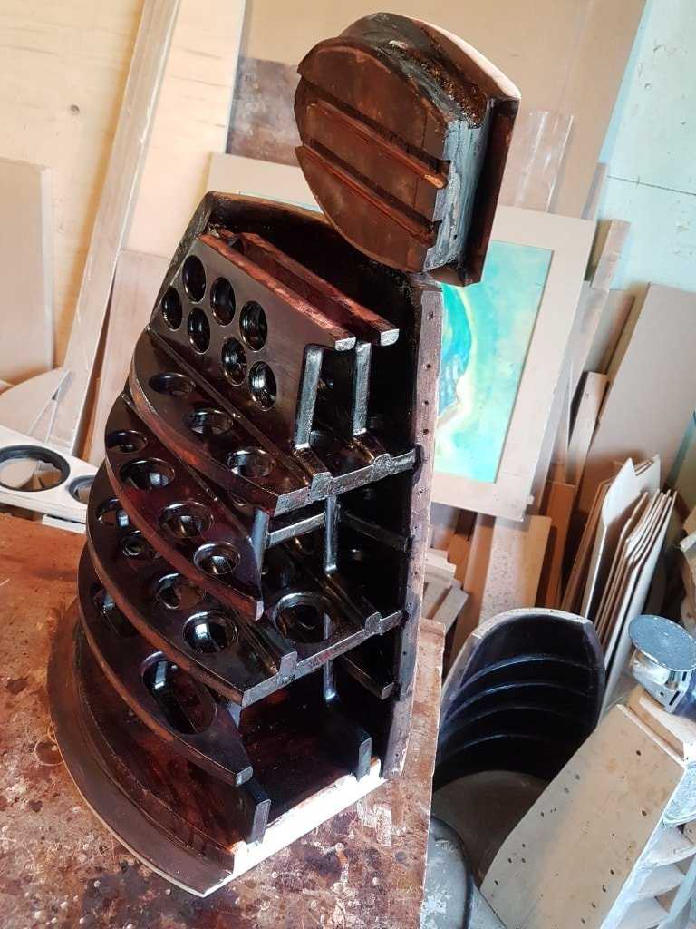

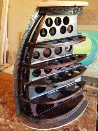

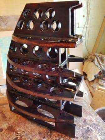

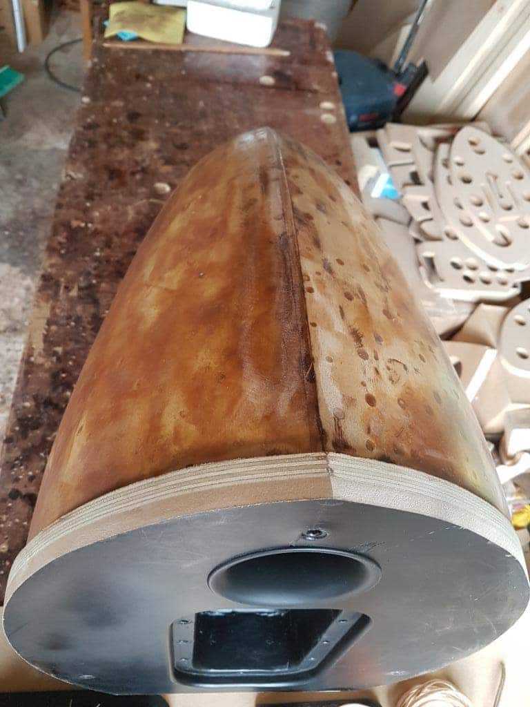

  10. A small structural change for the side panels, last layer is 1 x 4 mm plywood and everything is re ady for the measurements.

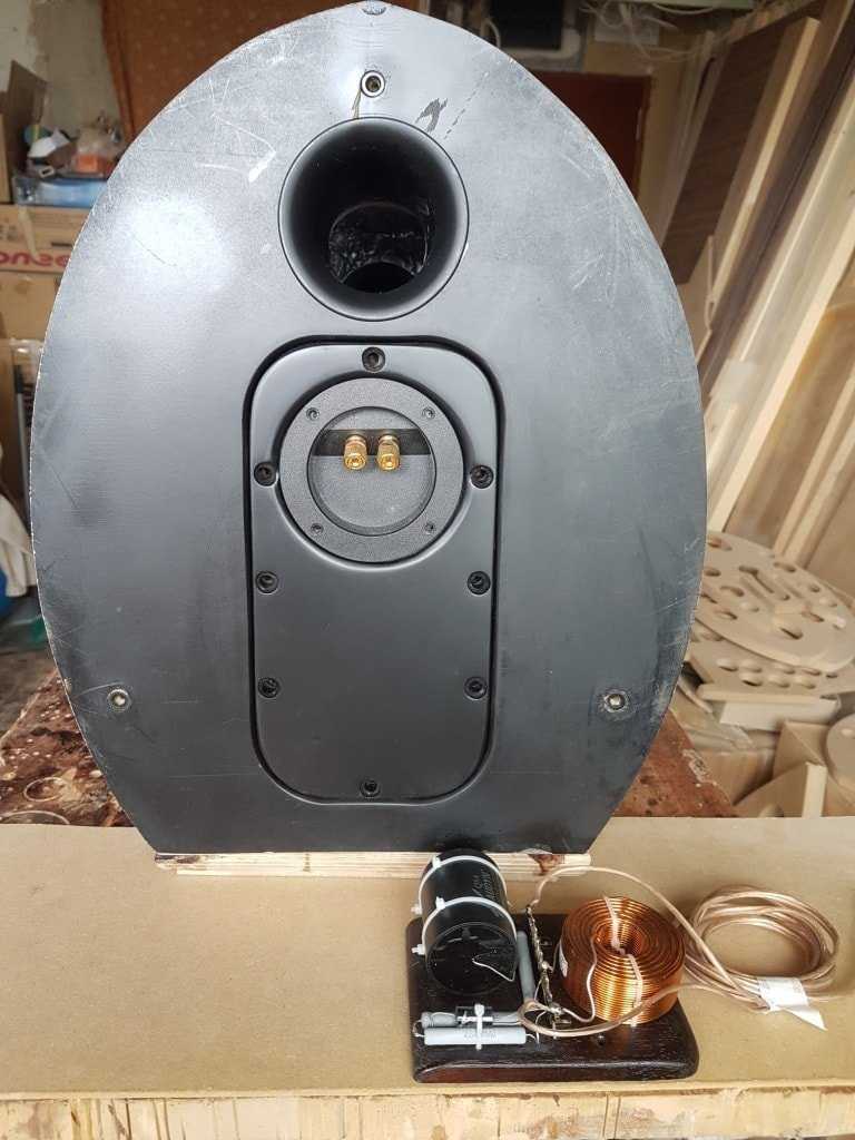

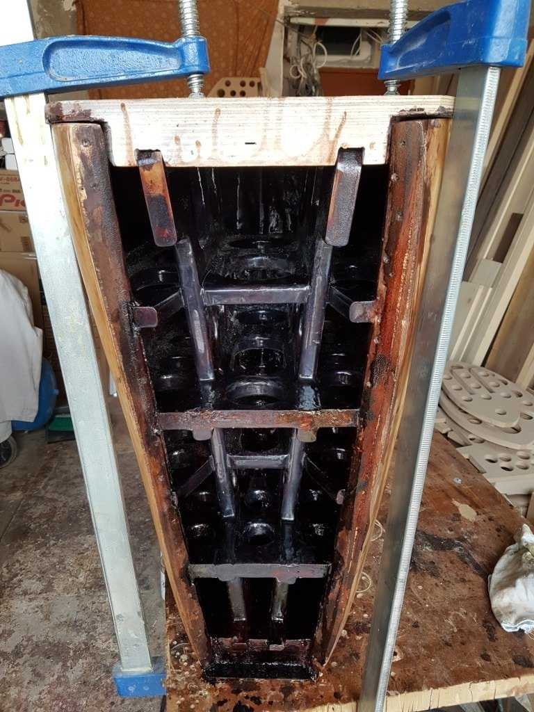

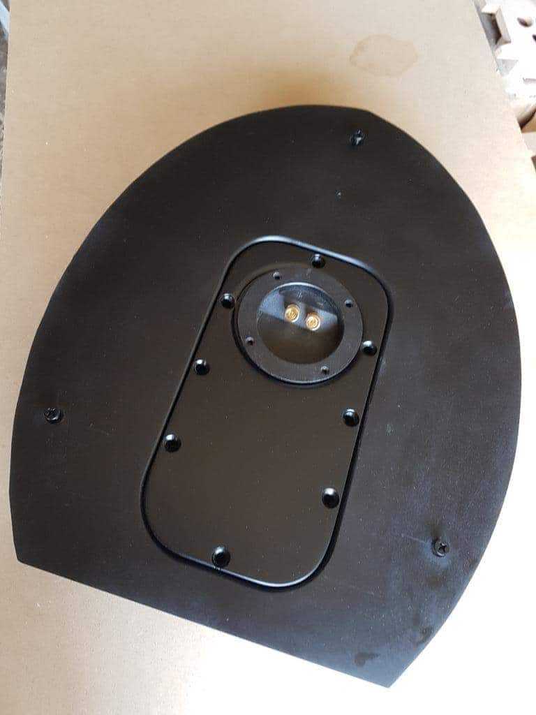

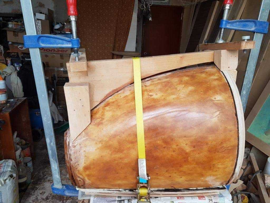

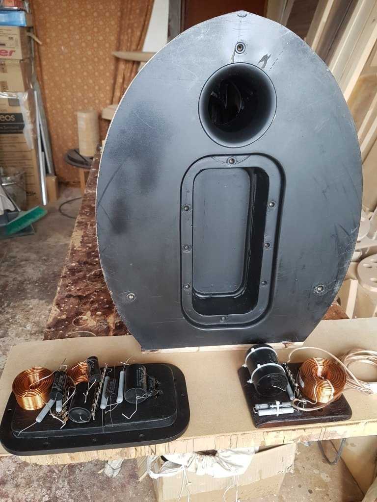

  11. I continue with the collection of the cabinet; Now I can make the exact measurement of the volume. And that's 31.5l, just as much as I need!Oh, l forget to show you what I did to get that volume!I maked a filter compartment (for the MW and TW), the W section will be in the box; I previously make the last layer-10 mm MDF / to get a sandwich construction / on the front panel and the bottom; Last constructive action ; After 10 hours I will install the last layers of 2 x 4 mm bent MDF;

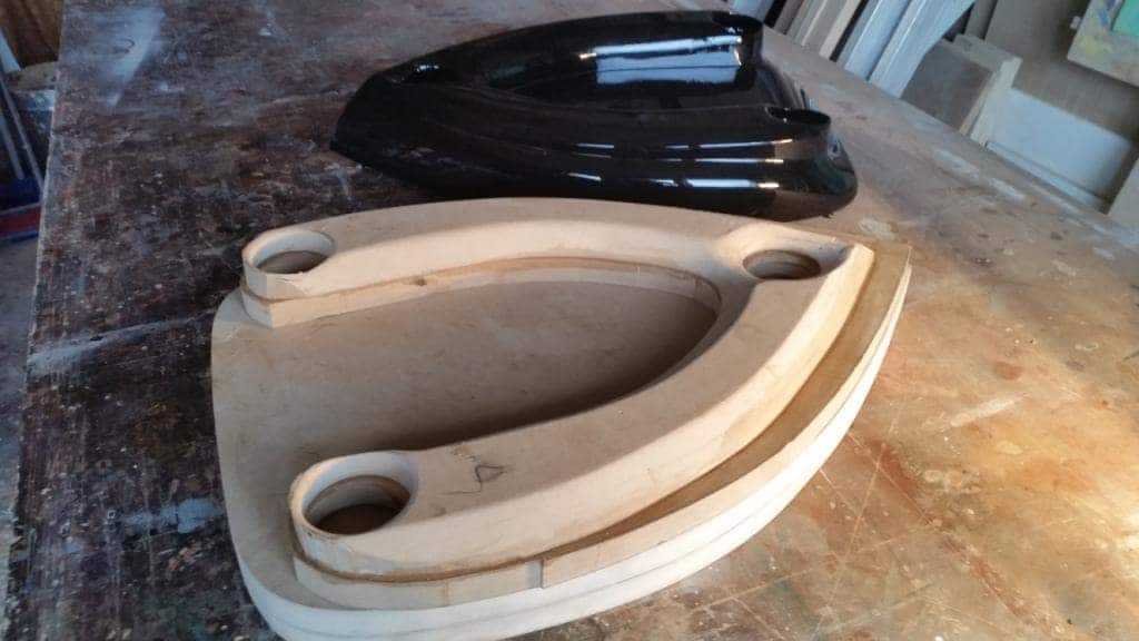

  12. And the original model will look like this;
  13. I have an idea to make a new project to in the base there should be two 10" loudspeakers - just an idea. They look like animals, maybe dinosaurs, but important are 20Hz.

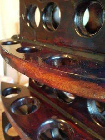

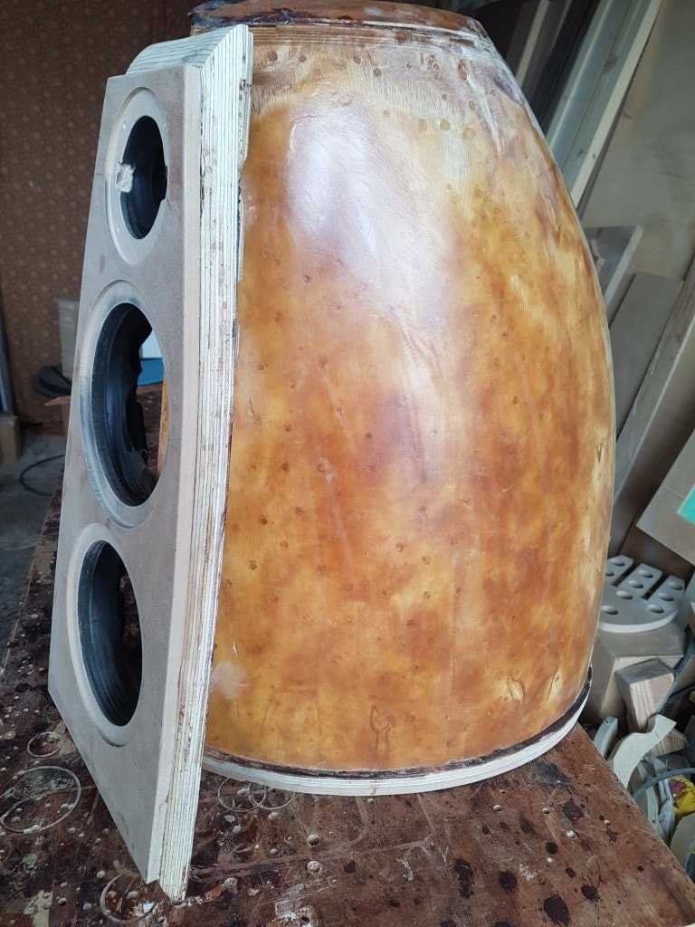

  14. Preprocessing of the internal ribbing; I can now start collecting the cabinet;

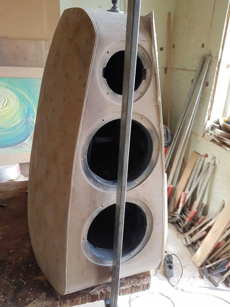

  22. The moment has come when i must find a volume of complex shape, before that I have to do some preparation. From waste material I made this gadget ,that takes part in the measurements and when assembling the cabinet: I have to do some preparation of the details; On the sixth photo, the red line is the waterline,must be fill with water next to it / everything must be perfectly horizontally!/. -I measure the weight of the my vented inner construction - 3.5 kg.-The amount of water is 42 l. in the box; 42-3,5= 38,5l, 4.5 l more than what's needed - what's next?I know the total volume, now everything is very simple there are several options for correction;- purely mathematical / small planarity, simple algebra and axonometry /- methodically- it can be done in several ways.There are more options ..later.
