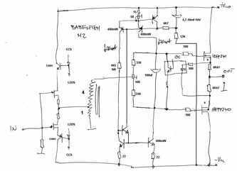

    GK 71 tube amp
    jest ........ al trista ampera !!:buehehe:poenta je da je bolje od AC ili CCS grejanja , bar za moje usi ........ i - da je proban koncept
  2. Zen Mod
    GK 71 tube amp
    grejanje treba uraditi sa nekim najmodernijim fazonima ;sa jedne strane filamenta ide cap multiplier a sa druge CCS ; oba sa snaznim bipolarcima , sto manje kapacitivnosti;ja sam testirao koncept na malom line stage sa ZA5502 , triodni spoj ni s ni b od smetnjial' jeb'ga - jos peska u kutiji ........

    GK 71 tube amp
    terat' lanpu sa mosfet folowerom naravno CCS loaded , cascodedonda ni brige ni pameti - lako izlaznu uterat , lako i driveru jer se ne mora borit sa Mileromnaravno - i dalje ostaje da driver mora imat mooda - sto swinga , sto Ri , sto struje

    dadoh ja krive za triodu a bb ih zaboravio prepostati ovdeza trafo kontam da bi Yves napravio proracun u koji ja apsolutno ne sumnjam , naravno posle izbora jezgrasad - ko bi to namotao - ja ne bih sigurno
  8. uff siroko pitanje ........ mozes malo da suzis - konkretna primena i sl .
  9. performance/safer ; it will give firmer base current to programming transistor in both CCS-es ; reeeeeeeeeaaaaaaaaaaaalllllly non-economic ;cap multiplier is OK ( I almost like them for power stages ) ........ maybe even sort of series reg ( I don't like them for power stages ) but shunt reg will result in insane vaste of energy/heat

  16. naaah ....... I don't really care if you can cope with loss of power , then you can cope with even more triode transfer function :buehehe:at 4mA ( sweet spot for LED in CNY) there is ~1V1 across LEDso - 1A4 ...... 1V1 ..... demands overall ( two MOX in series) 0R785Papa obviously have few Rabbits more in his sleeve
  17. I need to find table with CNY LED voltages vs. currentI remember I made it and maybe even post it in thread that will tell us what's lowest voltage we can have across middle resistors
  18. :tongue10:nacrtaj mu onda ti ......

    ma pusti ga Sipi , da se malo izduva bio mi danas B'ta B'ne , naisao u sigurnu kucu da se iskuka dobro - samo televonski .......sam je on dosao do resenja sa paralelisanjem , ali se dovoljno namucio i sa ovim jednim izlaznim i jednim u CCS-u i jednim kao ulazni buffer - sto se tice montaze ja sam bar stekao utisak da se debelo nasekirao i debelo porazmisljao , pre nego sto je odlucio da batali al' sam ga utesio najbitnijim - izdurao je sve , isterao sve ideje i koncept ........ i sad je jednostavno dosao do praga sa tehnologijom kako vidim to - bio bi problem spojiti i dva izlazna a kamoli 3 u paralelu , zbog current hogginga koji bi se neumitno javio ........ a da stavlja straobalne E ili C otpore ...... tek onda nije nista uradioCCS moze da resi i sa mosfetom , ali bi to biilo mnogo manje od pola posla ......najdragocenije nije izgubio nikako napustanjem koncepcije - ostaje mu znanje i praksa koju je stekao sad moze da pravi sta god hoce ......... prevalio je pocetak poprilicno :Viannen_loungelizard:edit: ne podrzavam ga u napustanju projekta ;podrzavam ga - sta god da resi ....... bio je izvanredan mali od palube ........ a sad je vec avanzovao
