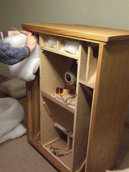

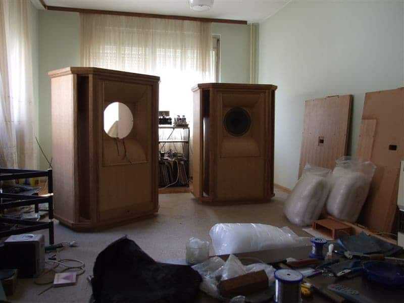

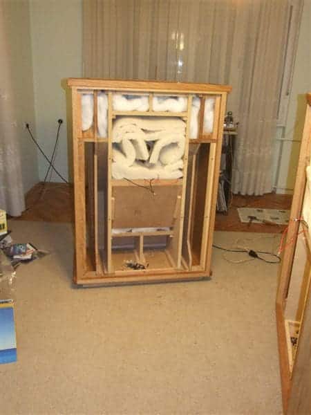

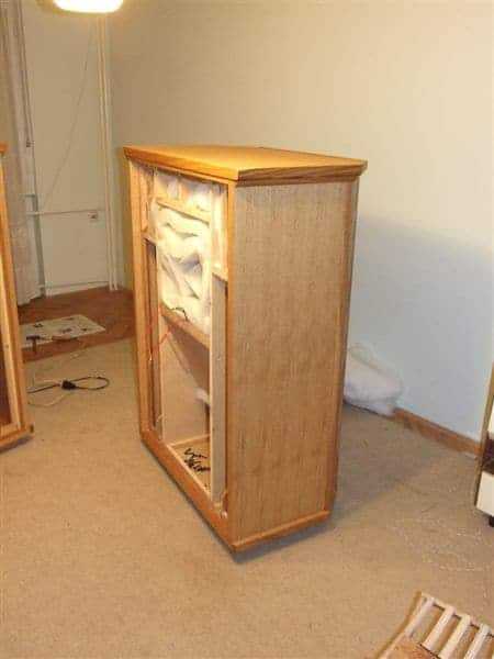

Eci Napisano Oktobar 28, 2010 Autor #133 Napisano Oktobar 28, 2010 Priprema za dampiranje kutija...Dampira se kompresioni deo kutije, dampira se iza drivera sa Visaton prirodnom vunom, ostatak iznad tunela sa koflinomPotrebna količina damping materijala je 6-8 pakovanja prirodne vune i 3-4 pakovanja koflina Preparing for damping...The compression part of the box should be damped. Behind the DC driver with Visaton natural wool, the rest above the tunnel, with IT Sonofil Polyester Required amount of damping material: 6-8 packs of natural wool and 12-14 packs of polyester

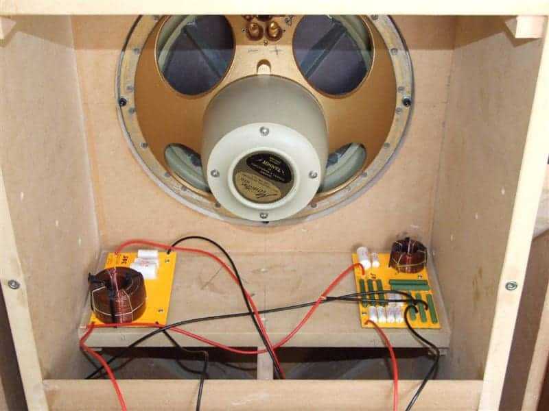

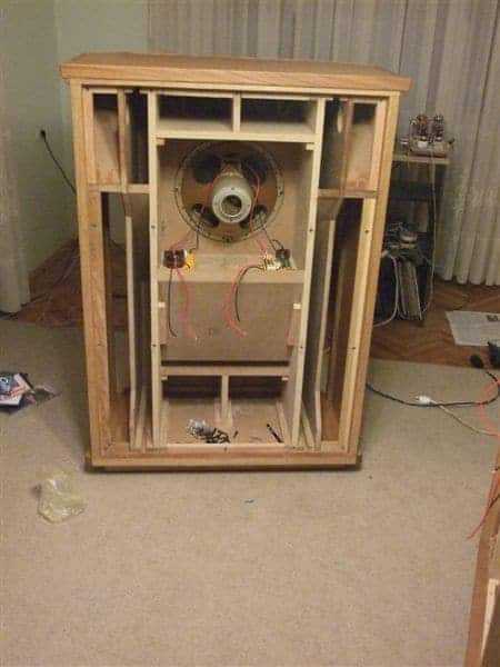

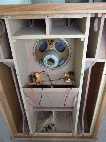

Eci Napisano Oktobar 28, 2010 Autor #134 Napisano Oktobar 28, 2010 Situacija pre dampiranja, ubačeni su driver i skretnica (posebne pločice woofer i tweeter) Before the damping material was inserted, the DC driver is inserted and also the crossover boards are mounted (separate boards for the woofer and tweeter)
Eci Napisano Oktobar 28, 2010 Autor #135 Napisano Oktobar 28, 2010 Na ovim slikama se lepo vide letvice koje drže rubove dela E, kao i ubačene matice 6mm za koje se pričvršćuje deo E On these pictures you can see clearly moldings which are holding the edges of part E, and also into them inserted 6mm nuts, for which attaches part E

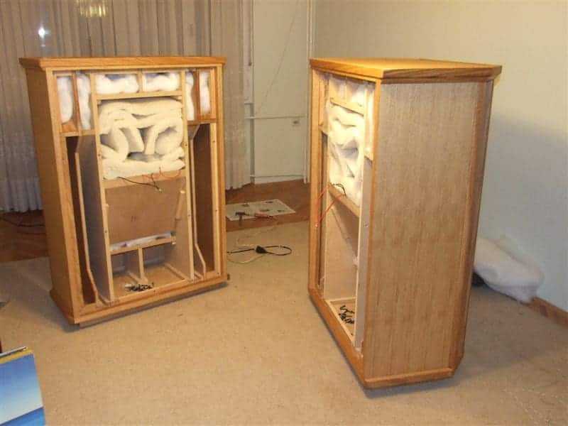

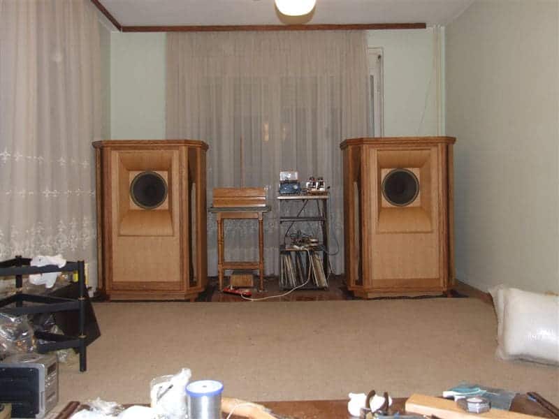

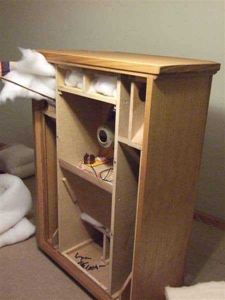

Eci Napisano Oktobar 28, 2010 Autor #136 Napisano Oktobar 28, 2010 Kreće dampiranje.. Starts the damping process..
Eci Napisano Oktobar 28, 2010 Autor #137 Napisano Oktobar 28, 2010 Dampiranje završeno End of damping process

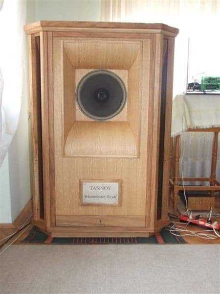

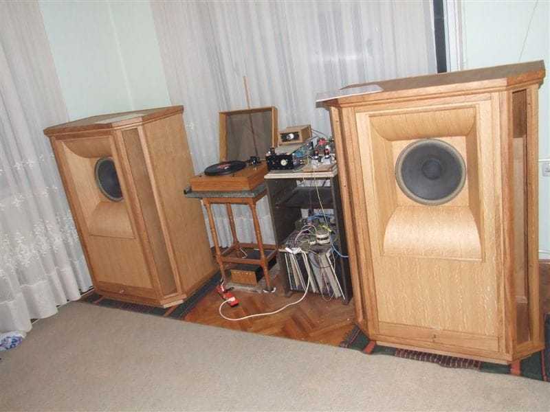

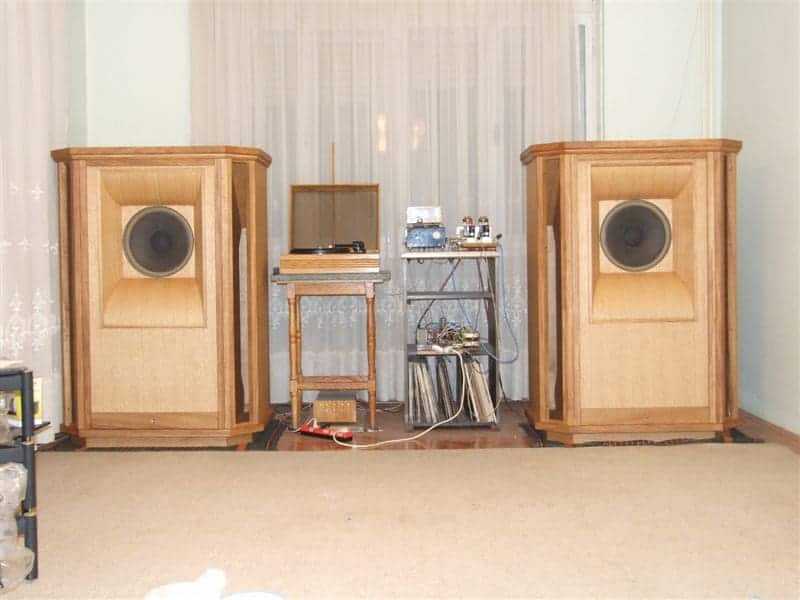

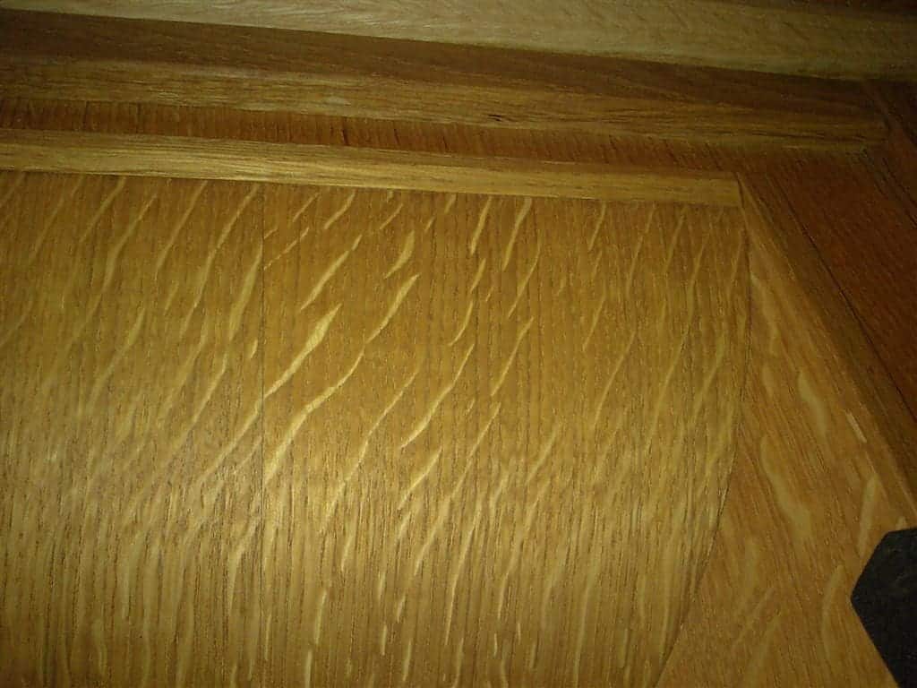

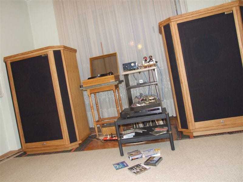

Eci Napisano Oktobar 28, 2010 Autor #138 Napisano Oktobar 28, 2010 Deo N je montiran, kao i deo X, kutije su spremne za rad. Finiš je radjen lanenim uljem. Kutije su premazivane/obradjivane vodenom šmirglom 6 puta. Jedan tretman para traje više od dva sataPotrebno je oko 1L lanenog ulja.Parts N and E and X are mounted, the boxes are ready.The finish was made with flax oil. The boxes were 6 times coated and treated with sandpaper (gradation 600). One treatment for two boxes takes more than two hoursIt takes about 1L flax oil

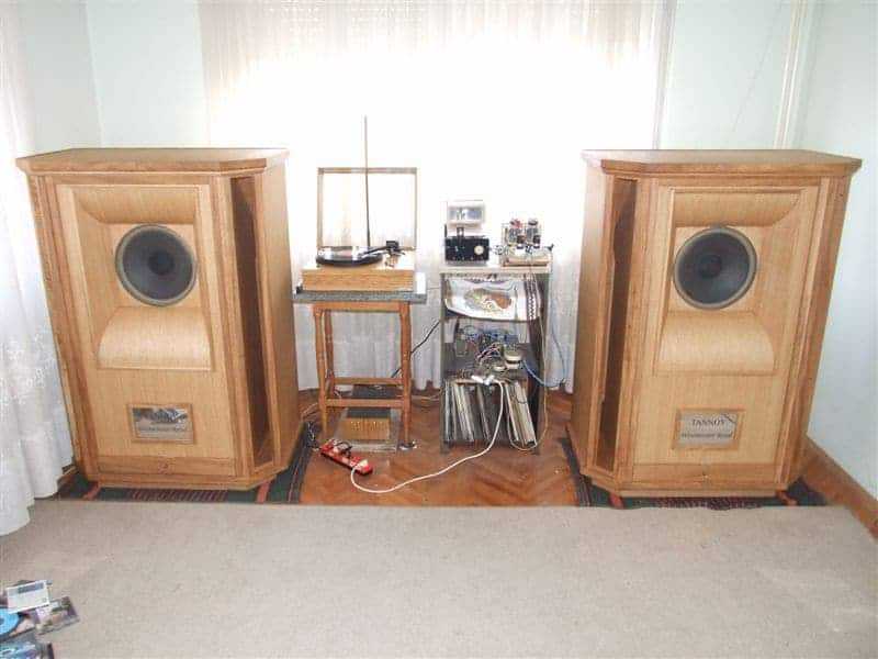

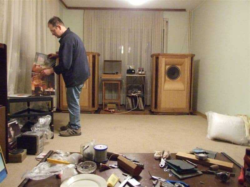

Eci Napisano Oktobar 28, 2010 Autor #139 Napisano Oktobar 28, 2010 Prva ploča, Diana Krall : Temptation, remake one scene sa Grčkim audiofilima.. Tek kasnije sam video da čovek nema Westminster.. The first vinyl, Diana Krall: Temptation, a remake of the scene with the Greek audiophiles from the Youtube .. Much later I saw , that man has no Westminster..

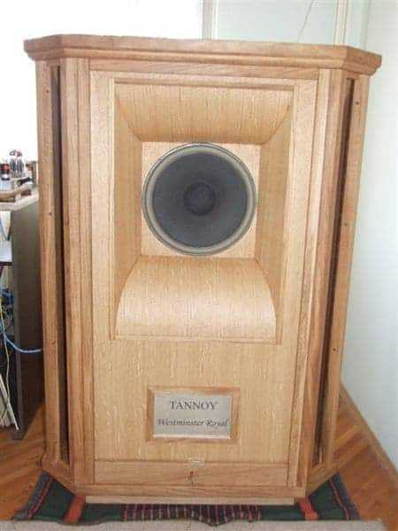

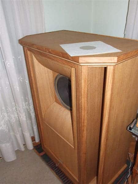

Eci Napisano Oktobar 28, 2010 Autor #141 Napisano Oktobar 28, 2010 Dodata je ukrasna pločica od prohroma A decorative stainless steel tile was added Jimi Go and dejanco32 je reagovao/la na ovo 1 1

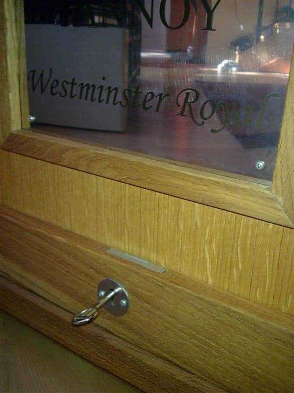

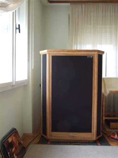

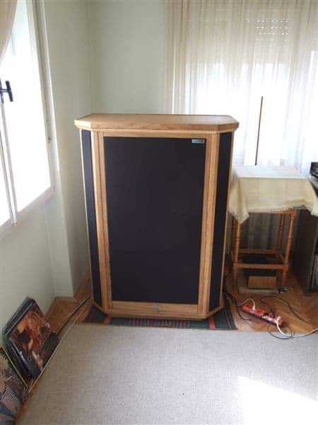

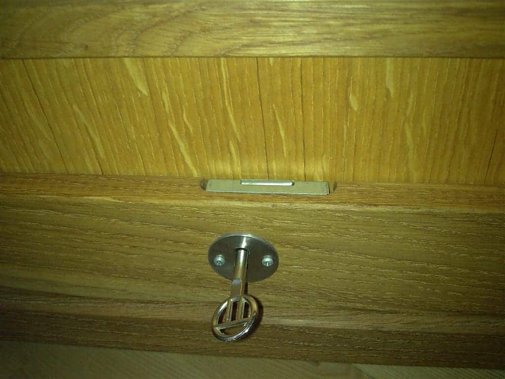

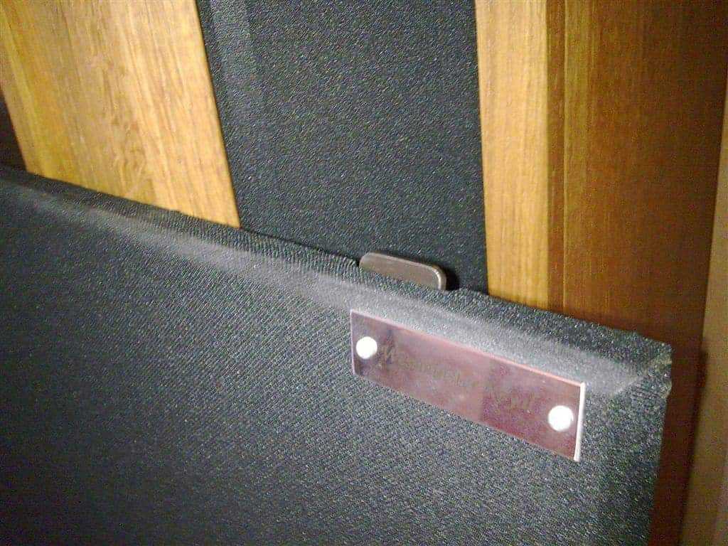

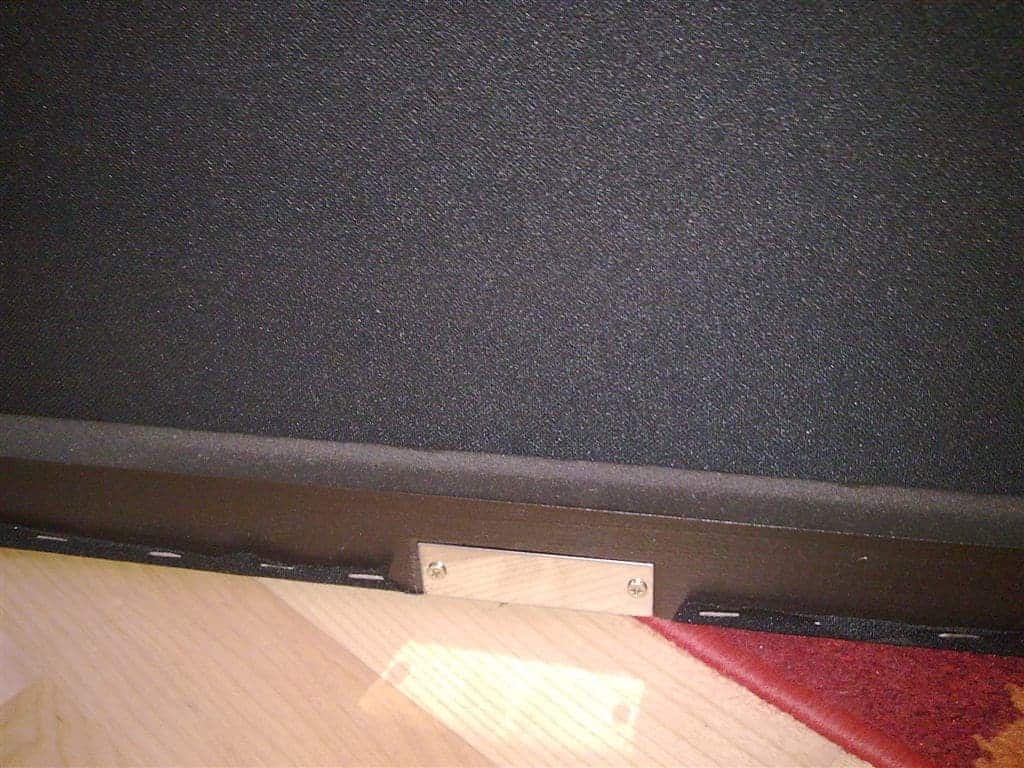

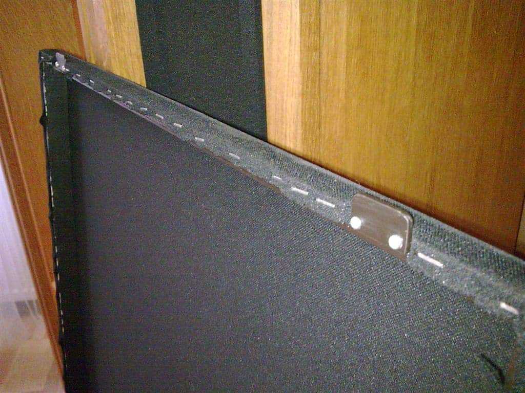

Eci Napisano Oktobar 28, 2010 Autor #142 Napisano Oktobar 28, 2010 Zaštitne maske su stavljene. Ramovi su izradjeni od bukve, dimenzije se uzimaju sa gotovih kutija. Deo kod lajsne Z, ima jezičke na dva mesta , i kači se ispod te lajsne. Deo koji ide iznad lajsne X, mora da se izdubi na sredini i napravi od prohroma deo koji će obezbedjivati jezičak brave da ne ispada, kada se maska zaključa.Napravljene su i ukrasne ključaonice od prohroma.Ovim se ovaj cook book izrade Tannoy WMR završava. :yes3:Ostaje još da prezentujem skretnicu koju sam stavio.The decorative masks were put on. The frames for the masks are made of beech, the dimensions should be taken from the finished boxes. Part of the frame beneath the molding Z has two tabs, and attaches with them for this molding. The part of the frame above the part X should have hole in the middle. Than make a tile from stainless steel, this provides that the tab lock does not fall out, when the mask is locked.Also were made stainless steel decorative keyholes.With this, the cookbook how to make the Tannoy WMR ends. :yes3:It only remains to present the crossover that is used. dejanco32 and Jimi Go je reagovao/la na ovo 1 1

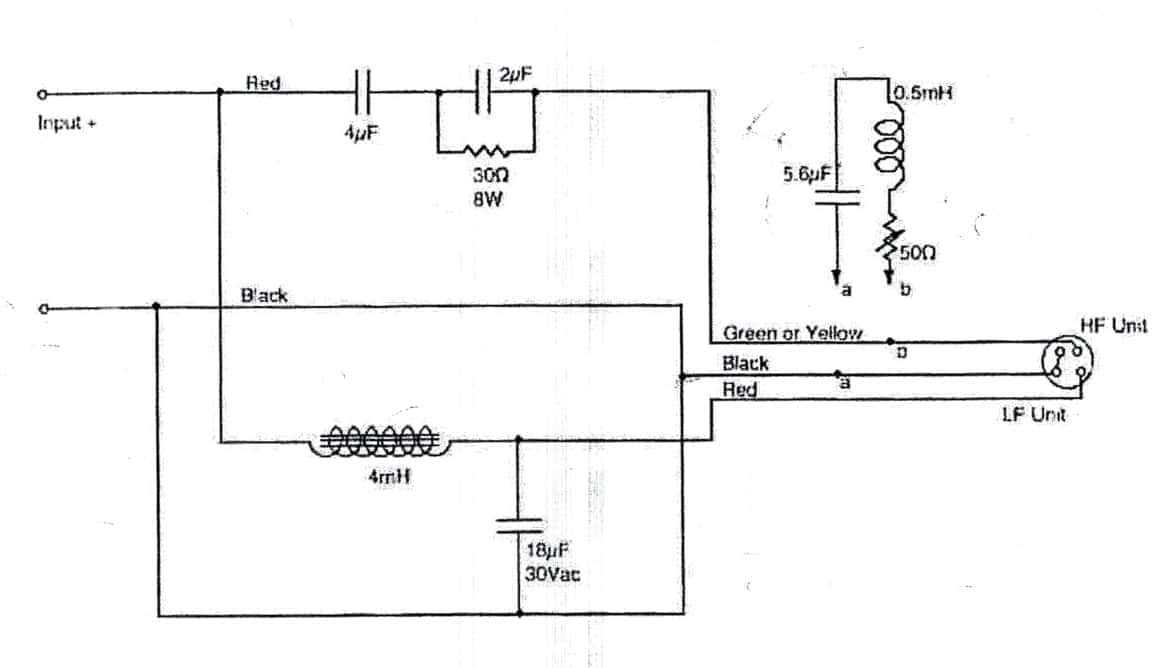

Eci Napisano Oktobar 28, 2010 Autor #143 Napisano Oktobar 28, 2010 Skretnica : klasična Tannoy kreacija The crossover: classic Tannoy design Jimi Go je reagovao/la na ovo 1
Eci Napisano Oktobar 28, 2010 Autor #144 Napisano Oktobar 28, 2010 Izgled pločica, spisak delova je u PDF-u. Kalemi su vazdušni, potenciometar u paralelnoj grani sa visokotoncem je izbačen. Umesto njega su stavljeni redno vezani otpornici od 10 Ohma, u zavisnosti gde se zalemi masa, dobije se željena vrednost otpornosti ( od kratkog spoja do 50 Ohma, u koracima od 10 ). U ovom slučaju je stavljena vrednost od 30 Ohma, vrednost odredjena slušanjem. Unutrašnje ožičenje je izvedeno Novkabel kablovima od 4 mm2. Konektori su WBT 0763 To bi bilo sve. How the crossover boards looks like, the parts list is shown on the PDF. All the inductors are with air core, the potentiometer in the parallel branch with the tweeter is thrown out. Instead of it, serial connected resistors of 10 Ohms were put in this branch .Depending where the connector/loudspeaker minus is soldered, we can obtain the desired value of resistance (from short circuit up to 50 Ohms, in steps of 10). In this case, 30 Ohms was set, a value determined by listening. The internal wiring is made with Novkabel cables of 4mm2. The connectors are WBT 0763 That's all. Tannoy Crossover 1.pdf Jimi Go and dejanco32 je reagovao/la na ovo 1 1
