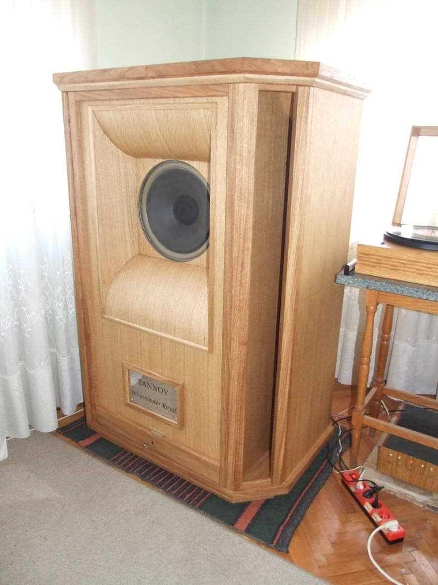

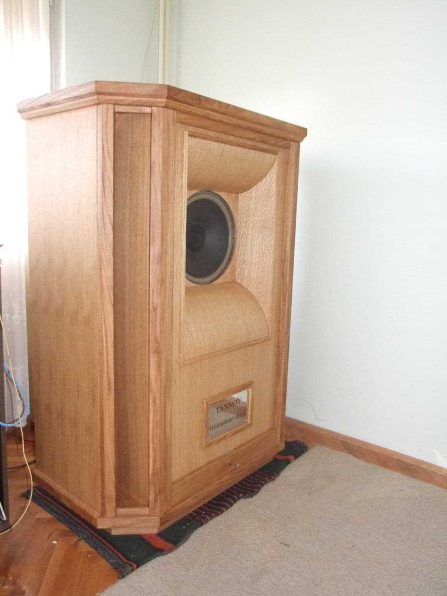

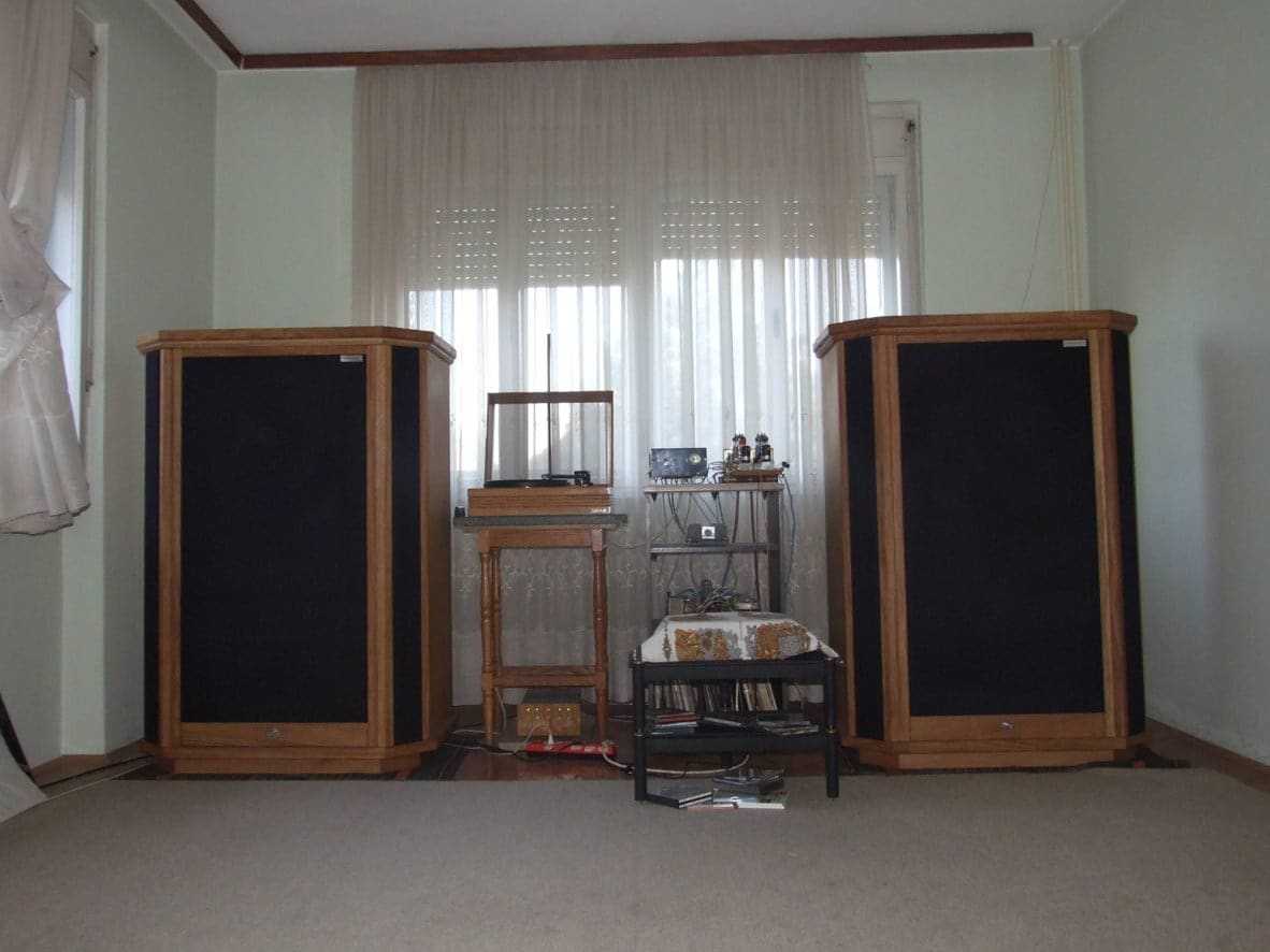

Eci Napisano Oktobar 22, 2010 Share #1 Napisano Oktobar 22, 2010 Projekat je radjen krajem 2007 i početkom 2008 godine. Sve je krenulo sa parom HPD385 i planom ovih kutija, koji ću objaviti u nepromenjenom obliku. Plan sam morao korigovati, dimenzije sam prilagodio debljinama materijala koji se mogu naći kod nas. Gradnja ovih kutija zahteva jako mnogo vremena, snage, volje itd. Bez pomoći profesionalnog stolara ne treba započeti gradnju. Evo nekoliko slika za početak kako izgledaju gotove kutije. This project was made at the end of 2007. and beginning of 2008. The whole story started with a pair Tannoy HPD385 DC drivers and with the blueprint for this box, which I will publish in unaltered form. I had to adjust the blueprint, and also to correct it for the thicknesses of materials that can be found here. Building of these boxes requires a lot of time, strength, will… Do not start to build the speakers without help of professional carpenter; For the start, here are some pictures of the finished boxes. Link to comment Podeli na ovim sajtovima More sharing options...

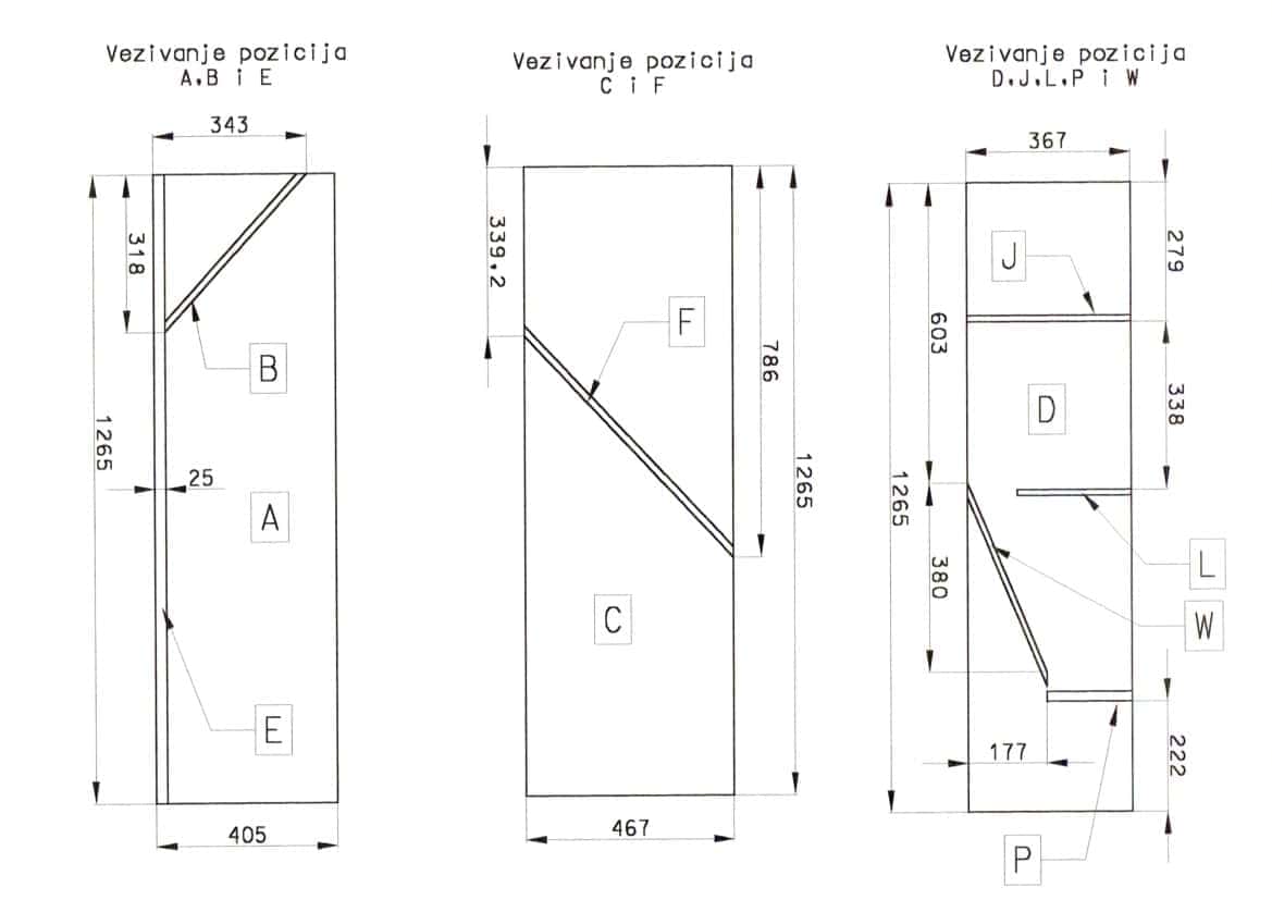

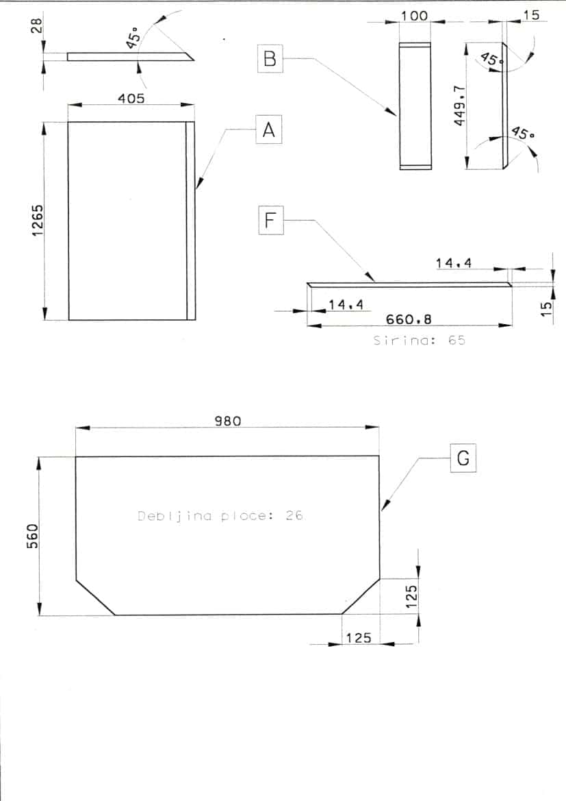

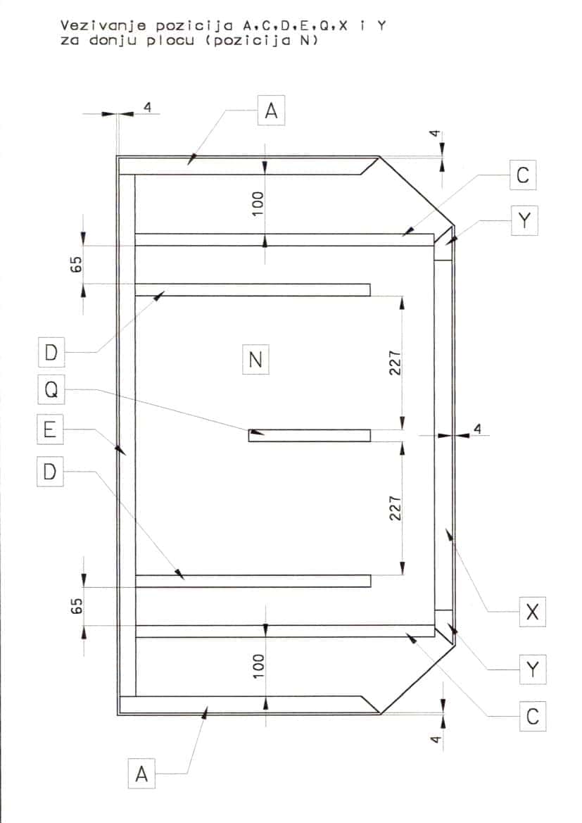

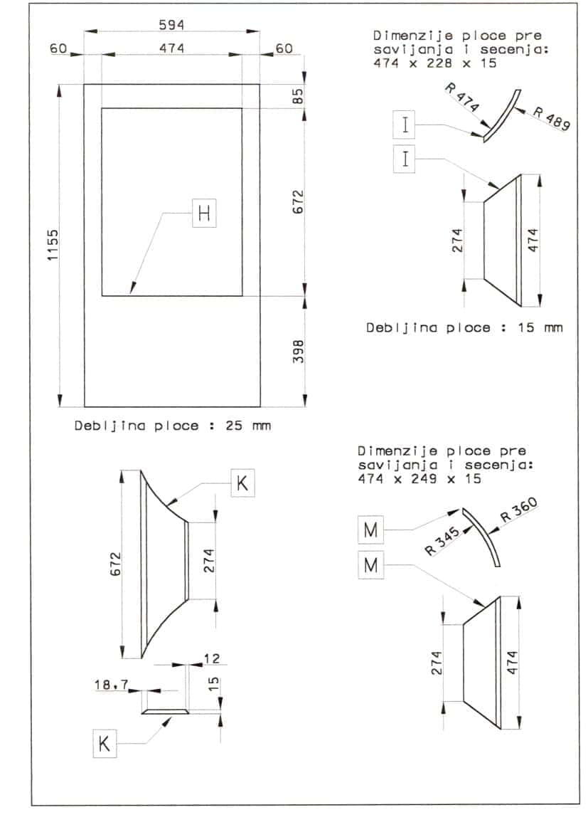

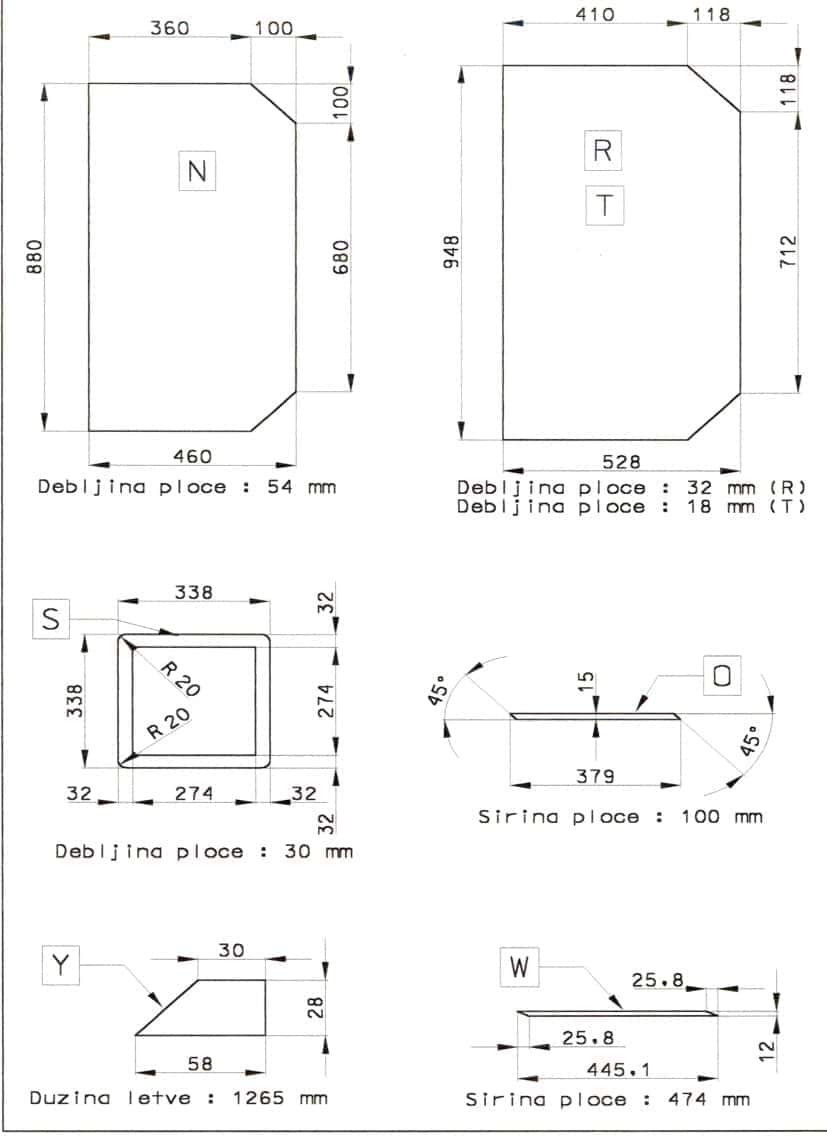

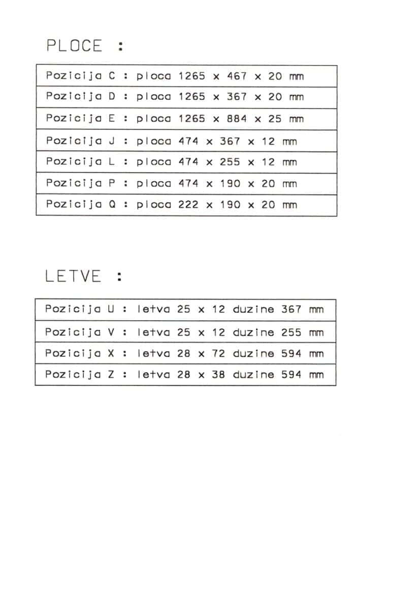

Eci Napisano Oktobar 22, 2010 Autor Share #13 Napisano Oktobar 22, 2010 A ovo je korigovani plan, po kojem su kutije radjene. Sa originalnog crteža sam koristio explode view ( Plan8 ), nisam radio u nekom od 3d cad programa. This is the revised blueprint; the making of boxes is based on it. From the original drawing I used the explode view ( Plan8 );I did not used any of 3d cad programs. WMR 1.pdf WMR 2.pdf WMR 3.pdf WMR 4.pdf WMR 5.pdf WMR 6.pdf WMR 7.pdf WMR 8.pdf WMR 9.pdf WMR 10.pdf WMR 11.pdf WMR 12.pdf WMR 13.pdf WMR 14.pdf WMR 15.pdf WMR 16.pdf WMR 17.pdf WMR 18.pdf WMR 19.pdf Huy vu and 15to12 je reagovao/la na ovo 2 Link to comment Podeli na ovim sajtovima More sharing options...

Eci Napisano Oktobar 23, 2010 Autor Share #15 Napisano Oktobar 23, 2010 Izrada kutija je trajala oko dva meseca, od toga više od mesec dana je trajala priprema - nabavka materijala, nalaženje pravih osoba za odredjene postupke oko izrade pojedinih delova.Na krojnoj listi ( WMR19 )fali: 1 daska hrast dužine 5m širine 40cm i debljine 5,5cm potrebna za ukrasne lajsne, 1 daska bukva dužine 4m širine 20cm debljine 2,5cm potrebna za izradu upornika i ramova za maske. Takodje potrbno je oko 18kg lepka za drvo ( Henkel moment ) i više od 2kg Henkel ekspres lepka ( kao univerzalni ) za lepljenje furnira na manje površine. Korišćen je hrastov furnir ( slavonski, extra kvalitet ), potrebno je oko 30m2 za komotan rad.Lepljenje furnira: zbog ogromnih ravnih površina, ručno je to nemoguće izvesti. Treba naći presu, najbolje kod stolara koji izradjuju vrata, imaju prese 2mx1m i furniranje je tada besprekorno. Neke stranice treba unapred furnirati, kao i neke delove - pre same gradnje. Pogledati explode view :A : obe straneB : duža stranaC : jedna strana ( jedna leva i jedna desna po kutiji )E : jedna strana kompletno, druga strana delimično ( zadnja vidljiva strana tunela )G : jedna stranaH : jedna stranaR i G : po dve trake, gornji i donji deo tunela. Slike slede: The production of this boxes lasted about two months, more than a month took me to prepare: procurement of materials, finding the right people for production of several parts. On the cut out list (WMR19) is missing: 1 oak plank width 40cm, 5m long and 5.5 cm thickness what is needed for decorative moldings. 1 beech plank width 20cm, 4m long and 2.5 cm thickness required to produce internal moldings and for the frames of decorative masks. Also is needed about 18kg wood glue ( Henkel Moment ) and more than 2kg Henkel Express glue (as universal glue ) for sticking veneer on smaller areas. Oak veneer was used ( from Slavonia/Croatia, extra quality ), needed about 30m2 for comfortable work. How to stick the veneer: because of the huge flat surfaces, with hand work that is impossible to manage. It is the best to find a press with dimensions 2m x 1m by some carpenter which makes doors, with this press the veneering is perfect. Some parts should be veneered in advance. Take a look to explode view: A: both sides B: longer side C: one side (one left and one right for each box) E: one side completely, the other side partly (the visible rear side of the tunnel) G: one side H: one side R and G: two strips, the top and the bottom of the tunnel Pictures are following: Link to comment Podeli na ovim sajtovima More sharing options...

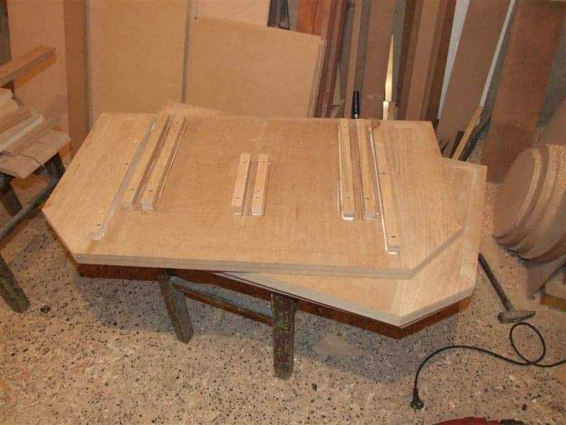

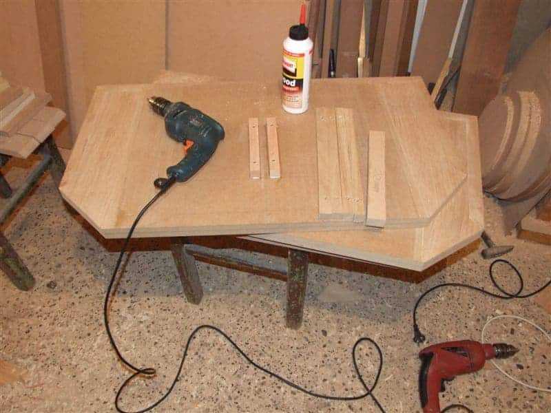

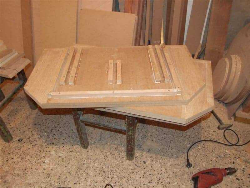

Eci Napisano Oktobar 23, 2010 Autor Share #16 Napisano Oktobar 23, 2010 Ovo je prvi korak. Radi se o delu R, na kojem su iscrtane linije gde treba postaviti lajsne. Vidi se takodje da je donji deo tunela isfurniran. Lajsne su postavljene za deo Q. This is the first step. Here is the R part, on it are drawn marking lines, where the moldings should be placed. You also can see that the lower part of the tunnel is veneered in advance. Moldings are set for a part Q. Link to comment Podeli na ovim sajtovima More sharing options...

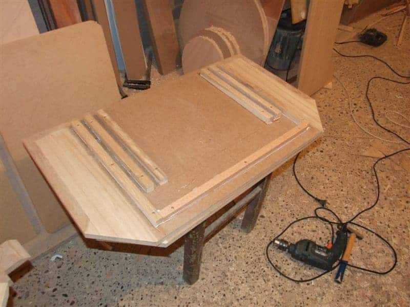

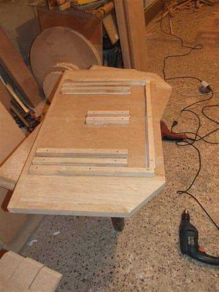

Eci Napisano Oktobar 23, 2010 Autor Share #17 Napisano Oktobar 23, 2010 Lajsne za stranice DMoldings for D sides Link to comment Podeli na ovim sajtovima More sharing options...

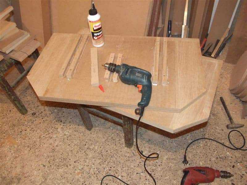

Eci Napisano Oktobar 23, 2010 Autor Share #18 Napisano Oktobar 23, 2010 Za stranice CFor C sides Link to comment Podeli na ovim sajtovima More sharing options...
Eci Napisano Oktobar 23, 2010 Autor Share #19 Napisano Oktobar 23, 2010 Isti momenat iz drugog ugla The same picture from a different angle Link to comment Podeli na ovim sajtovima More sharing options...

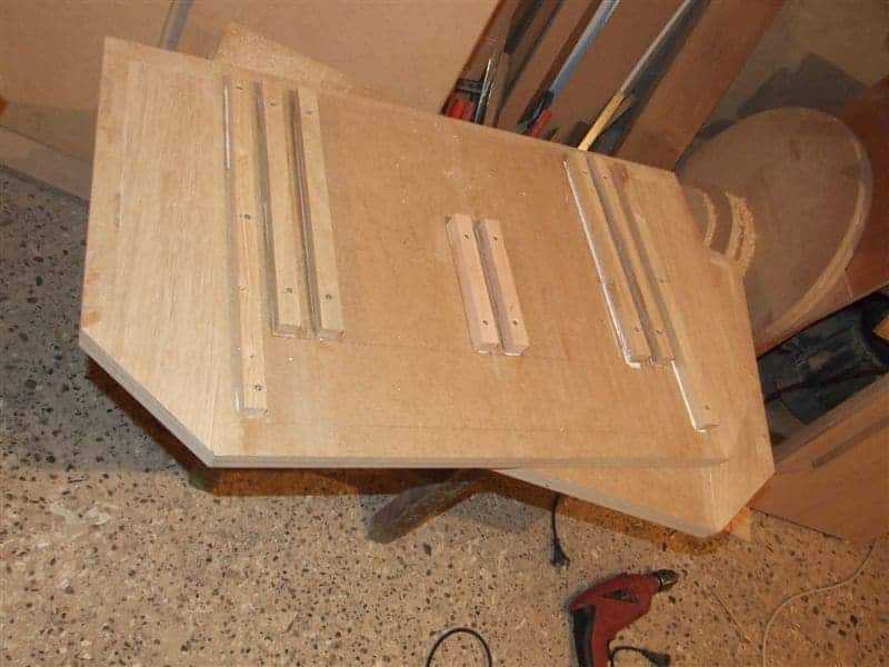

Eci Napisano Oktobar 23, 2010 Autor Share #20 Napisano Oktobar 23, 2010 I za prednju stranicu H And for the front side H Link to comment Podeli na ovim sajtovima More sharing options...
Eci Napisano Oktobar 23, 2010 Autor Share #21 Napisano Oktobar 23, 2010 Izgled kompletnog dela R The look of completed part R Link to comment Podeli na ovim sajtovima More sharing options...
