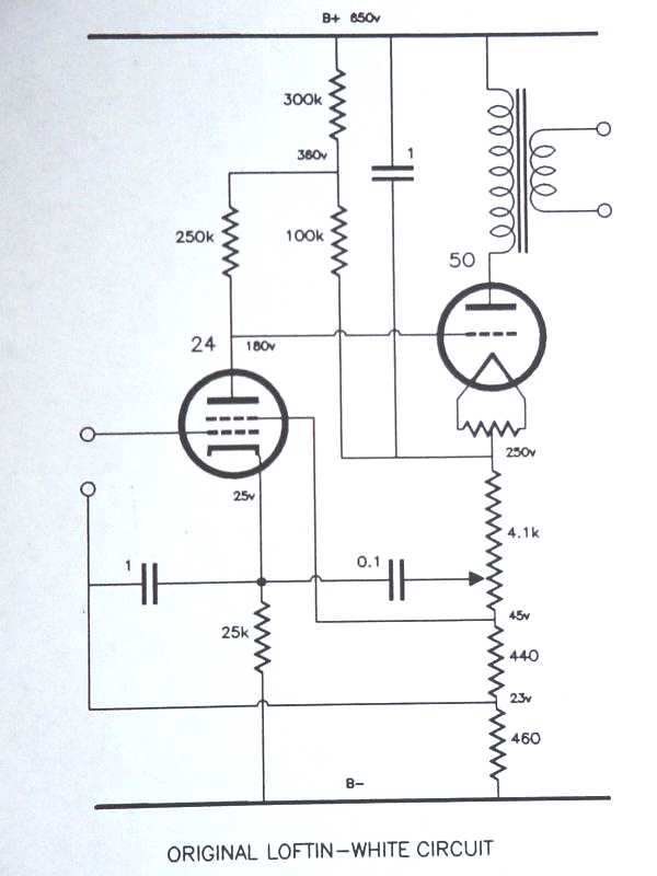

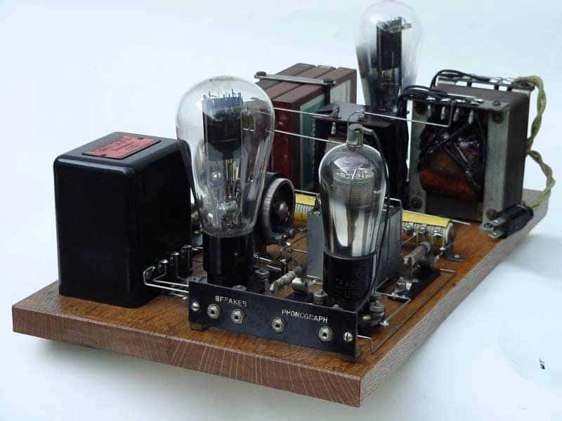

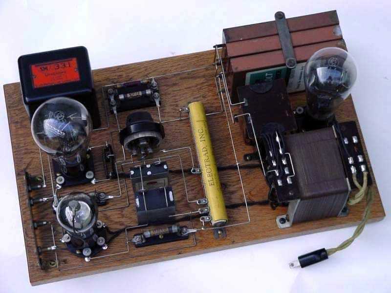

Zen Mod Napisano Mart 4, 2010 Share #1 Napisano Mart 4, 2010 zarad mode , kojom se maltene svaka DC sprega izmedju stepena naziva Loftin - White , mozda je korisno prisetiti se sta se stvarno podrazumeva pod istim ; svojevremeno sacuvao stranicu i fajlove sa neta ;navod sa stranice , koja vise ne postoji : Loftin - White , reproduction by Alan Douglas In the course of writing an article on the Loftin-White circuit which appeared in Vacuum Tube Valley issue no.6 (Winter 1997), I wanted an actual amplifier to illustrate the article and for testing. While some breadboard models were illustrated in the original 1930 Radio News articles, there were no definitive plans published, and essentially no samples survive. So I created my own, using period components and following "breadboard" wiring practice. The only item not from 1930 is the 25K Ohiohm cathode resistor: even the oak board was a bit of office furniture that my father brought home after a remodeling job in the 1940s. And I did hide new mylar caps inside the old high-voltage filter cans.The full account is in the VTV article (www.vacuumtube.com): the history of Loftin and White's work, the (non)-acceptance of their design, my own building project, and a complete bibliography of all Loftin & White and related magazine articles from the 1930s.slicice reprodukcije : Link to comment Podeli na ovim sajtovima More sharing options...

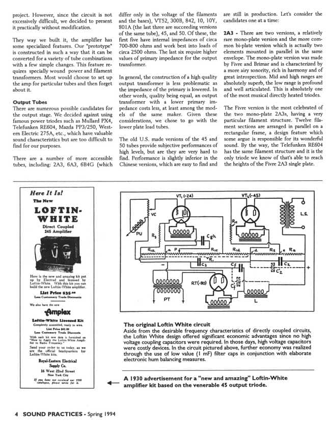

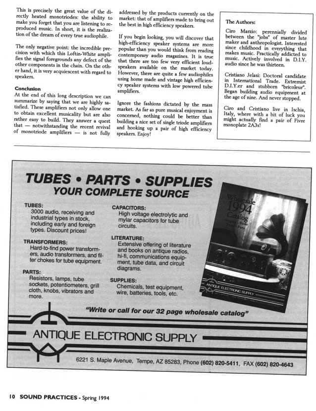

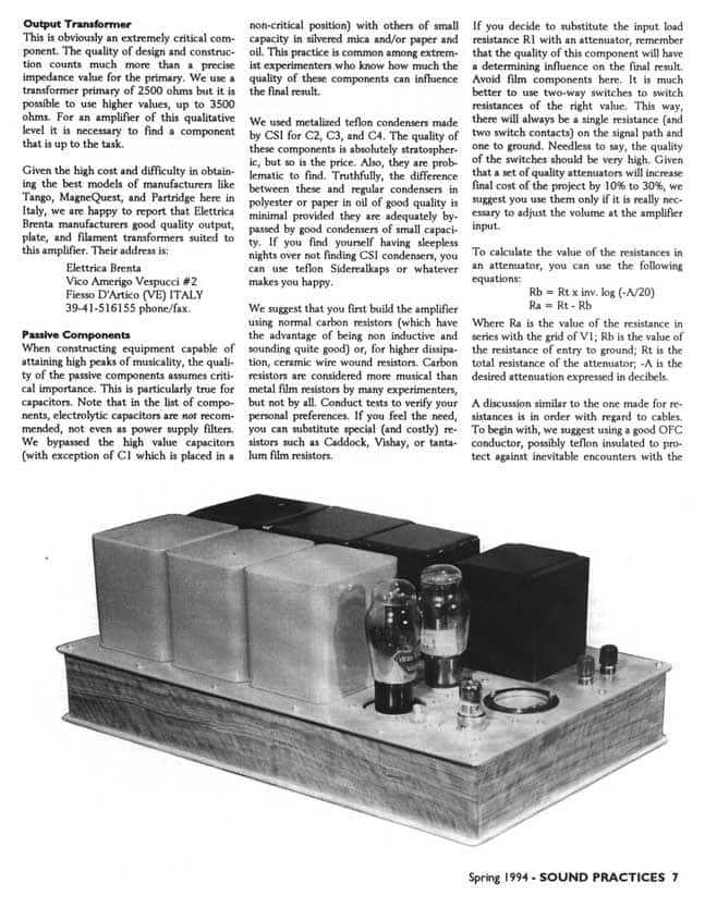

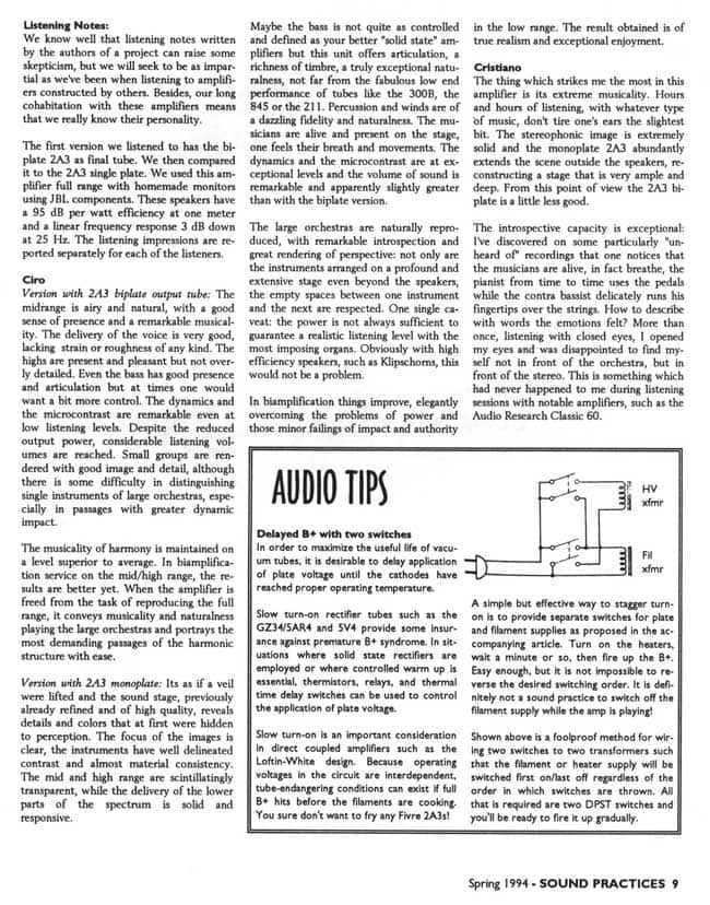

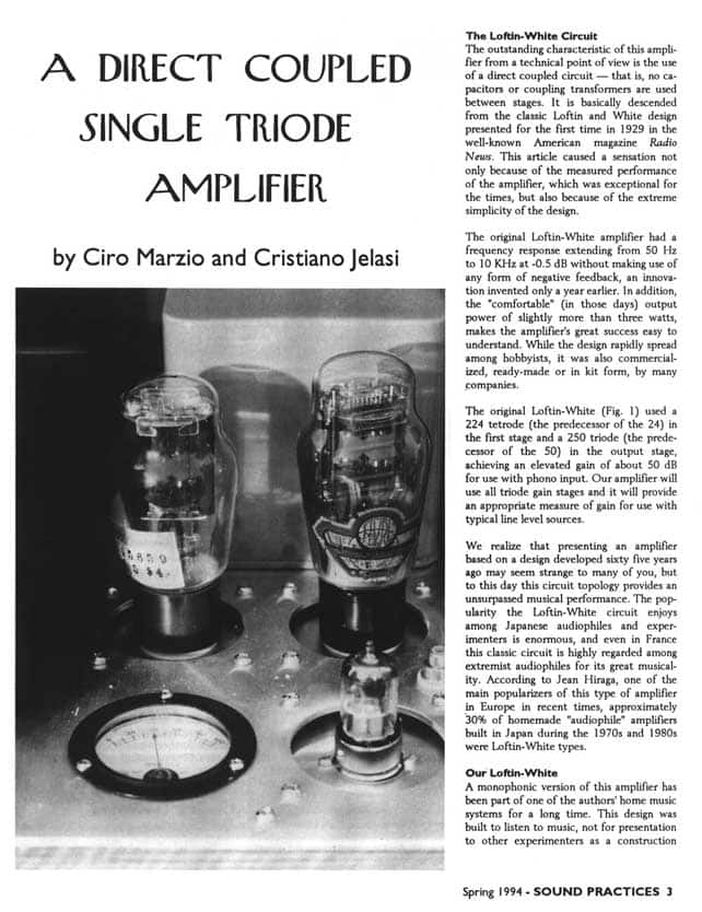

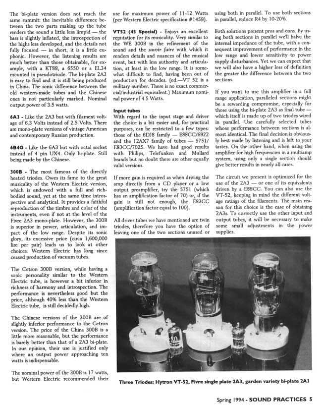

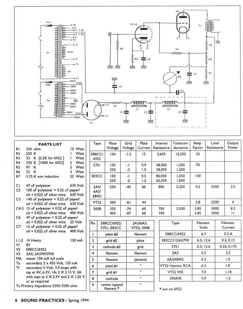

Zen Mod Napisano Mart 5, 2010 Autor Share #9 Napisano Mart 5, 2010 no - to su sasvim druga pitanja .... mada ja ne bezim po svaku cenu od konda , ali se i zna gde mu nije mesto a gde i moze da bude elem - obecao sam jos malo zanimljive literatue o L-W ampuscan clanka iz Sound Practices Link to comment Podeli na ovim sajtovima More sharing options...
ZZZ Napisano Mart 5, 2010 Share #10 Napisano Mart 5, 2010 Vrlo lepo... Znam te fotke i jako mi se dopada kako je sve to napravljenoJa se odavno spremam da napravim jedan.nazalost nisam mnogo odmakao sem stoImam skoro sve elemente i to jako dobre+ handy made izlazne trafoe...svi trafoi za grejanje i ostali na posebnim jezgrima.siemens PIO,cak sam nabavio i male instrumente sa kazaljkom na srediniza kontrolu i set up radne tacke...Cevi AX50, 2A3(6B4G opt.), 6J5 ili 12AY7 mono block verzija.btw mislim da je to jedna od najboljih topologija ako ne i najbolja? Link to comment Podeli na ovim sajtovima More sharing options...
