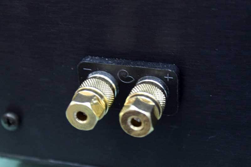

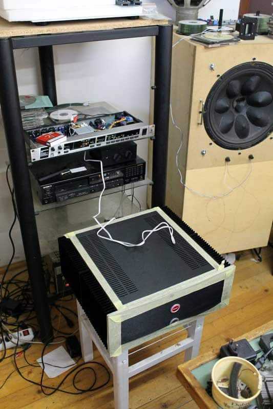

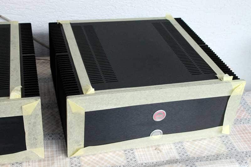

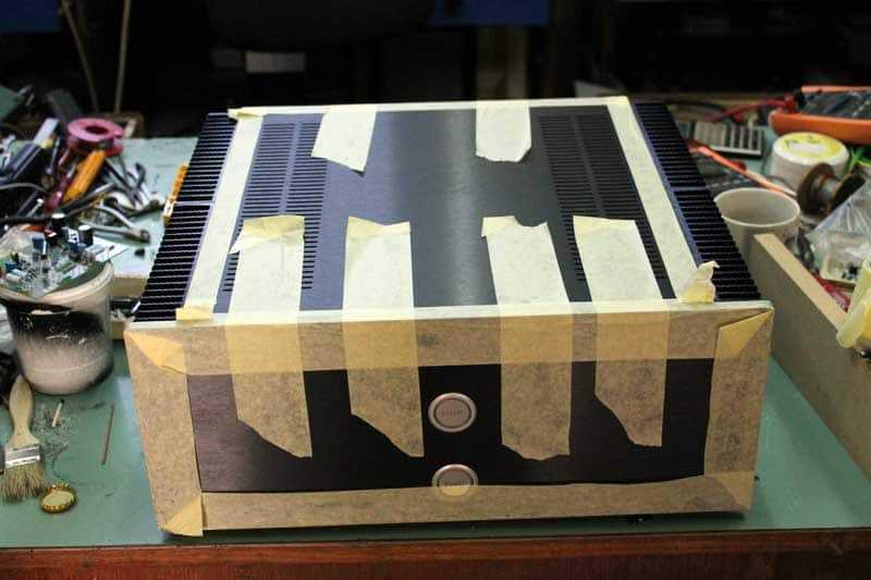

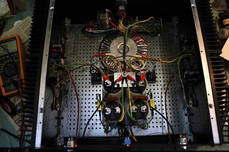

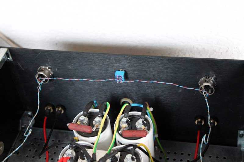

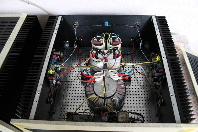

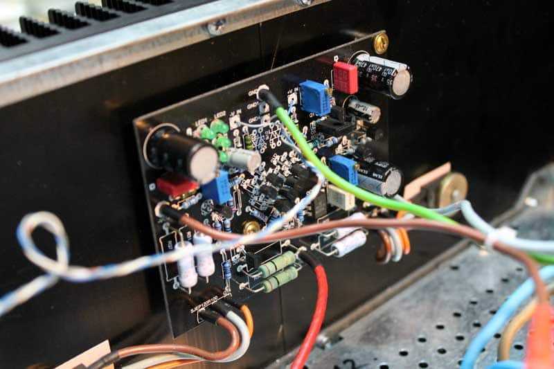

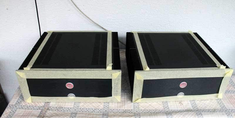

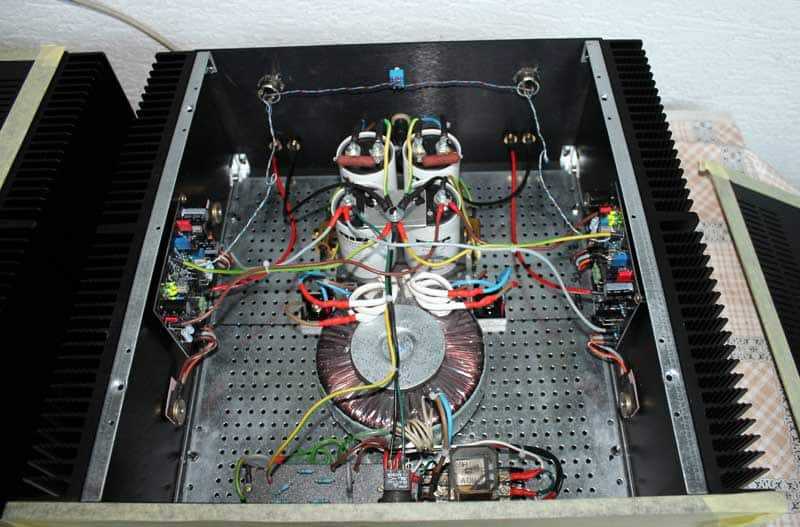

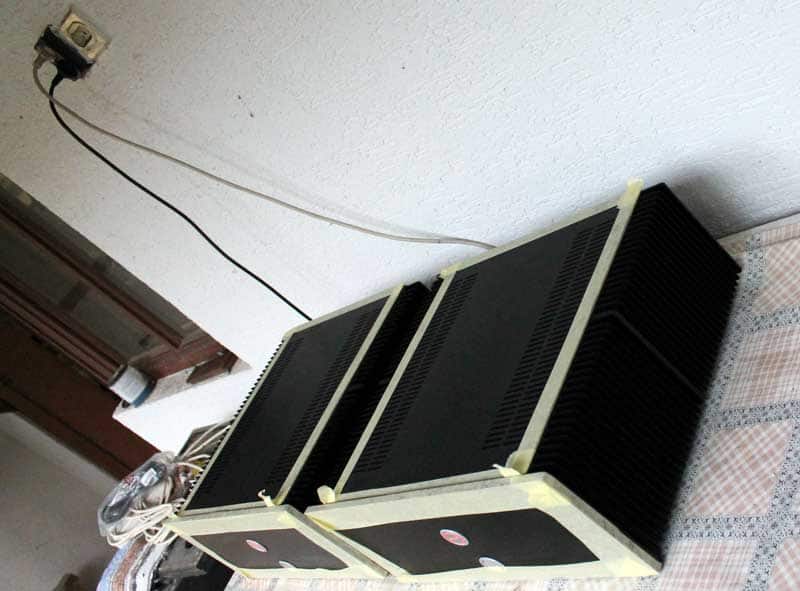

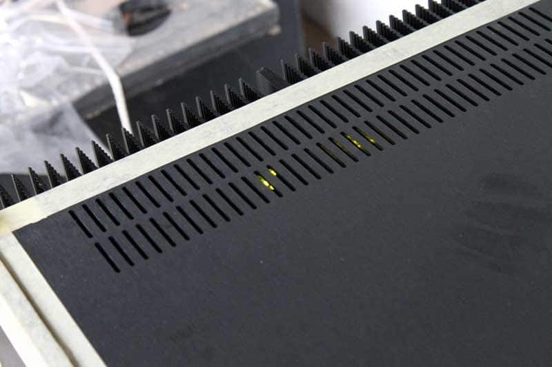

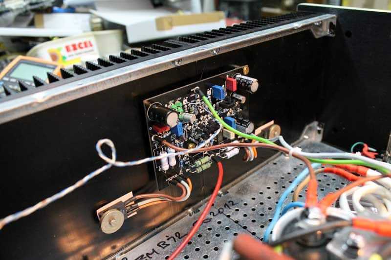

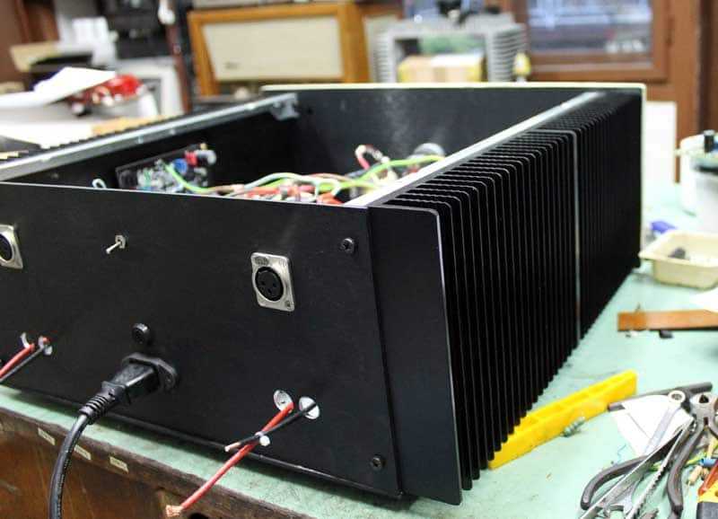

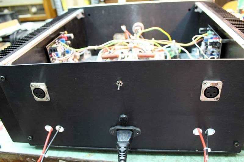

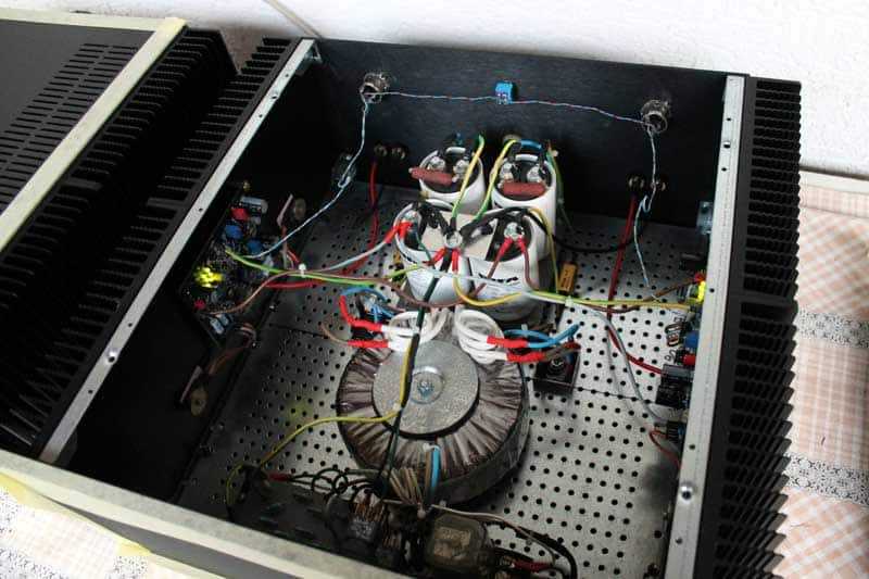

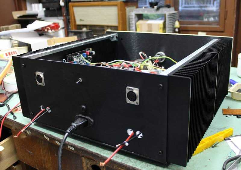

Babelfish J2 , ongoing ...... no more; burned in !
bias & offset procedure done
clipping test done

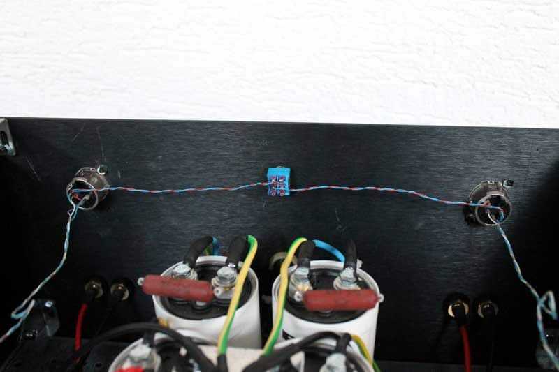

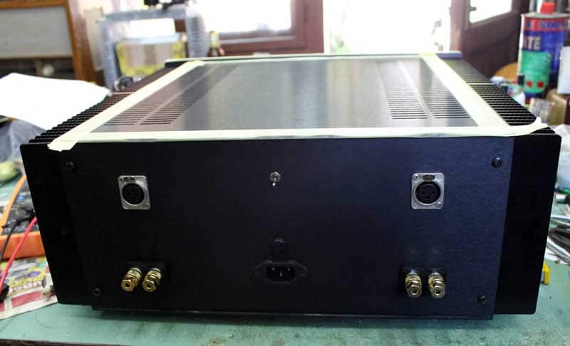

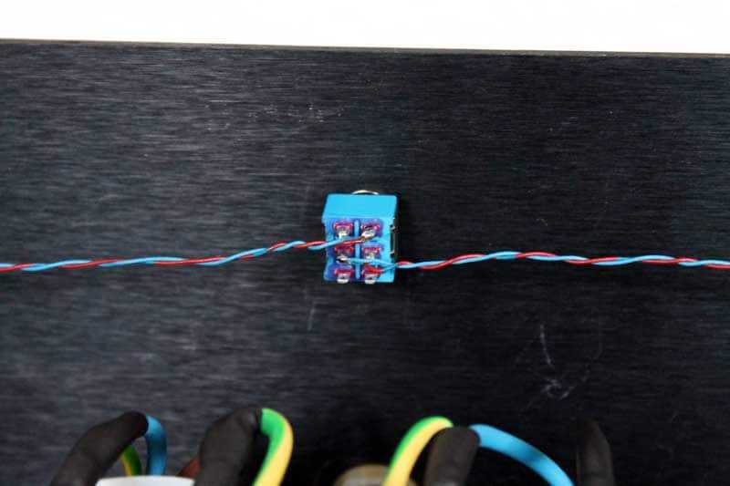

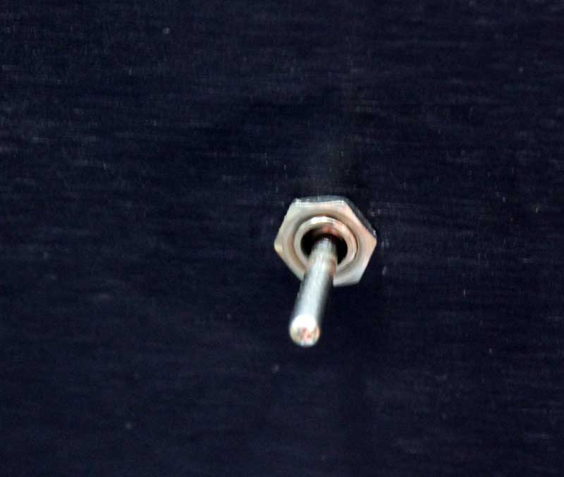

installed switches for tying L & R inputs , for bi-amp duty .
they're made with common supply for both channels in case , because of possibility of use in parallel mode
in any case , when made as dual mono , wiring can be cleaner and nicer .
whatever , I'm satisfied .

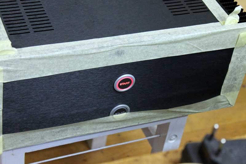

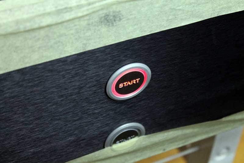

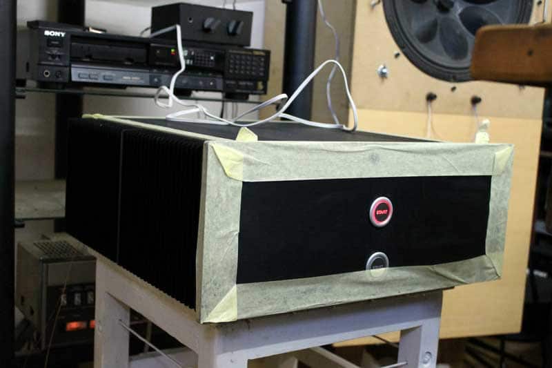

bottom taster buttons will be replaced later ( pair of "START" buttons per amp just doesn't make much sense :sarcastic_hand: ) , and missing Cardas posts on one will be mounted as soon they arrive .
cheap & dirty amps for everyday's use , if you don't mind burnin' 2 x 200 W of electricity :rofl:
free tip for any user of A class amp - having Babysitter is cunning ......... as shown here : http://tinyurl.com/85ymtnm
