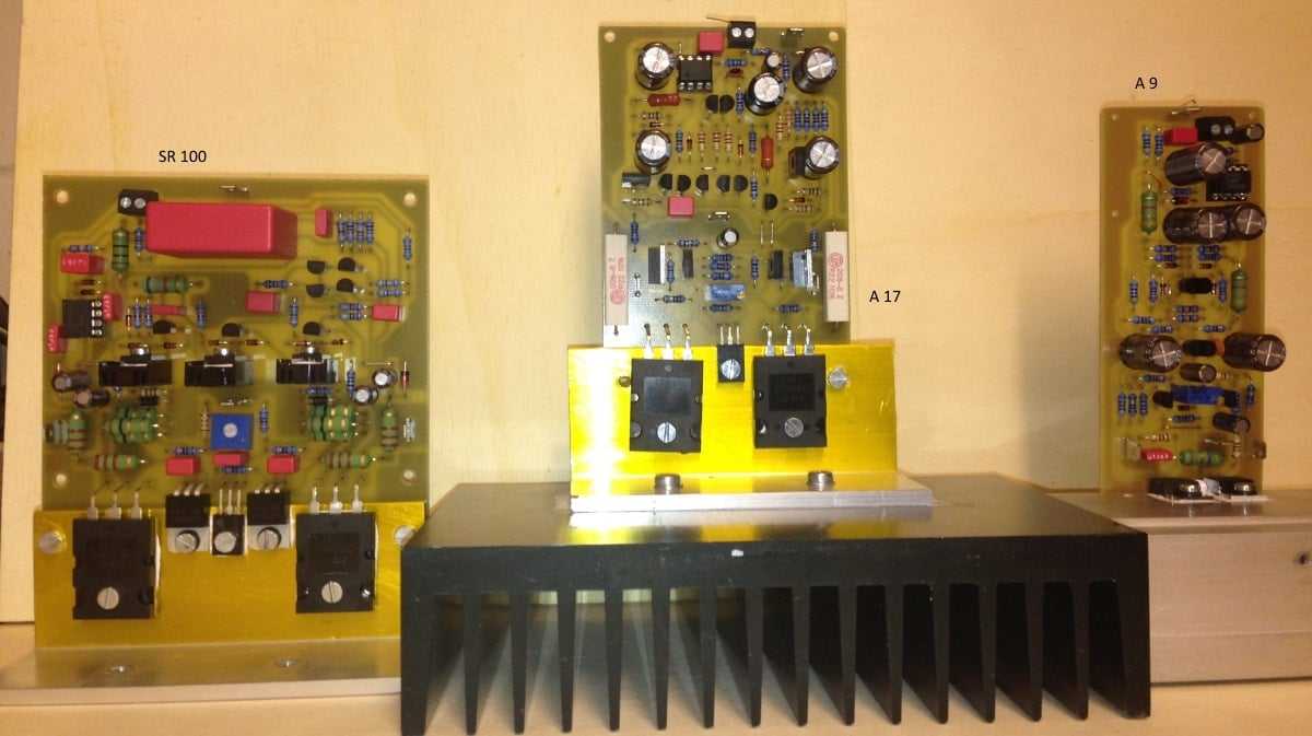

HomeMadeAudioProject Napisano Decembar 13, 2014 Autor #8 Napisano Decembar 13, 2014 moram izmjeniti upravo postavljen post na diyaudio.com da bi dodao taj dio pitanja inače,Olaf je lik koji baš ima smisla za organizovati šemu na pločicu: i ovde je koristio tu traku...
HomeMadeAudioProject Napisano Decembar 14, 2014 Autor #9 Napisano Decembar 14, 2014 pitaj ga jel cheap-chineeese ili 3M traka. I use the Kapton film for quite some time. Was discussed here in the forum (I think still4given used it at first, but not sure). I have never made measurements, but also any bad experiences. In general, the very good thermal conductivity of Kapton is known. Mine comes from ebay, 30m long, 50mm wide for about 10 euros, labeled 3M. I am very satisfied. And much cheaper then silicon-foil. regards Olaf
