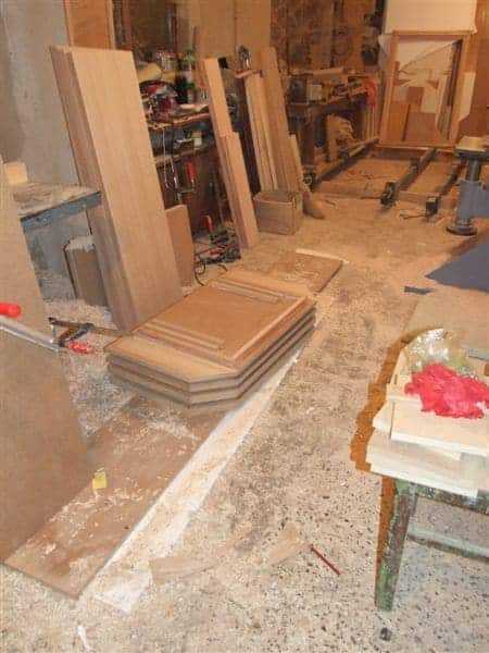

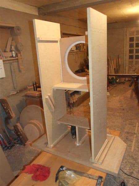

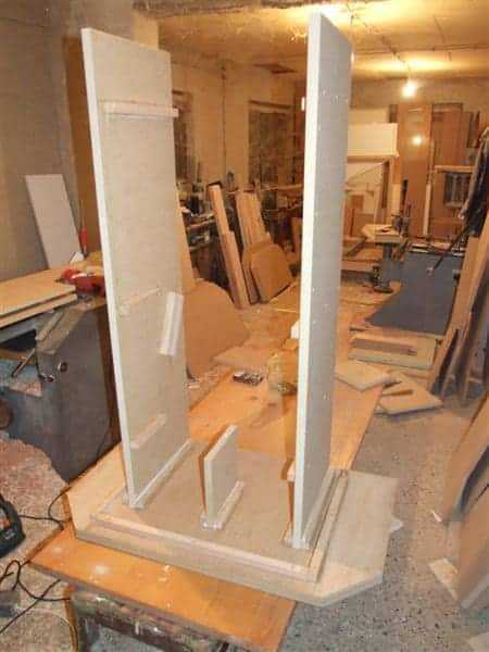

Eci Napisano Oktobar 23, 2010 Autor #23 Napisano Oktobar 23, 2010 Deo T iz drugog uglaTreba primetiti da je i ovaj deo isfurniran ( gornji deo tunela ) Part T from a different angleThis part was also veneered in advance ( the upper part of the tunnel)

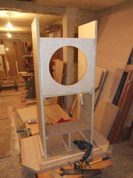

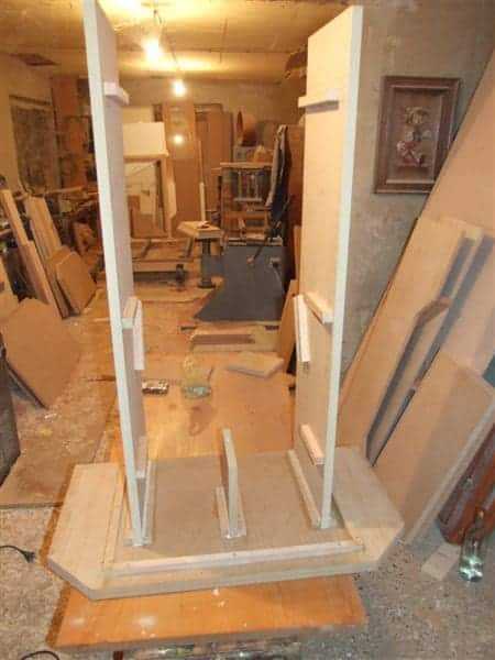

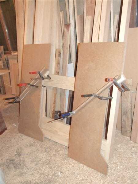

Eci Napisano Oktobar 23, 2010 Autor #24 Napisano Oktobar 23, 2010 Vezivanje dela F na deo C Binding the part F to the part C

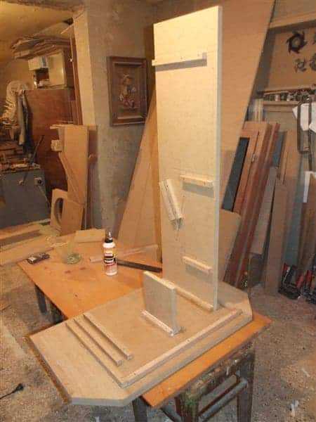

Eci Napisano Oktobar 23, 2010 Autor #25 Napisano Oktobar 23, 2010 Spojeni delovi F i C Parts F and C are connected

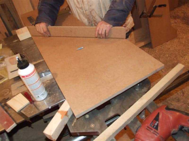

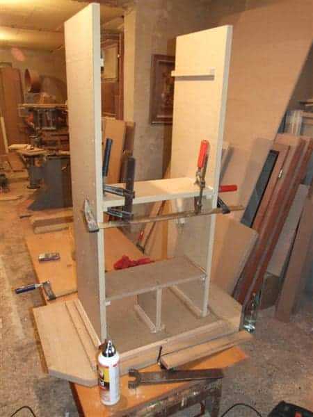

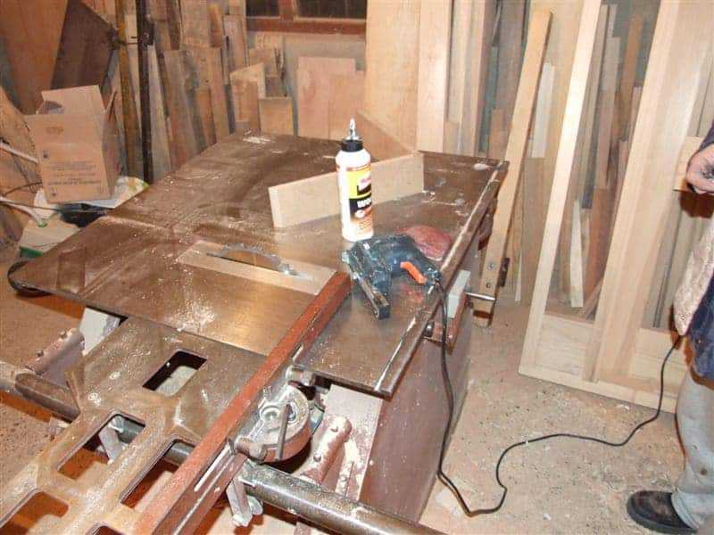

Eci Napisano Oktobar 23, 2010 Autor #26 Napisano Oktobar 23, 2010 Slika iz radionice Image from the workshop

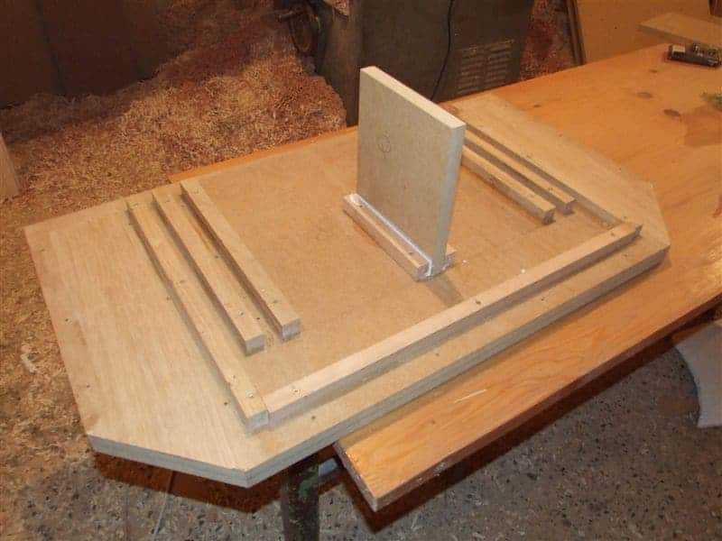

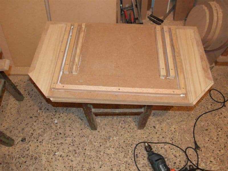

Eci Napisano Oktobar 24, 2010 Autor #27 Napisano Oktobar 24, 2010 Stranice D, nalepljene lajsne D sides, pasted moldings

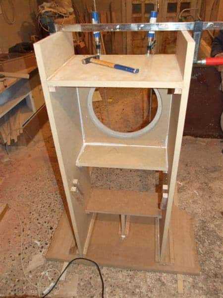

Eci Napisano Oktobar 24, 2010 Autor #28 Napisano Oktobar 24, 2010 Spojeni delovi O The O parts are connected

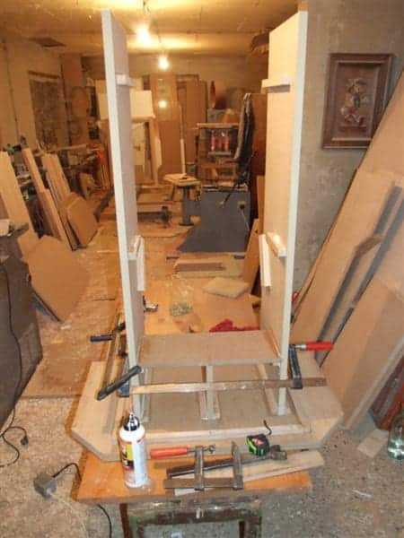

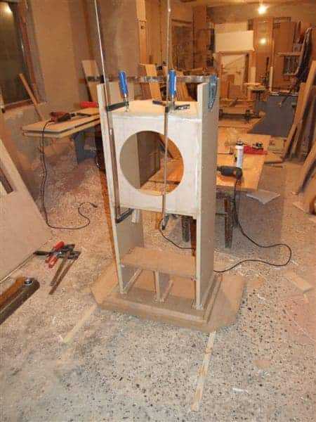

Eci Napisano Oktobar 24, 2010 Autor #29 Napisano Oktobar 24, 2010 Kreće sastavljanje: Deo Q na deo R And starts the assembling: Part Q goes on the part R
Eci Napisano Oktobar 24, 2010 Autor #31 Napisano Oktobar 24, 2010 Opet D na R Again part D goes on part R
Eci Napisano Oktobar 24, 2010 Autor #33 Napisano Oktobar 24, 2010 Deo P na deo Q Part P goes on part Q

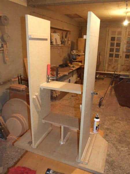

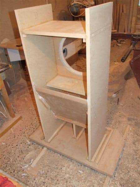

Eci Napisano Oktobar 24, 2010 Autor #34 Napisano Oktobar 24, 2010 Deo L izmedju D stranica Part L between D sides

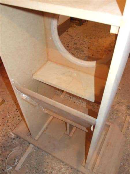

Eci Napisano Oktobar 24, 2010 Autor #36 Napisano Oktobar 24, 2010 Delovi S1 i S2 sa crteža WMR 18, unapred se zalepe S1 je 6mm debeo bukov šper, S2 je 28mm MDFPostavljanje nosača ( S1+S2 ) za HPD385 Parts S1 and S2 ( from the WMR18 drawing ), they are connected in advance. Part S1 is a 6mm thick beech plywood, the part S2 is a 28mm MDFOn the picture : setting up the carrier (S1 + S2) for the HPD385

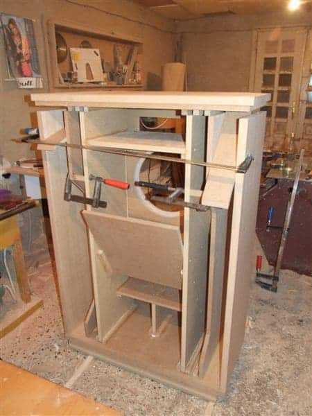

Eci Napisano Oktobar 24, 2010 Autor #41 Napisano Oktobar 24, 2010 Proba: kako se deo W uklapa - veoma bitan deo, razdvaja kompresioni deo kutije od unutrašnje horne, formira ujedno i grlo horne Ostali delovi su stavljeni sa stegama, čisto da se stekne uvid, kako će to izgledati Test: How the part W fits - a very important part, separates the compression part of the box from the inner horn, and also forms the horn throat. All other parts are placed with clamps, just to see how the box will look like
