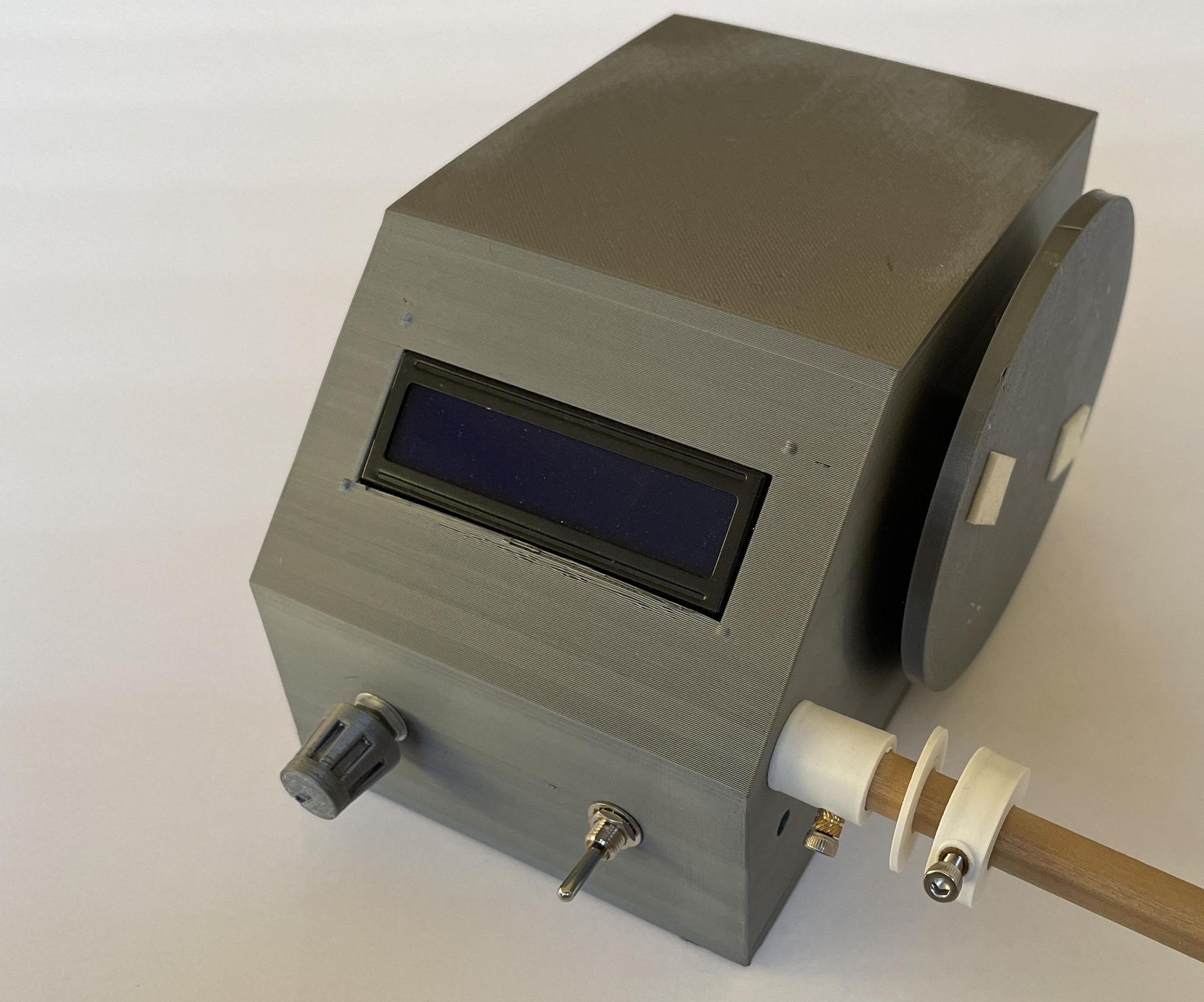

neskor Napisano Oktobar 1, 2024 Share #1 Napisano Oktobar 1, 2024 Potreba pomoc prijatelja za prepravku Arduino koda Nasao sam neki projekat na netu za malu motalicu za magnete za gitaru. Pickup Winder V2 WWW.INSTRUCTABLES.COM Pickup Winder V2: Hello again, if you are here I assume its because you saw the first video or instructable I made on building a DIY pickup winder for about 37 dollars. Today, I am taking a look at version 2. (If you haven’t seen or read about version one check it ou… Sve sam ja to lepo spojio, ucitao kod i sve radi kako treba. Ima par greska kako je vezan prekidac smera na semi i pin A1/A0 u kodu ali to je reseno. Medjutim po meni fali jedna stvar, rucno resetovanje countera. Da li neko zna sta treba da ubacim u kod da bih omogucio opciju rucnog reseta countera na taster. Hvala unapred Arduino kod u prilogu. Pickup_Winder_Version_2.ino Link to comment Podeli na ovim sajtovima More sharing options...
