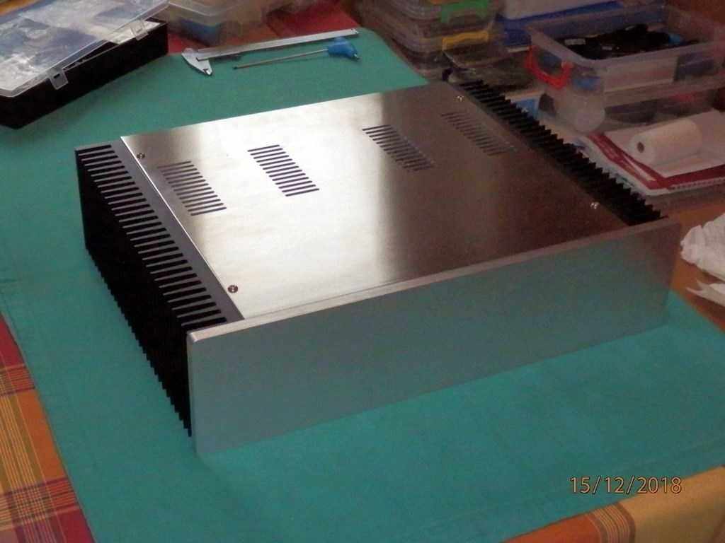

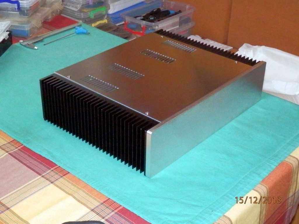

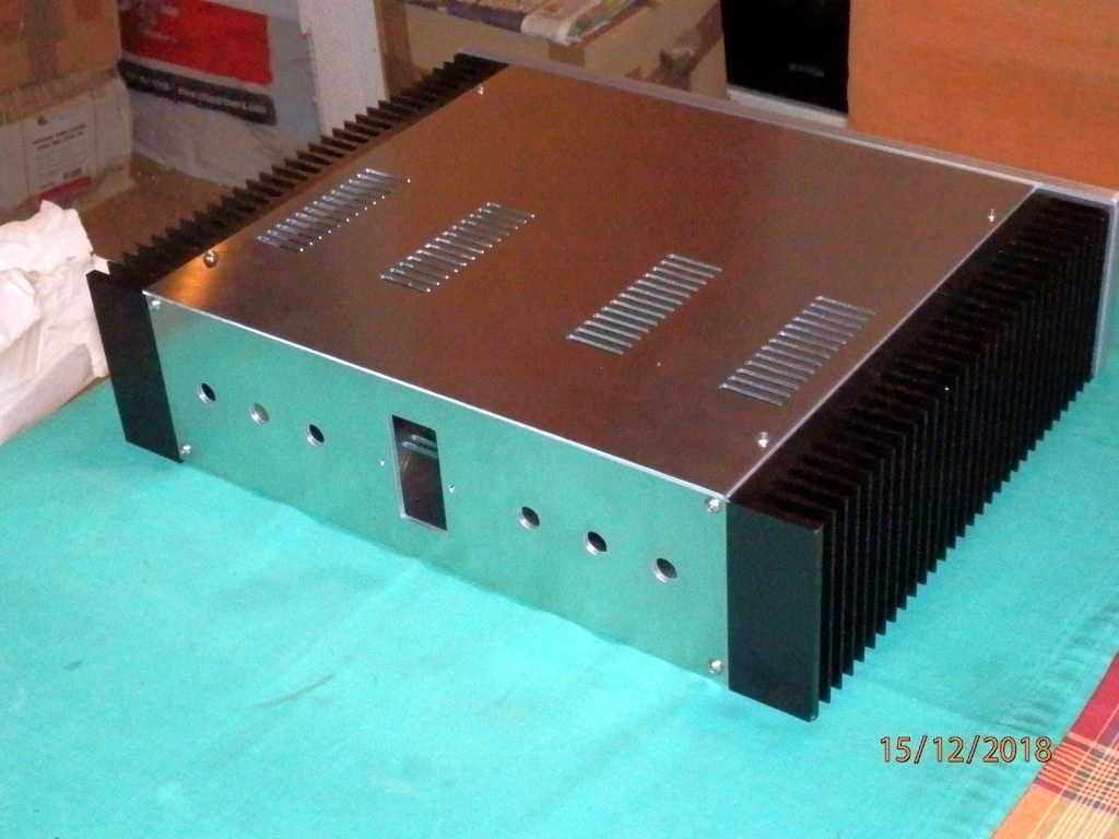

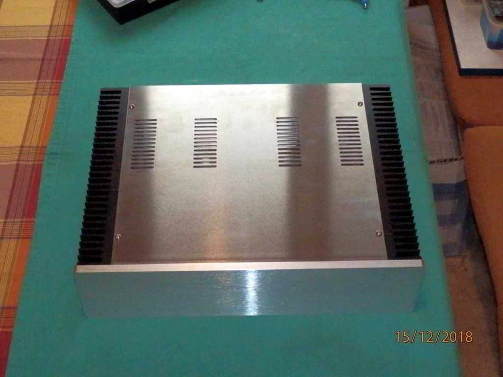

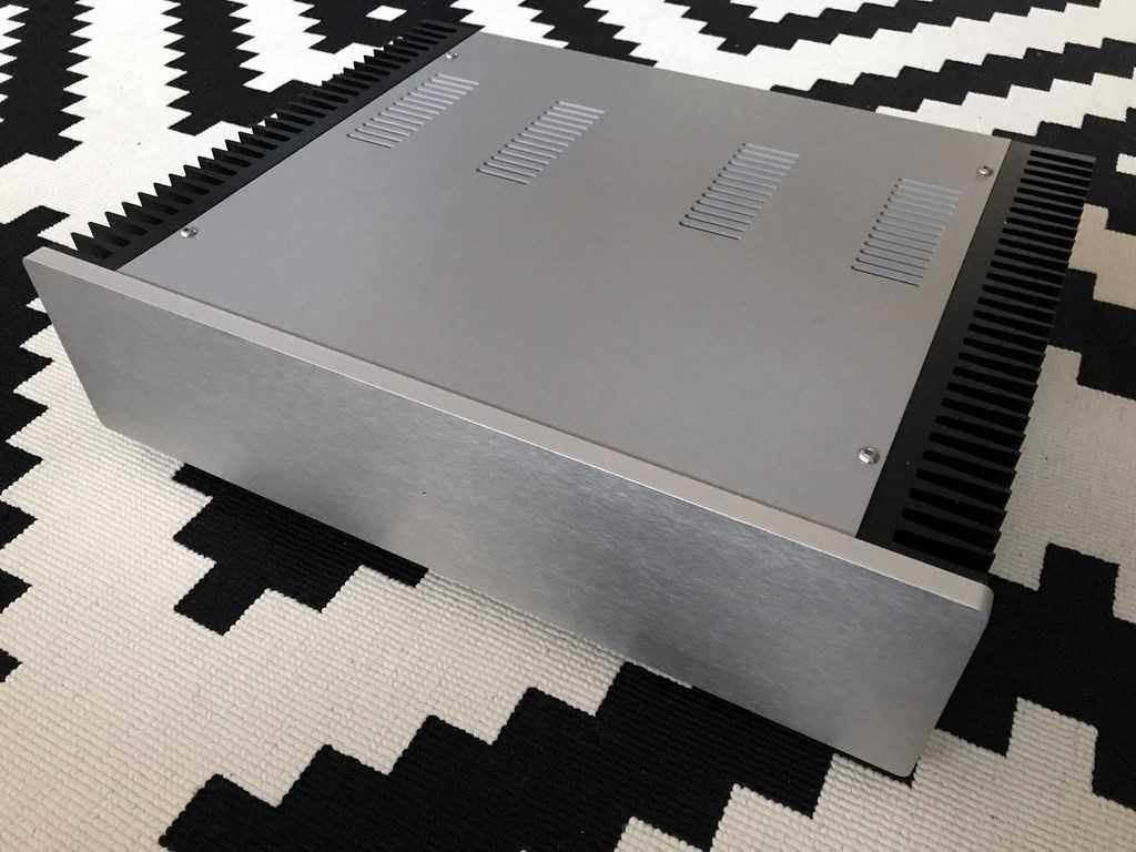

Kućište za "Zimsko pojačalo" - varijacija na temu Vladino pojačalo CMA. Spoljne dimenzije  v103 x š410 x d310mm.
Hladnjaci Fischer SK56x100. Kompletno urađeno od Al. deb 3mm, prednja ploča deb10 x v103 x š410mm.
Površine maš. brušene, eloksirane natur svetlo. Urađeno za kolegu Vukašina, decembar 2018.

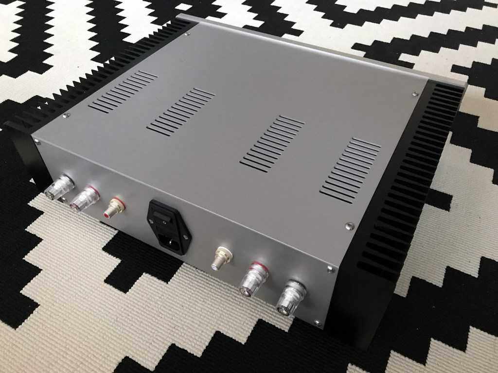

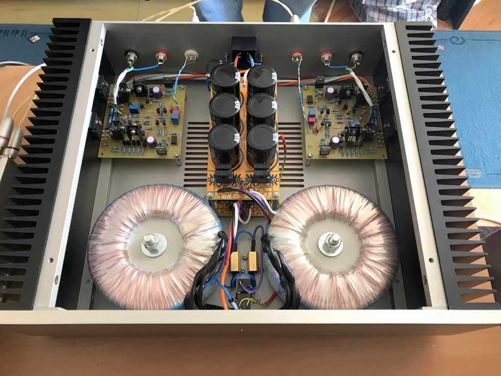

Završeno pojačalo
IMG_06641024x768.thumb.jpg.18d6902da2a2d8db1bb01776cc963b72.jpg  IMG_06651024x768.thumb.jpg.e3cf2801b8640f857780019580c92512.jpg  IMG_06671024x768.thumb.jpg.d2c8b80e761543b2a0aa0be437f15712.jpg
IMG_06681024x768.thumb.jpg.97ed19281bc9b9dd0b39deeadc47e199.jpg  IMG_06691024x768.thumb.jpg.0ceb6c6852f0640d11ac477efdf3970a.jpg  IMG_06701024x768.thumb.jpg.9fd205e7c89561e33244d248f41d4a4e.jpg

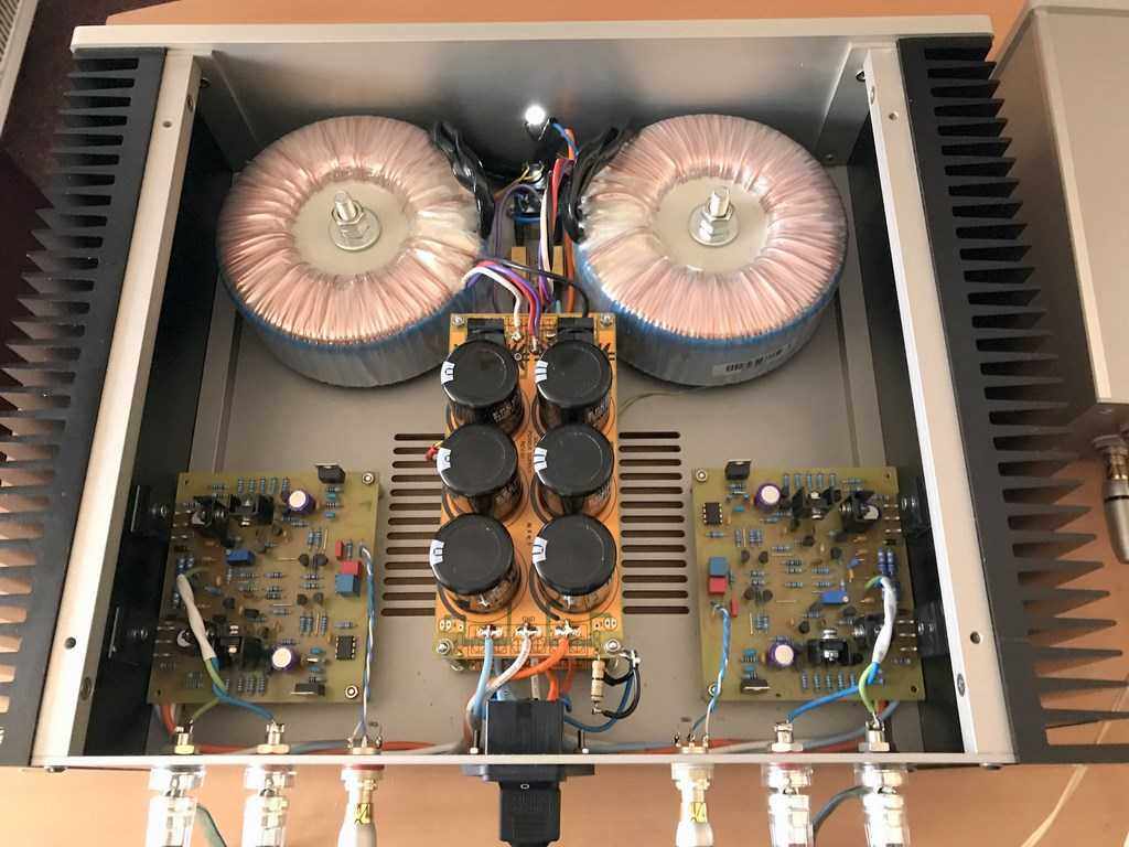

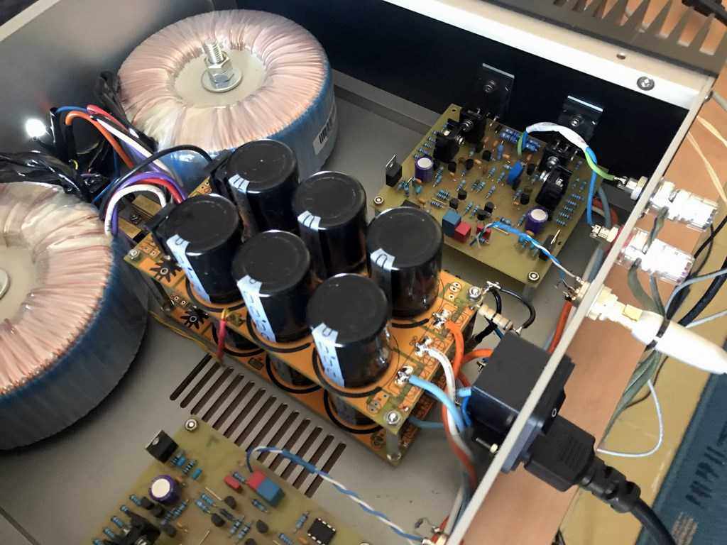

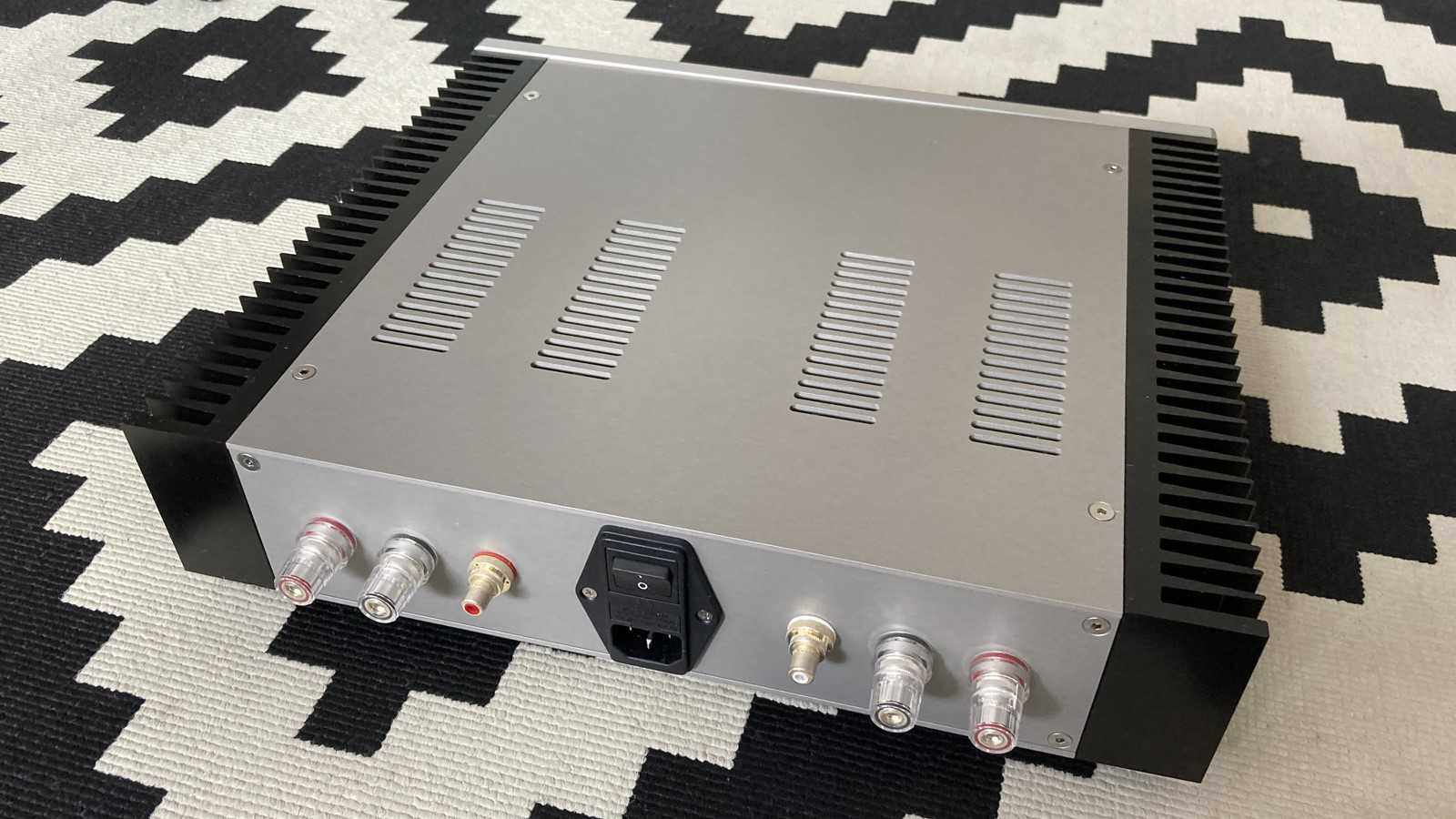

Dodatak - jun.20220

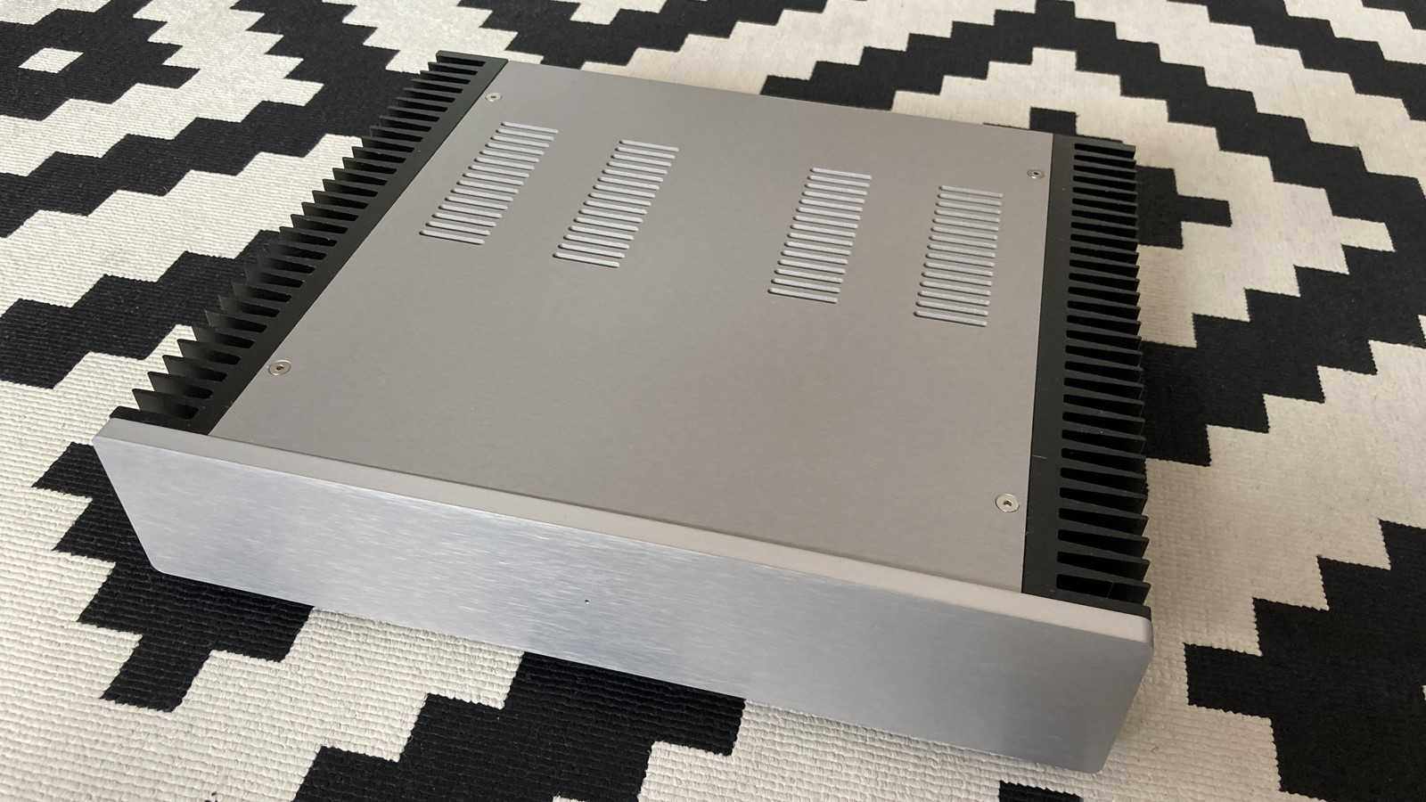

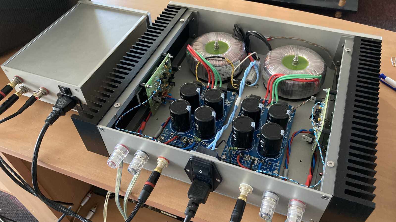

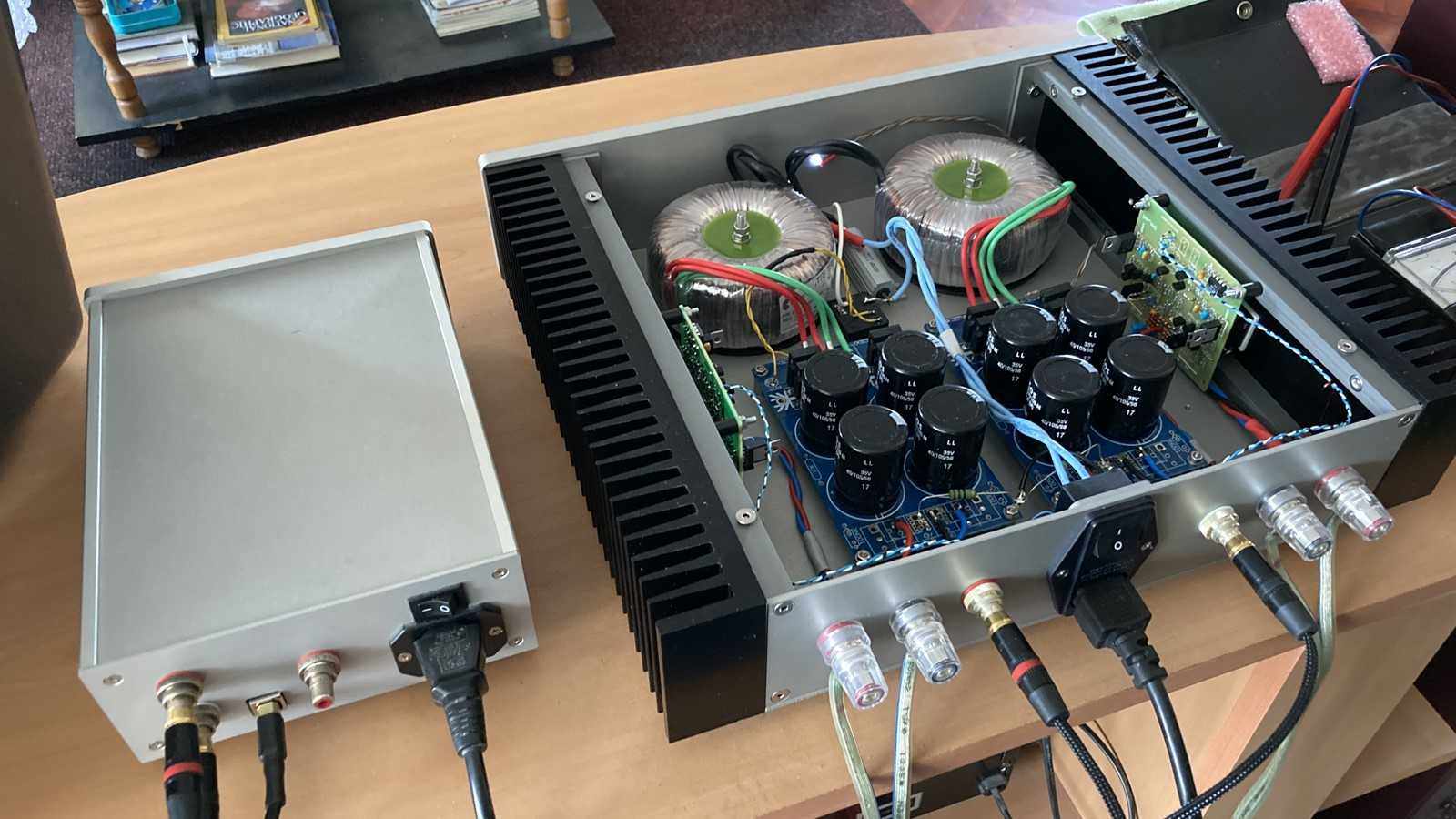

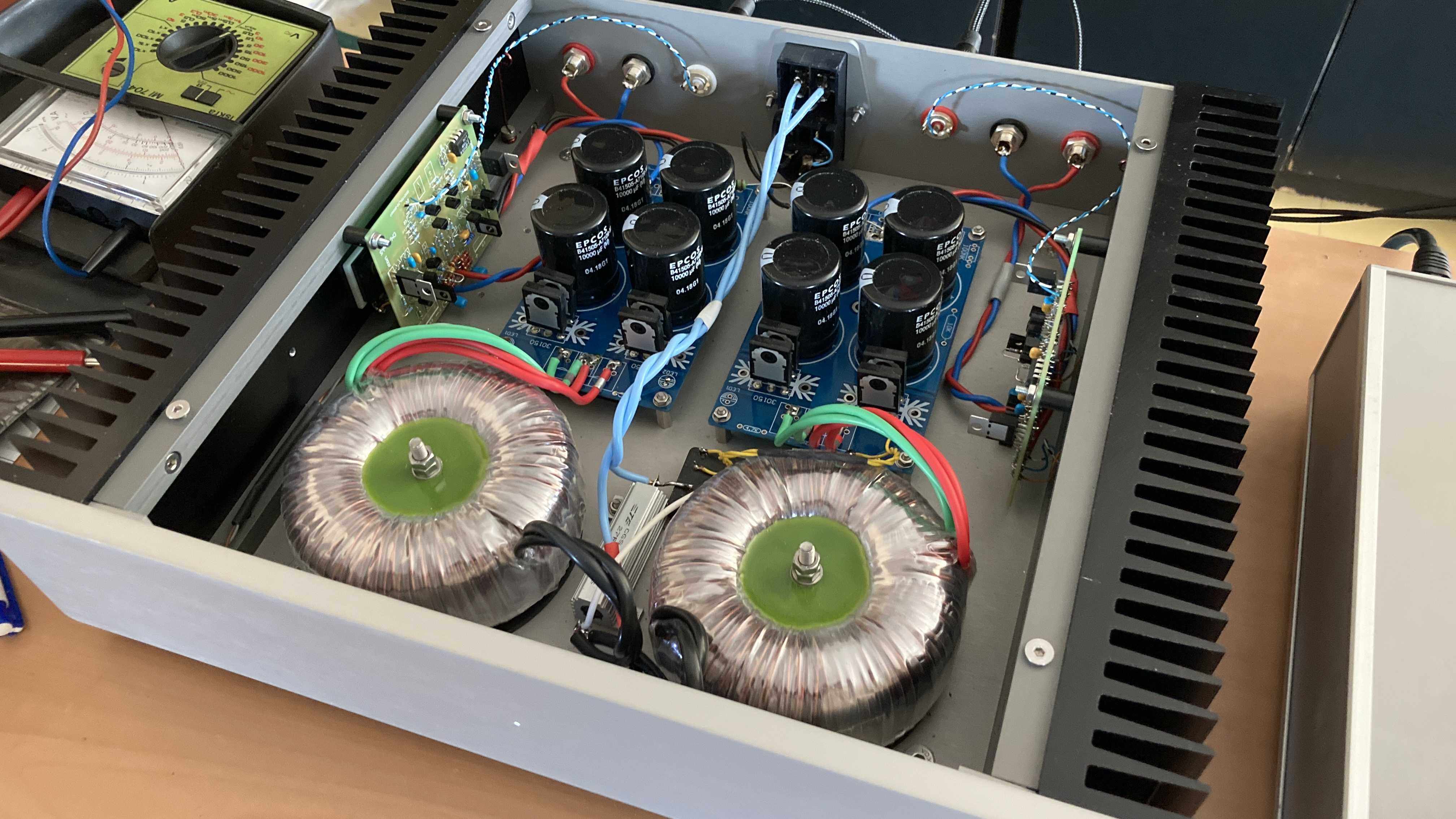

Zimsko Pojačalo 2
1600884689896730.thumb.jpg.fab438959eb269ce171e3d94868a2ffe.jpg  16008846898967301600x1200.thumb.jpg.1dfefd17a38622382dc97133a4028193.jpg  16008846904829071600x1200.thumb.jpg.c8b70e7ab5f7913ae76c2a89fcea01e8.jpg
16008846909624591600x1200.thumb.jpg.89d8309602ab10b887c73d369a3a73b6.jpg  16011100492376421600x1200.thumb.jpg.2e8ba10b75316b796e1b0eda171ea3f5.jpg  16011100497554471600x1200.thumb.jpg.702e0979d124870d710853bb295304b2.jpg
