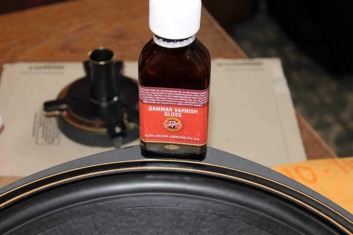

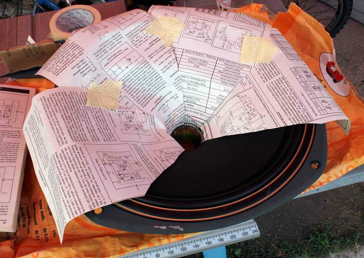

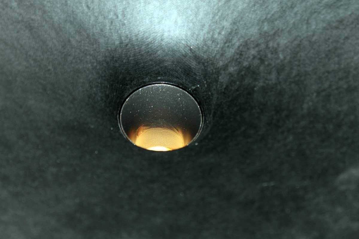

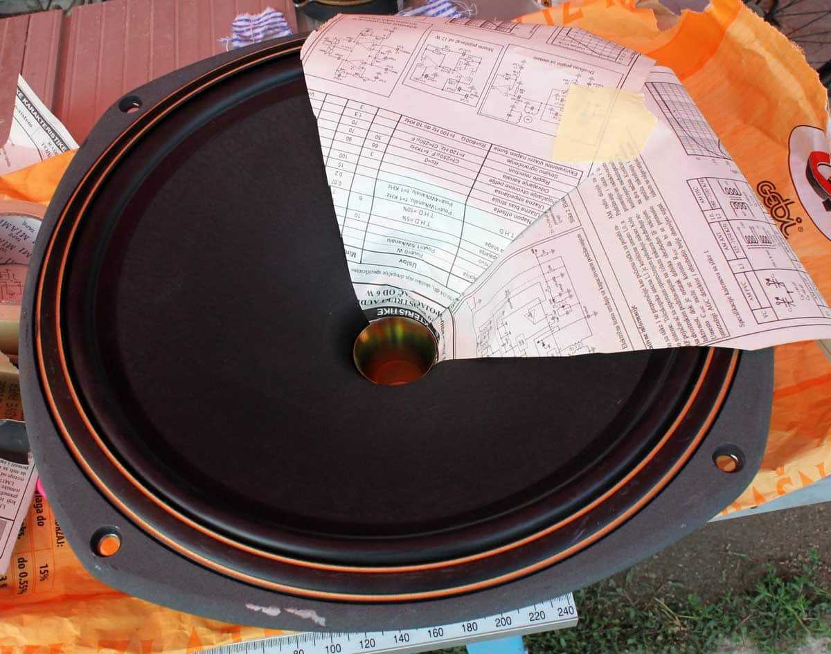

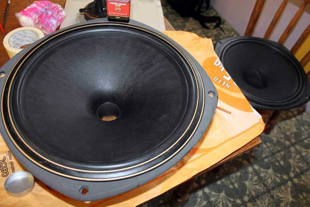

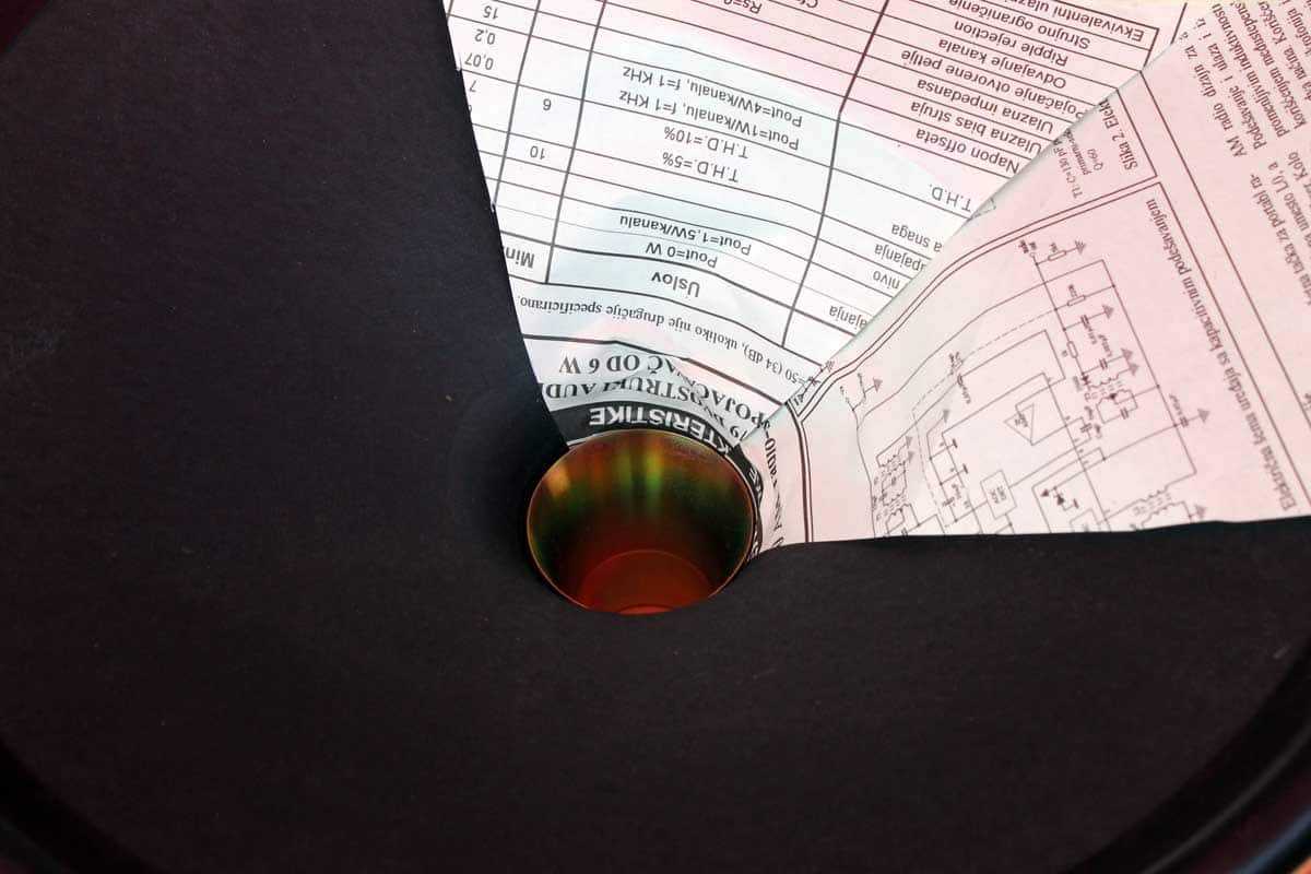

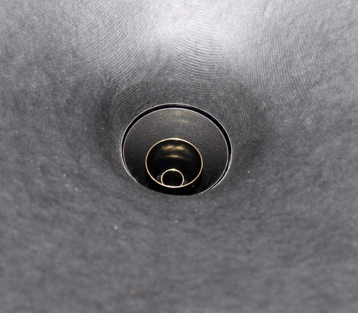

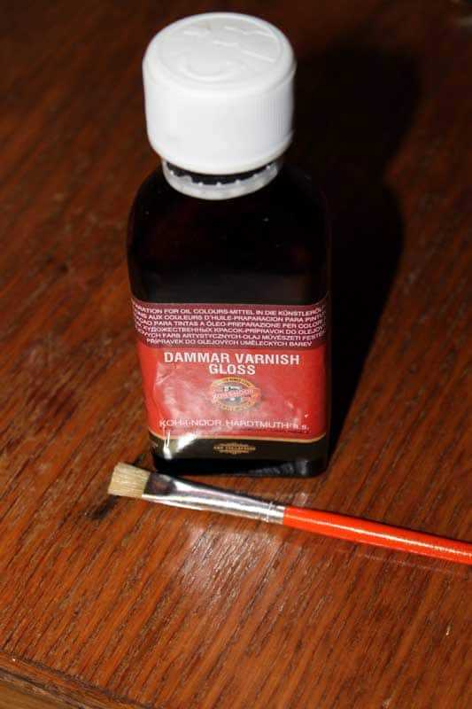

remove compression driver , sand horn throat, degrease it , cover cone with paper inlets , spray-paint da throat, wait , Dammar everything ( as Gusztav made the button ) , put compression driver back

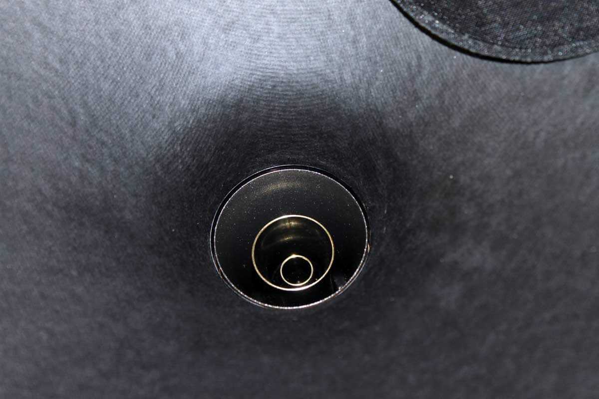

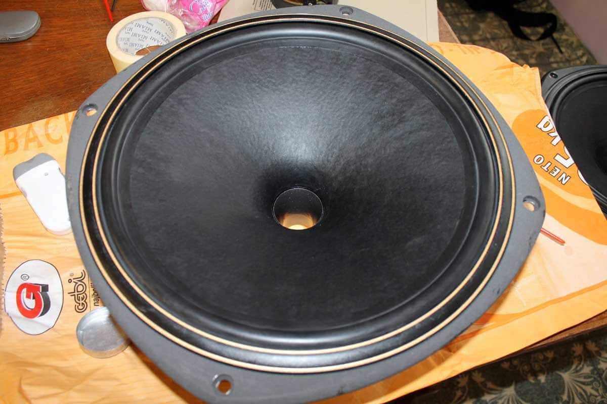

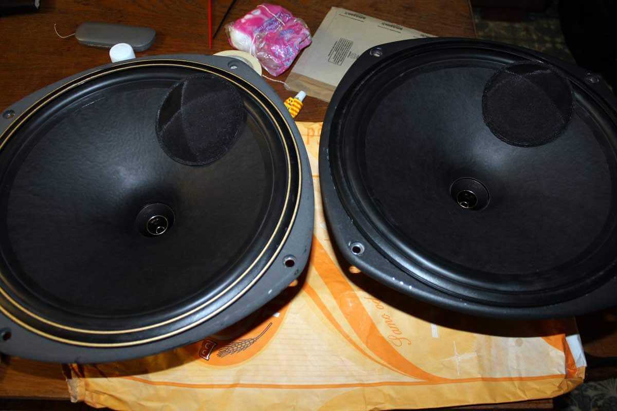

that's it - now K3833 is same as K3836 , excluding two funny golden rings ( to be precise - K3833 having gray basket and two golden rings , while K3836 having black basket and no silly golden rings )...... which will be invisible in WM , anyway .
...... A day later - measured Fs for both bass and compression drivers - 27 & 28 Hz , 1065 & 1075 Hz

Zen gde se pazari ovaj DAMMAR, ima li ga u prodavnicama slikarskog materijala ili nabavljas na drugom mestu?
Zen Mod
jace knjizare/papirnice i kako si i rekao - slikarske
