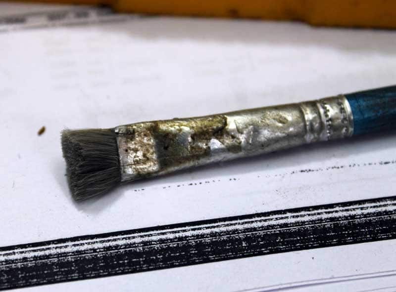

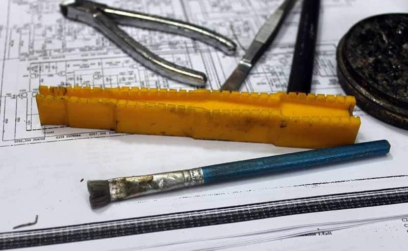

RECIPE
what you need :
1.small brush , semi hard m ~8mm wide , same as kids are using for painting in
school
2.Ethanol 95% (pure alcohol)
3.Acetone with oil ( nothing else than nail polish remover )

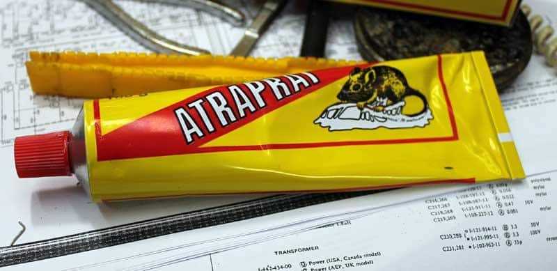

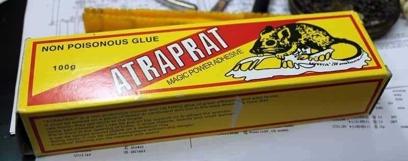

4.mouse glue (yes , that organic everlasting sticky goo)
5.Vaseline
6.cotton cloth ( old T shirt or whatever)
brush - buy it anywhere , mouse glue - anywhere , everything else - nearest drugstore
important to say - surround was originally threated from upper side , mostly ;
just slight residue of original rubbery impregnate is visible from bottom side
of surround
procedure for upper side of surround:
using brush - from upper side - soak surround with ethanol ; it's best to soak
it in parcels of 10cm , then rub it with same brush ; whenever you fill brush
with residue , wipe it on cloth
repeat procedure until you make two full circles (so entire surround perimeter
is twice treated)
move to second speaker ,same procedure , again two circles ;
repeat same soak-rub-wipe-soak-rub-wipe procedure on both speakers , until you can see clear fabric of cloth , without any trace of rubber

now - put some mouse glue on small (coffee cup) plate , add acetone and dissolve it to something liquid as milk
using brush - put that mixture on upper side of surround ; if you see that your
mixture on plate is going firmer , add acetone and mix ; when you treat entire
surround , take just acetone with brush and treat entire ( already impregnated )
area with it , to make it more uniform
leave it for 12h

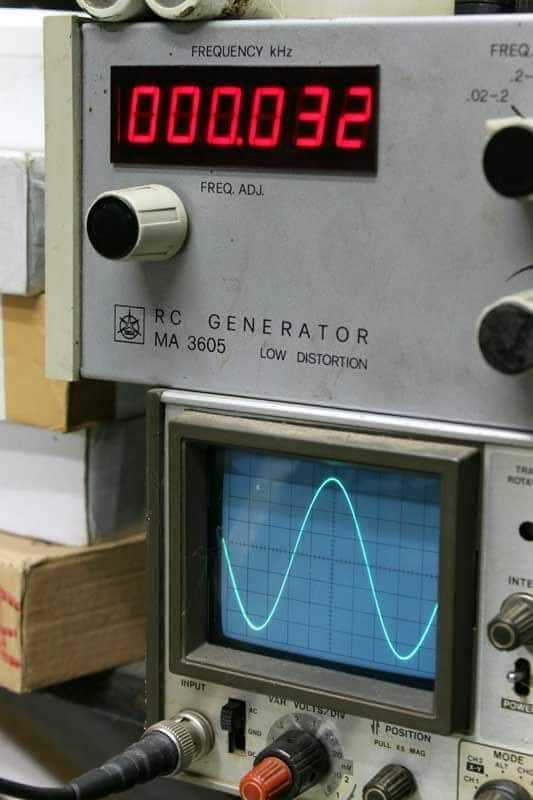

measure Fs
easiest way of measuring Fs - use sine signal generator with 50R output
impedance , connect it to bass terminals , put CRO probes on terminals
sweep frequency from 100Hz down ; when you see biggest sine amplitude , there is Fs
another possibility for measuring - instead of sig gene - use Sig Jenny program
( wave gene with counter ) , sound card to small amp , amp to bass terminals ,
AC voltmeter to terminals
put few volts of sine to bass , sweep from 100Hz down , when you see biggest
reading on Vac meter , that is it
mine are at 31 and 33 Hz , I'm not loosing sleep because of using mouse glue and
vaseline on piece of cloth ;)

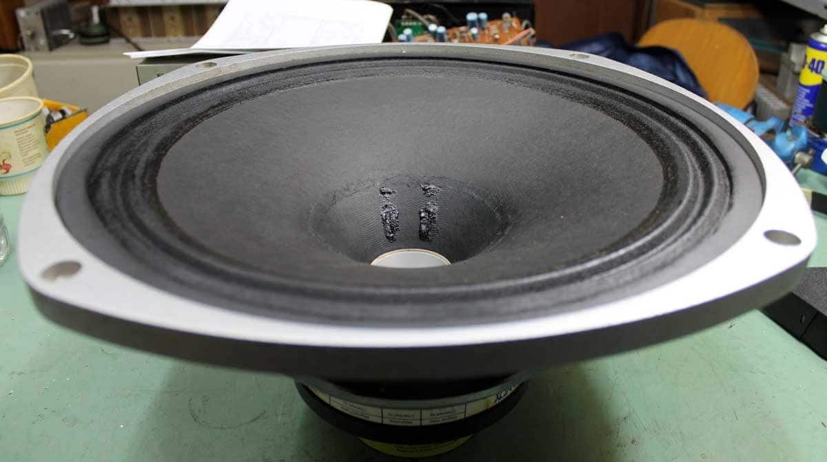

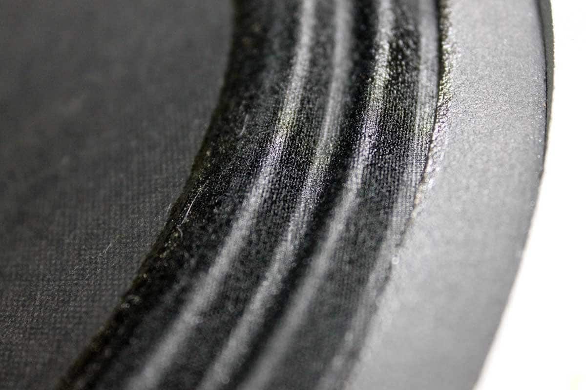

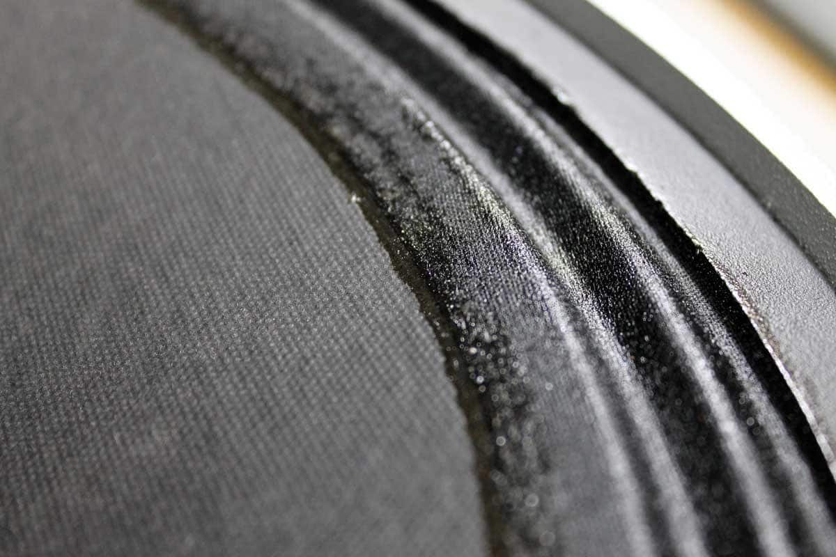

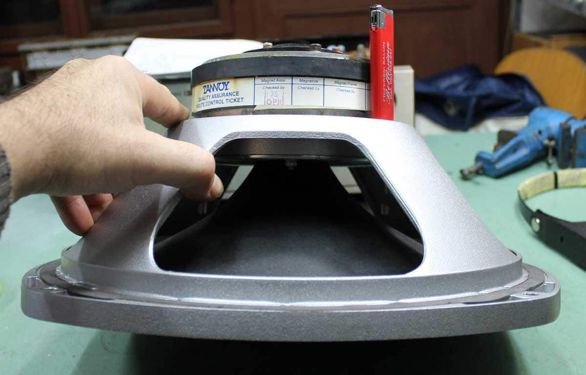

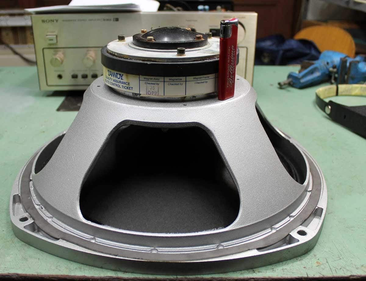

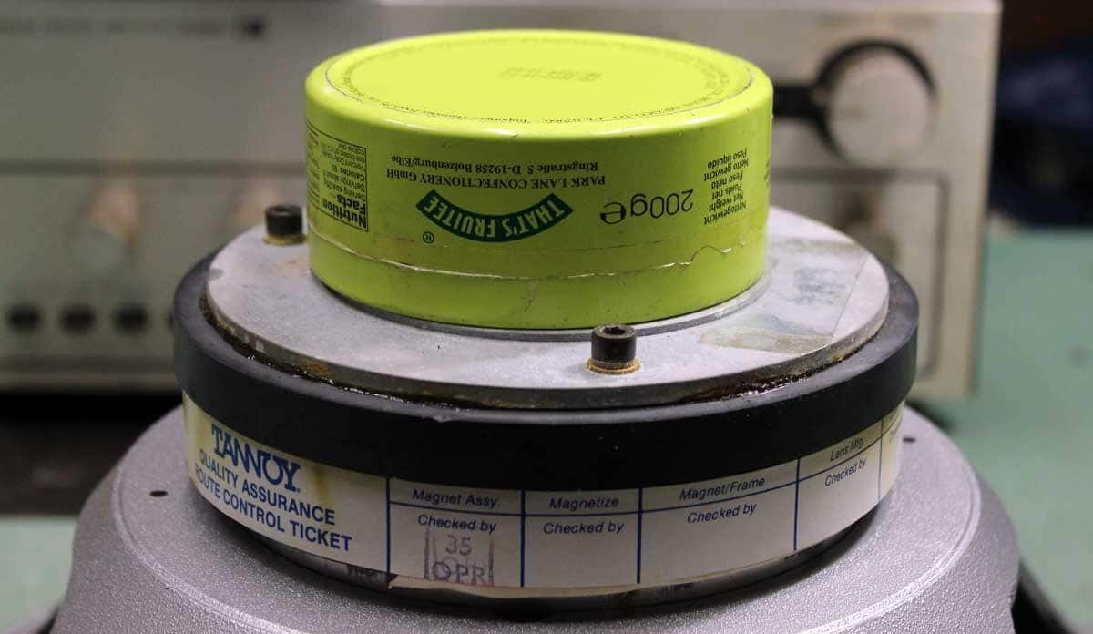

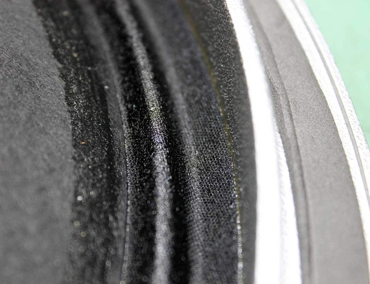

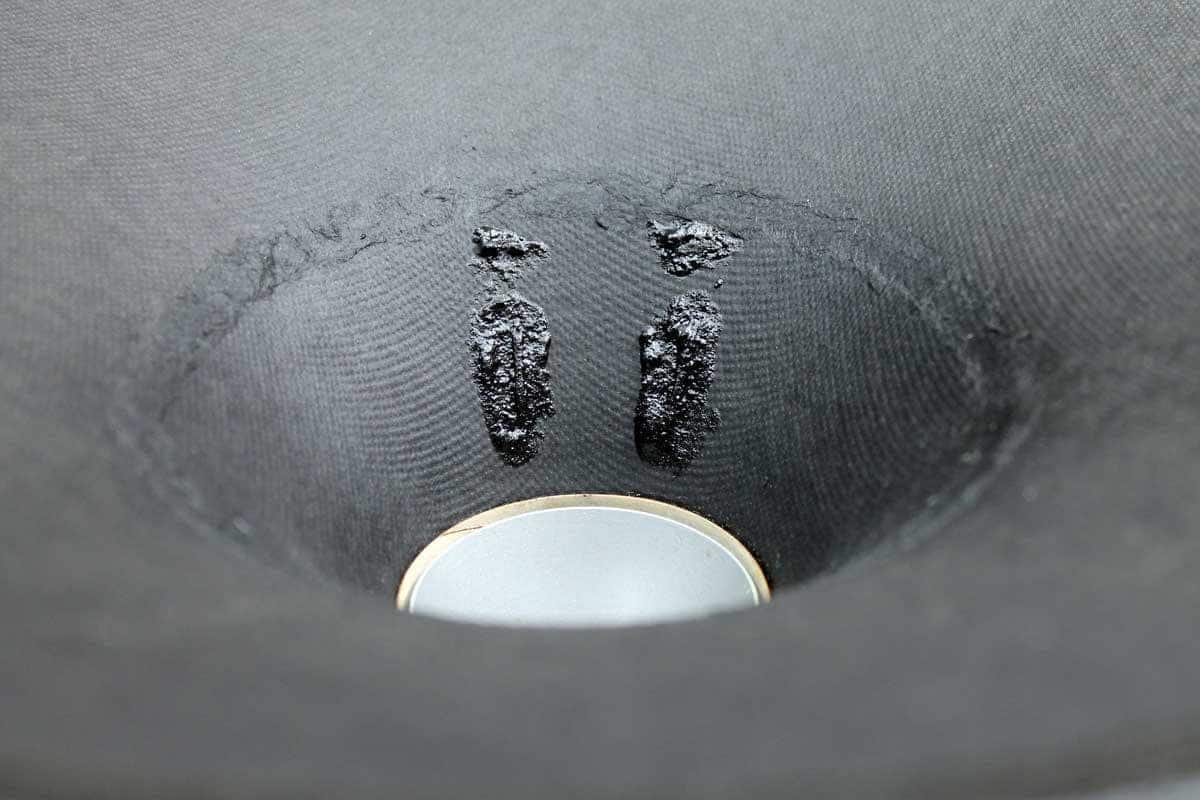

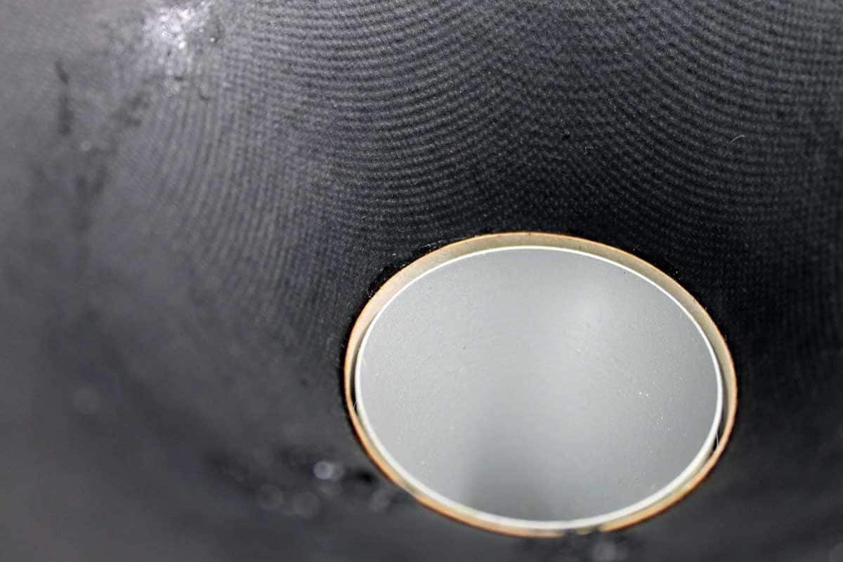

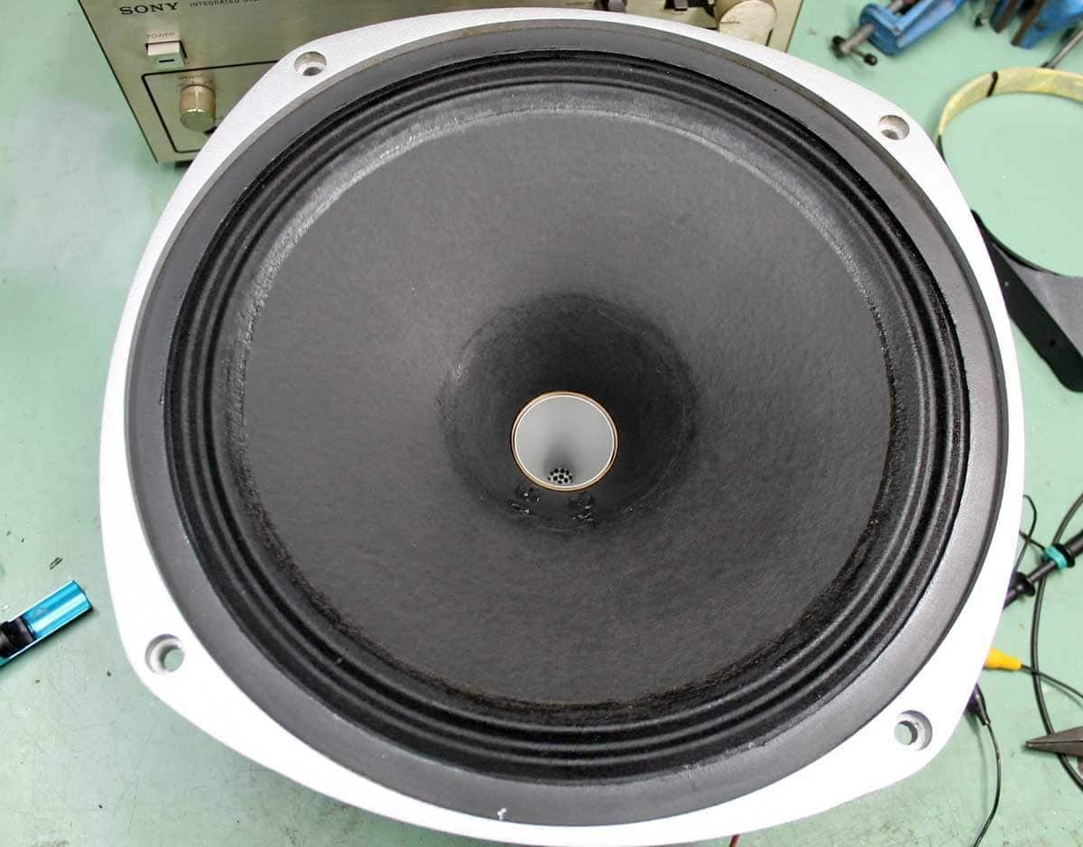

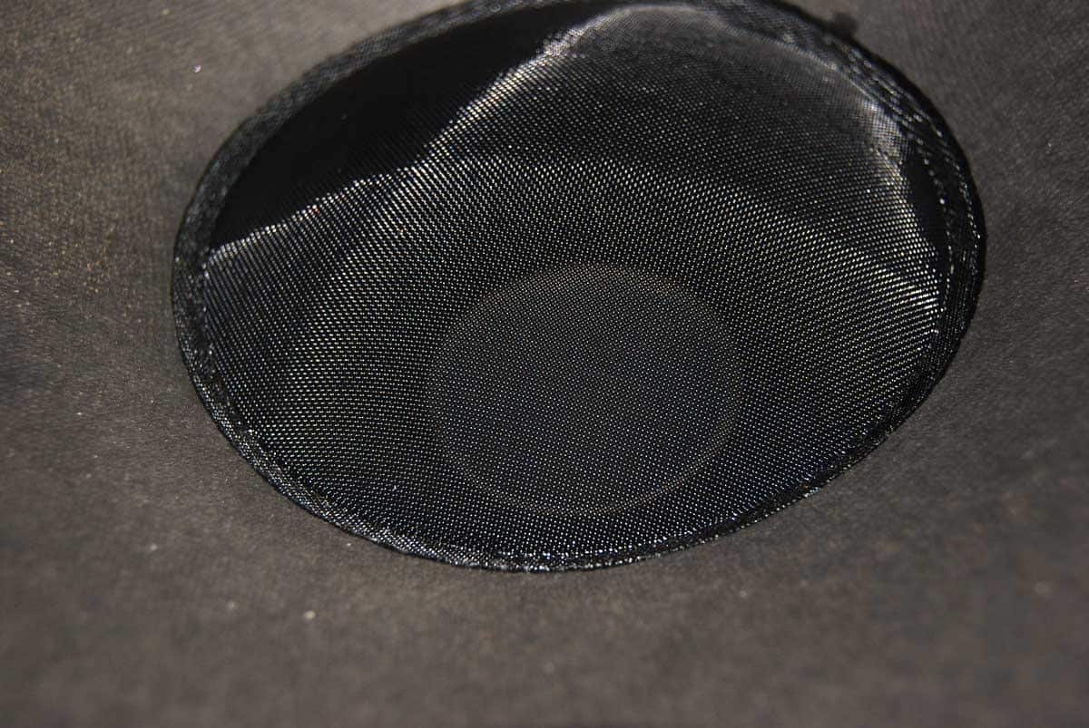

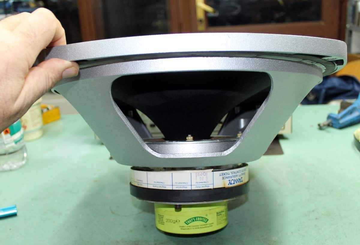

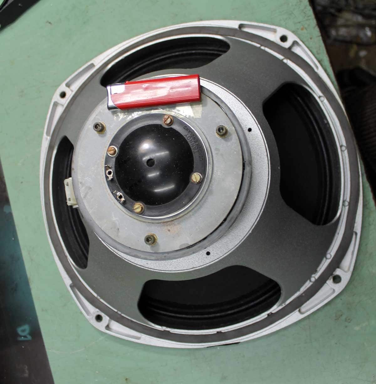

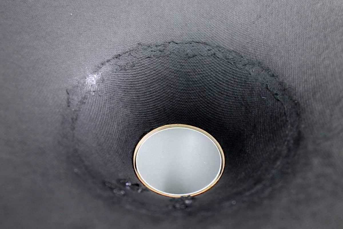

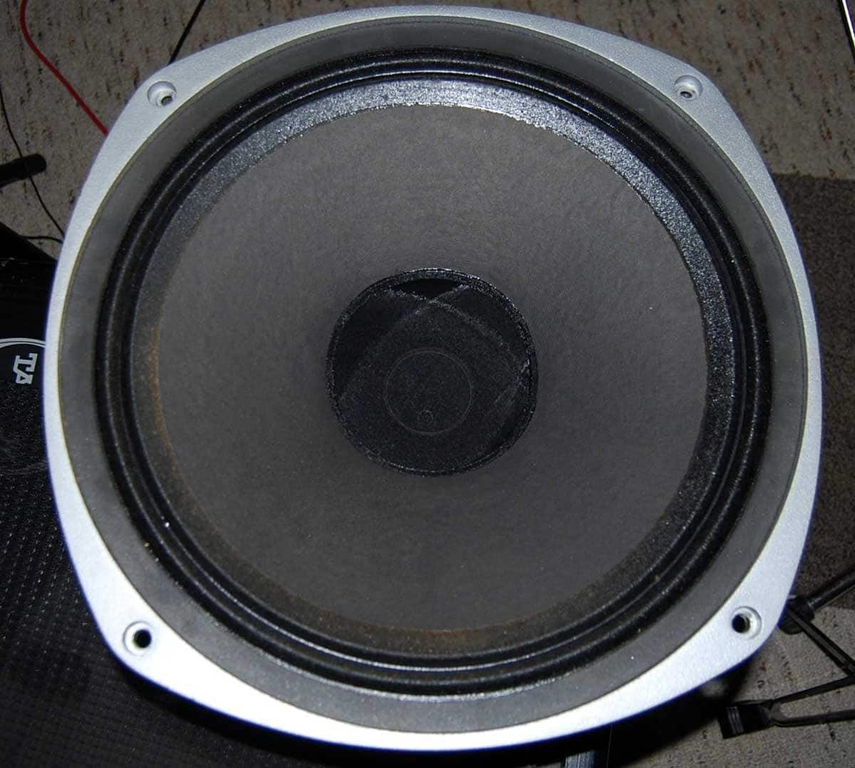

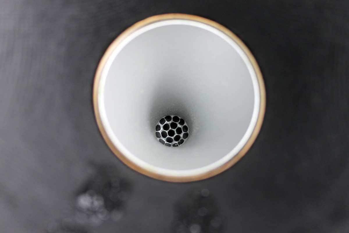

In case that I remember to get cam to my workshop tomorrow , I'll make few pics and put it here , along with few pics of same drivers prior to fun procedure

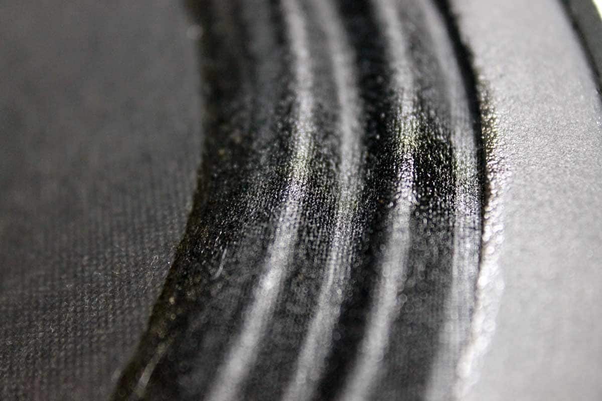

edit : did I told ya that each cone got 2 layers of Dammar ?

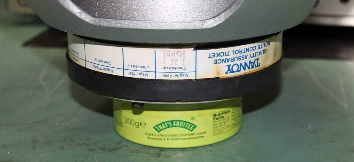

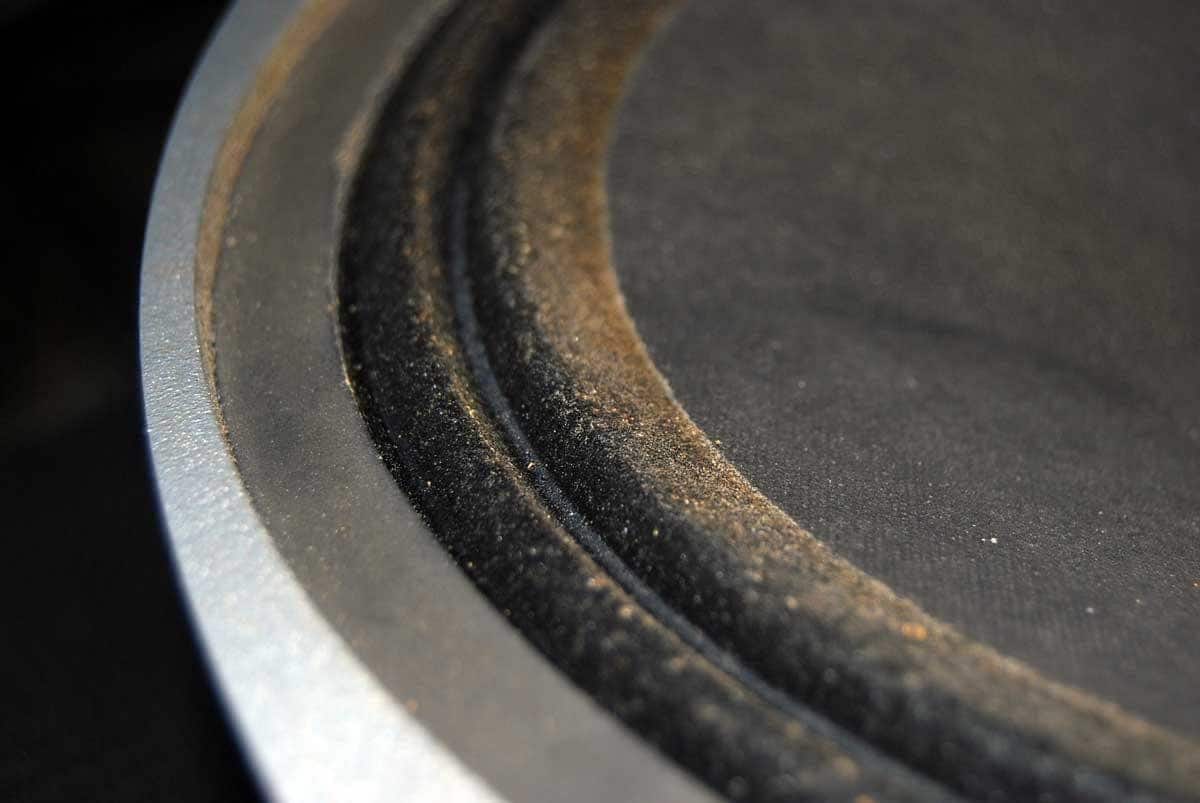

all pics are after treatment , except last 3 ones - sent to me from seller , so prior to procedure ...... months ago
if you're puzzled - here is a link for SigJenny sig gene proggie : http://www.natch.co.uk/downloads/SigJenny/SigJenny.html
