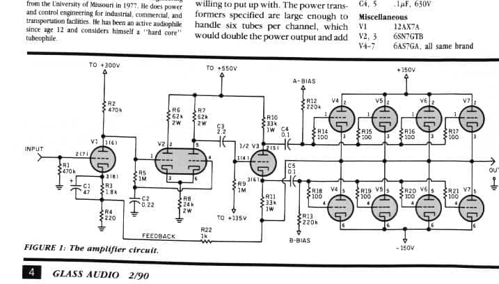

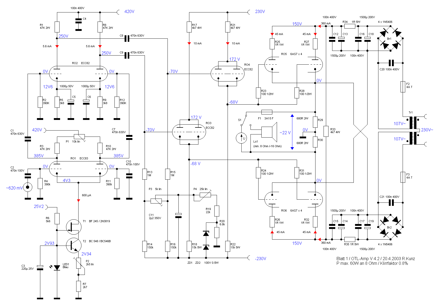

stein Napisano April 18, 2011 Share #2 Napisano April 18, 2011 OTL?Ili za 1k2 na 8 oma:http://www.diyaudio.com/forums/tubes-valves/151251-pls-help-me-buil-my-first-amp-6h5c-6as7-tube.html Link to comment Podeli na ovim sajtovima More sharing options...
MARSAUDIO Napisano April 18, 2011 Autor Share #3 Napisano April 18, 2011 OTL?Ili za 1k2 na 8 oma:http://www.diyaudio.com/forums/tubes-valves/151251-pls-help-me-buil-my-first-amp-6h5c-6as7-tube.htmlOTL je drugom planu. A oni drugi iz linka je PP. Link to comment Podeli na ovim sajtovima More sharing options...
stein Napisano April 19, 2011 Share #4 Napisano April 19, 2011 OTL je drugom planu. A oni drugi iz linka je PP.Samo sam to našao... Link to comment Podeli na ovim sajtovima More sharing options...
