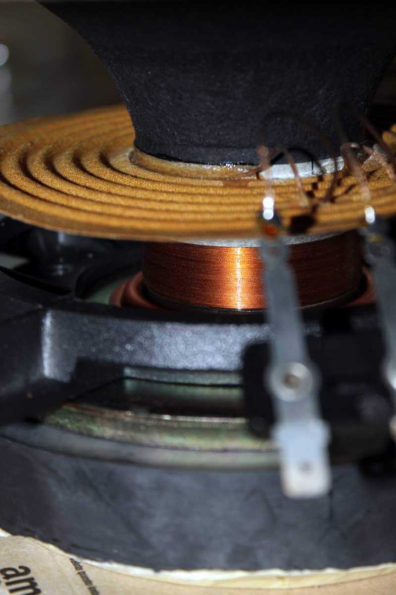

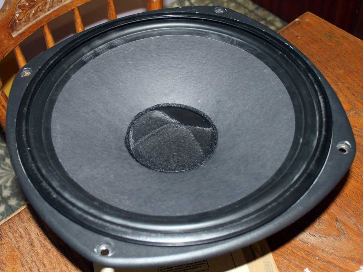

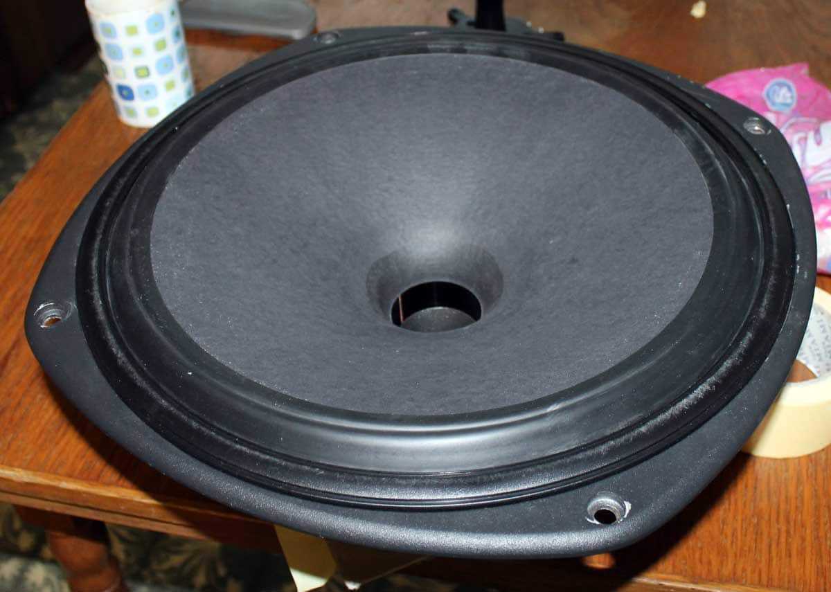

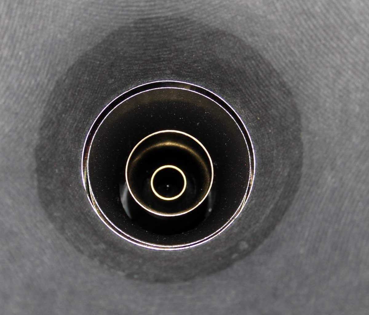

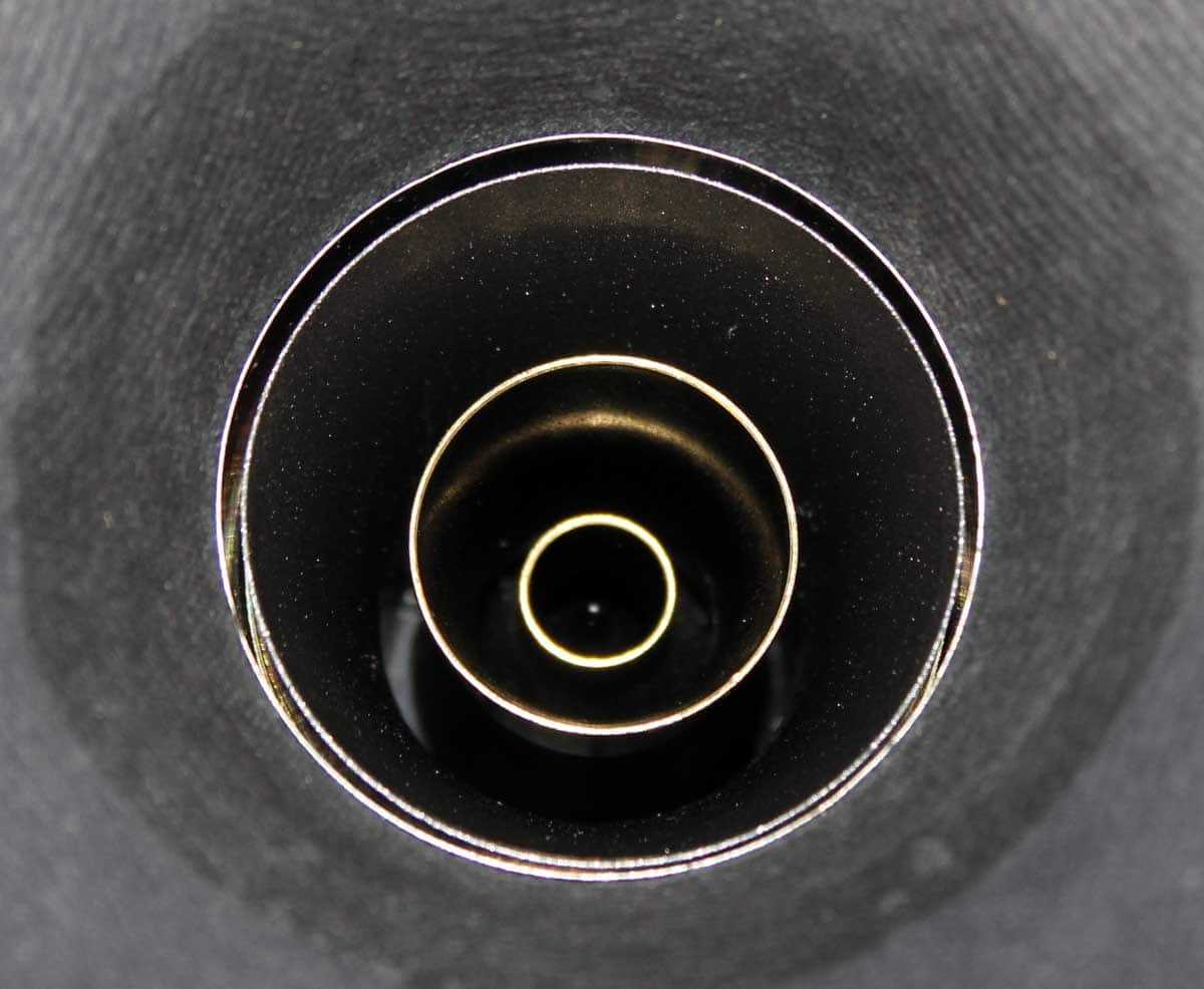

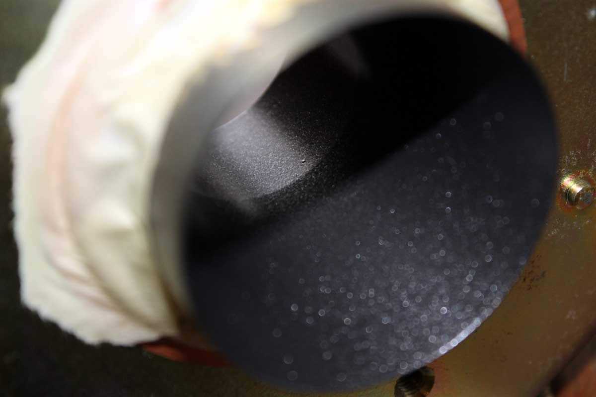

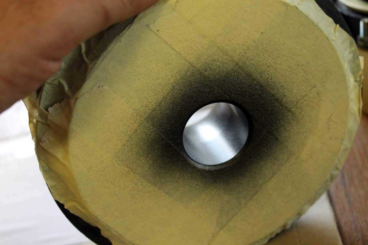

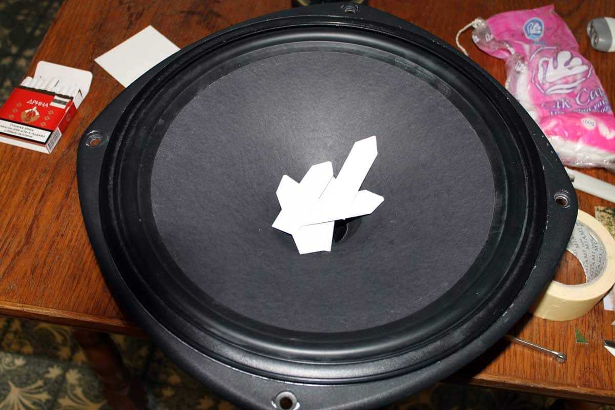

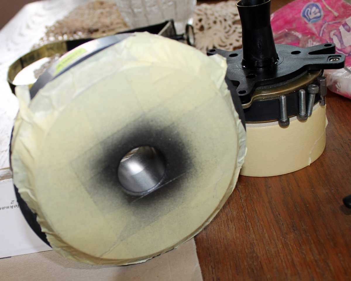

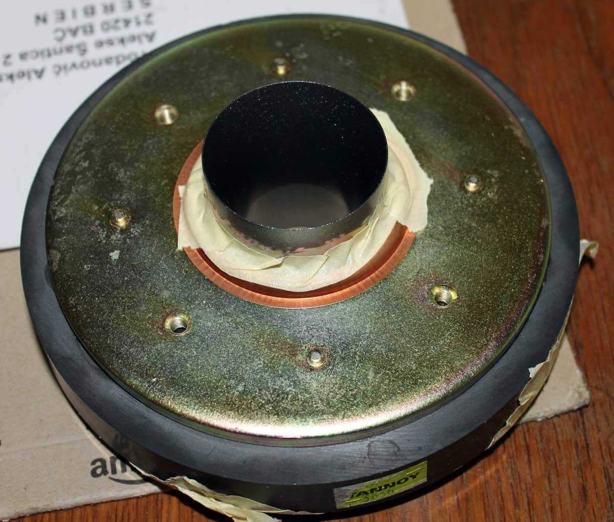

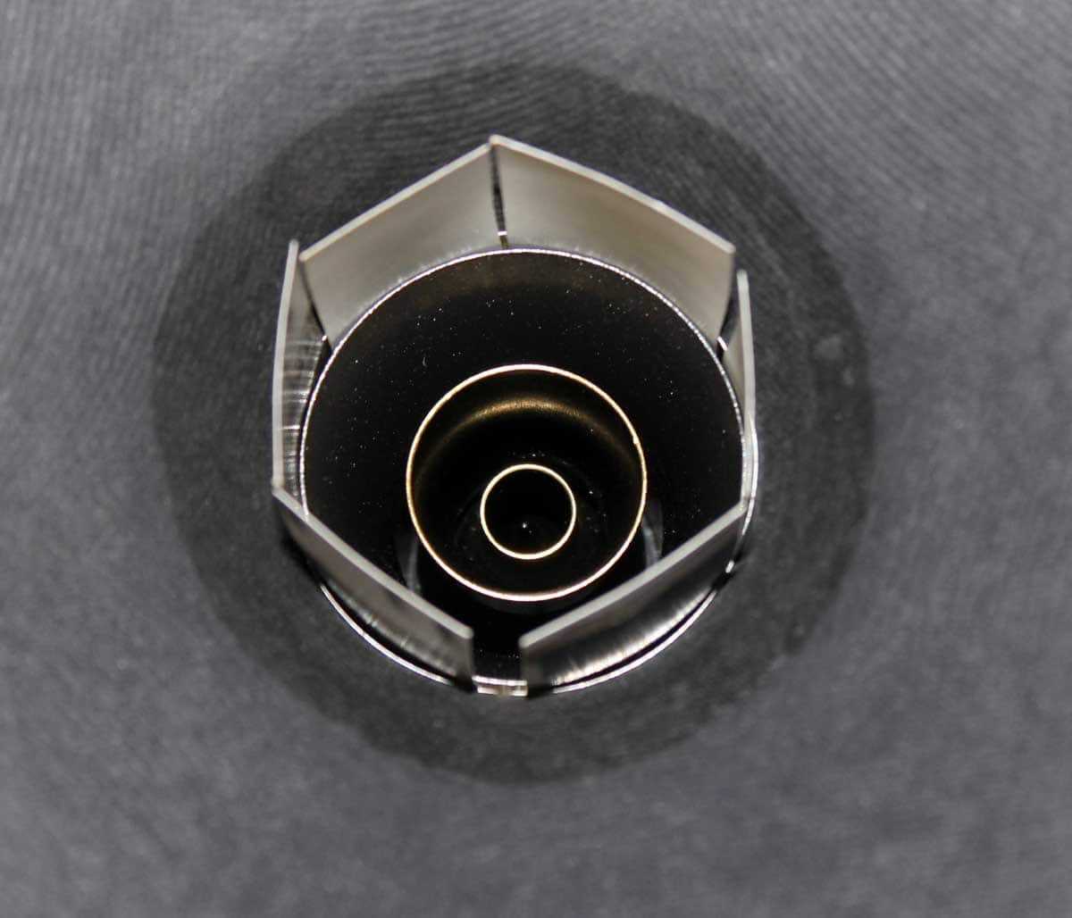

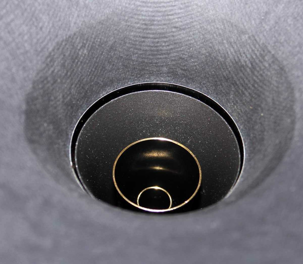

I'm lazy to comment each picture ; cleaned , horn throat sanded , degreased , painted ;

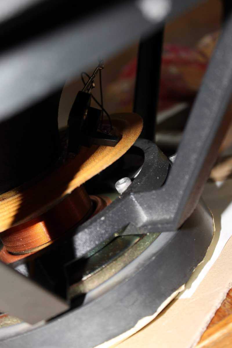

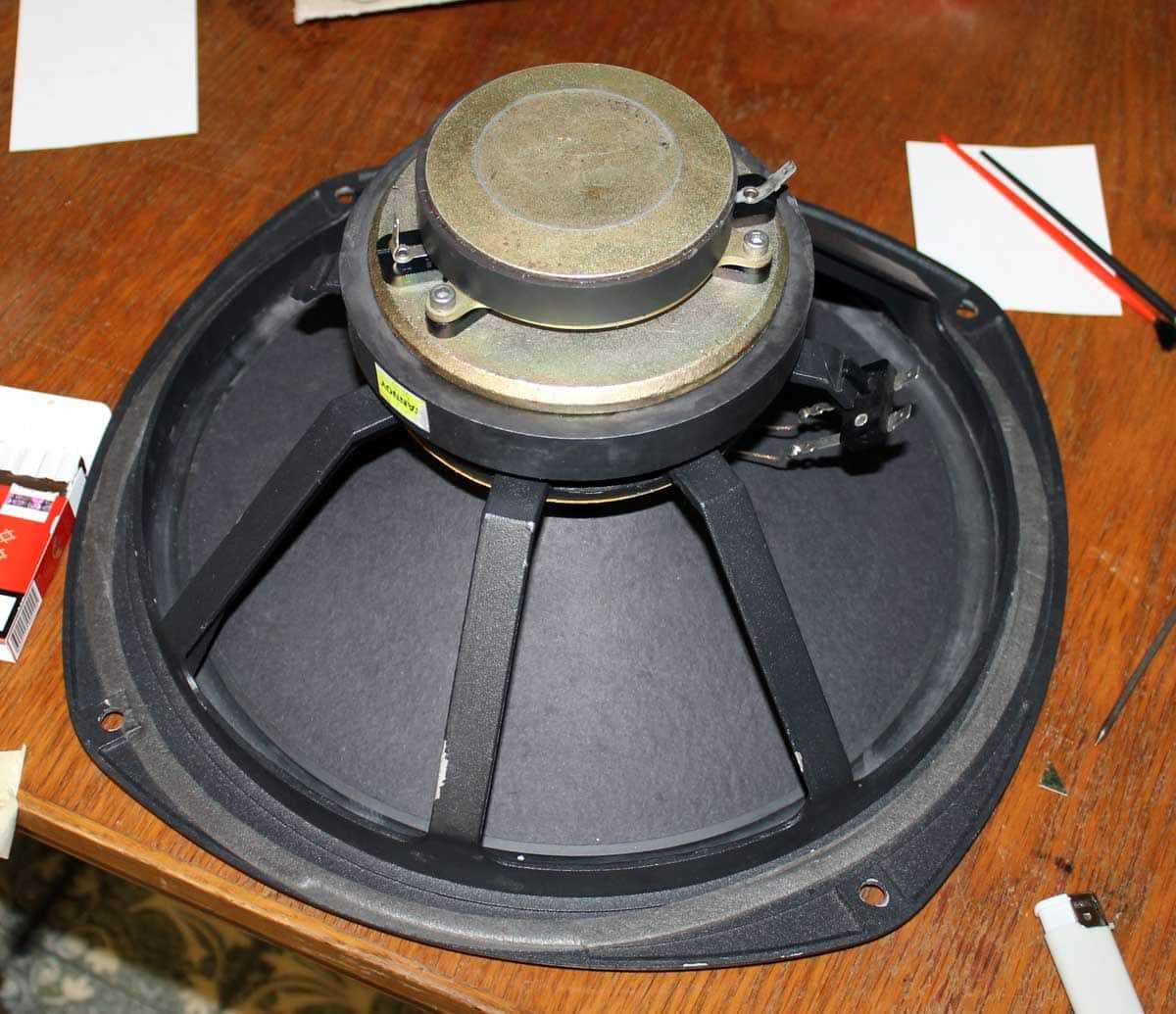

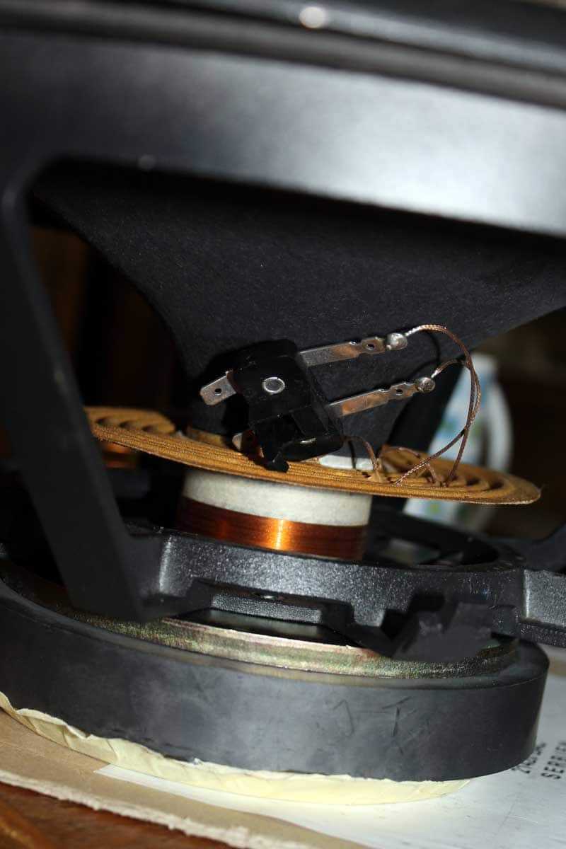

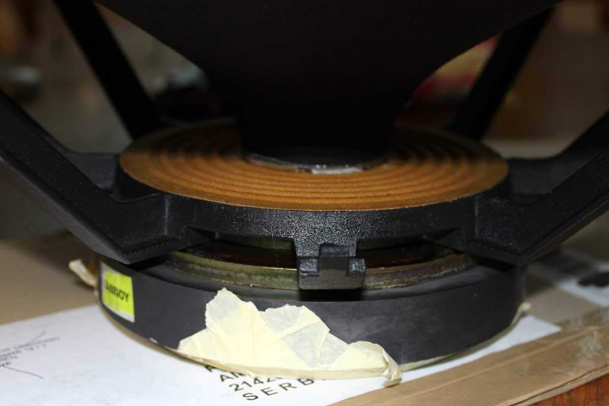

spider area on basket cleaned from glue residue

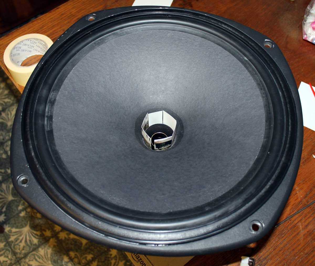

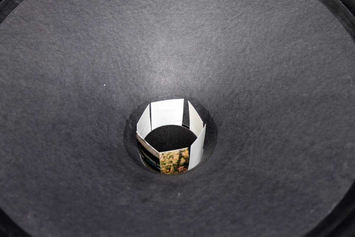

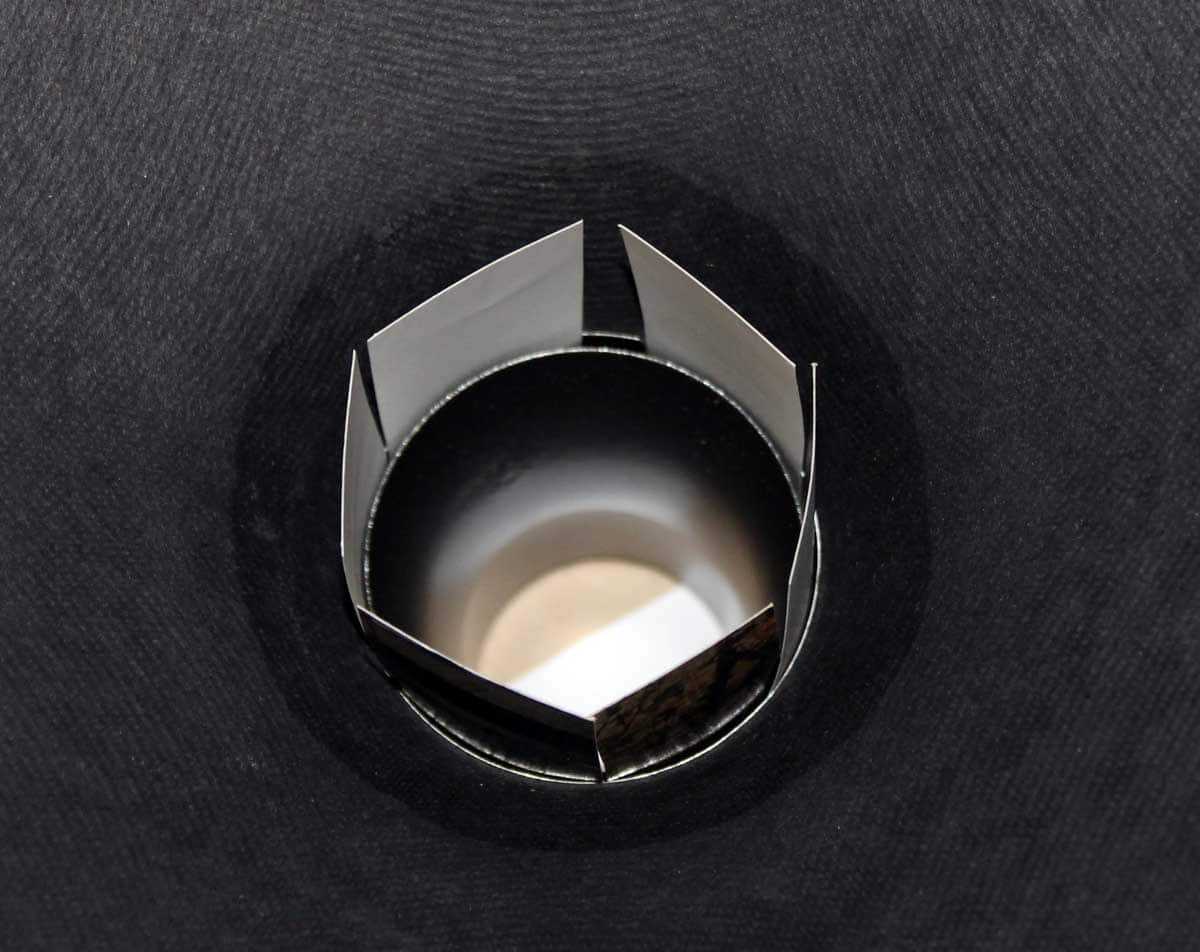

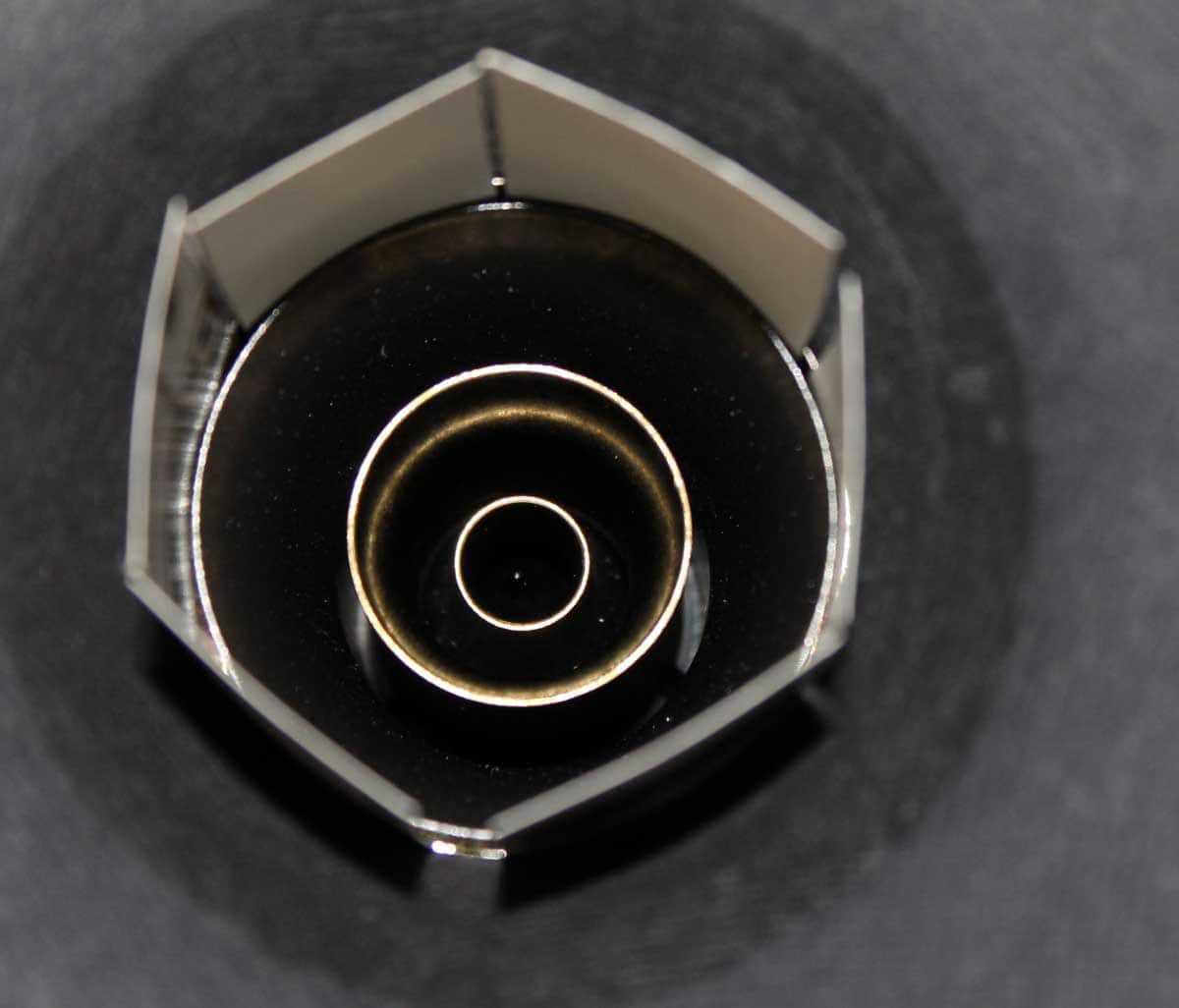

prior to re-gluing it , VC is alligned with shims made of redundant photo ( didn't had usually used plastic foils near by)

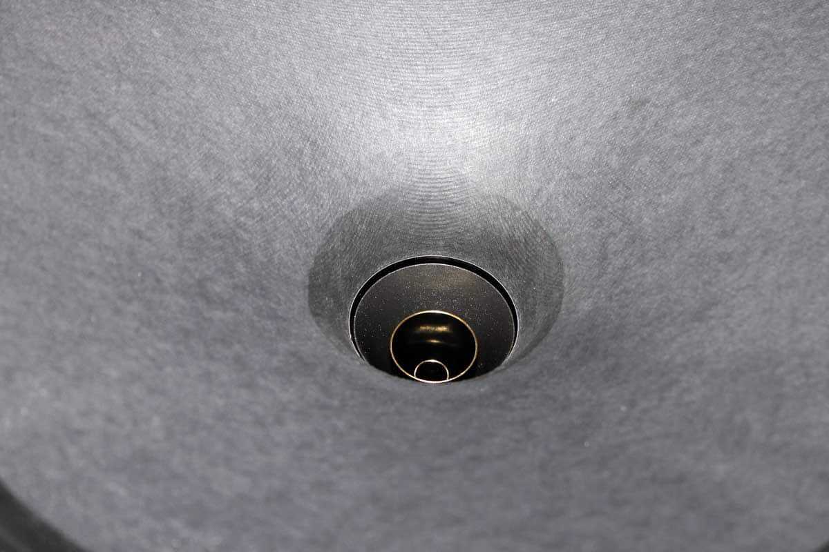

spare mesh dust cap placed just for fun ...... it will not be used

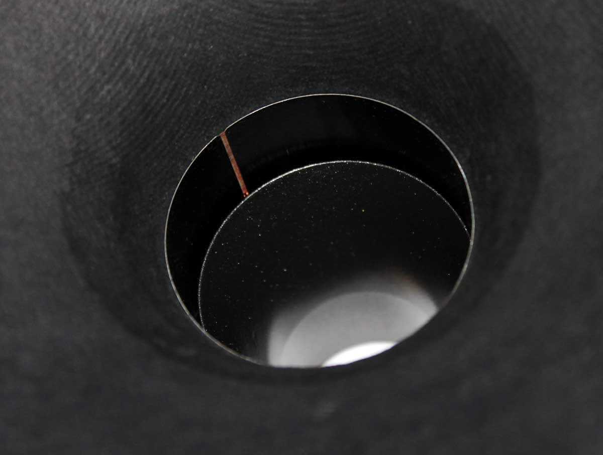

I intend to redo other driver's horn throat in black , to make them same-looking
so - pretty much same work as....or even less than complete recone ...... but without 150E spent unnecessary , for new cone

Eto vidis, fotografija moze da se koristi i za centriranje Tannoy trapa. Da li ce bolje da zvuci jer si koristio srebro sa fotografije?
