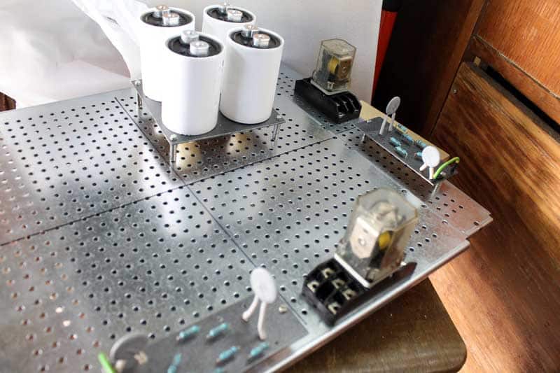

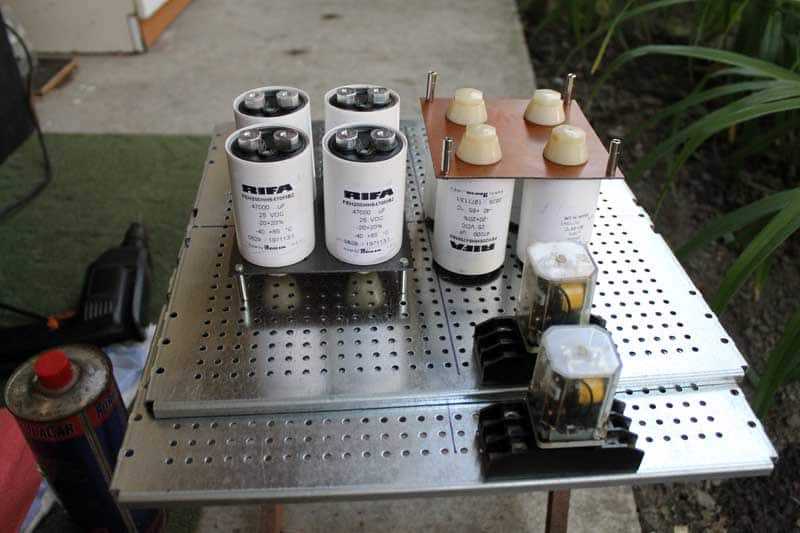

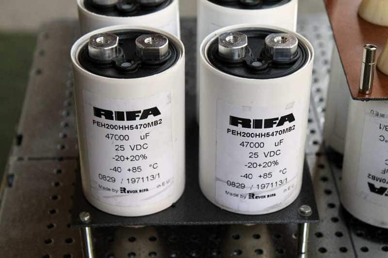

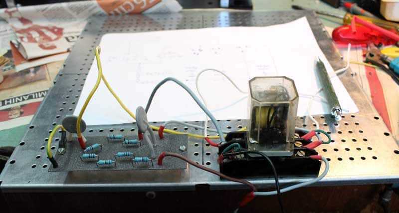

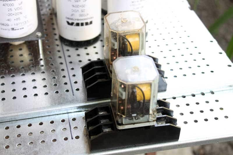

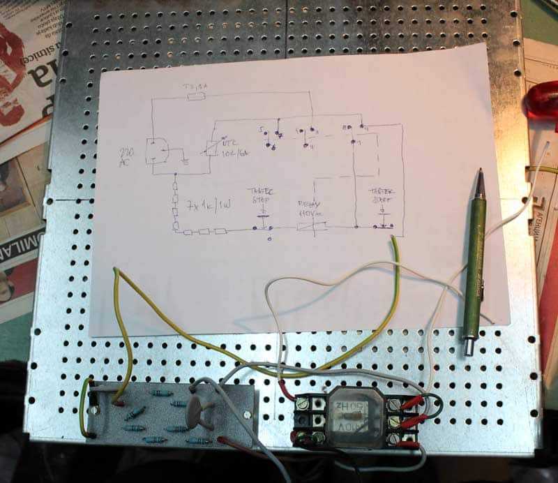

Hi Aleksandar, very fine big Rifa caps!

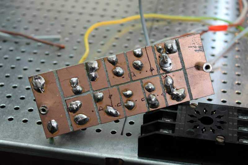

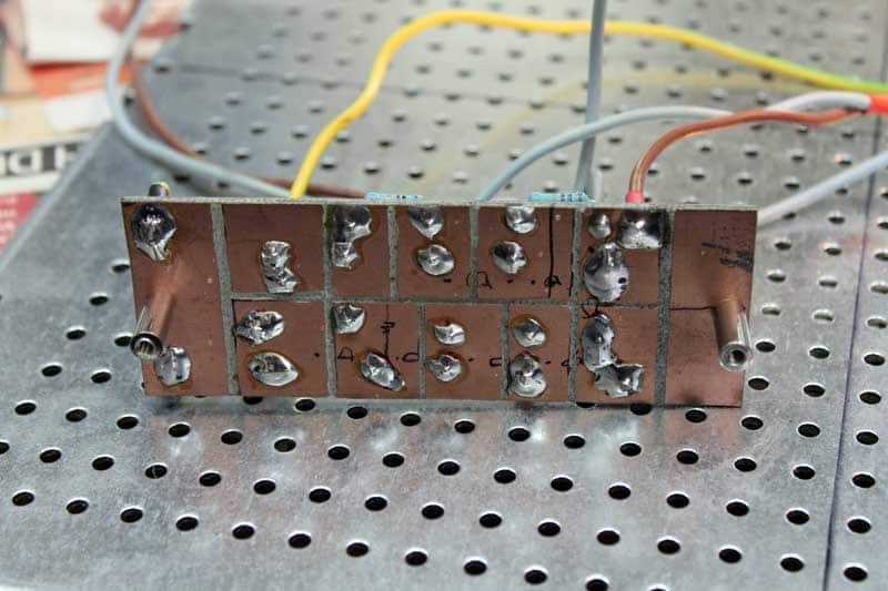

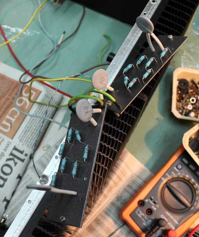

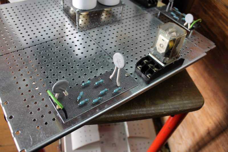

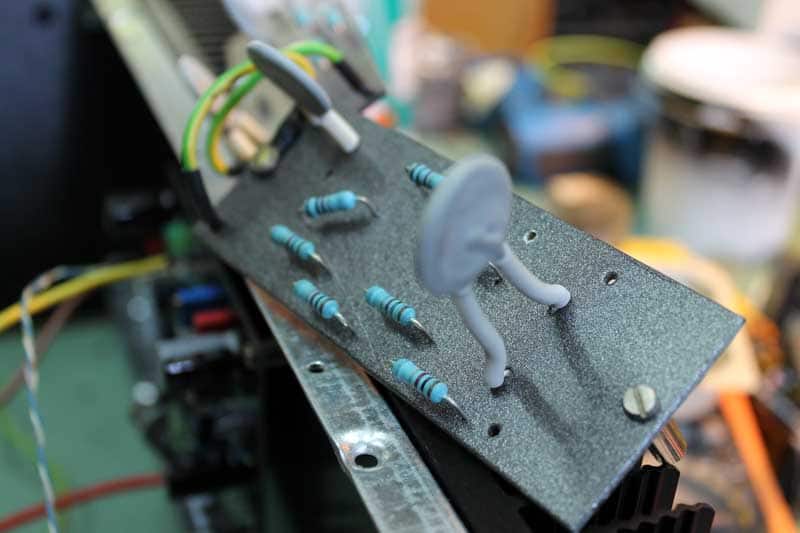

and what is the use of the small resistors near the CL60 thermistors?

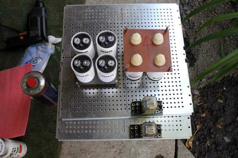

I am satiesfied that even you make the big holes in part one with many small holes with the drilling machine.....!
Zen Mod
more pics added
so , now you can see purpose of small resistors
