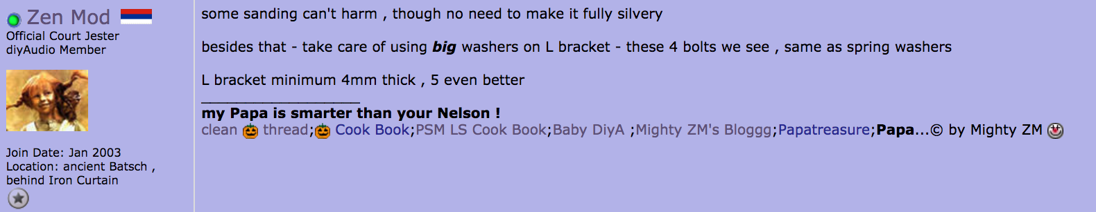

Mikorist Napisano Decembar 2, 2018 Share #861 Napisano Decembar 2, 2018 Link to comment Podeli na ovim sajtovima More sharing options...
