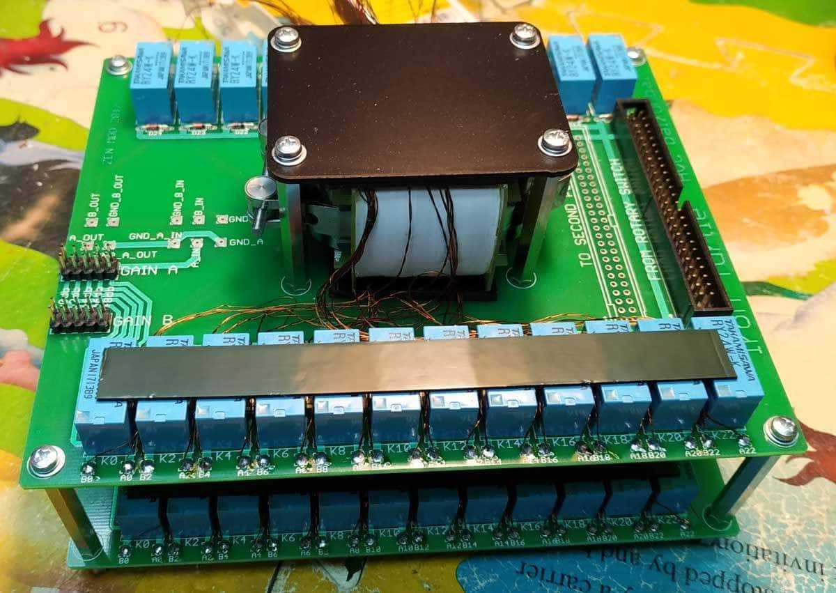

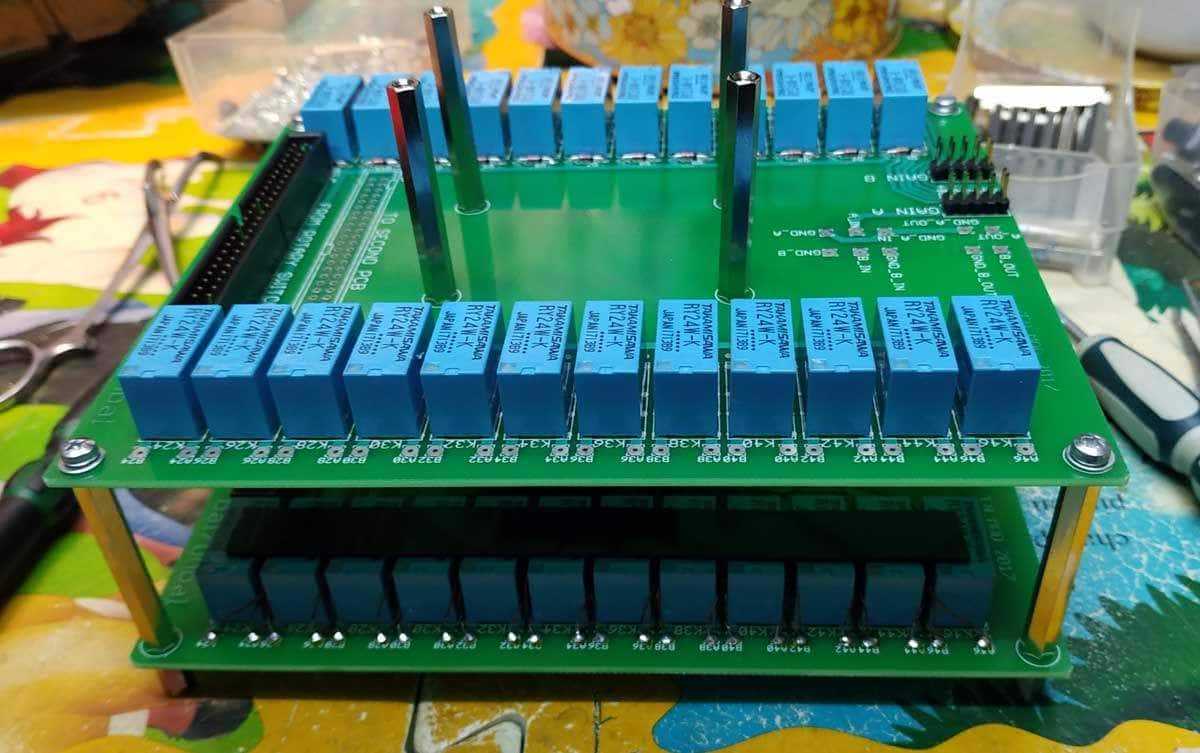

Aleks Napisano Decembar 5, 2018 Share #661 Napisano Decembar 5, 2018 11 hours ago, Zen Mod said: Nego jeli bre, s'ti pokupovao sve zalihe odstojnika 50mm iz eMGe-a, ak nisi pričaj gdes nabavio (krava te ubola)? Nema niđe već nedeljama, ko da tražim semajlirane pufne stantusno za frezenklovanje.. Link to comment Podeli na ovim sajtovima More sharing options...
Leonardo Napisano Decembar 5, 2018 Share #662 Napisano Decembar 5, 2018 45 minutes ago, Zen Mod said: edit: pretpostavljam da je najlaksi ( iako ne i najbrzi ) nacin da cujes u svom okruzenju - kad onaj vrljavi Webhamster dobije svoju , pocetkom godine , kontam ..... ako ti se svidi sto cujes ( u sta sumnje nemam) , Zasluzni Majstor Leo je zasluzio zasluzeni popust - po ceni kita , uz prethodno dostavljeni ostali hardware , dobija sastavljen uredjaj Biće to reprezentativni primerak, vredan pojavljivanja na RMAFu, Diy.rs POWER Mikorist je reagovao/la na ovo 1 Link to comment Podeli na ovim sajtovima More sharing options...

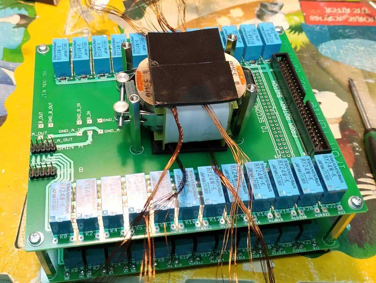

Mikorist Napisano Decembar 5, 2018 Share #663 Napisano Decembar 5, 2018 da okačim i ovde šta ide u Bundevu https://www.hitachi-metals.co.jp/e/products/elec/tel/pdf/hj-b11-a.pdf ne znam tačno koji je model.... ali je ovo Quote Metglas is Amorphous metal alloy with a non crystalline structure produced by ultra-rapid quenching (about 1 million ℃ per second) of molten alloy. Because amorphous metal has no anisotropic properties, which originated from a crystalline structure, and there are no crystalline grain boundaries to prevent motion of magnetic domain walls, it shows excellent magnetic properties such as high permeability and low loss while having a high-saturation magnetic flux density. Amorphous metal materials for transformers, whose main ingredient is Fe (iron), are used in power line transformers and industrial transformers. Compared to conventional materials such as silicon steel, amorphous metal materials have a small no-load loss (iron loss), 1/5 that of silicon steel. Therefore, they make a major contribution to energy conservation. Hitachi Metals provides amorphous metal ribbon. Link to comment Podeli na ovim sajtovima More sharing options...

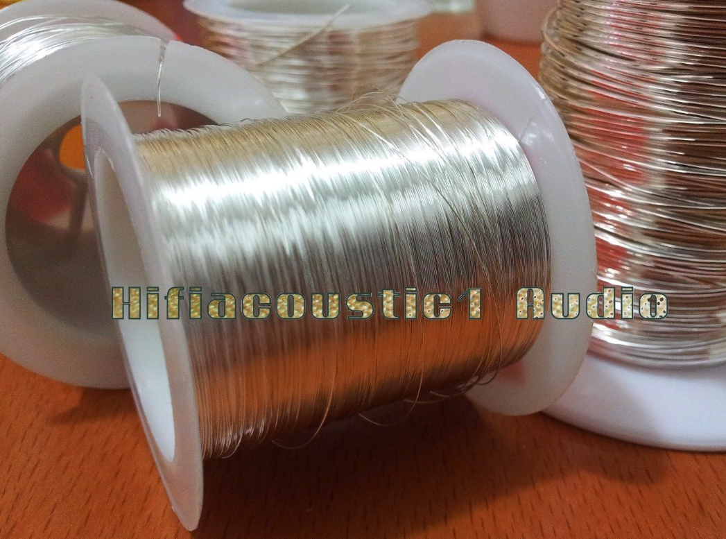

Mikorist Napisano Decembar 5, 2018 Share #665 Napisano Decembar 5, 2018 42 minutes ago, vladd said: Pa eto, buducnost je tu... Mada je to druga vrsta kreacije, ova do sada je specificno suptilna, a bez upliva magije... Pa da. Gubici u gvožđu smanjeni na jednu petinu... odnosno izobličenje.... Šta misliš šta bi se dobilo srebrom da se mota ? Nađoh 0.2mm 5N Solid Core Pure Silver (lak žica) ....... oko 500$ kotur.... Link to comment Podeli na ovim sajtovima More sharing options...
guja011 Napisano Decembar 5, 2018 Share #666 Napisano Decembar 5, 2018 ti zbavim to? Link to comment Podeli na ovim sajtovima More sharing options...
Mikorist Napisano Decembar 5, 2018 Share #667 Napisano Decembar 5, 2018 2 minutes ago, guja011 said: ti zbavim to? ima i zlatna.... sve može, samo da dobijem na lotou... Link to comment Podeli na ovim sajtovima More sharing options...
guja011 Napisano Decembar 5, 2018 Share #668 Napisano Decembar 5, 2018 57 minutes ago, Aleks said: Nego jeli bre, s'ti pokupovao sve zalihe odstojnika 50mm iz eMGe-a, ak nisi pričaj gdes nabavio (krava te ubola)? Nema niđe već nedeljama, ko da tražim semajlirane pufne stantusno za frezenklovanje.. http://kelco.rs/katalog/komponente.php?IDgroupweb=8140 Link to comment Podeli na ovim sajtovima More sharing options...
Zen Mod Napisano Decembar 5, 2018 Autor Share #669 Napisano Decembar 5, 2018 58 minutes ago, Aleks said: Nego jeli bre, s'ti pokupovao sve zalihe odstojnika 50mm iz eMGe-a, ak nisi pričaj gdes nabavio (krava te ubola)? Nema niđe već nedeljama, ko da tražim semajlirane pufne stantusno za frezenklovanje.. jok,ja trosim 5 ako ima,40 i 45 Link to comment Podeli na ovim sajtovima More sharing options...
Mikorist Napisano Decembar 5, 2018 Share #670 Napisano Decembar 5, 2018 24 minutes ago, guja011 said: http://kelco.rs/katalog/komponente.php?IDgroupweb=8140 valjda im je ažuriran sajt.... redovno Link to comment Podeli na ovim sajtovima More sharing options...

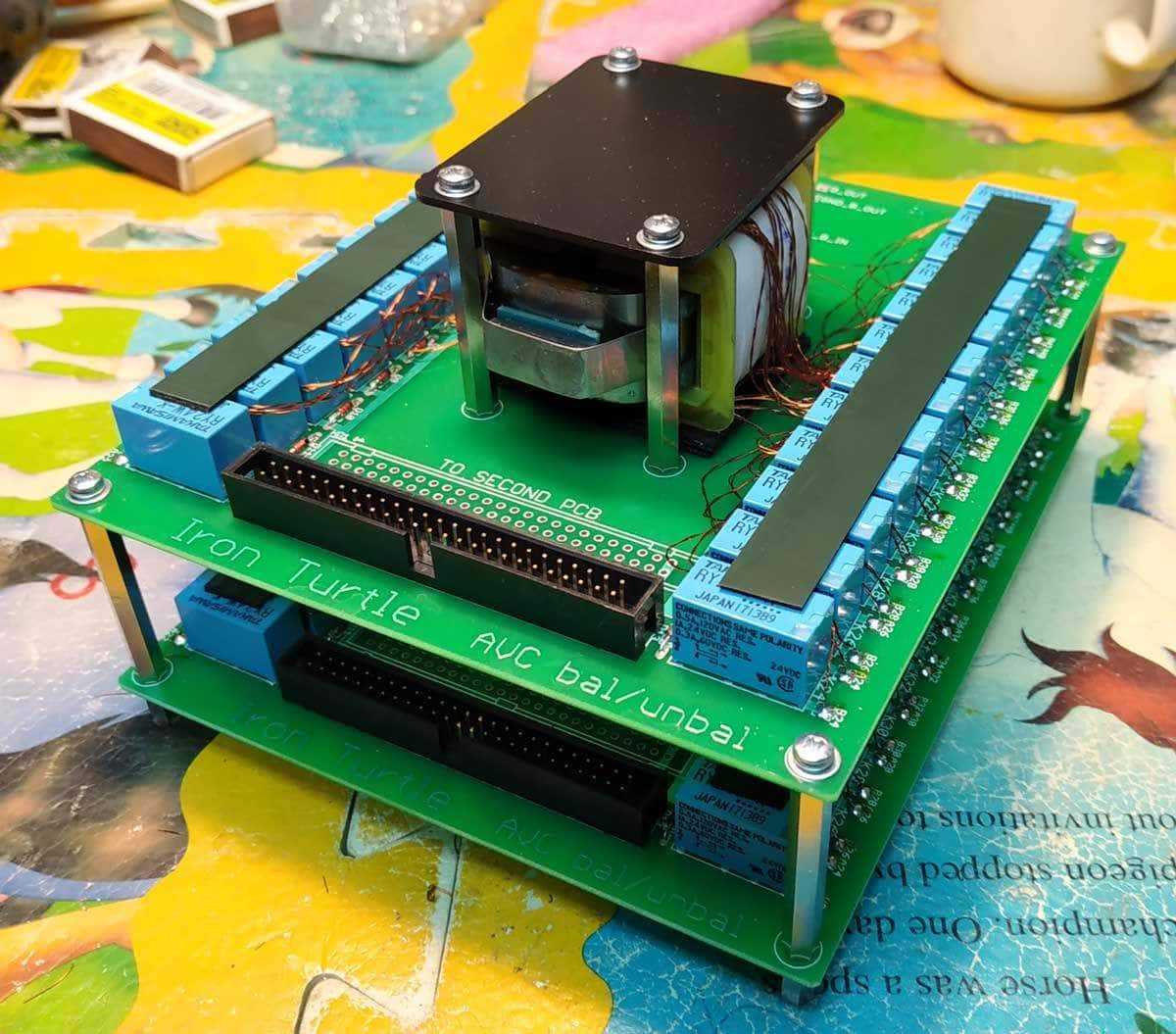

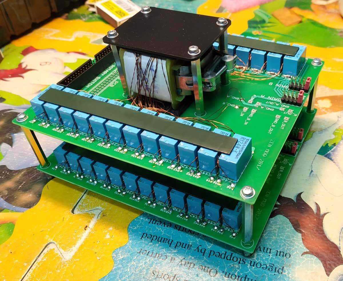

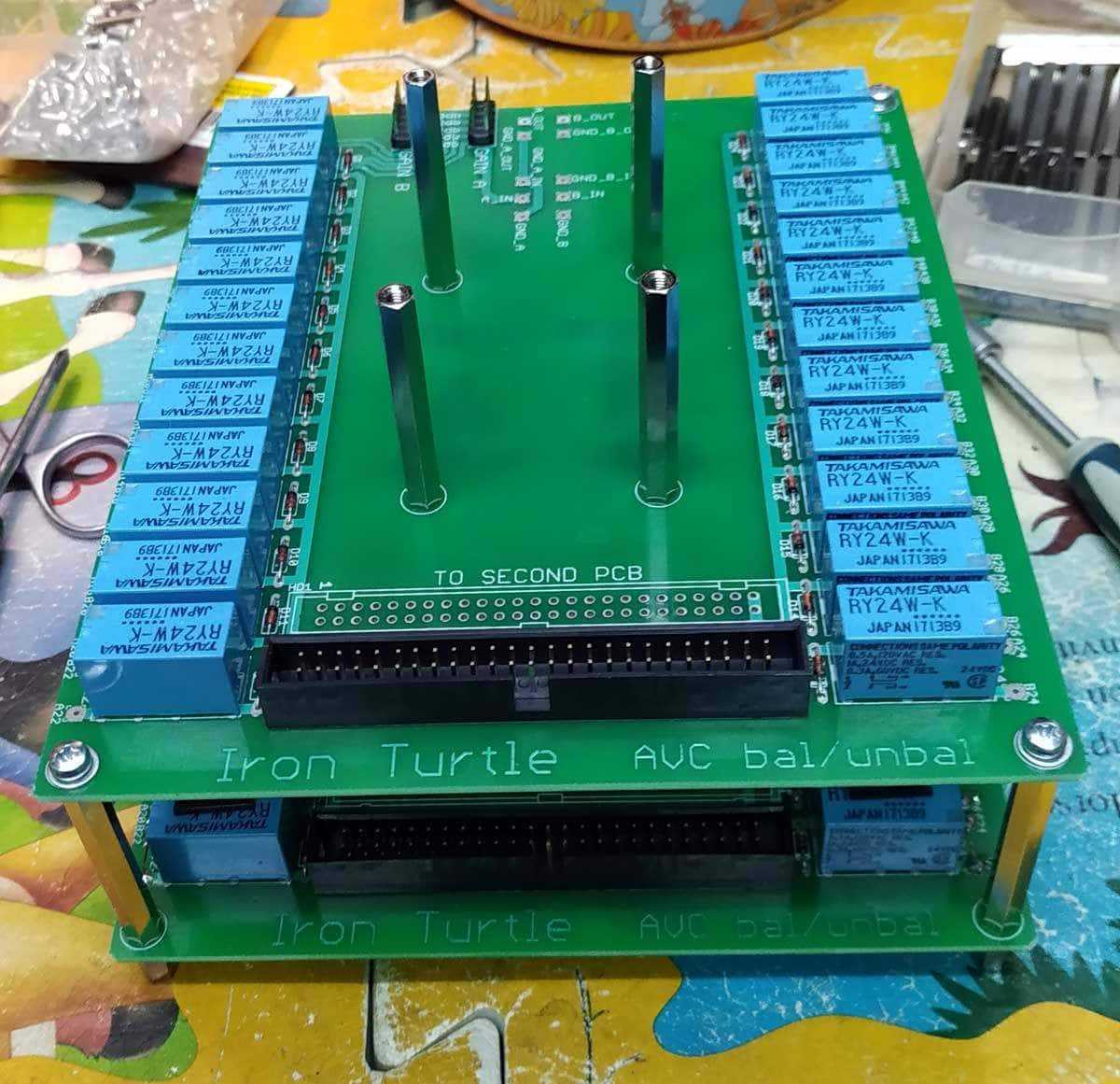

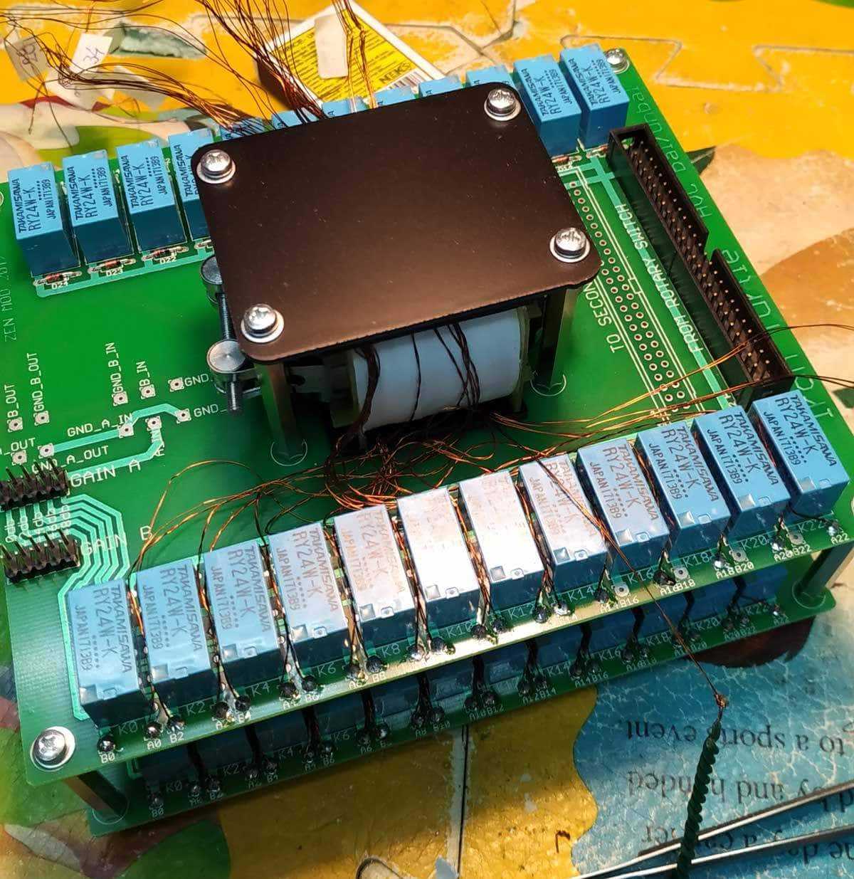

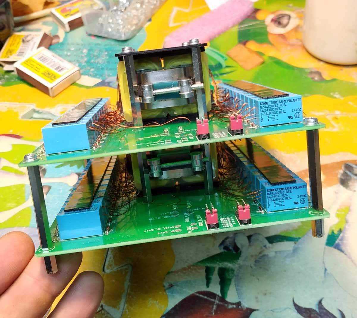

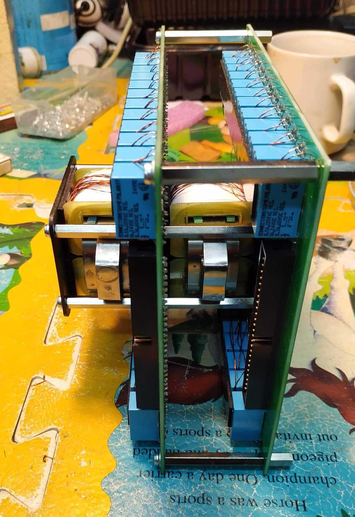

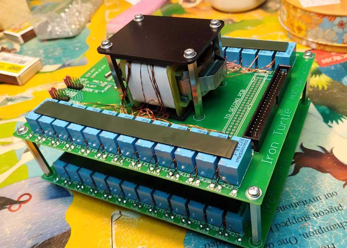

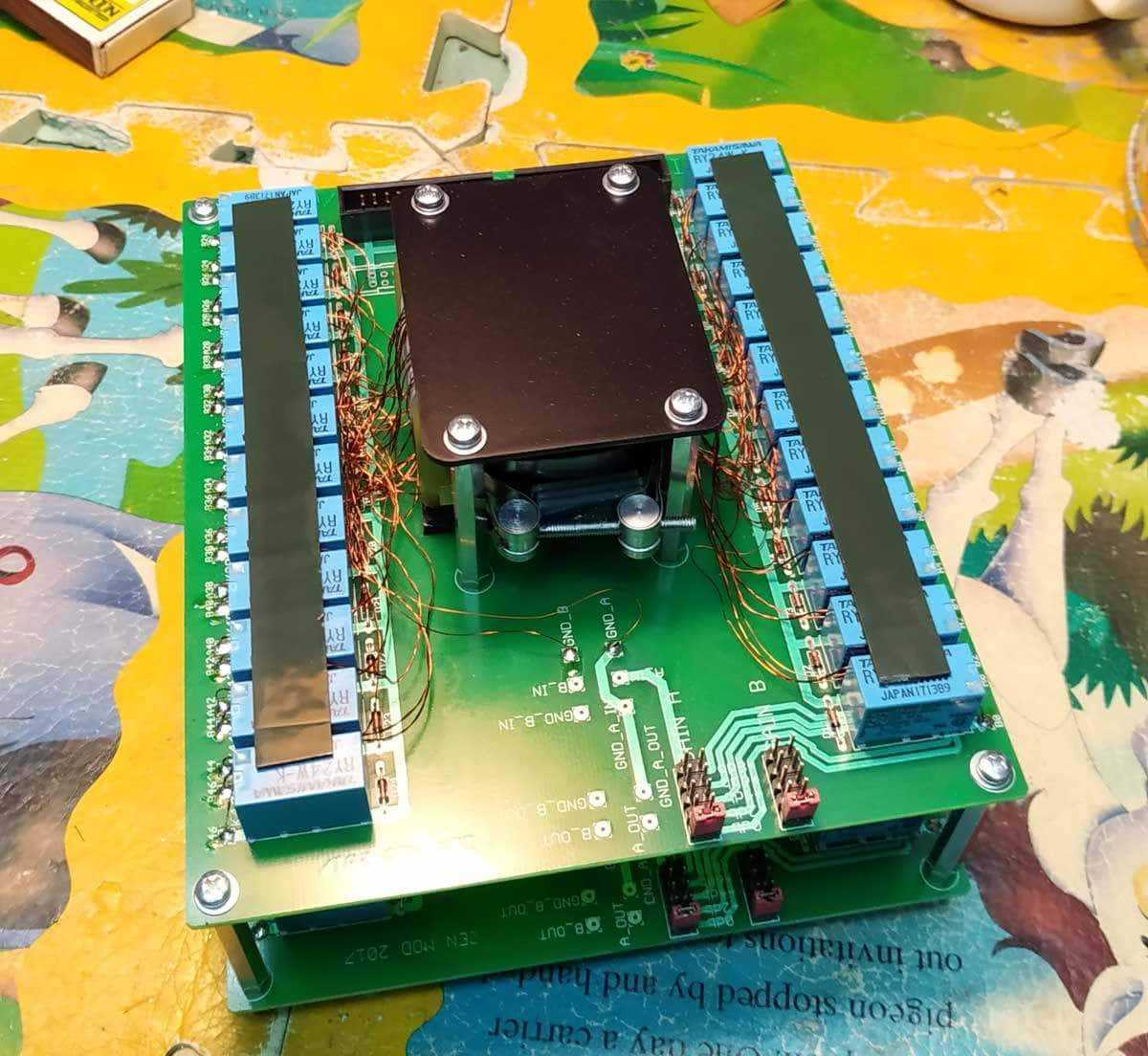

Zen Mod Napisano Decembar 5, 2018 Autor Share #671 Napisano Decembar 5, 2018 zavrsen balansirani Iron Turtle sutra samo jos logo da privrnem .... Leonardo, Mikorist and Dual je reagovao/la na ovo 1 2 Link to comment Podeli na ovim sajtovima More sharing options...

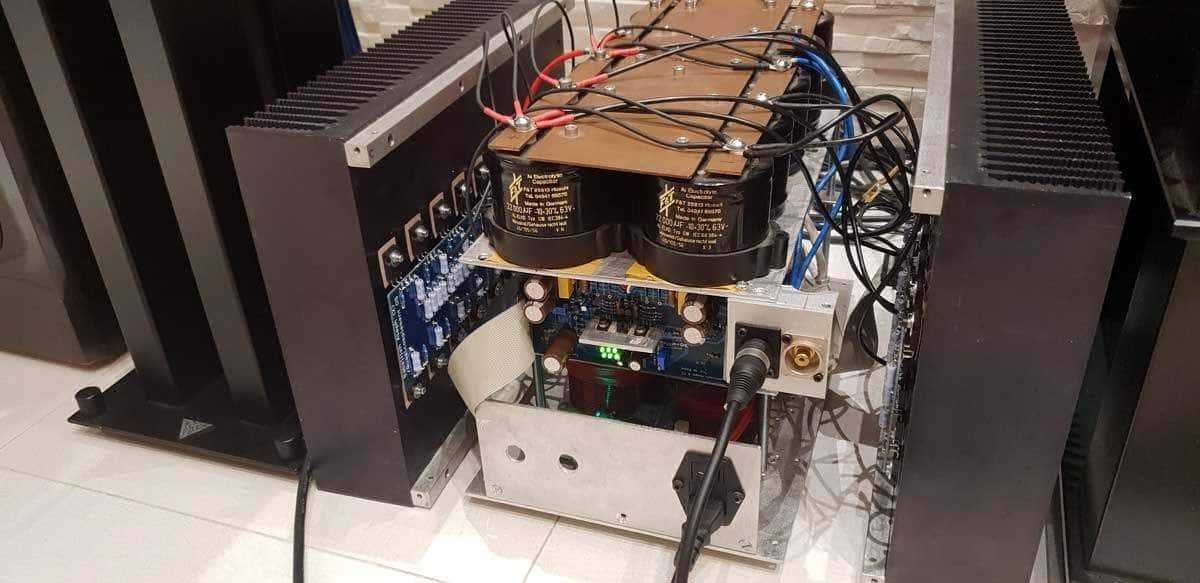

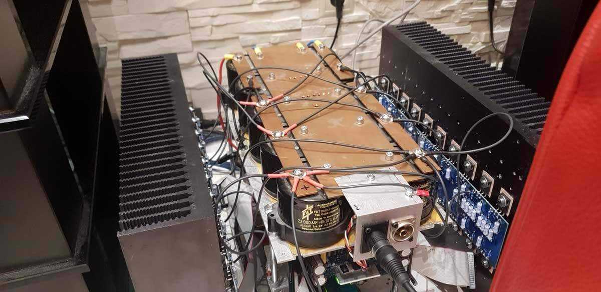

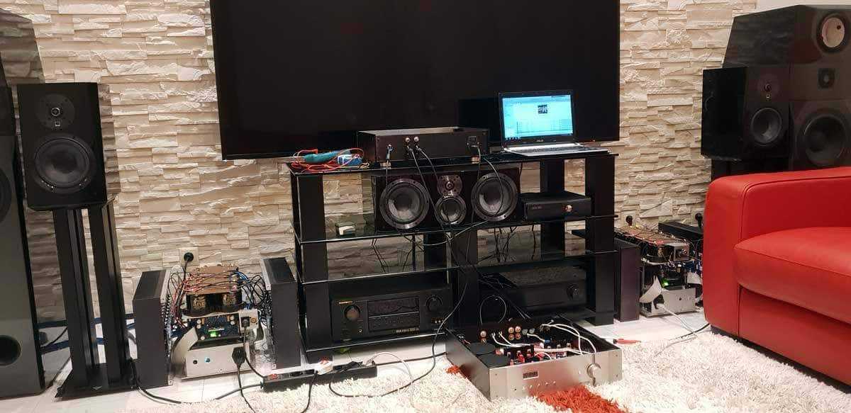

Zen Mod Napisano Decembar 7, 2018 Autor Share #672 Napisano Decembar 7, 2018 napravio covek u Rumuniji Babelfish XJ ono , jos da zavrsi kutijanje .... al' nesto nece zuriti po svoj prilici Mikorist je reagovao/la na ovo 1 Link to comment Podeli na ovim sajtovima More sharing options...
Mikorist Napisano Decembar 7, 2018 Share #673 Napisano Decembar 7, 2018 Daj opis kako svira. Link to comment Podeli na ovim sajtovima More sharing options...

Zen Mod Napisano Decembar 7, 2018 Autor Share #676 Napisano Decembar 7, 2018 1 minute ago, Mikorist said: Daj opis kako svira. otkud ja znam ja ne slusam ampove koje konstruisem ; naucih to od P.J. Walker-a ; msm , to jesam naucio odmah , ostalo tek treba da proucim Link to comment Podeli na ovim sajtovima More sharing options...
Mikorist Napisano Decembar 7, 2018 Share #677 Napisano Decembar 7, 2018 2 minutes ago, Zen Mod said: otkud ja znam ja ne slusam ampove koje konstruisem ; naucih to od P.J. Walker-a ; msm , to jesam naucio odmah , ostalo tek treba da proucim ma copy paste rumunov opis Link to comment Podeli na ovim sajtovima More sharing options...
Mikorist Napisano Decembar 8, 2018 Share #678 Napisano Decembar 8, 2018 10 hours ago, Mikorist said: ma copy paste rumunov opis Quote Now, I really understand what the Polish meant ... that his friend complained. Aleksandar, I did a lot of amplifiers ... but now I feel nirvana! You should just hear some DSD with HQPlayer ... Everything is perfect for me. But the female voices ... leave you breathless. I'm very happy to have the inspiration to do BJX. And I feel so bad I wanted to quit when I did not know why was oscillating. It would have been a big mistake. Now I really have no desire to do anything from amplifiers. "Thanks, Aleksandar, for the joy we today Best regards, Vitali https://www.diyaudio.com/forums/pass-labs/318319-babelfish-xj-jx-whatever-aleph-servo-greedy-boyz-11.html#post5625606 Link to comment Podeli na ovim sajtovima More sharing options...
