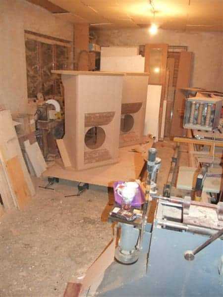

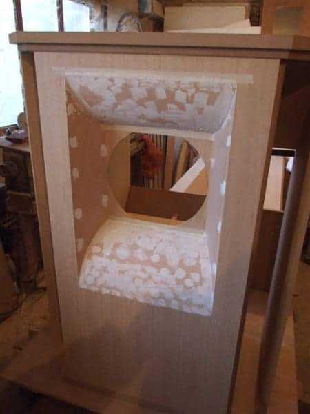

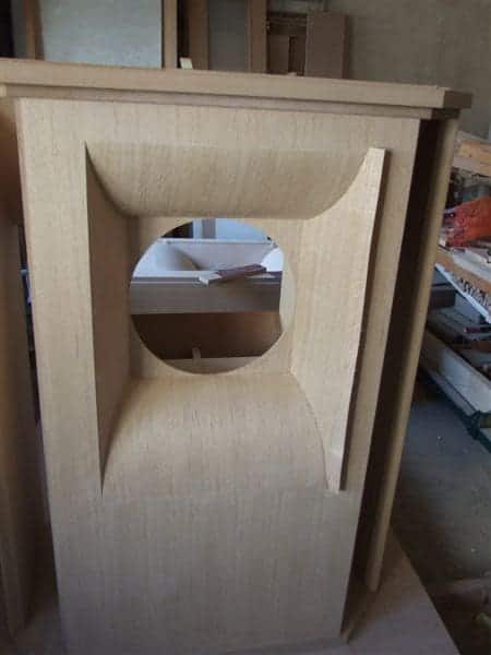

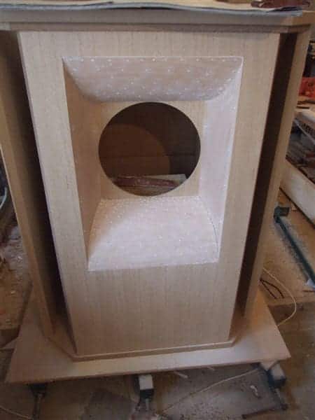

Krivine se dobro obrade šmirglom, priprema za sledeći postupak : stavljanje šper ploče debljine 4mm na MDF
Curves have to be well processed with sandpaper, and the next process could start: putting on the 4mm thick beech plywood on the prepared MDF surface

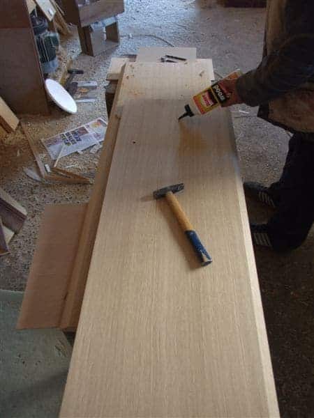

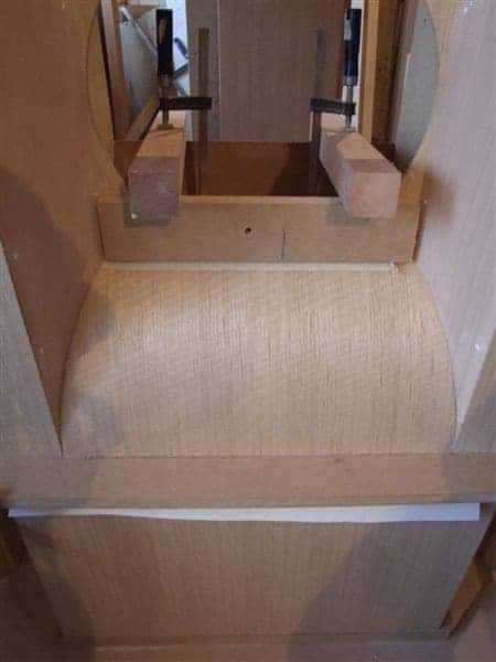

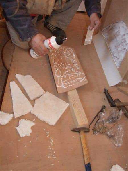

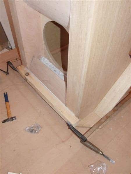

Nanošenje lepka na donju krivinu. šper 4mm je iskrojen pomoću papirnog modela. Nosači naležu 5mm na otvor od H, MDF je 19mm. Kada se sabere to je 28mm što je i debljina H.
Application of glue on the lower curve. The plywood was cut out, using the previously made paper model. Carriers are laying 5mm on the opening of H, the MDF is 19mm thick, the plywood is 4mm thick. All thicknesses added up making 28mm, what is also the thickness of H.

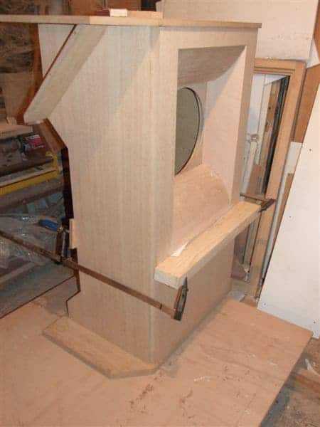

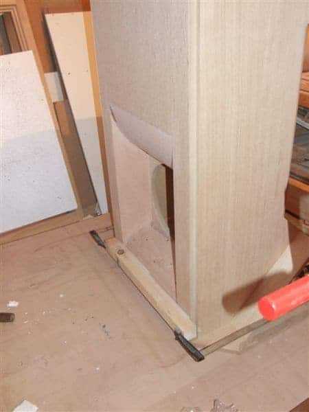

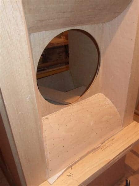

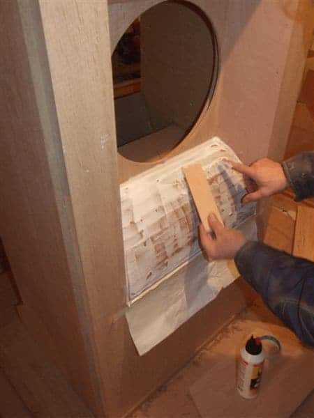

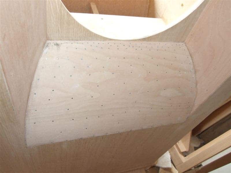

Stavljen šper, donji deo je fiksiran. Postepeno se krivi i kucaju se ekserčići.
The lower part of the plywood was fixed. After that the plywood was gradually bended and set with glue and small nails.

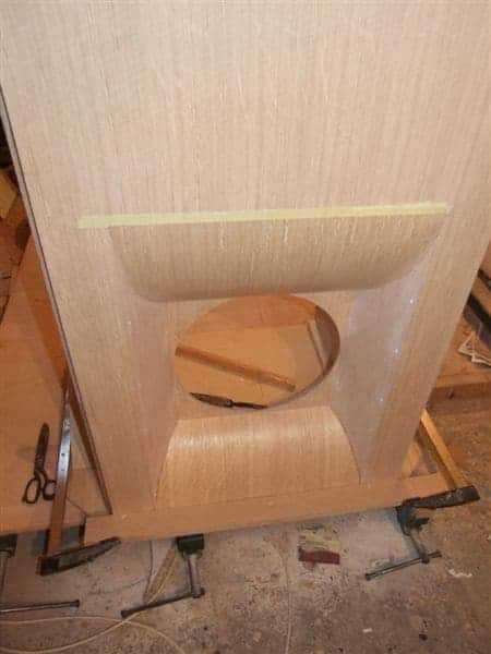

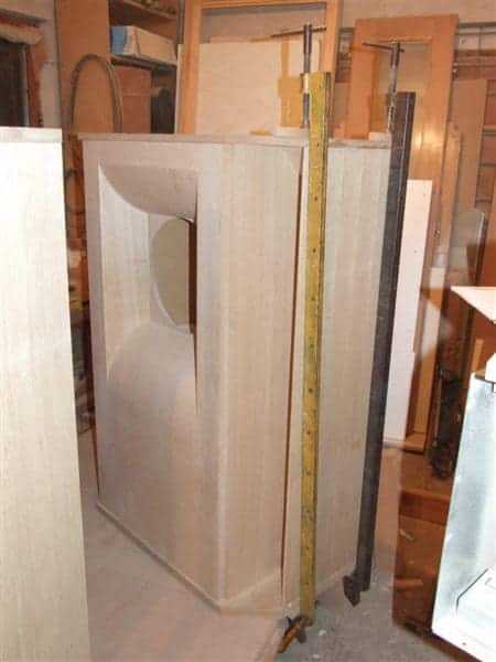

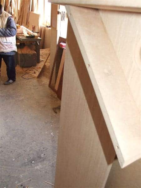

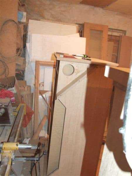

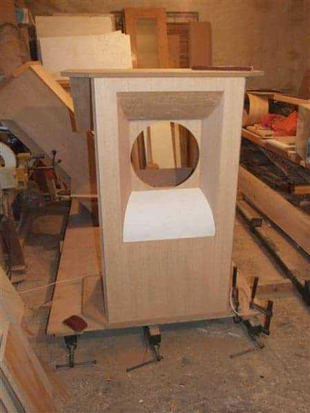

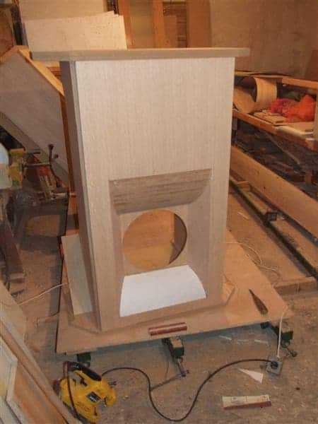

Okrene se kutija, stavlja se šper 4mm, priprema i realizacija je identična kao u prethodnom slučaju
Then the box was turned around, and the 4mm plywood was pasted. Preparation and realization is the same as above

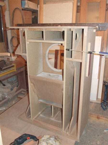

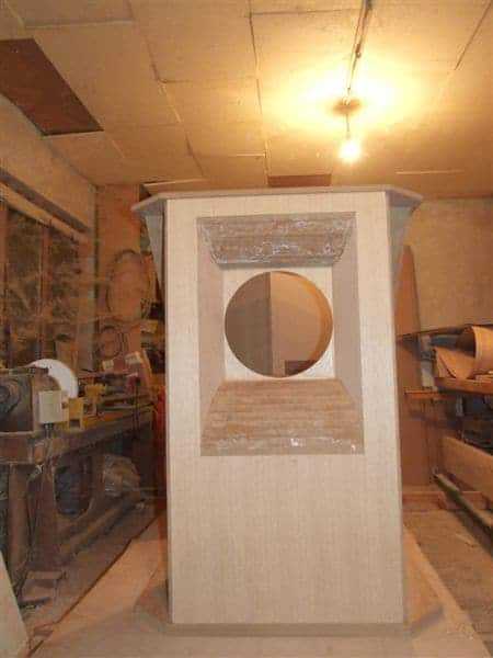

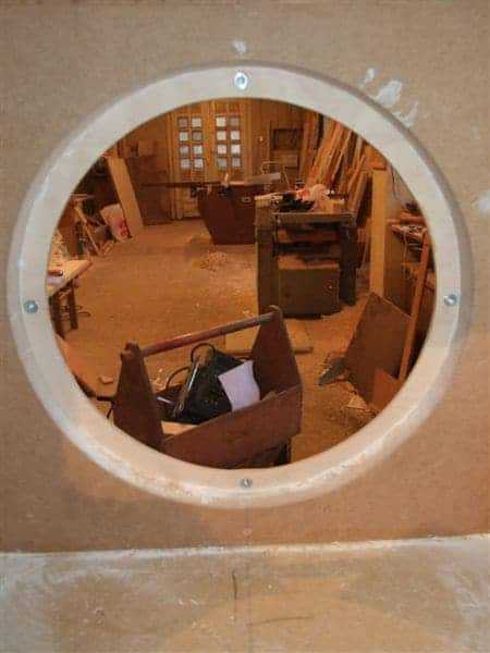

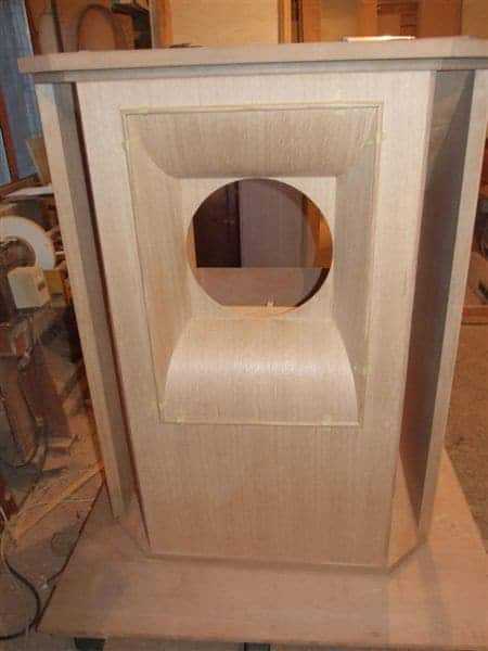

Ovaj momenat nije na crtežima. Na stranicu C iznad dela B izbušiti otvor prečnika 100mm. Ovim se uključuje u kompresioni deo kutije i zapremina koja je ograničena sa C, B, A i T
This move is not on the drawings. On the side C, above the part B, drill a hole of 100mm diameter. With this, the volume what is limited with parts C, B​​, A and T is added to the compression part of the box.

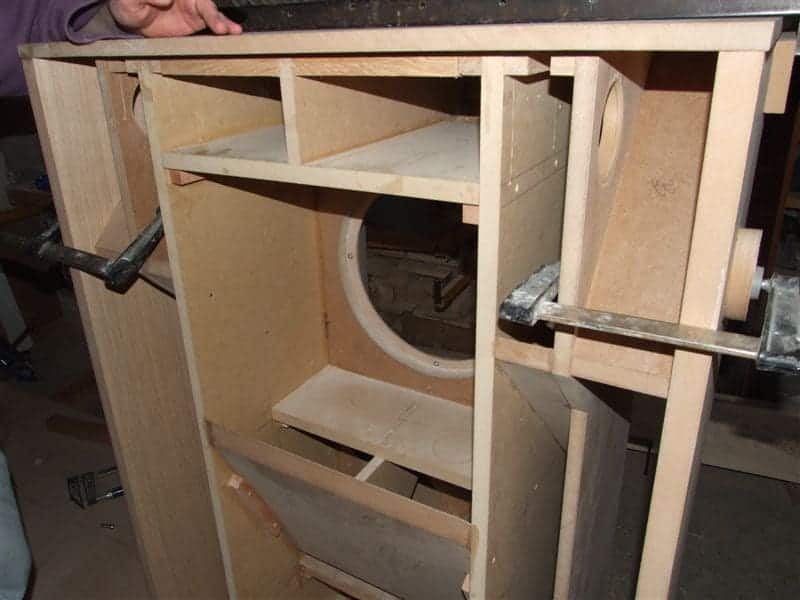

Unutrašnjost kutije, pogled na S2 i S1Zabušene rupe i zavrnute matice sa spoljnim navojem ( unutrašnji navoj je 6mm ). Matice gore i dole prodiru kroz S1 u MDF, a levo i desno u deo K. HPD385 se postavlja iznutra.The box from inside, view to parts S2 and S1 .The holes are predrilled and the “Insert Nuts for wood Type D M6x13mm “are tightened. Nuts up and down across the S1 penetrate into the MDF. Nuts left and right into the parts K. HPD385 is placed from inside the box.

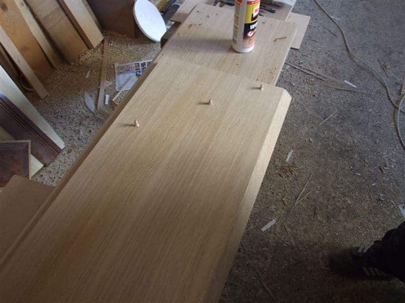

Stranica A ( obe strane isfurnirane ), izbušene su rupe za tiple za spajanje sa delom BThe A part (both sides veneered), holes are drilled for the dowels, for connection with part B
