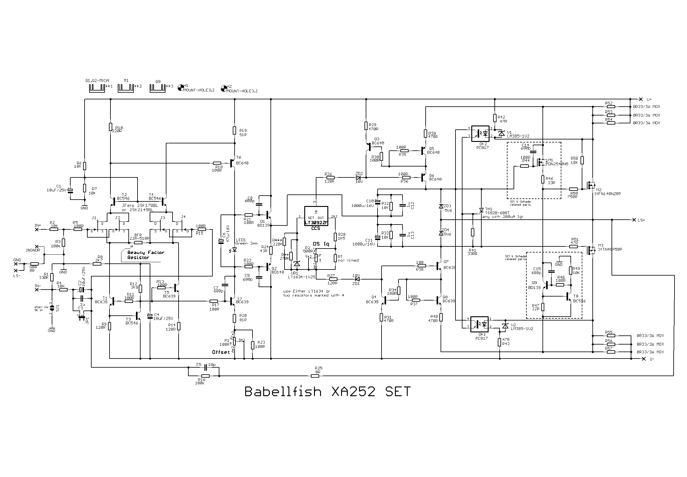

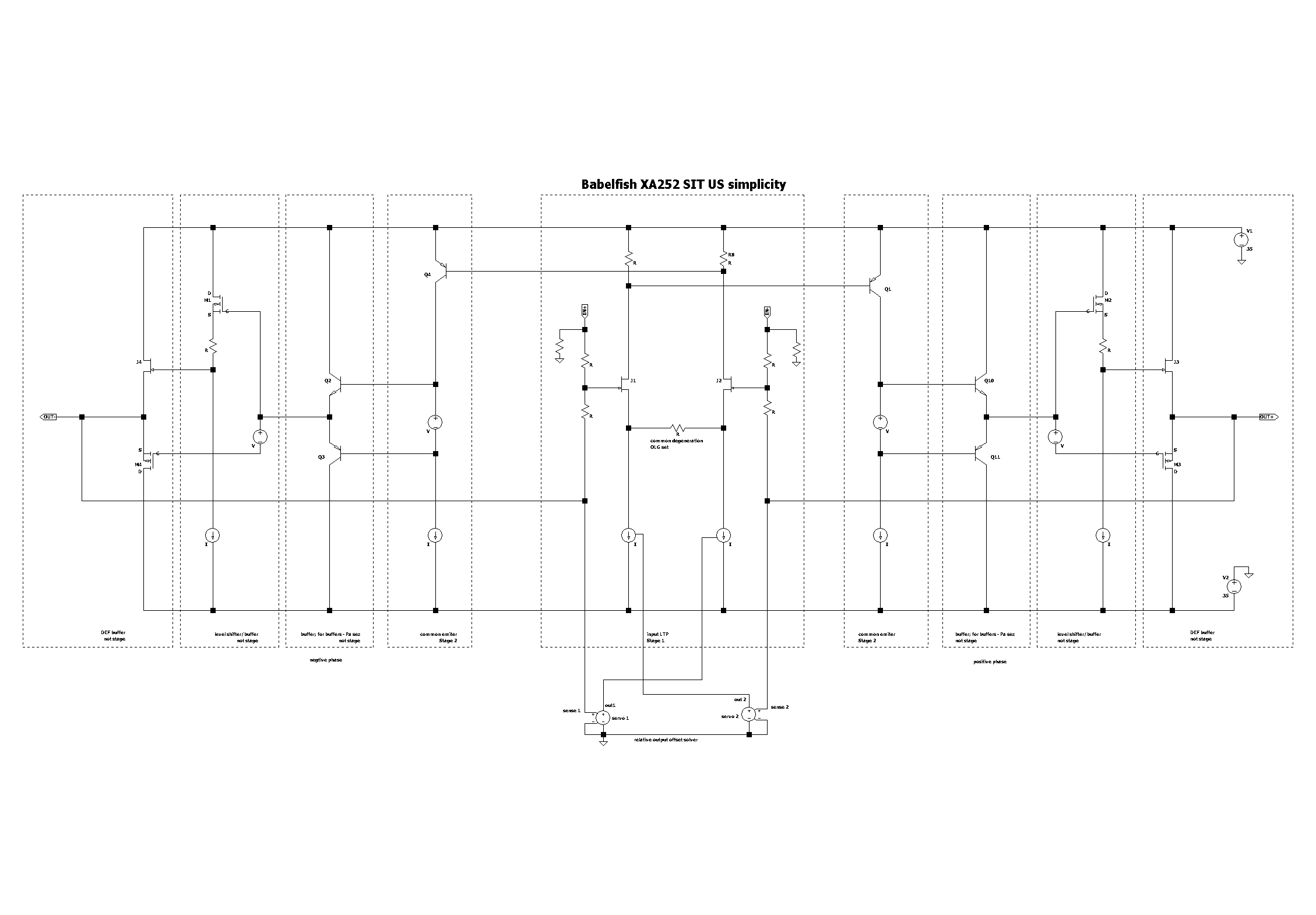

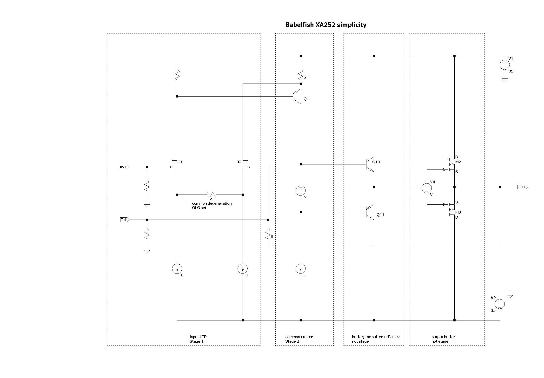

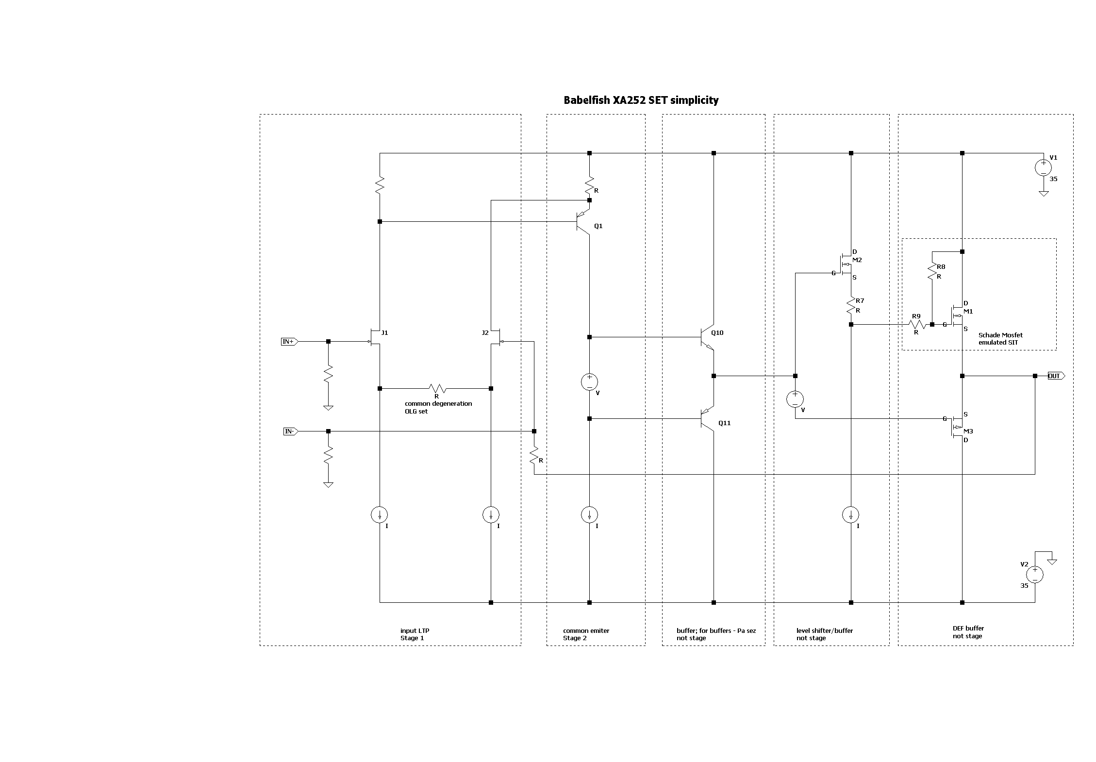

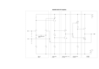

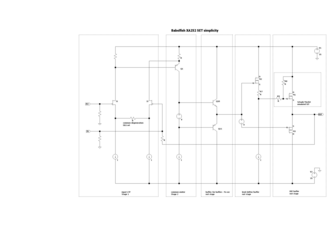

Zen Mod Napisano Jun 18, 2021 Autor Share #45 Napisano Jun 18, 2021 Babelfish XA252 SET as my pal Indra, member of same Pantheon and evidently same Caste to which I belongs, asked ....... here is schm of Babelfish XA252 SET fancyschmancy name for Schade iteration of full Mos OS, where upper output Mosfet is Schaded, so practically being emulation of SIT gate resistor R50 increased to 750R, introduced new resistor R58 (18K) SIT related parts (two rectangles of short dash lines) mounted - as for SIT iteration, but instead of M1 - IRF510 (we are using for SIT), placed DN2540 R46 changed to 33R we need around 3V voltage level at left (inner) side of R50, so result as is - DN2540 gate voltage is 3-4V-ish (fine tune of R46 possible to achieve full symmetry of M1 and M3 gate voltages, trivial task) ; these being referenced to output node all parts titles ref. to attached schm once when I have final pcb, containing all 3 amps , schmtcs with proper nomenclature will be posted I could avoid T8-Q9 30mA CCS, and route lower end of R46 to output node (M2 source), but as I already had CCS in place, why not using it yes, as Indra said - Papa's fave gigglywiggly graphs are saying that 2nd is neg. in phase ; that not posted, just simulated, but no reason for doubt sp300b je reagovao/la na ovo 1 Link to comment Podeli na ovim sajtovima More sharing options...

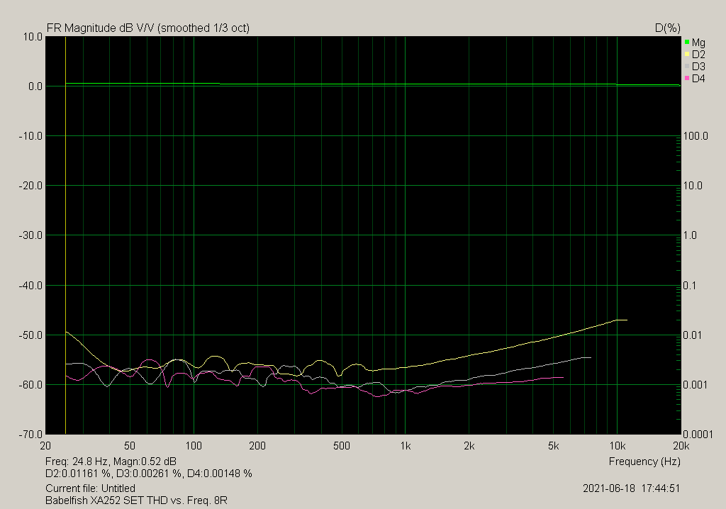

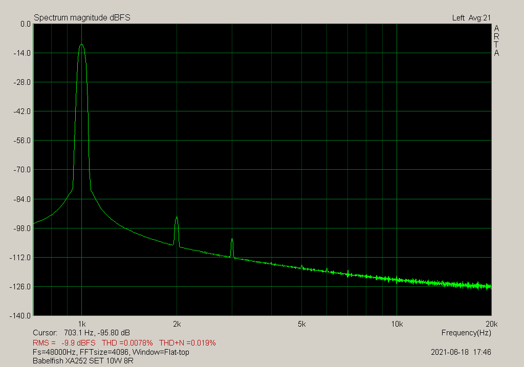

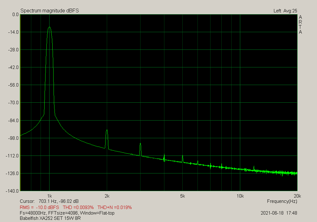

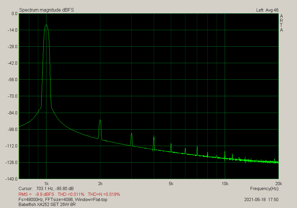

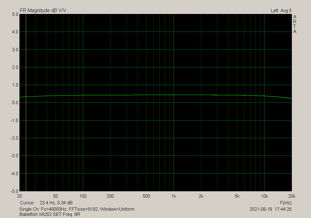

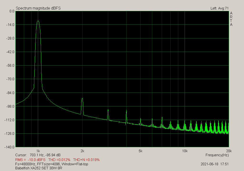

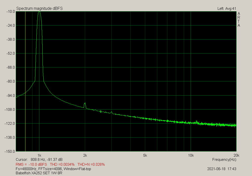

Zen Mod Napisano Jun 18, 2021 Autor Share #46 Napisano Jun 18, 2021 Babelfish XA252 SET - graphs , 8R load, BFR=22R as titled rails as previously: +/-30Vdc, Iq 1A7-ish Link to comment Podeli na ovim sajtovima More sharing options...

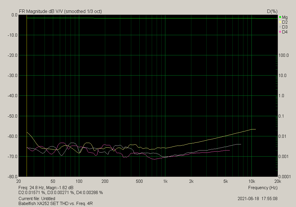

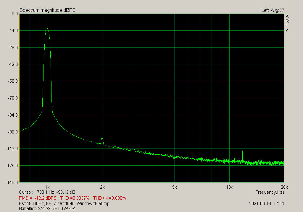

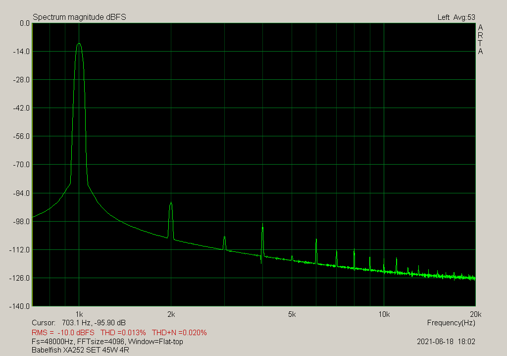

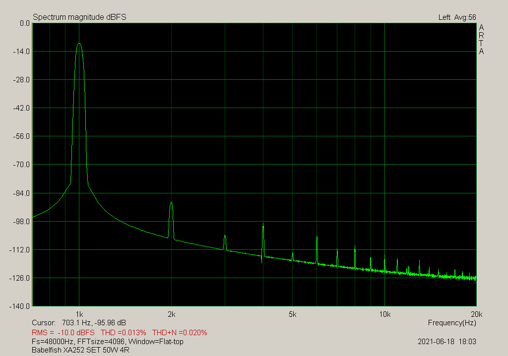

Zen Mod Napisano Jun 18, 2021 Autor Share #47 Napisano Jun 18, 2021 Babelfish XA252 SET - graphs , 4R load, BFR=22R everything the same, load changed to 4R that's it; my preference sez that I'm not even going to try tests with 510R for BFR as expected (ZM being lazy .......... I'm going to really check that maaaaybe later tonight, to actually compare graphs one by one) - this one being somewhere in the middle between B. XA252 and B. XA252 SIT Woland and vinko je reagovao/la na ovo 2 Link to comment Podeli na ovim sajtovima More sharing options...
Zen Mod Napisano Jun 18, 2021 Autor Share #48 Napisano Jun 18, 2021 OK, I've compared graphs B. XA252 waaaaay down in THD at all power levels, so no real comparison, except same THD Spectra nature (that is more "except") then, THD levels comparison between B. XA252 SET and B. XA252 SIT clearly shows that SET is uniformly approx. 6db down at each tested power level in my book, that's pretty good emulation - achieving same behavior and consistency, while still making some desired difference ...... even ignoring that we are emulating nearly 100$ part (plus not so easy to obtain) with 25$ part edit: for SET - did I said that even famous ∀ Class DEF current distribution is clearly evident - Schade SIT emulation is working as proper SIT in DEF - I like to see it as SIT being error corrector for Mosfet zerowaf je reagovao/la na ovo 1 Link to comment Podeli na ovim sajtovima More sharing options...

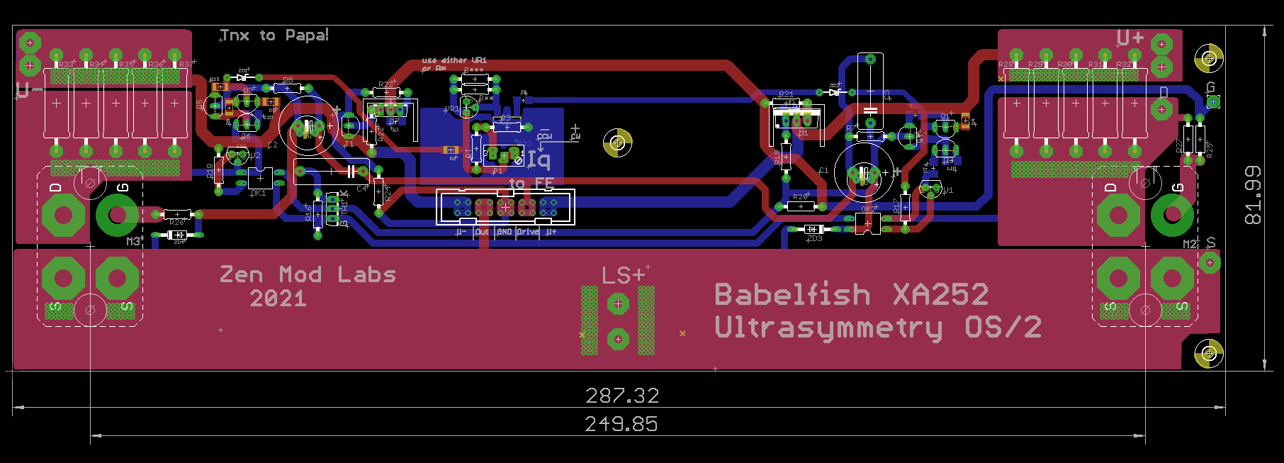

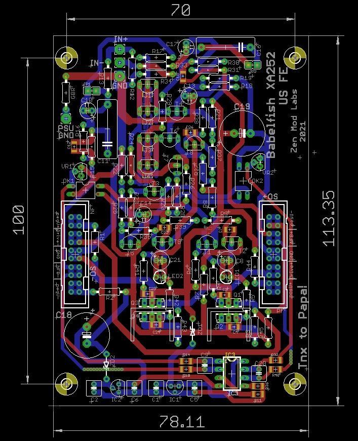

Zen Mod Napisano Jul 13, 2021 Autor Share #58 Napisano Jul 13, 2021 Sloba je sam svoju pcb nacrtao ......... zabava za letnje dane sp300b je reagovao/la na ovo 1 Link to comment Podeli na ovim sajtovima More sharing options...
