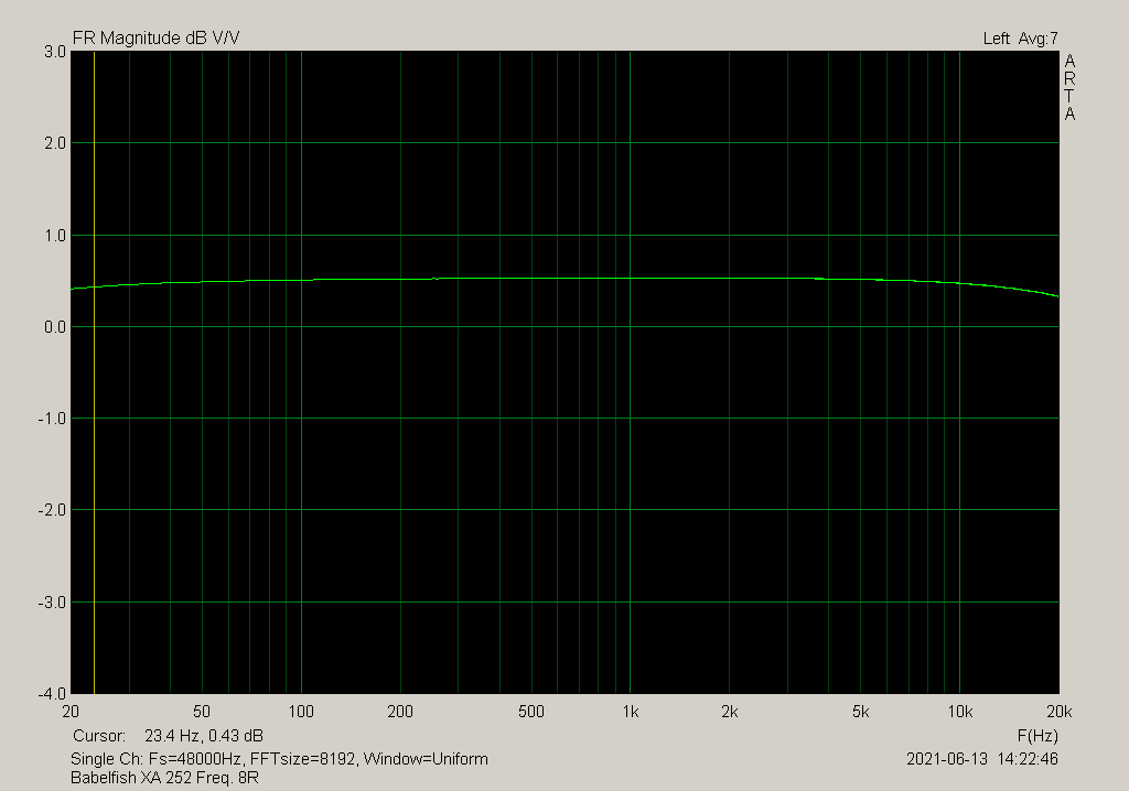

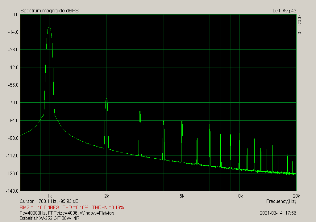

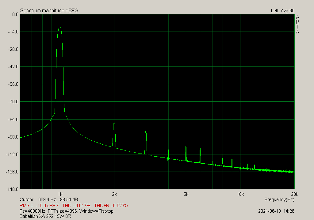

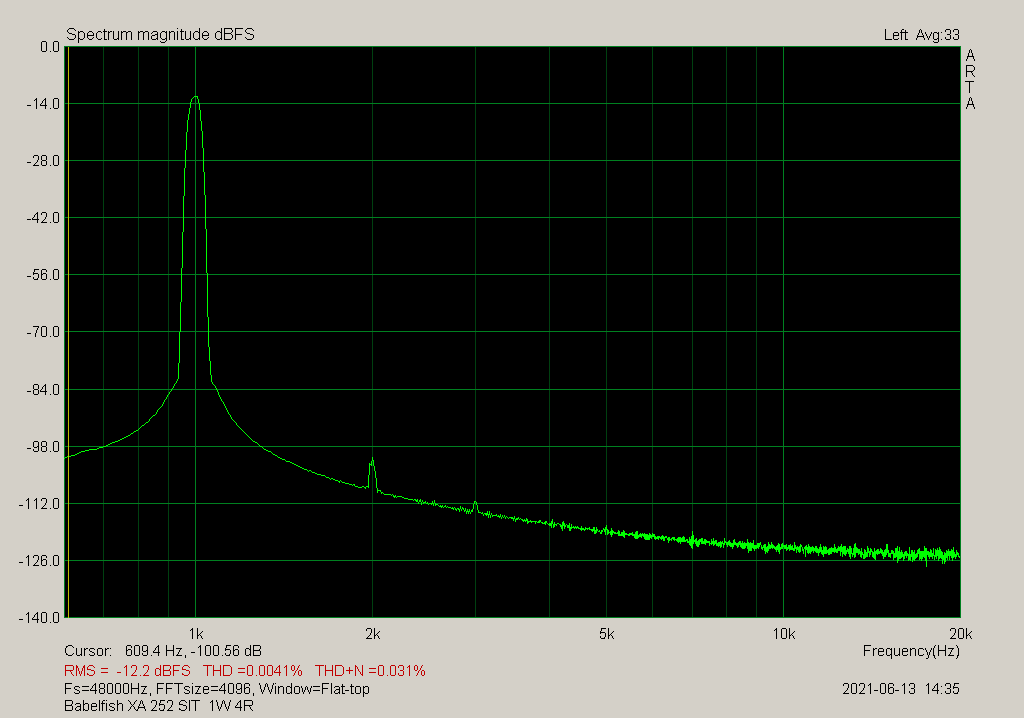

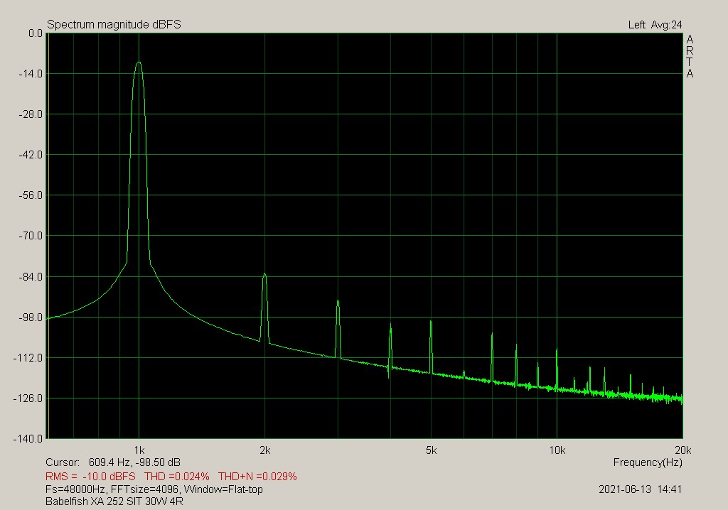

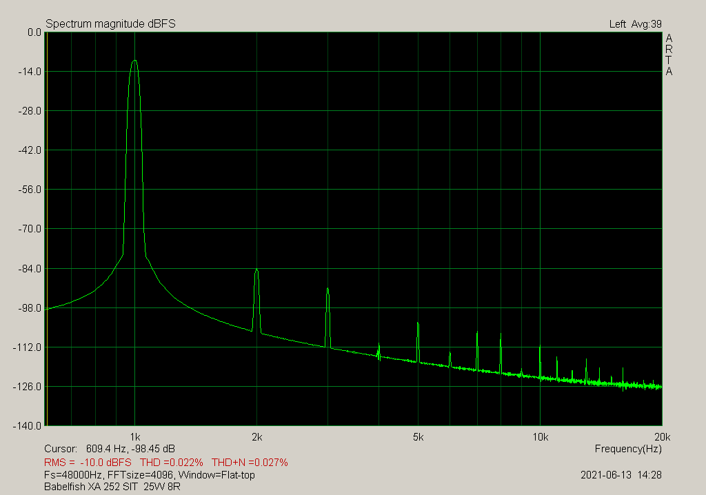

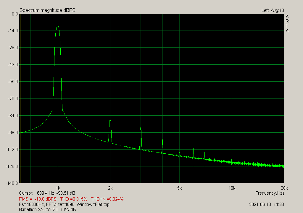

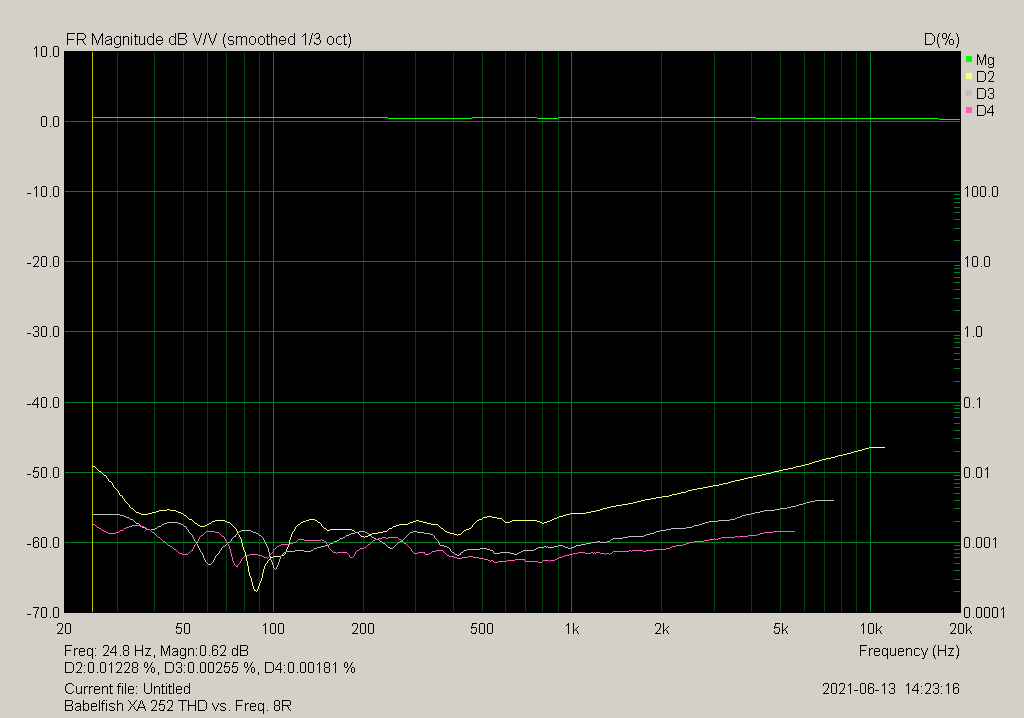

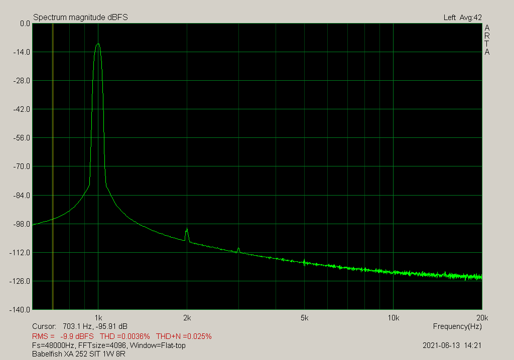

Zen Mod Napisano Jun 13, 2021 Autor Share #27 Napisano Jun 13, 2021 Babelfish XA252 SIT - graphs , 8R load, BFR=22R Today I had time just for first battery of tests, with BFR value of 22R Happy Camper, will be even more campier tomorrow, after all tests and some mooooosic time everything as before (rails 30Vdc, Iq 1A7), I've just mount necessary parts for SIT iteration and changed upper mosfet for THF51 as of recently - Ugs value of SIT is irrelevant, it's just niiiiiice to have them so-so matched by Ugs graphs going up to 30W, at greater levels than 30W - Opto+Thyristor current limiter kicked in and entire OS gone Dodo ; obviously DEF specific current distribution of parts is putting heavy burden on Mosfet and I need to investigate how much I can increase protection treshold, without risk I will also think of ways - maaaaaybe - how to slighlty increase power output ........ I don't want to change even a iota of natural DEF behavior, so I need to see how much exactly juice is going through Mosfet dynamically, and to accordingly declare new Iq point for that rails are OK, 30 as is, 35 if one want to squeeze as much watts is sane from this amp more to come these days about that Srecko je reagovao/la na ovo 1 Link to comment Podeli na ovim sajtovima More sharing options...

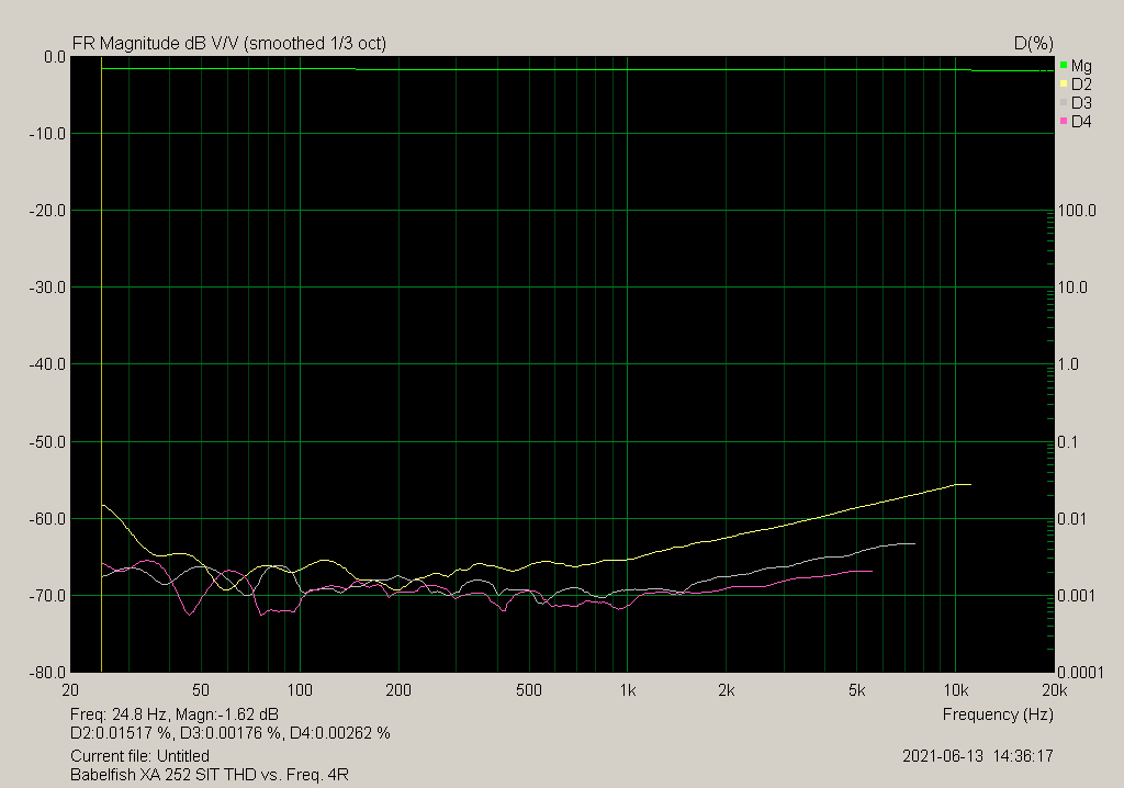

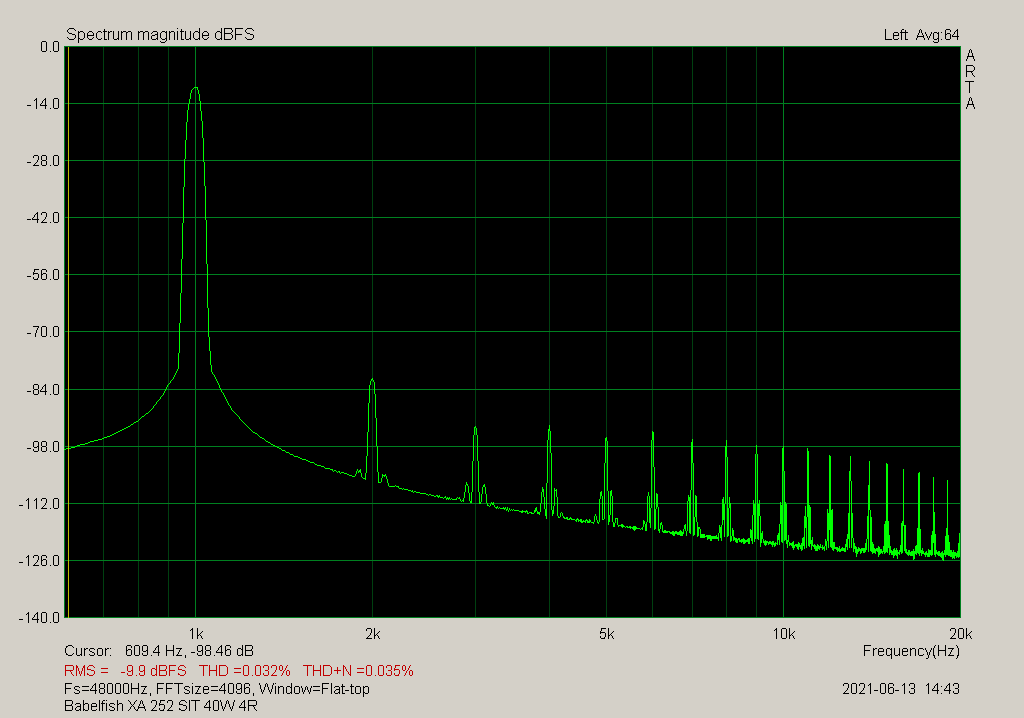

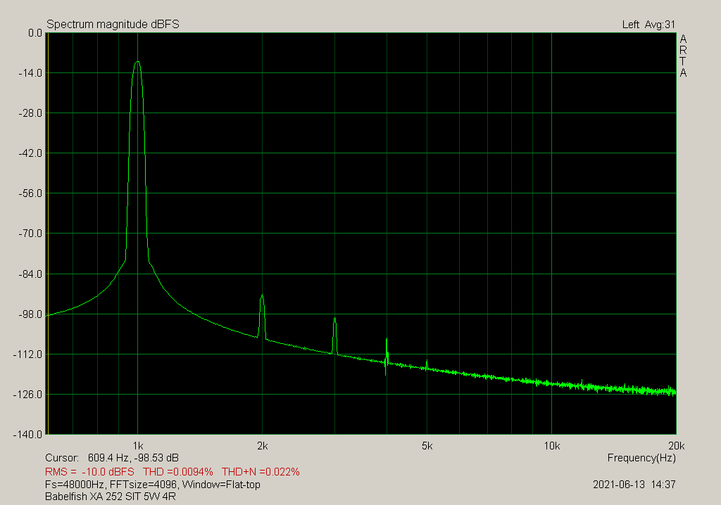

Zen Mod Napisano Jun 13, 2021 Autor Share #28 Napisano Jun 13, 2021 Babelfish XA252 SIT - graphs , 4R load, BFR=22R everything same, load changed to 4R Srecko and shonne je reagovao/la na ovo 1 1 Link to comment Podeli na ovim sajtovima More sharing options...

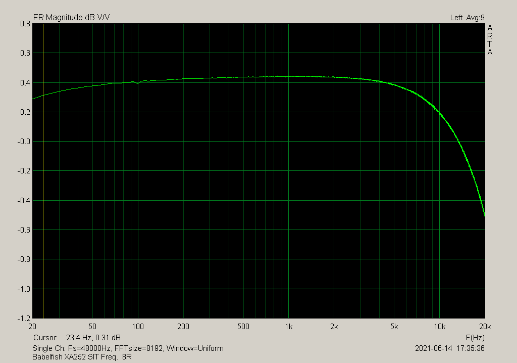

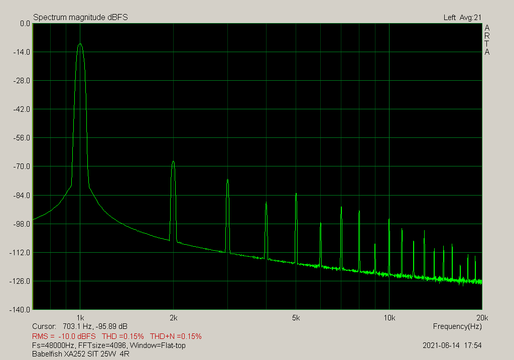

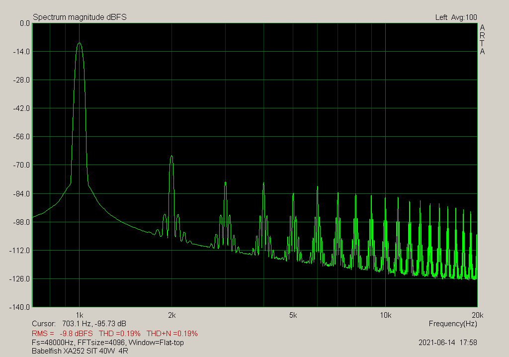

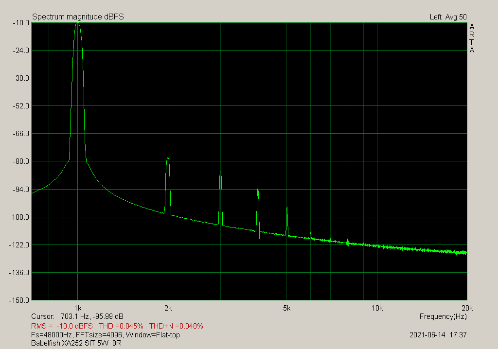

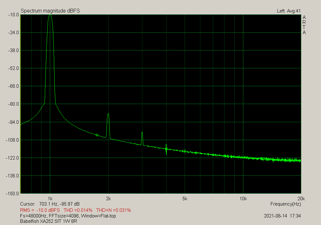

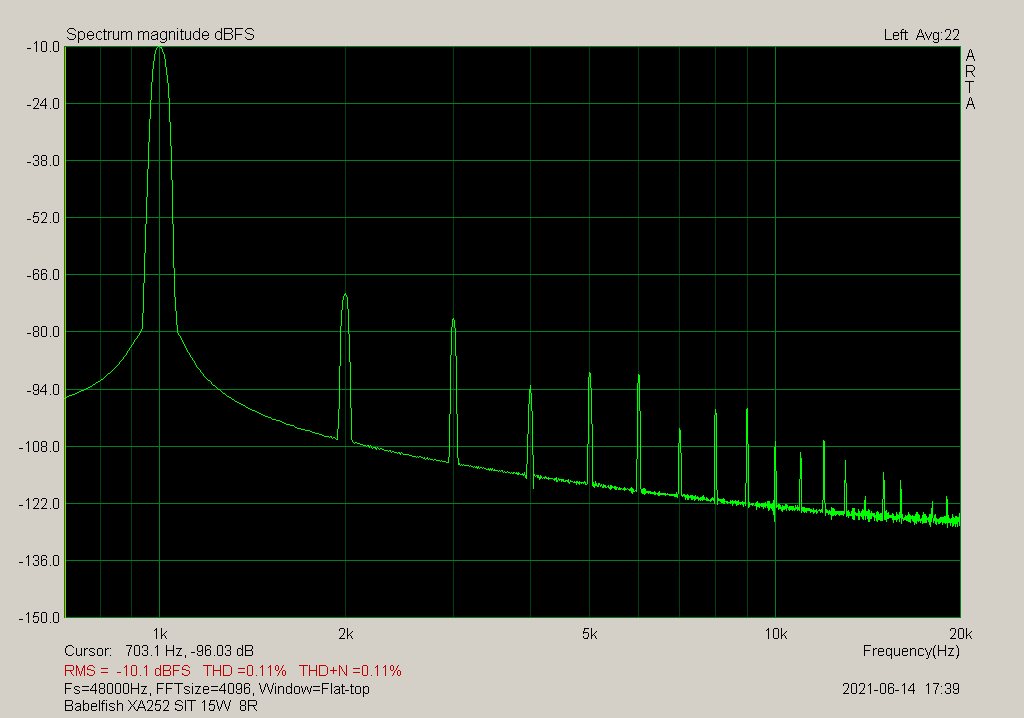

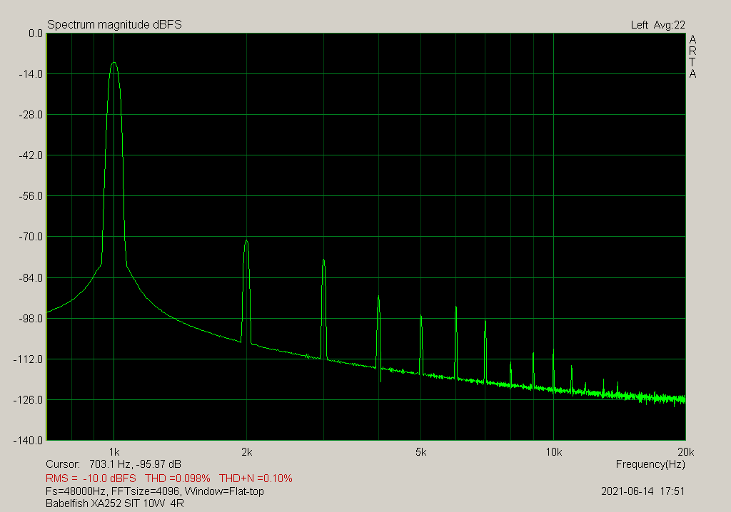

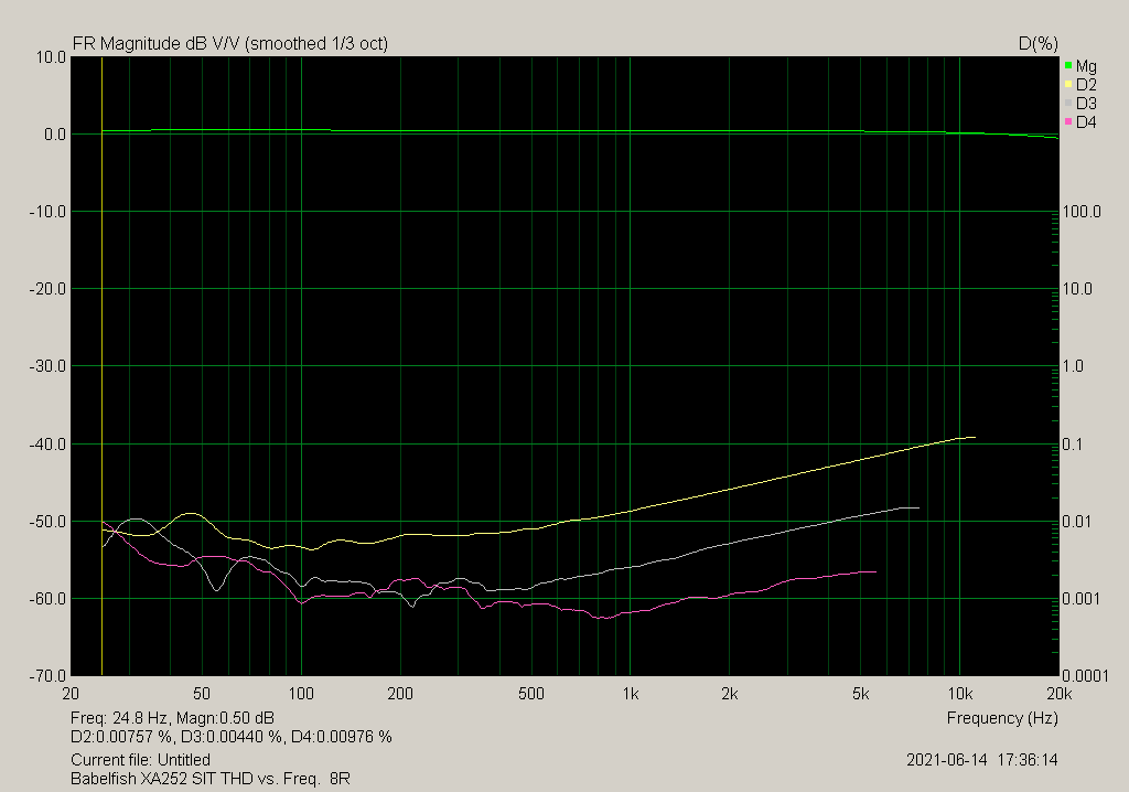

Zen Mod Napisano Jun 14, 2021 Autor Share #35 Napisano Jun 14, 2021 Babelfish XA252 SIT - graphs , 8R load, BFR=510R .... everything same (rails +/-30V, Iq 1A7) Srecko je reagovao/la na ovo 1 Link to comment Podeli na ovim sajtovima More sharing options...

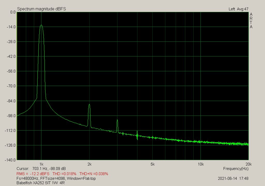

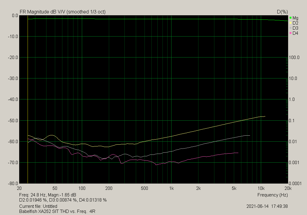

Zen Mod Napisano Jun 14, 2021 Autor Share #36 Napisano Jun 14, 2021 Babelfish XA252 SIT - graphs , 4R load, BFR=510R Load changed to 4 Ohms sp300b, Srecko and dejanco32 je reagovao/la na ovo 2 1 Link to comment Podeli na ovim sajtovima More sharing options...
Zen Mod Napisano Jun 14, 2021 Autor Share #37 Napisano Jun 14, 2021 Conclusion ! My preferences: -Babelfish XA252 (that being All Mos): rails between 30 and 35Vdc - depending how much power is needed, Iq everything between 1A and 2A, depending how much aluminum is on disposal, BFR-22R -Babelfish XA252 SIT: rails 30Vdc, Iq 2A, BFR-22R Hasta La Vista, Baby........ I'll be back! mutayu, sp300b and zerowaf je reagovao/la na ovo 3 Link to comment Podeli na ovim sajtovima More sharing options...
