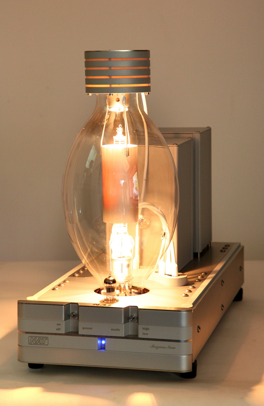

Mikorist Napisano Januar 12, 2023 Share #748 Napisano Januar 12, 2023 @shonnevreme je za NEXT level 😁😛 Magma M WWW.NATAUDIO.COM Single Ended Mono Block Power Amplifier Magma M is reference point power amplifier made by NAT as pure class A, single - ended type with zero global f... Link to comment Podeli na ovim sajtovima More sharing options...
