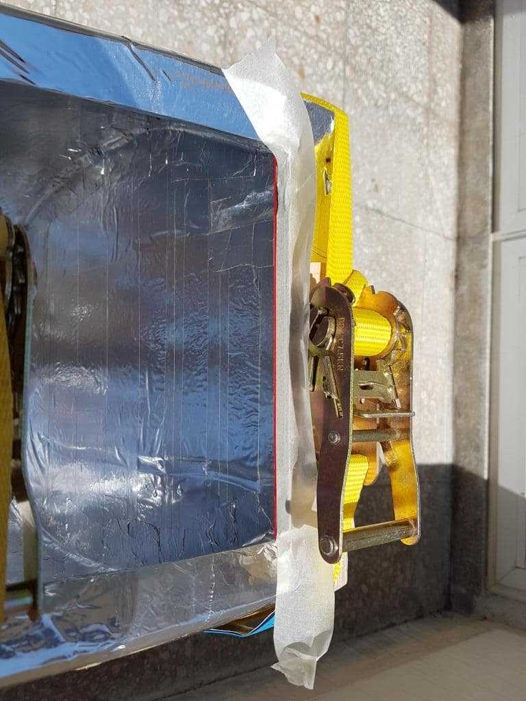

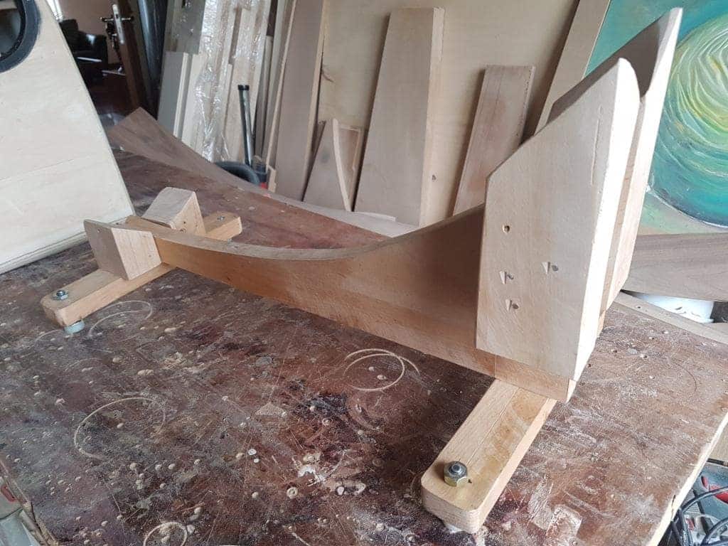

15 hours ago, Dacho said:

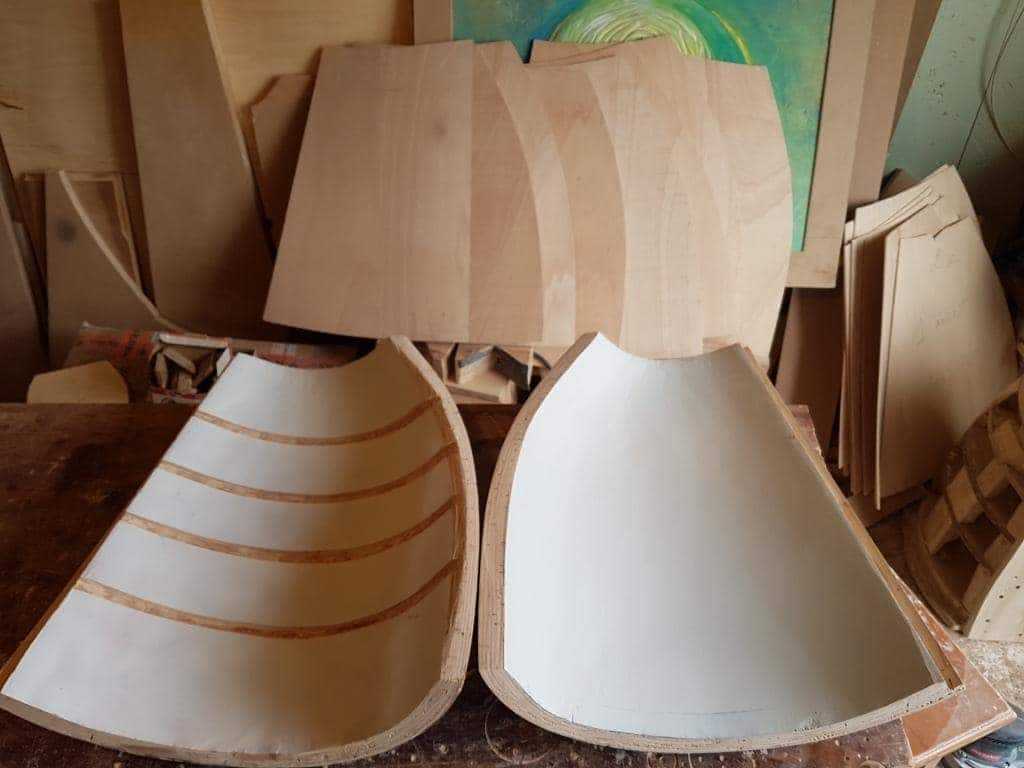

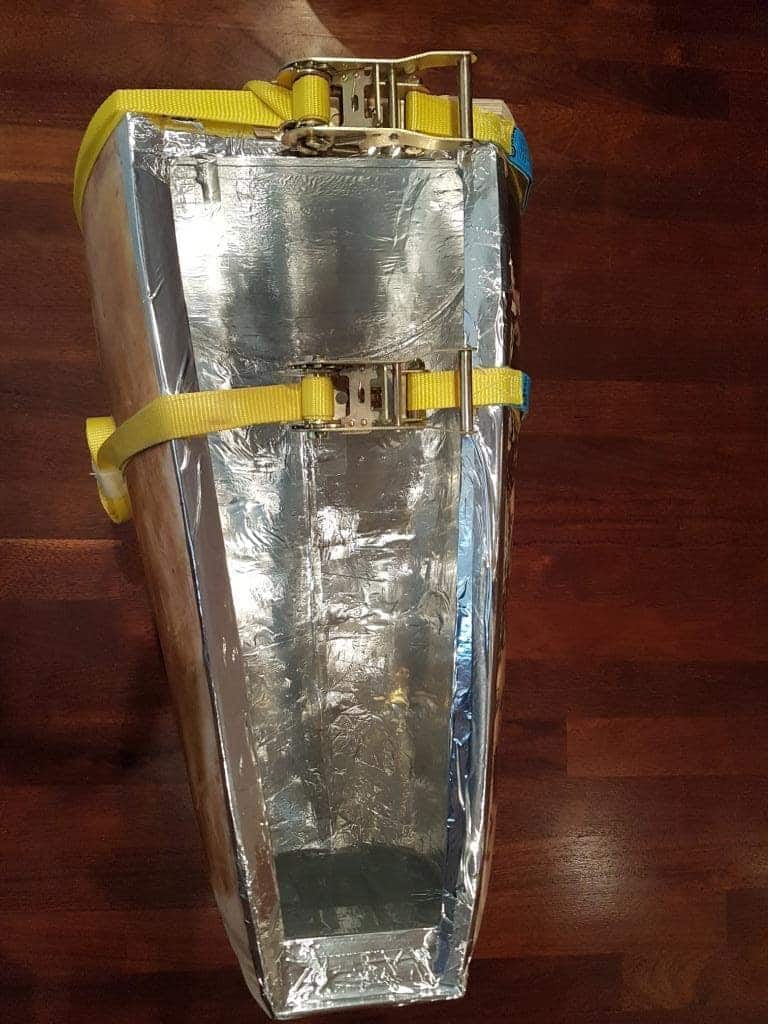

On the first picture...

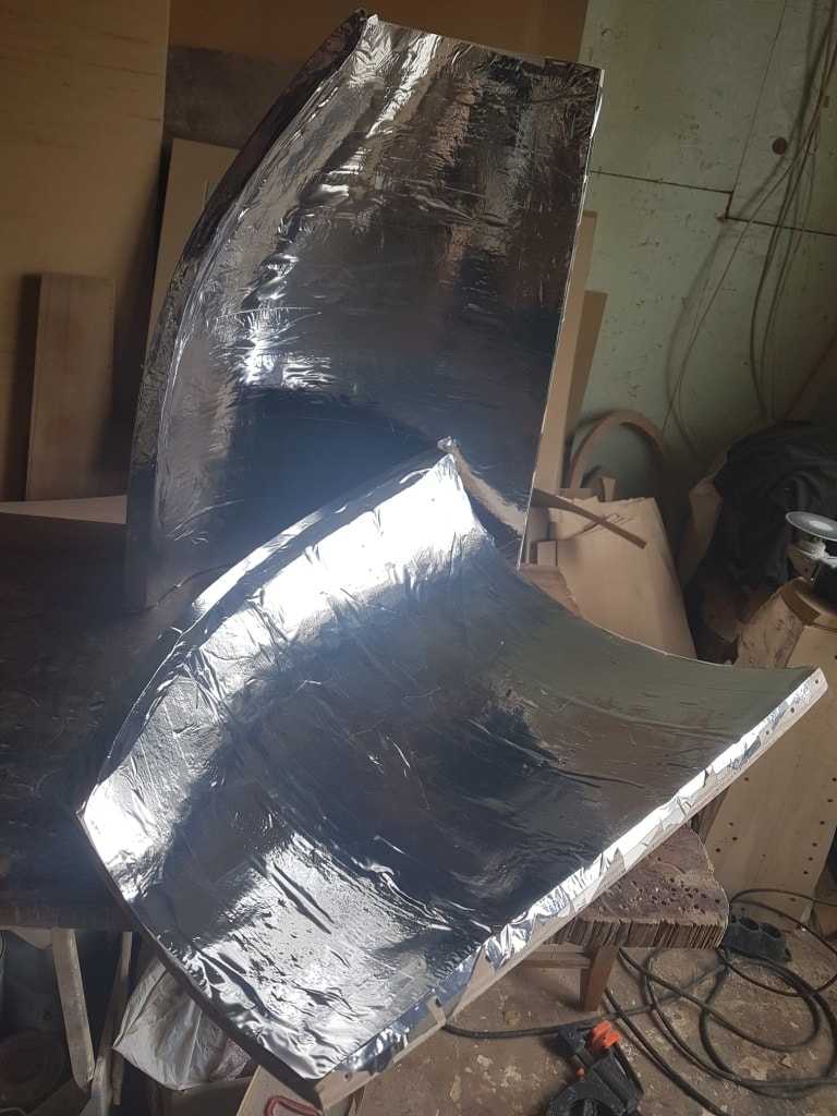

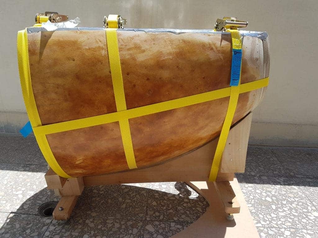

The first image is a "matrix" of her bending 8 layers x 4 mm MDF/ she did not participate in the construction/.
This aluminum foil  is to not to  to be glued the layers in bending.
Sorry, I do not understand!

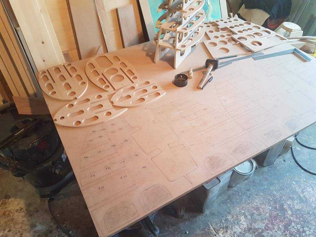

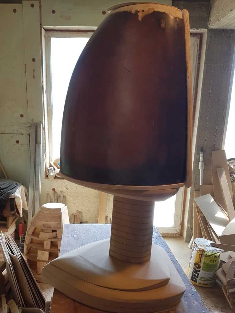

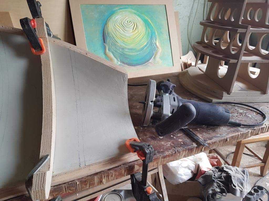

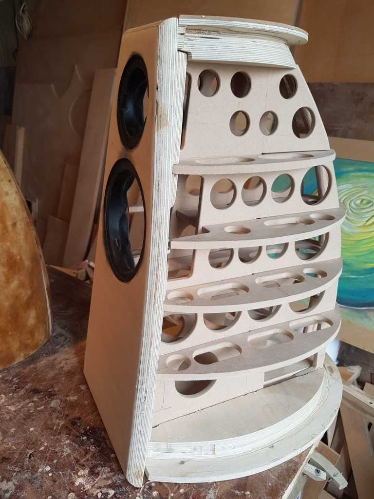

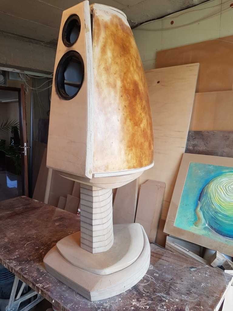

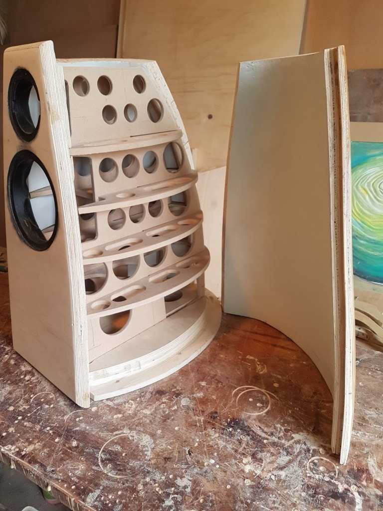

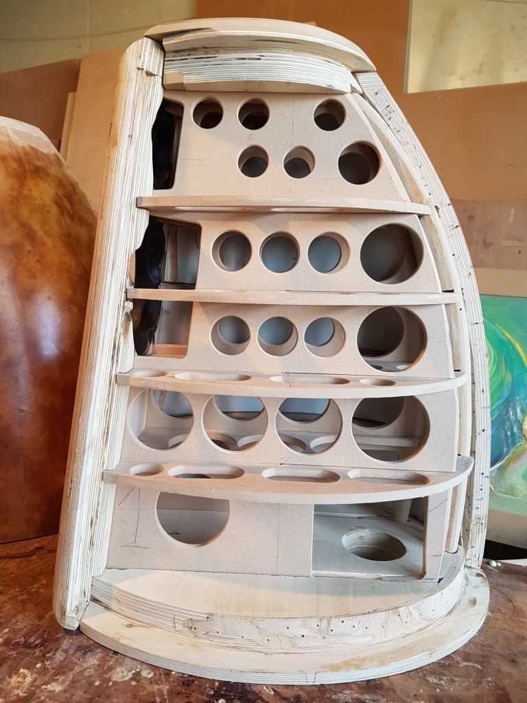

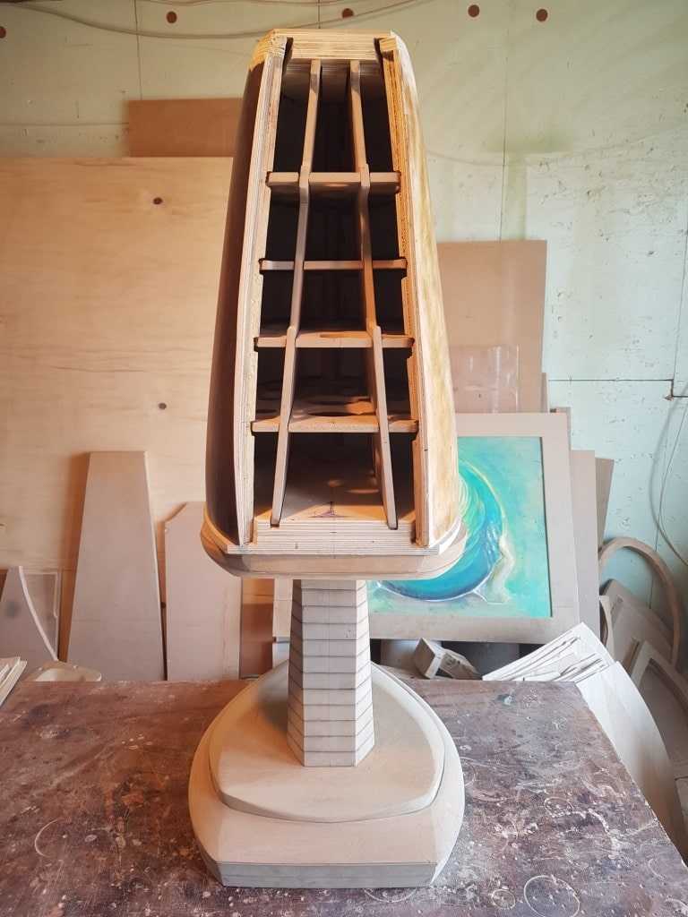

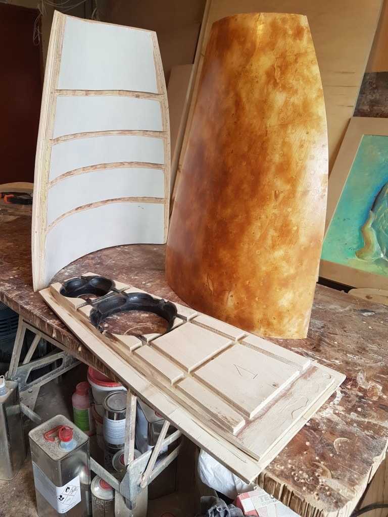

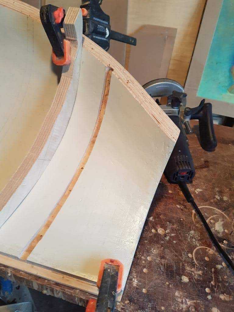

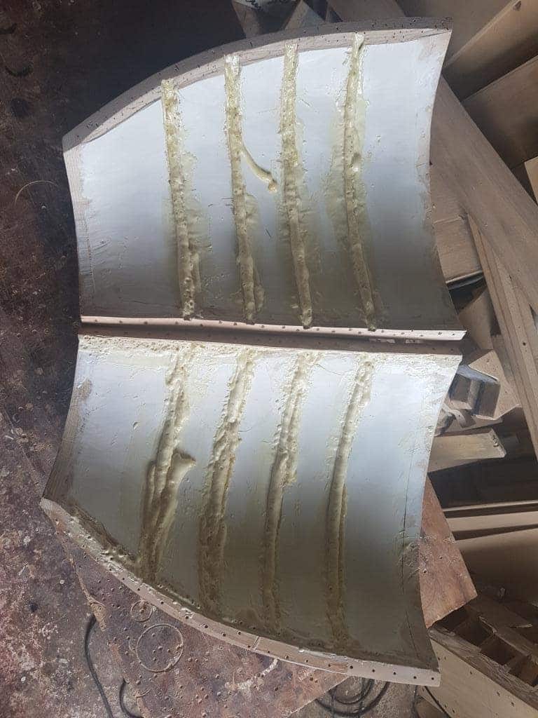

These columns have their new  owner and I work on a new project.
To move the evening!
I decided to move my evening as you presented
my new project:

looking simply great !

Great matrix construction!!
Do you have your own CNC machine or you work with manual tools?

^I've never used CNC machine, everything is made by my hands.

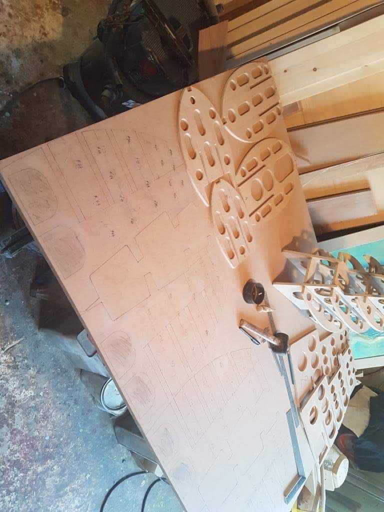

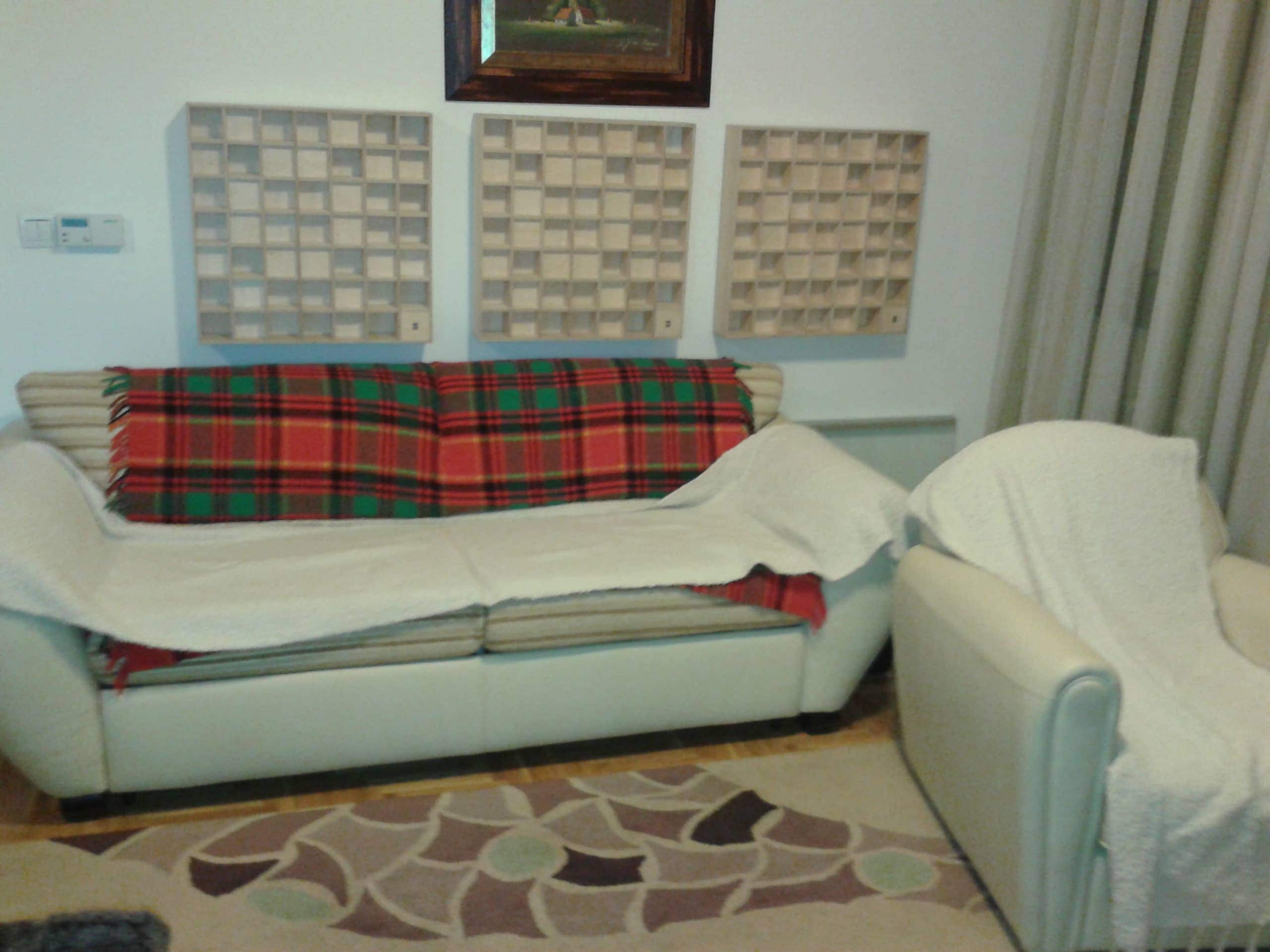

Pay attention to the most important tool-panel behind /my job - I  must finish her -  never ever!/.
